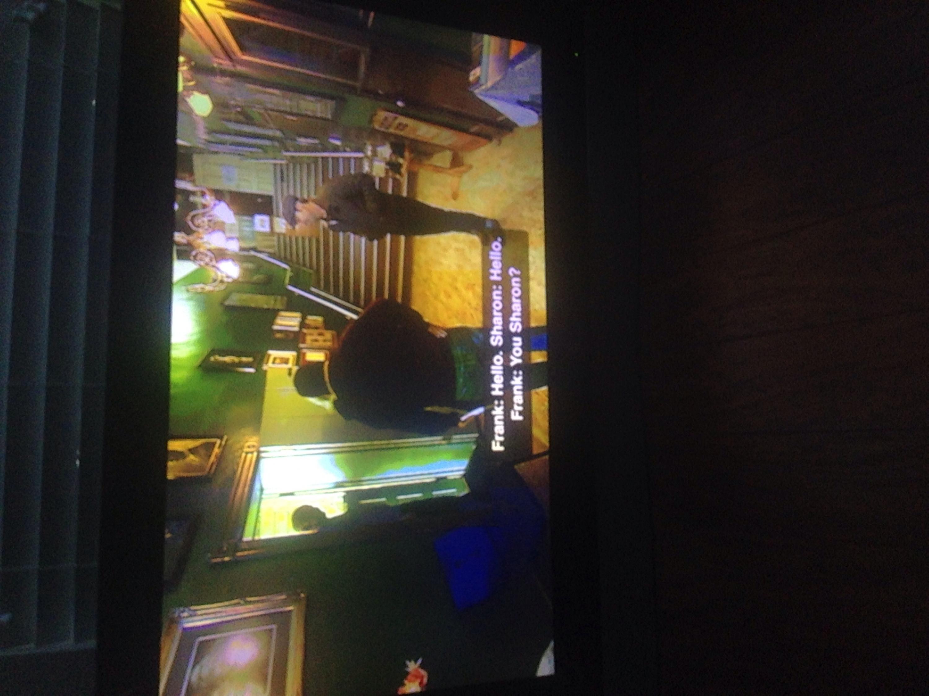

Vizio P42HDTV10 no picture
  • ned1
    • Feb 2014
    • 139
    • usa
    Re: Vizio P42HDTV10 no picture
    Got it, VSC was set to 150 instead of 120.
    Thank you all
      That fixed the issue? Good to hear... surprised though!
      • ned1
        • Feb 2014
        • 139
        • usa
        Looks better, can be tweaked more. Any suggestion Tom?
          If that did not fix it completely it needs the control board flashed as I mentioned previously.
          • ned1
            • Feb 2014
            • 139
            • usa
            How do you flash control board. Sorry I missed that
            • ned1
              • Feb 2014
              • 139
              • usa
              See picture
                To flash it requires the $150 jig by LG.
                However Capkid is offering a service for about $22.50 to do this:
                https://www.badcaps.net/forum/showthread.php?t=29263
                Simply post him your control board & he will flash it with the updated software.
