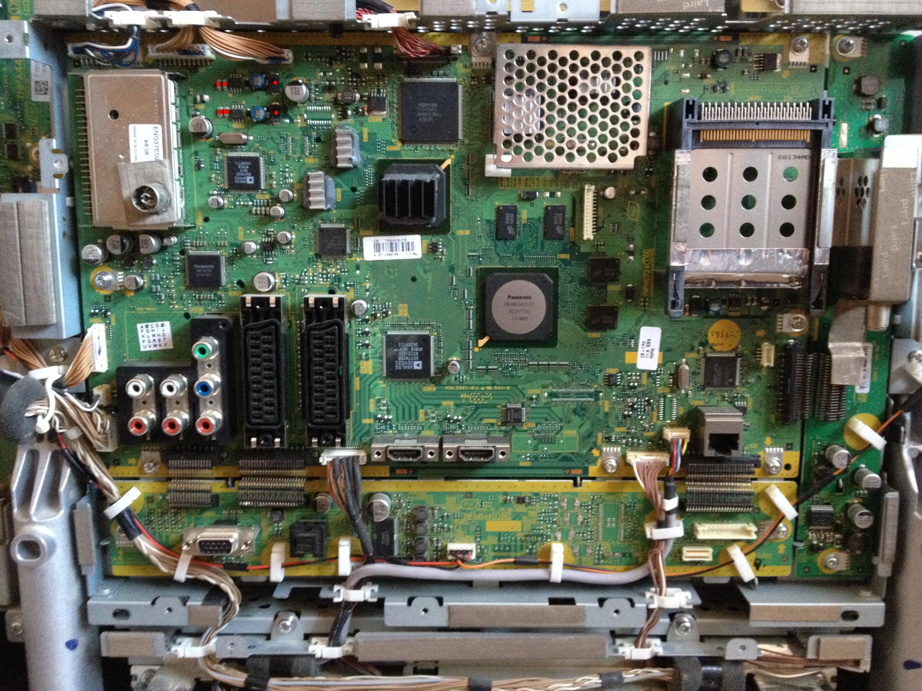

          Can't sleep! Anyway, disconnect, A5(LVDS cable), A6,A7, power on and full white on my PZ800, or A5, P6,P7. Had to push the power button to turn it on, there will be no front LED indication, not on mine at least.
          If the LVDS is left in, goes to a gray, primed screen.
          i was trying to do a bit of a search for the A board. TXN/A1SJTB comes up for 42,46,50" sizes which is unusual. Normally those numbers would be unique for each size.
          I noticed in your photo "CB" in front of that suggesting Rev CB which I'm getting the feeling it's a 50" version. TNPH0724CB
          There is a SUFFIX legend on the board and position of the jumpers decodes what it is.
          Was the board sold as specifically for a 42 or TXN/A1SJTB?
          Have not worked out what rev for the other sizes yet but on your original A, on that white sticker with TXN/A1SJTB, are there 2 letters at the beginning and are they the same as the replacement?

                    hi all sorry for delay work duties got in the way again lol
                    Ok im going to try and cover all you asked me to check but sorry if iv missed anything
                    Tom - those measurements
                    The first 4 are all 15.6 volts, the other two back points are 1.8 for the top and 1.3 for the bottom

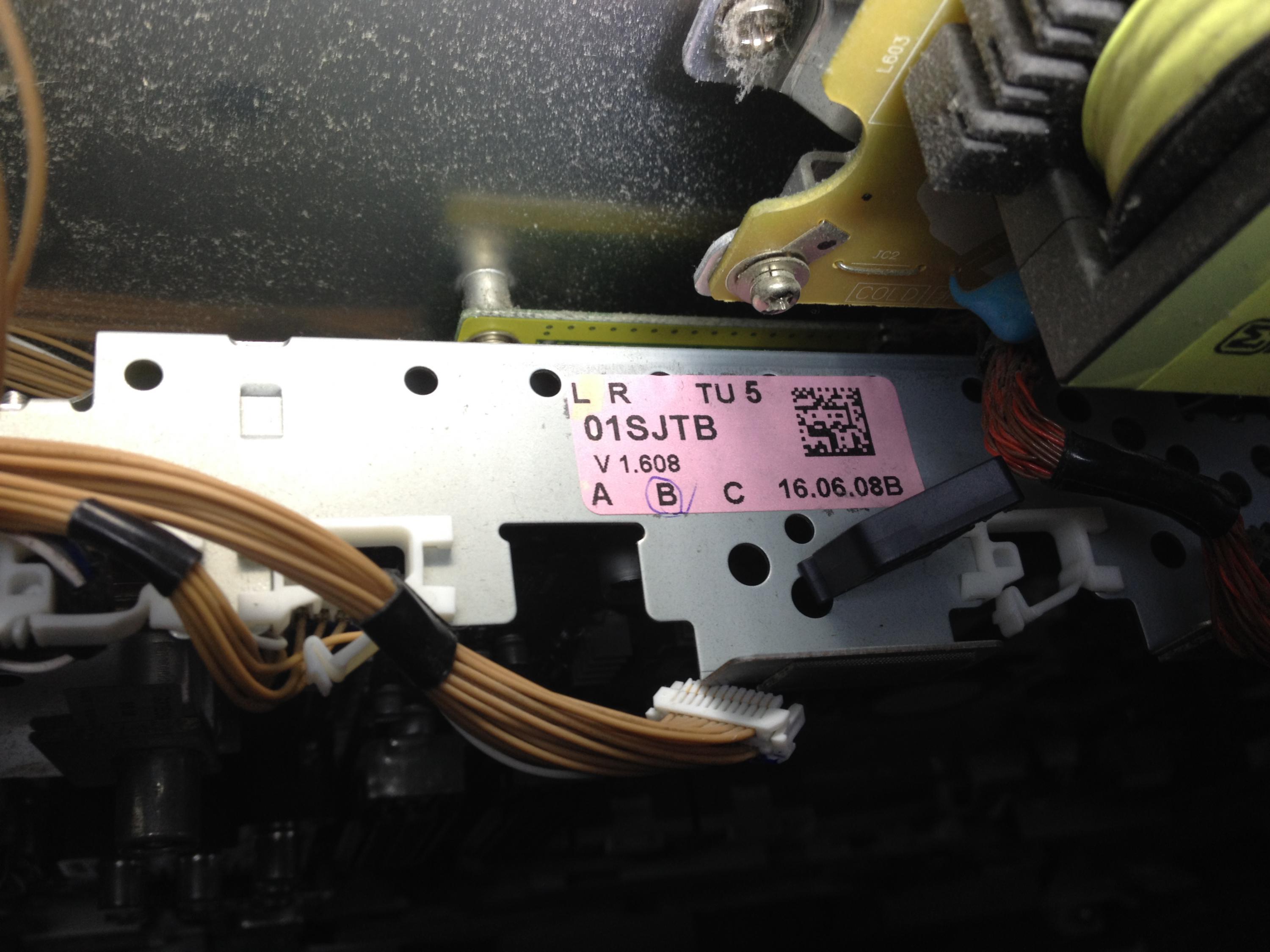

                    TW2005 - the revisions match they both are CB
                    There are some differences tho the sticker with the alphabet and certain letters are crossed out ( i would have thought this was date or manufactures line details )
                    and there are 2 other stickers that have differences - please see the pics
                    I have been told by the seller that it is indeed out of a 50 but will fit 42 and 46
                    I think this is the reason and it is size specific as that would make a lot more sense
                    If you guys could have a look and tell me what you think please ?
                    First 2 are original board 42 and the second two are from the 50

                      sorry its put the pics in diff order 50 is the first 2 and second set are the original 42 board

                          Those boards would be the same then going by the sticker. i'd take up the guuy's offer of another board but I'm wondering if there's a missing voltage 0n A6/A7?
