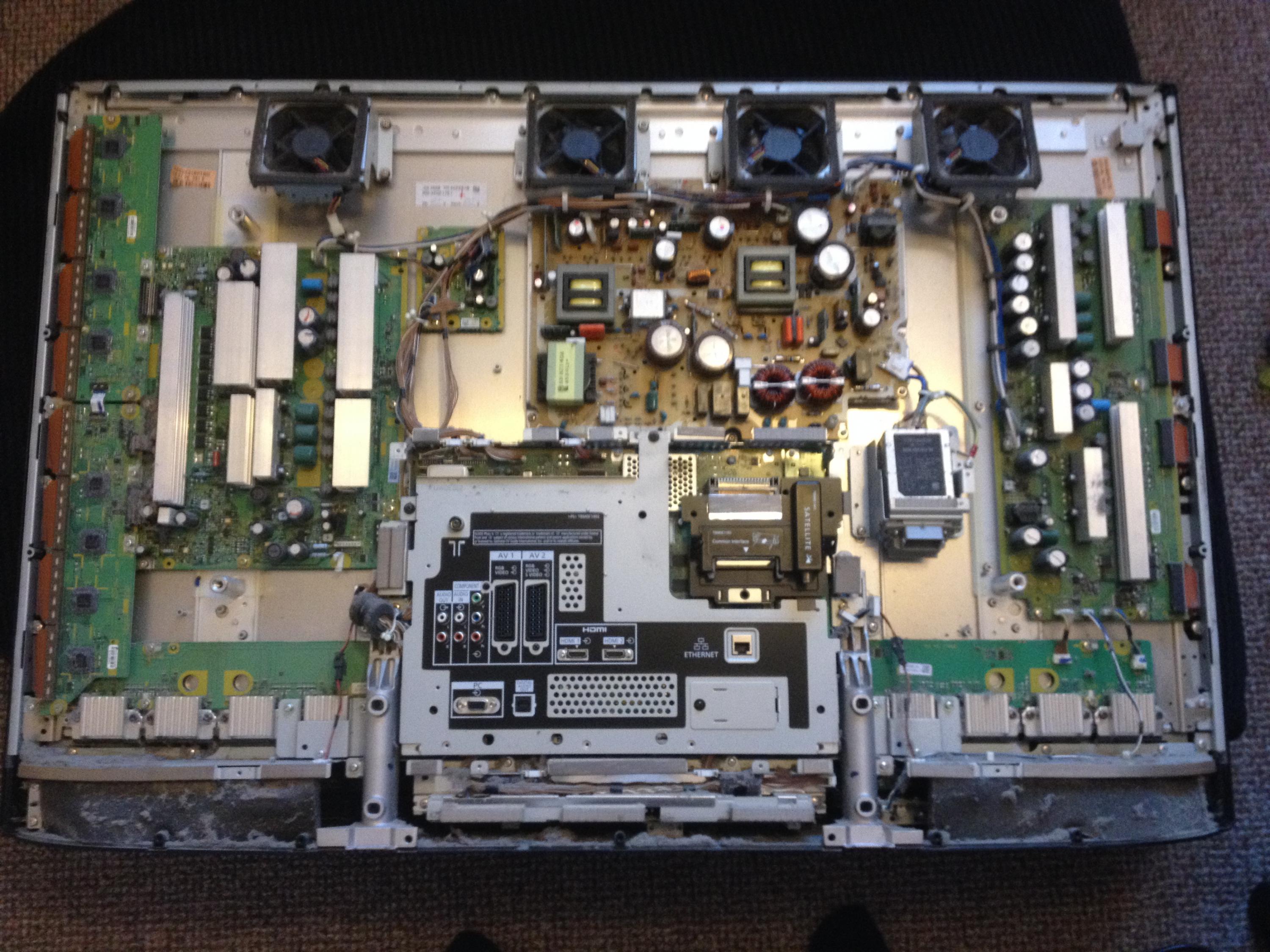

                iv got my compressed air but i cant get it to come on
                iv followed the video and mine dosnt have the 10 flash until iv pushed the power button
                then the tv does 2 quick clicks and then a pause 2 - 3seconds then the 3rd click and then flashes 10 times
                the tv is really really dusty so im going to clean up and re-seat all connectors
                while im doing that can you guys suggest what i can check next ?

                  Re: Panasonic TH-42PZ81 - 10 Blink / Flash
                  iv tried all connections and still no joy, how do i go about testing each board ?
                    It's more likely you have a 10 blinks after power button fault then, this is possibly main board related. You should check all the power supplies on the main board such as the SUB5V and SUB9V. Also check if Vsus rises briefly.

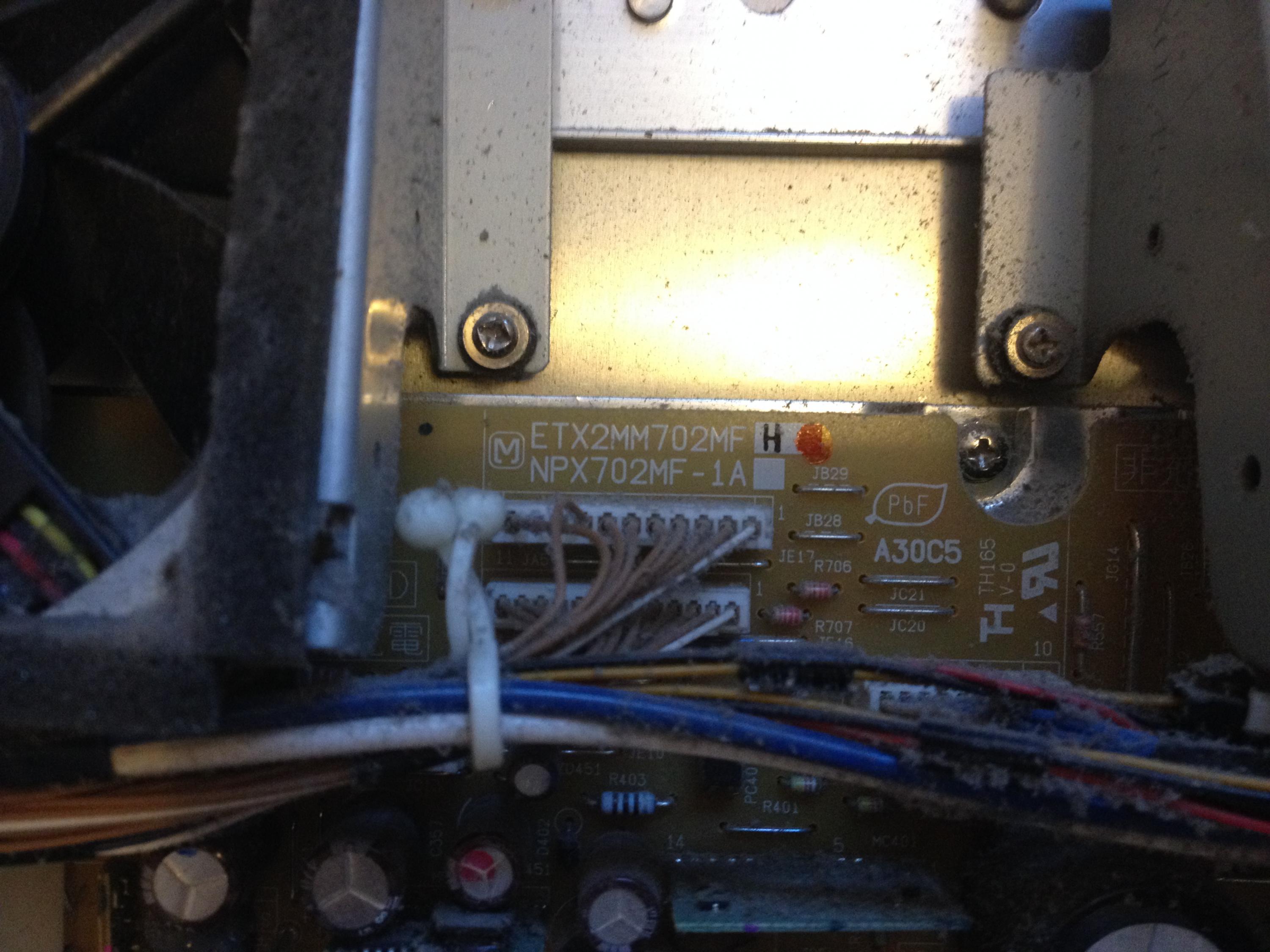

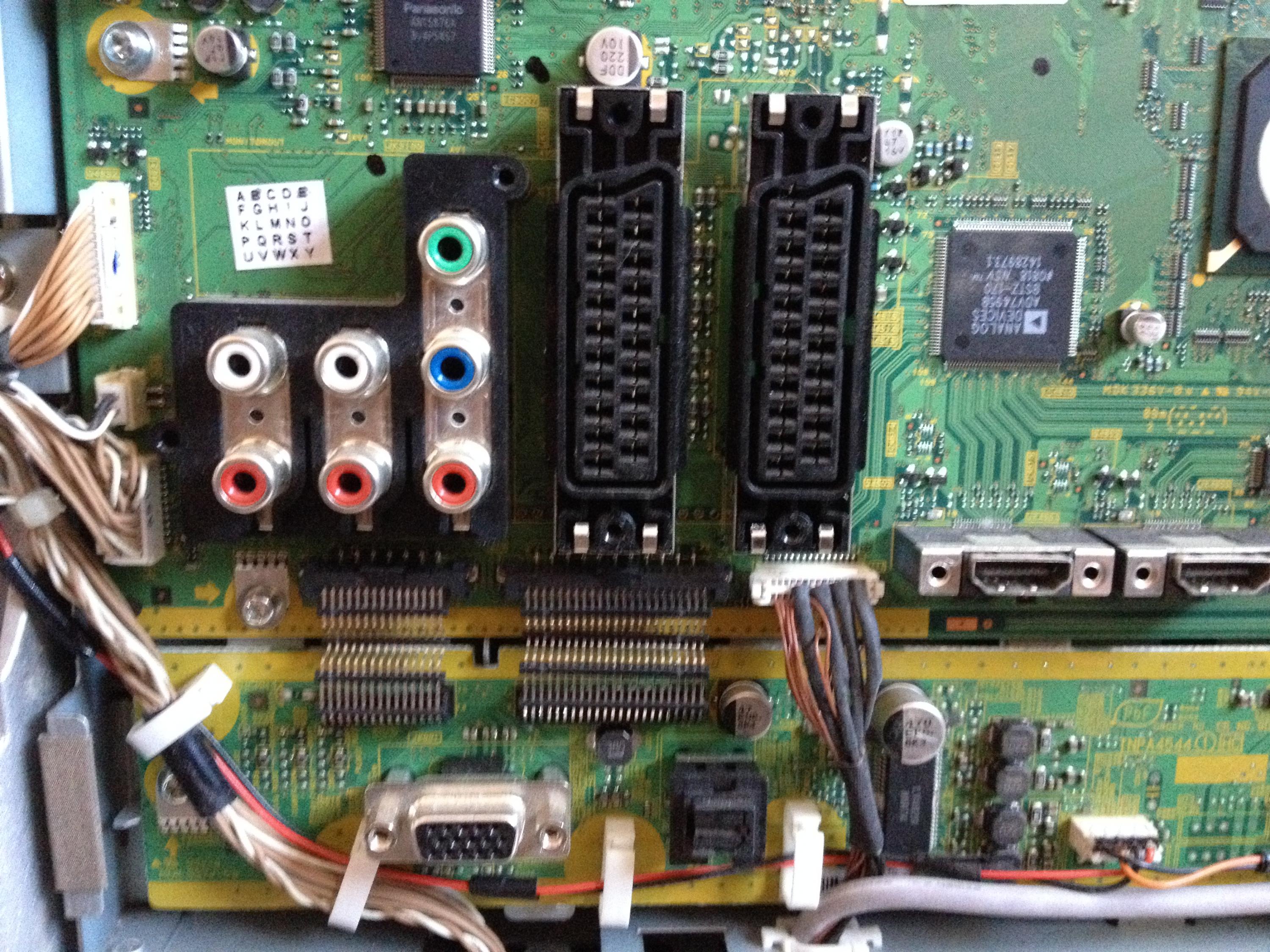

                            i have noticed some empty sockets do you think someone has been inside this befor or are they ment to be no wires in these connections
                                  All those are debugging/factory use sockets, that's fine.

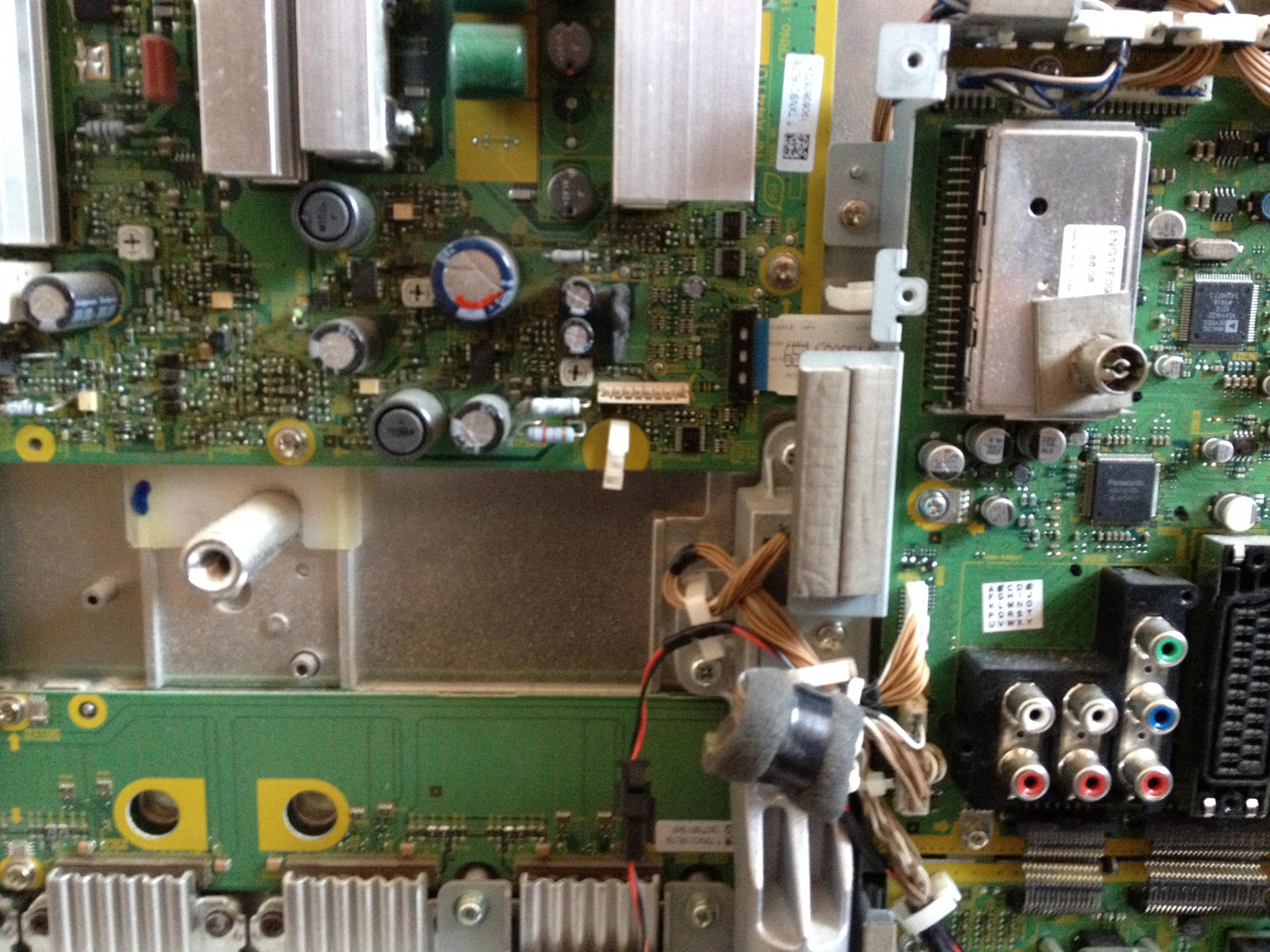

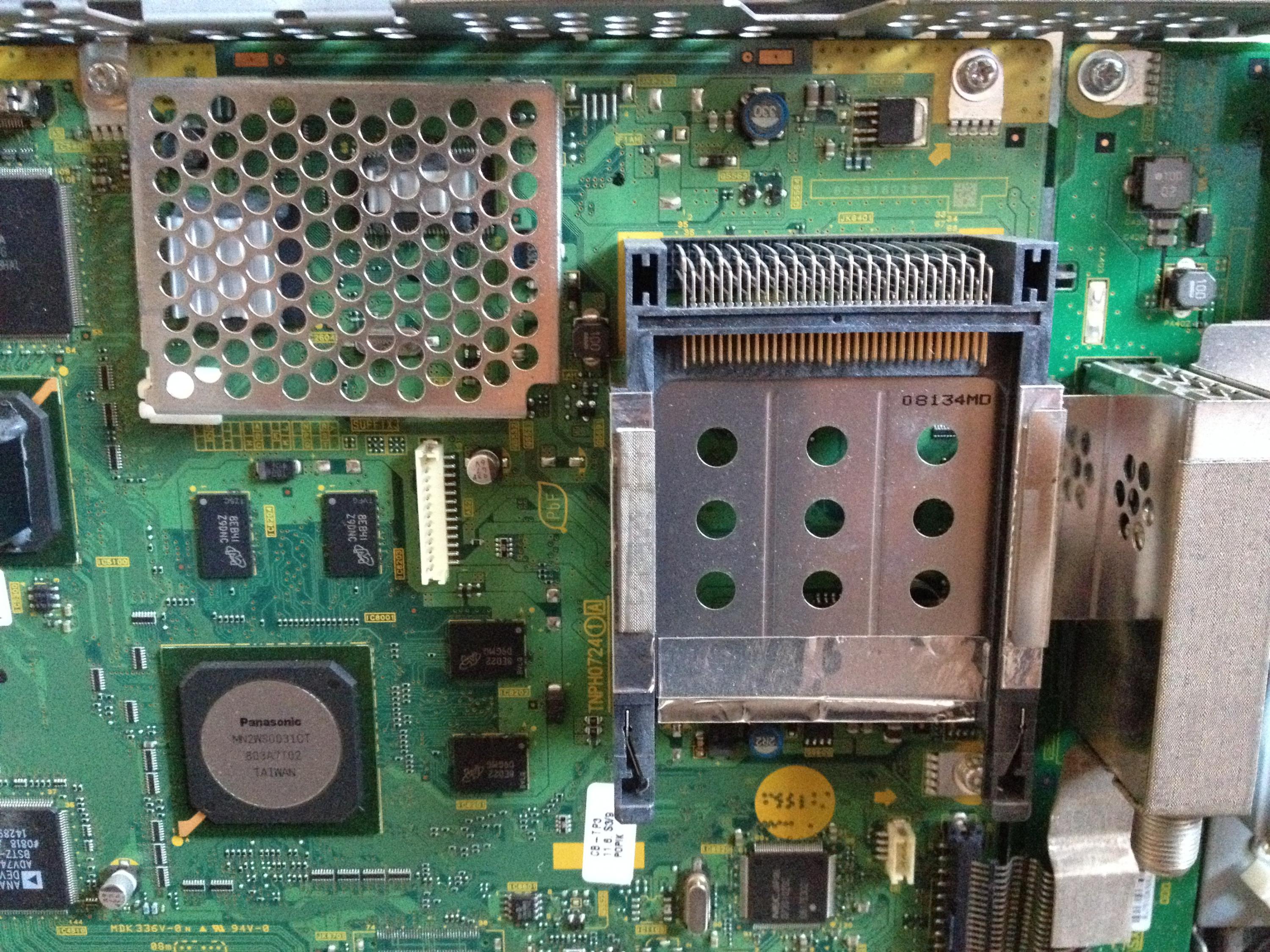

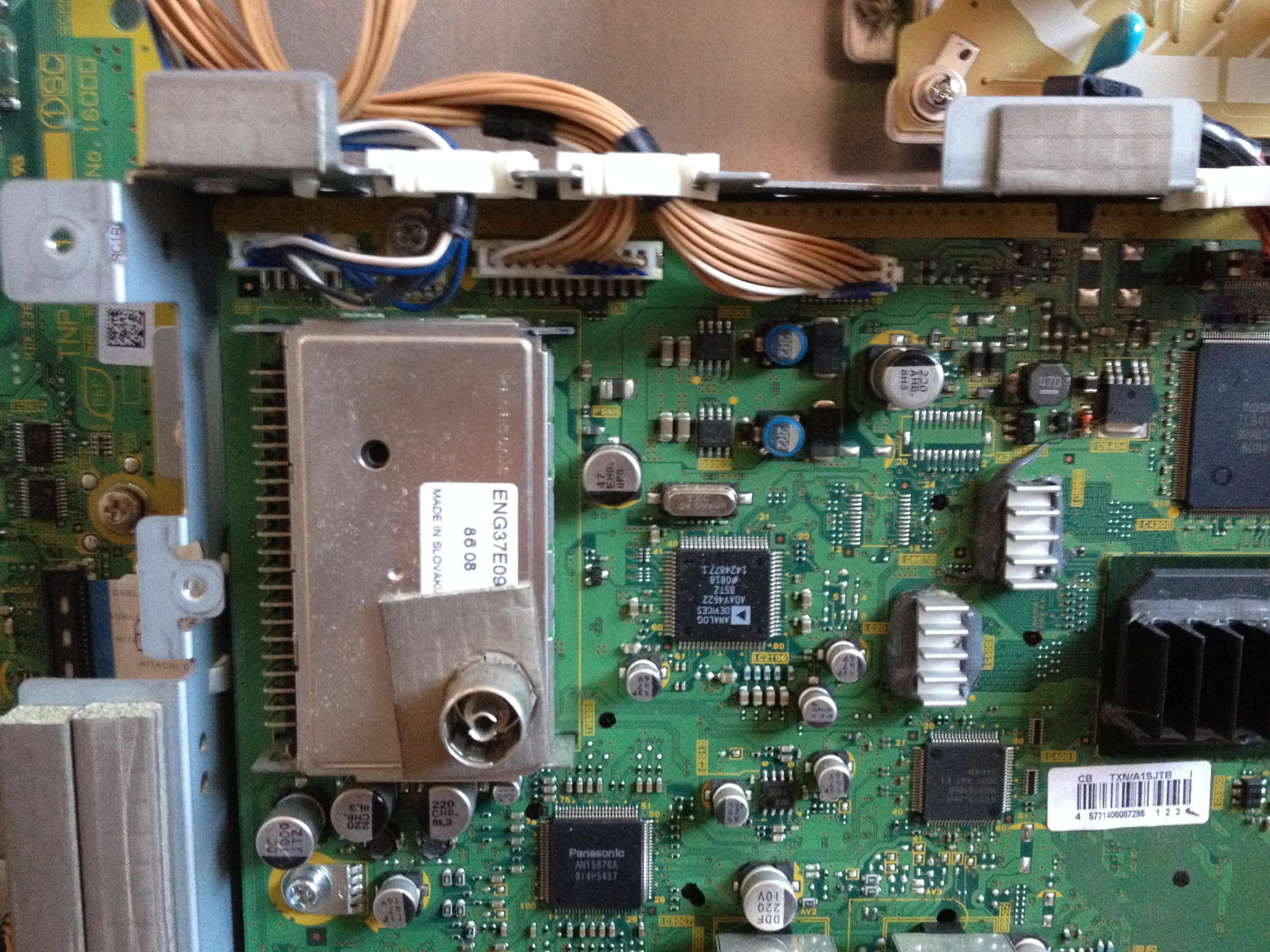

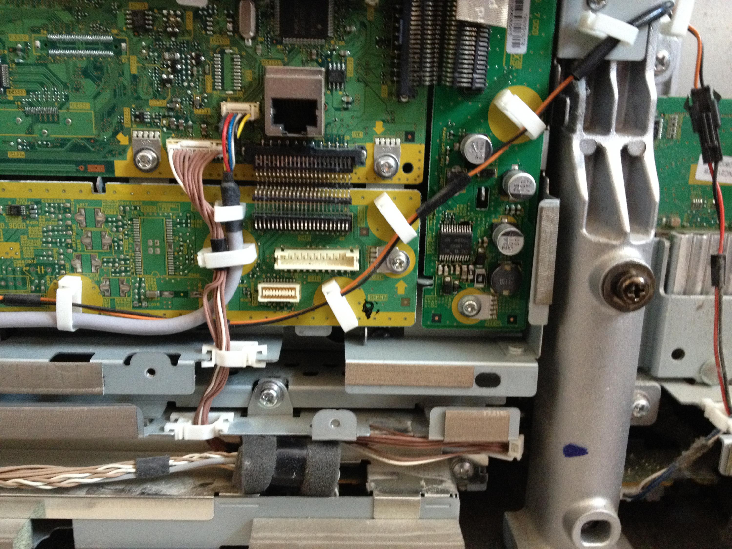

                                      Full picture of the A board and I'll take a stab at guessing location, could be wrong but worth a shot. Can't find any manual for PZ81. The main board is different because of Freesat support, but all other boards are more or less identical.
                                      • noledud
                                        • Dec 2013
                                        • 413
                                        • united kingdom
                                        thanks tom here it is
