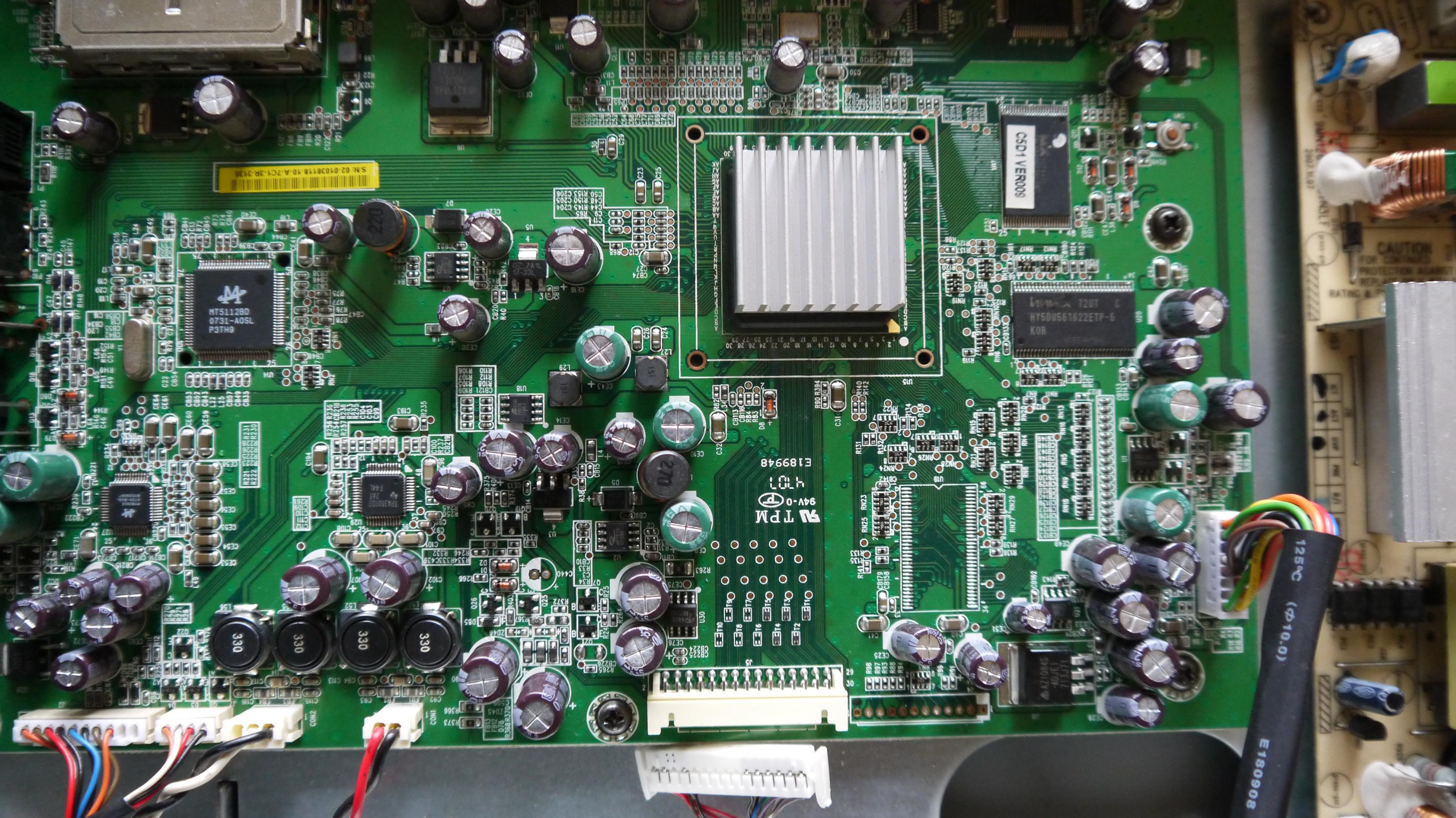

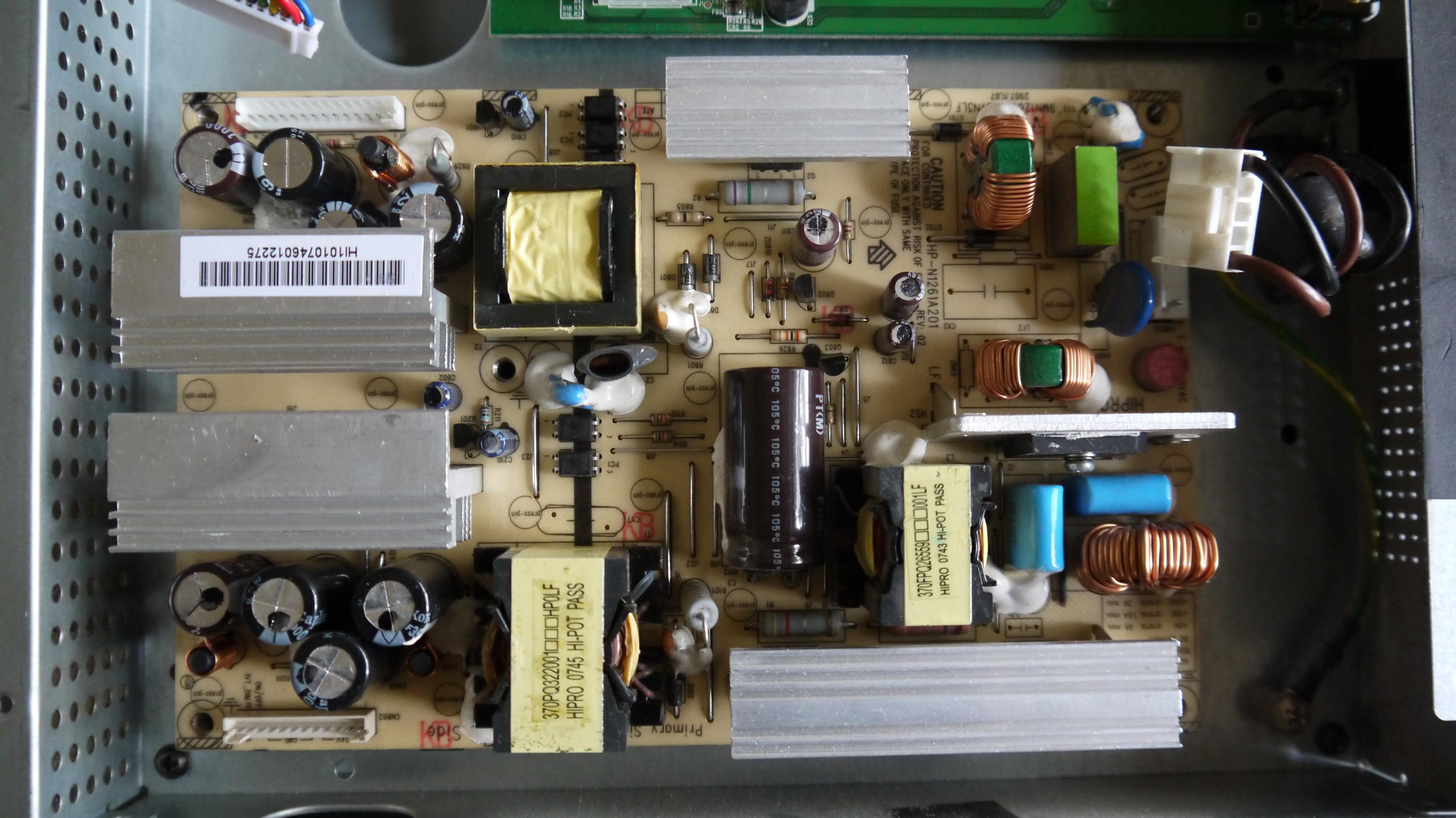

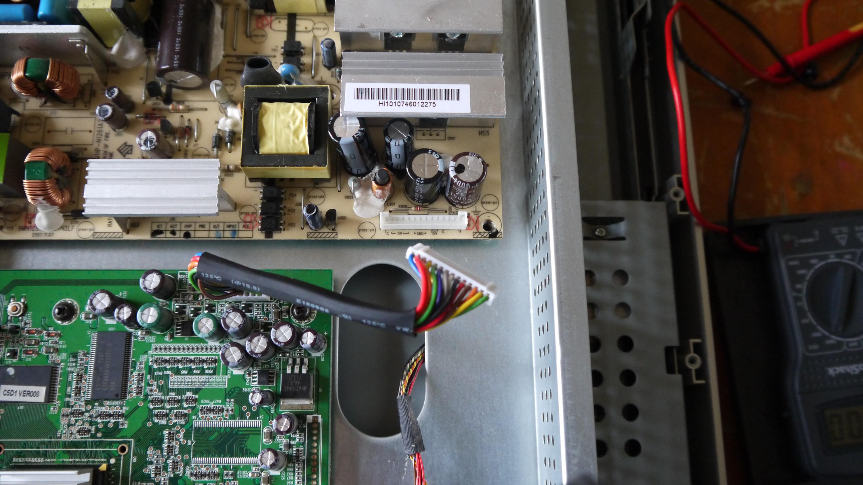

    Re: Vizio VW26LHDTV10F, No Sound, Backlight and Standby Light
    Here are some Pictures:

      You need to retest the input voltage to pin 3 of U3, U5, U6, U8, U9, U11, U33: they are way too low.

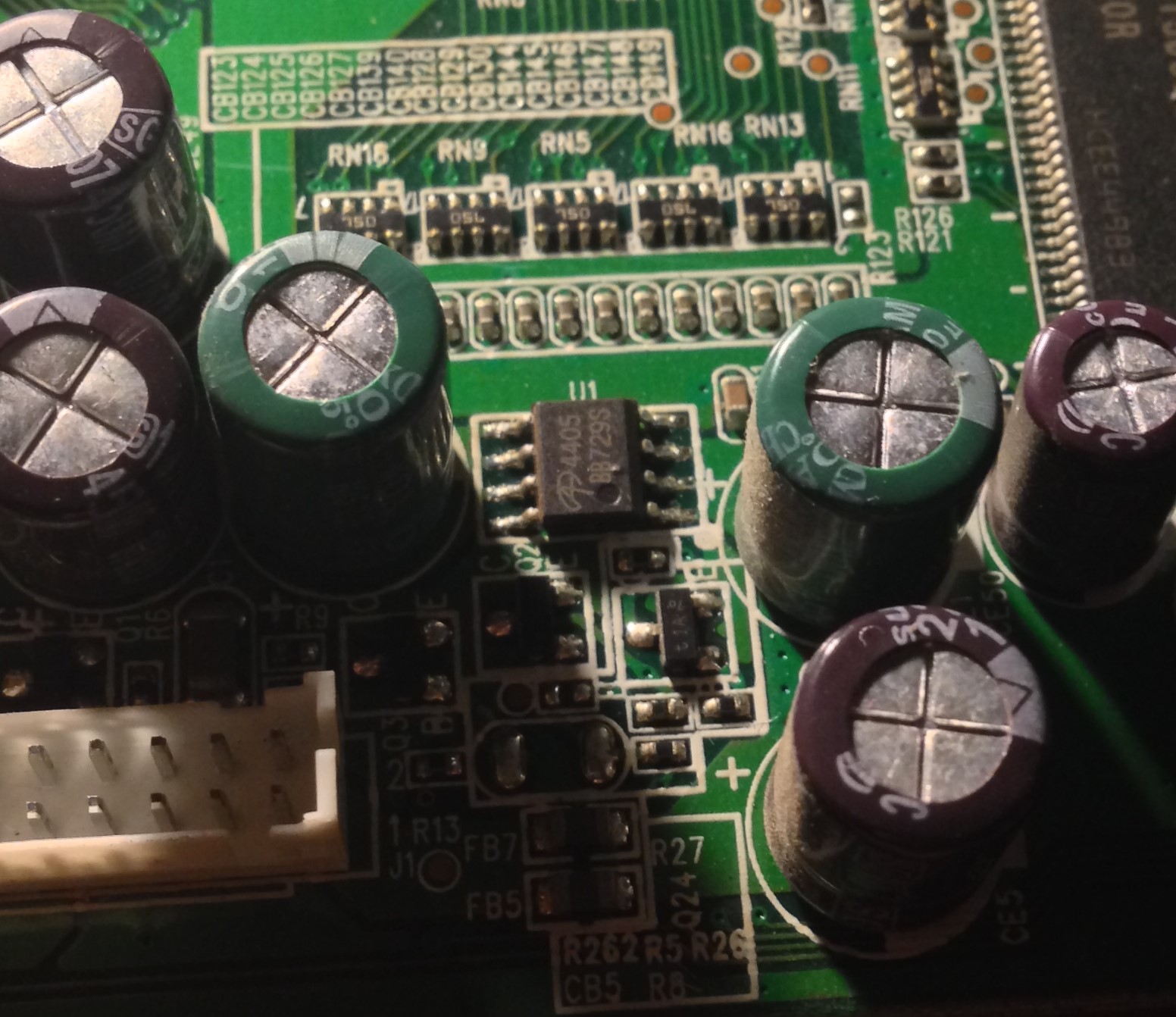

                              Oh. On the new board, an 8 prong mosfet is burnt. It is located beside the connector from the PS. The volts coming from it matches the volts going to the regulators.

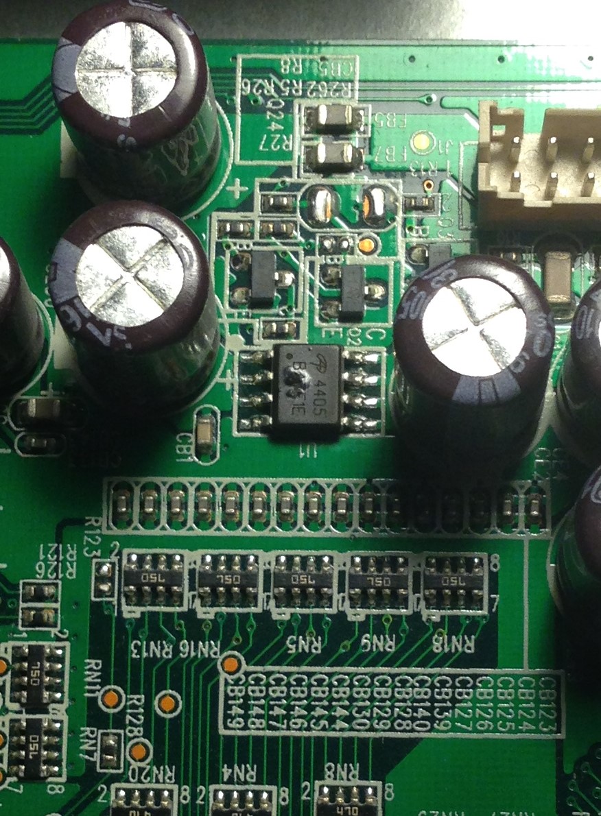

                                  Originally posted by tom66
                                  Can we see a picture of this burnt MOSFET? The seller probably didn't test the board, they rarely do.
                                  Hi tomm66, thanks for assisting.
                                  The board I bought was good when I got it. The original one had no standby light, no sound, no backlight, but when I installed the new one, I saw standby light and I got a white backlight then I smelt something burning.
                                  Upon closer inspection of the original board i notice that the same MOSFET was burnt as well. I have uploaded pictures of both.
                                  What do you think is causing the mosfet to burn up?
                                    It looks like it is being used as a switch.
