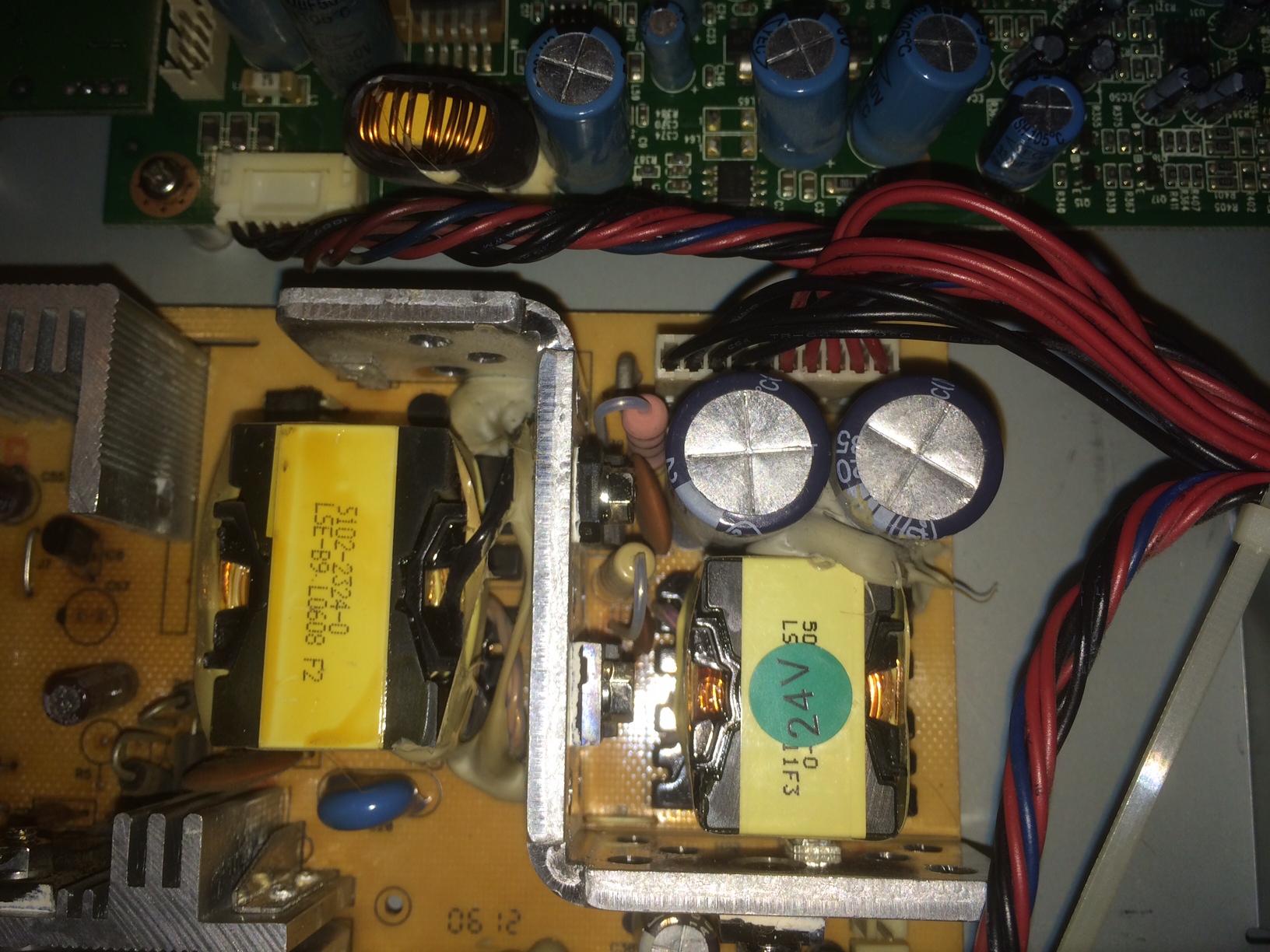

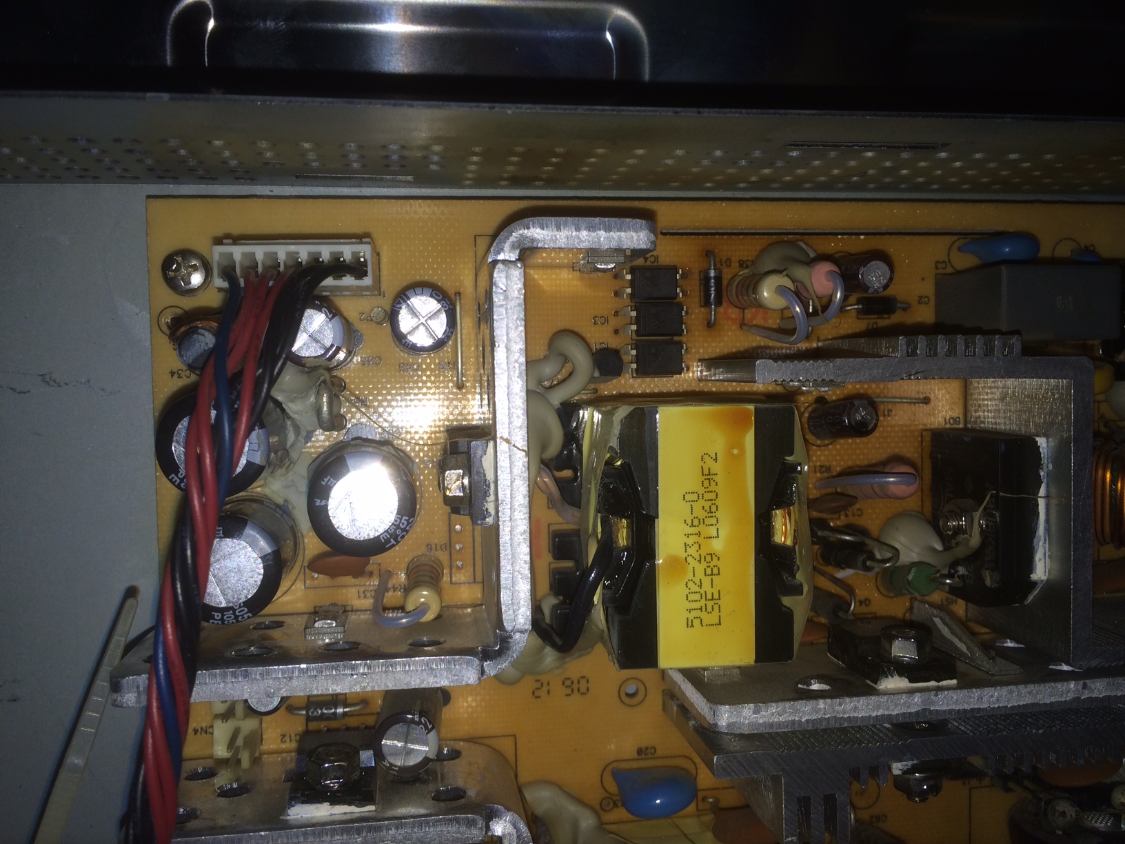

    Leave the original caps in there. Take some pictures of the guts of the TV and post them, and make some voltage measurements on the power supply and inverter.

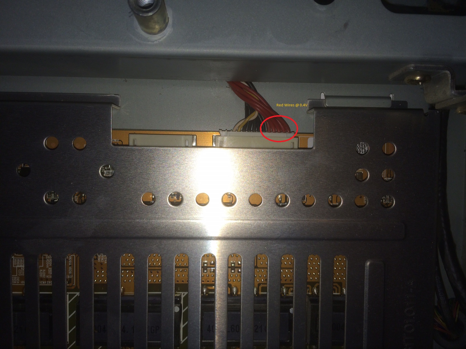

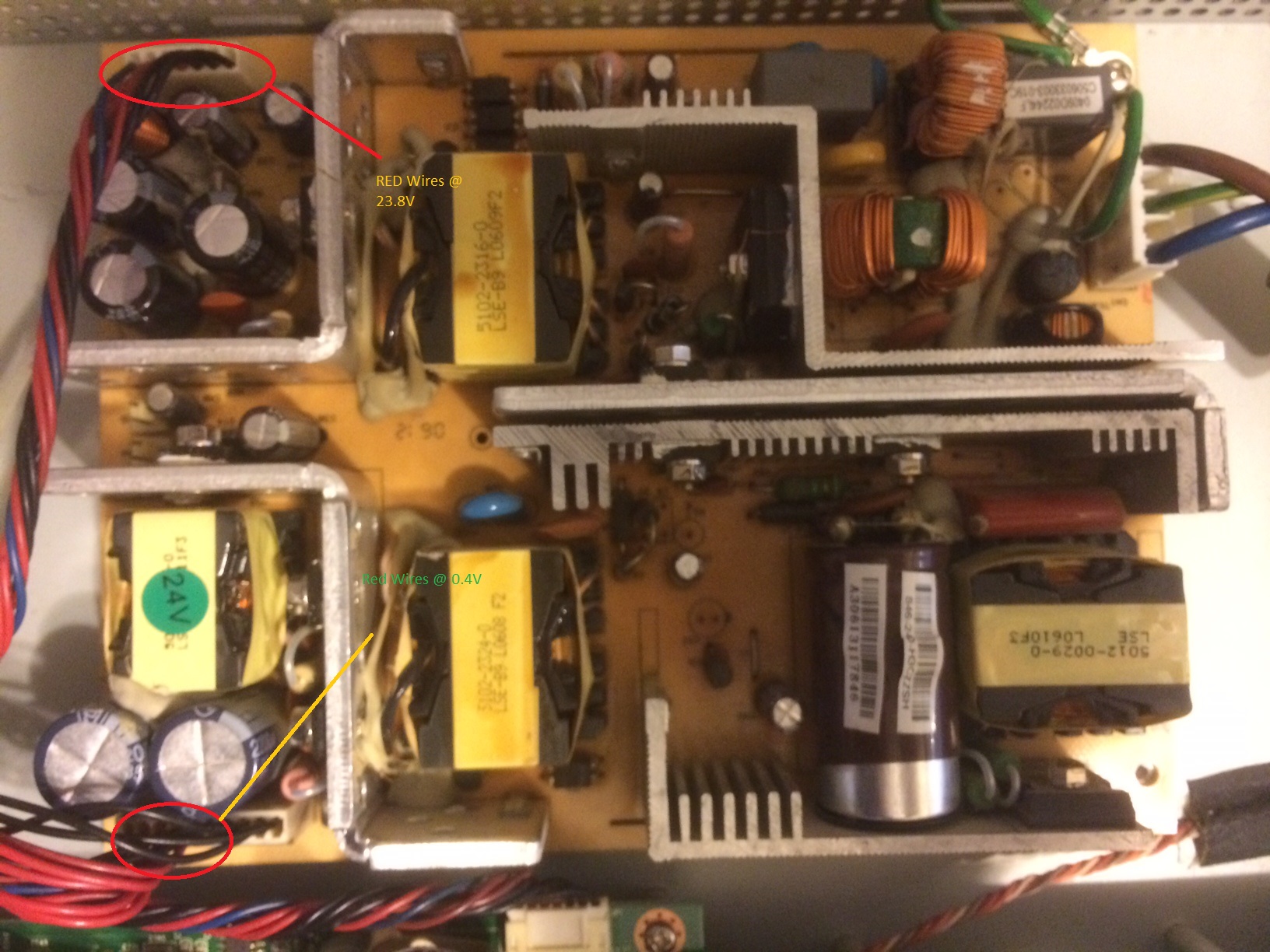

        Anyway I did some voltage checks tonight with power/blue light on. I am hearing a very faint random buzz coming from the power supply. My Z9 diode connection is solid although the solder doesn't look the best.
        I have circled and wrote values on the pictures. Values with 23.8V and 0.4V where indicated on the large photo.

          What DC voltage do you get at the TWO LEGS of the main filter, the one laying side way with the wrapping coming off half way, when TV is powered off and then powered on?
          That big cap does not look normal.

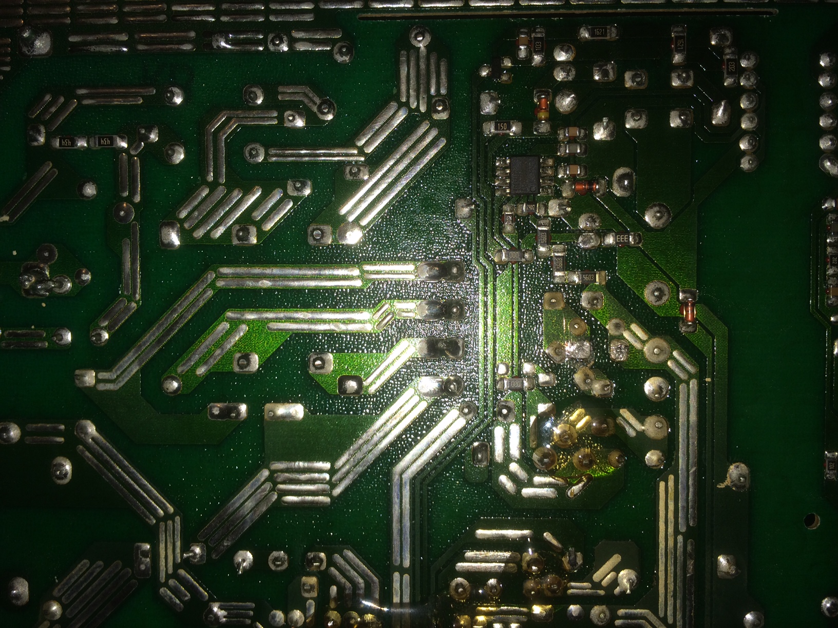

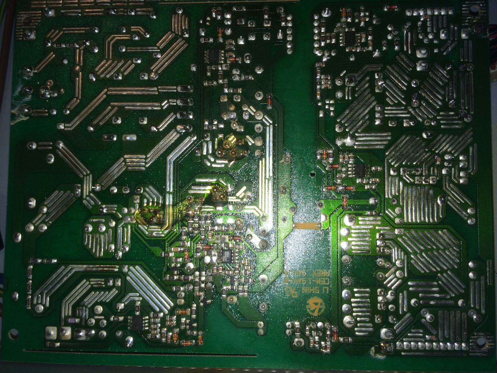

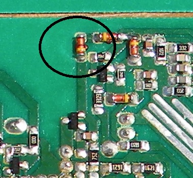

                              Ok, I had a chance to do some more testing and I found it! I've attached a photo of the cracked diode. Pushing on one side of it causes the buzzing noise to stop and backlight to remain constant so I know 100% this is the culprit.
                              Now how do I go about identifying this diode and is it possible to solder a standard small diode from Radio Shack in it's place or do I need to find an exact match?

                                What did you finally do about the diode?
                                  Re: Polaroid FLM-323B Powers on, No Picture, Only powers off with cord.
                                  Replaced it with one of these and it's working great!
                                  http://www.ebay.com/itm/BZV55-C5V6-P...item1c33f1ca9b

                                      I checked the diodes on back and the one next to the one you replaced was open. I removed it and it had cracked in two pieces. I was in a hurry and no one sells sm diodes in town so I went to radio shack and got an axial zener close to the value of the original.
