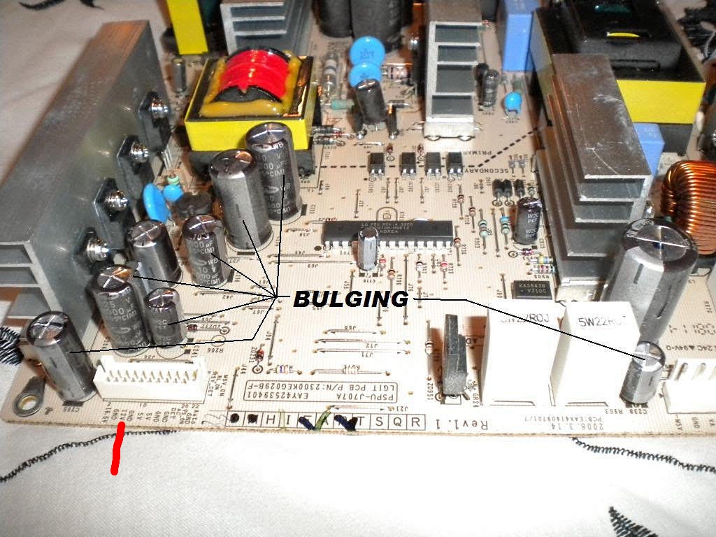

    I have replaced and or swapped out the main board the control board and brand new YSUS. Have also done the capacitor repair to all 9 capacitors and the 2 resistors.
    Problem still exist plug in get stand by orange Visio, press power Orange Vizio goes white, no picture no sound.
    Ran some voltages all within range except the 12 volt is reading 9.2 volts(red Line). Please advise new power supply or?

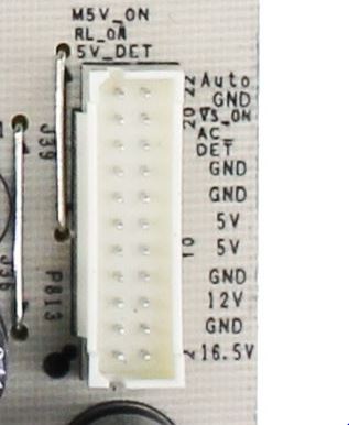

        I tried downloading a Service manual for you from two different sites but it would not save due to problem 14 reading the document but it can be veiwes. Elektrotanya.com and togohome .com Can the PS be jumpered on to stay on? There should be a Stby voltage of 5vdc. There should be a cable/connector to and from the main board to the PS.
        Check for 5vdc stby using chasis ground for black meter lead. If thats good then check if there is a PS_On command from the main board. Some sets use active high (2.4vdc and up) or active low (0 to 2.3 or so) there should be a high or low with the set plugged in then when set is turned on the PS_on should change states.
        If its low then high when turned on then jumper (500 to 1K ohm resistor) the PS from stby 5vdc to the PS_on with the main board disconnected and the PS should turn on.
        If its high then low when turned on then jumpper the PS from GND to the PS_on with a
        500 ohm resistor with the main board cable disconnected and the PS should turn on.

          Also, there's an AUTO-GEN on the control board, R241,R211 there's 2 pads . short them and then disconnect the LVDS from the main and the power connector. then we just need to jumper that to get PSU up including panel-on and hopefully screen will display test patterns. maybe LTANK knows but manual is useless that I downloaded.

          Found this where a guy had re-capped to find C801 was an issue but no clue on what his 12v line was.
          http://www.avsforum.com/t/1333136/vi...ready-replaced

            I just read this from a 2009 model but has the same 22pin connector from the psu to mainbaord and pinouts.
            It says with P813 disconnected , auto-gen pins shorted ,tv will just turn on and display.
            remove the LVDS cable , P813 and try above and see what happens.

              I don't know which is the standby pin to measure on the PSU so please point that out for me. I also don't have the resistors laying around you mentioned. Again not yet a novice but determined as a guru. Attaching picture of connector so you can help me determine which pin is for what. Also what is LVDS mentioned later? Sorry long post.

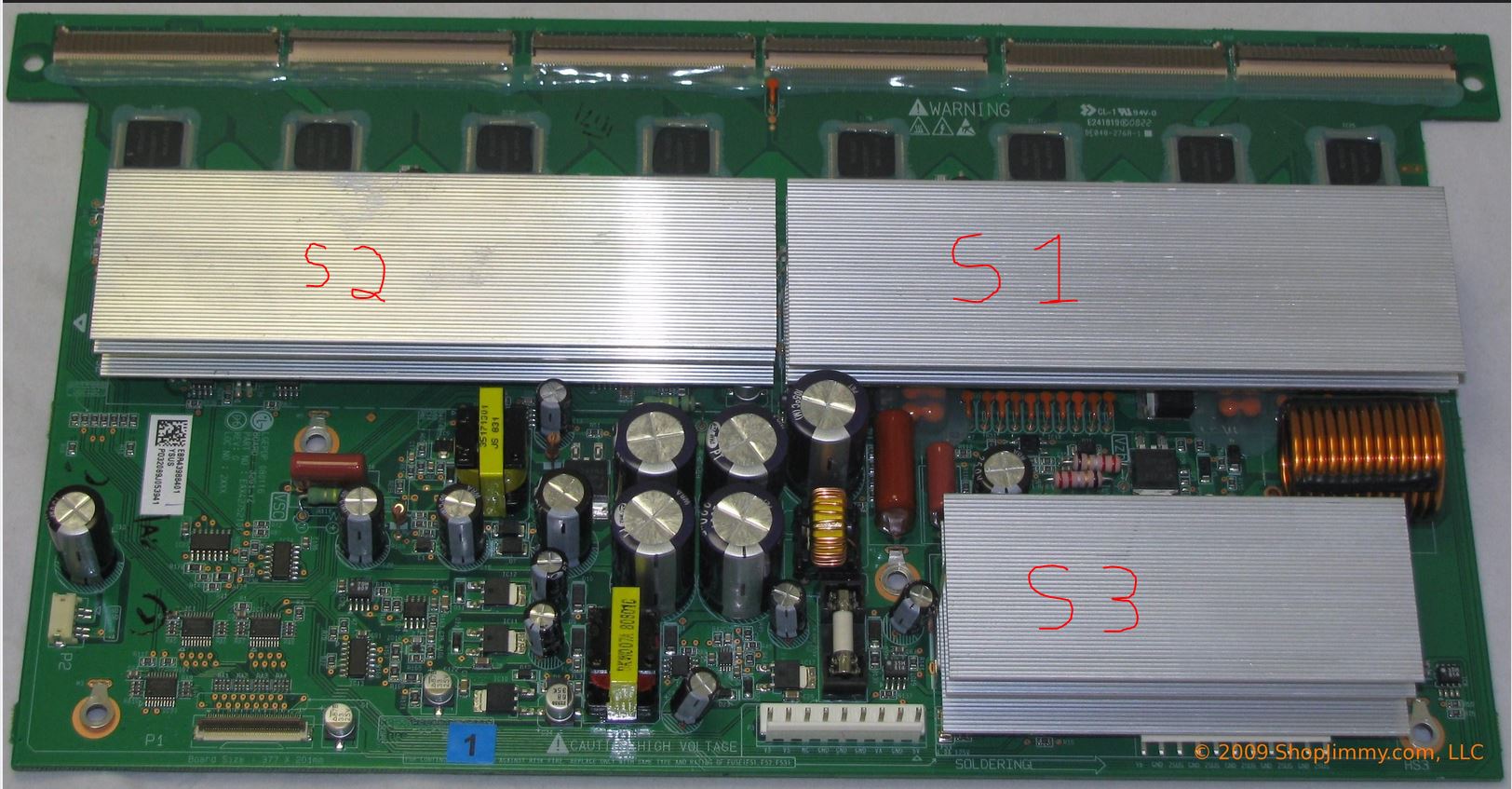

                    OK powered it up with a source no difference however I did noticed S1 on SUS board got hot to the touch and S3 was warm S2 was cold to the touch.
