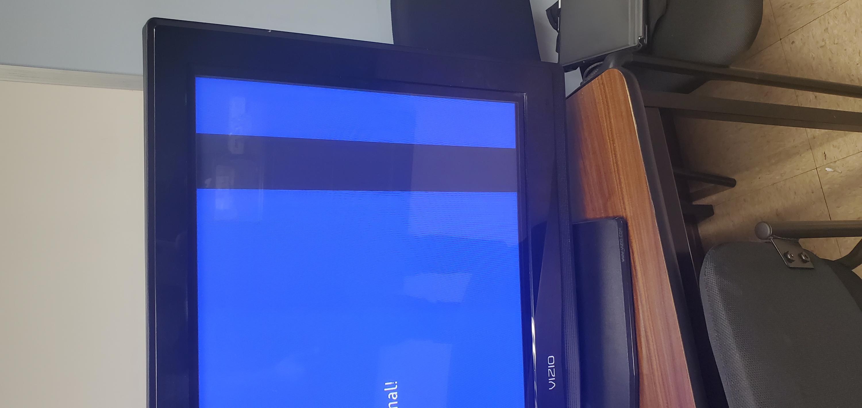

    Its been a long time since i been on here.
    Anyway i searched the model number but no threads on this issue
    I pulled this unit out of my companys electronics recycling bin
    Wouldnt turn on so after opening it up discovered 2 bad caps
    Replaced the 2 caps harvested from a different psu which where the same brand and rating .
    I only did this to determine if the unit would power up which it did.
    it has a vertical black bar and I dont recall if the issue is due to a bad tab bond or a faulty chip.
    Is this repairable or should i just use it as is?

    Re: Visio VP322 vertical black bar
    Press hard around the bezels where the tab bonds are, or open up the tv and press at the tab bonds directly. If it is the tab bonds shim it with something like thermal conductive pad.
