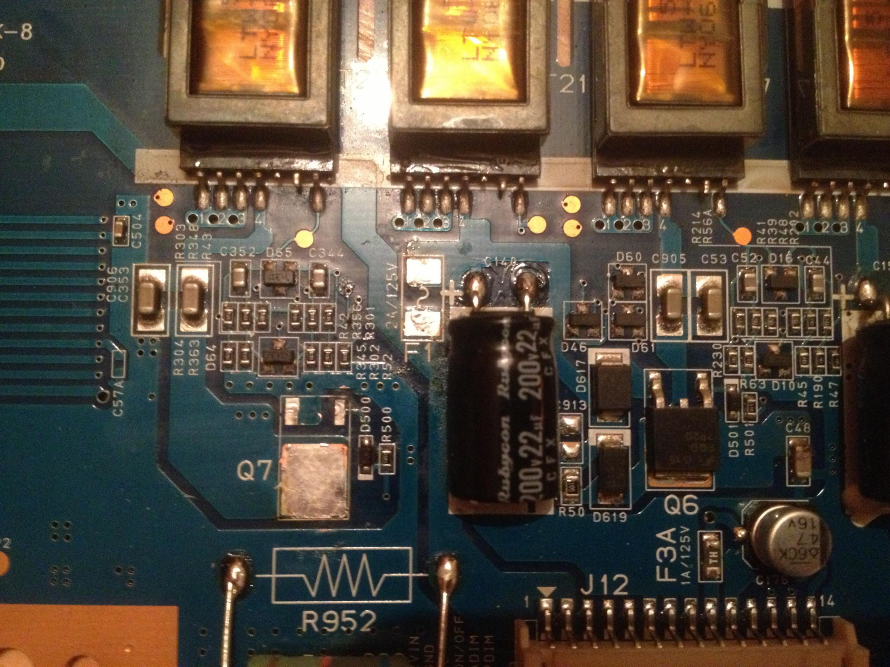

    I have a LE46M51B with bad inverter board 120V46W2B rev 13. I have done some checking with my DMM, and have found a few shorted components. My problem is, I do not know what the part numbers are for some of them.

        I will take some pictures tonight when I get home, I should have done that the first time. I have removed some of the components, but I've left the ones I need identified.
        Dudm, yes that's the board. One fuse blown, a rectifier, a few diodes, and a resistor, if I remember right. It is actually one of the diodes that doesn't seem to have anything written on it. I will take a pic, and try to point out the components that seem to have shorted.

          Ok, here is a close up of the part I'm working on. As you can see, I've removed the rectifier at Q7, and the fuse at F1 as these are blown. There are other diodes blown too, the one at D619 is shorted. I have replacements for these, but the one I don't know the value of, is the little diode at D500.
            Re: Samsung LE46M51B bad inverter board
            That is the Gate discharge Diode which is connected in parallel with gate drive resistor. The damage like that can mean the PWM IC outputs may be damaged as well, you can use IN914 in its place.

              The resister is also blown. I did a quick search for the IN194, which you suggested. Can't seem to find any in the UK. Farnell UK have them, but there minimum order is 10, plus shipping.
                Sorry, 1N914.
