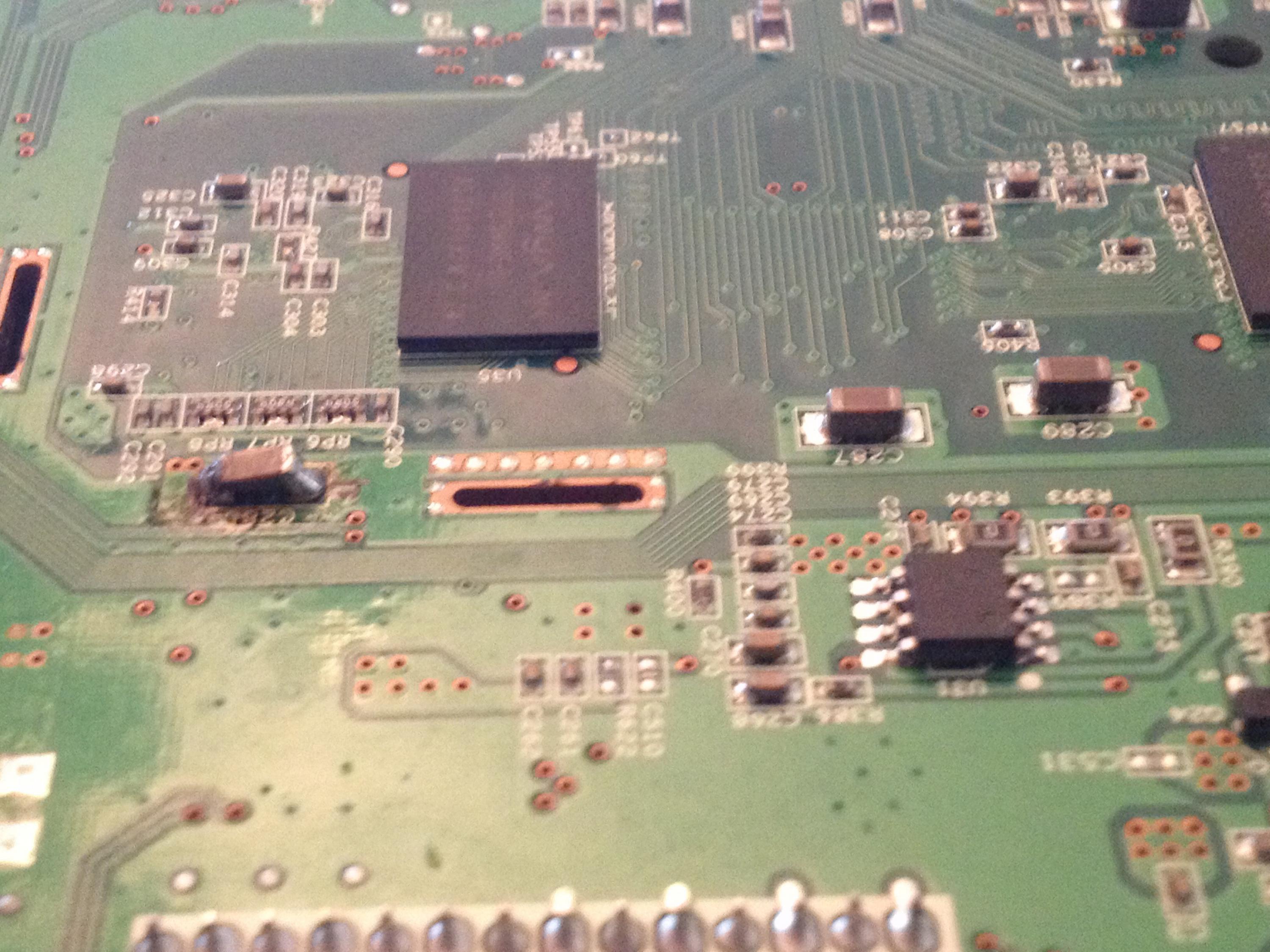

            Yea it still didn't fix the problem. I'm almost completely exhausted on this tv. I checked all fuses for voltage. All caps good. All points on power board getting correct voltage. I have no idea where to go one this one. The heat shield on the main board still gets kinda warm. Not so warm it burns but enough to notice. The tv is a m550nv vizio that when plugged it logo flashes for a while then goes to stand by. U turn it on and the backlight turns on but no picture on screen. If u hit the power button to turn on menu the screen dims but no image.

                No I don't. Left it in my other spy bag. Lol jk. But originally I had to replace a melted capacitor that was underneath side of the main board next to where the heat shield would be.

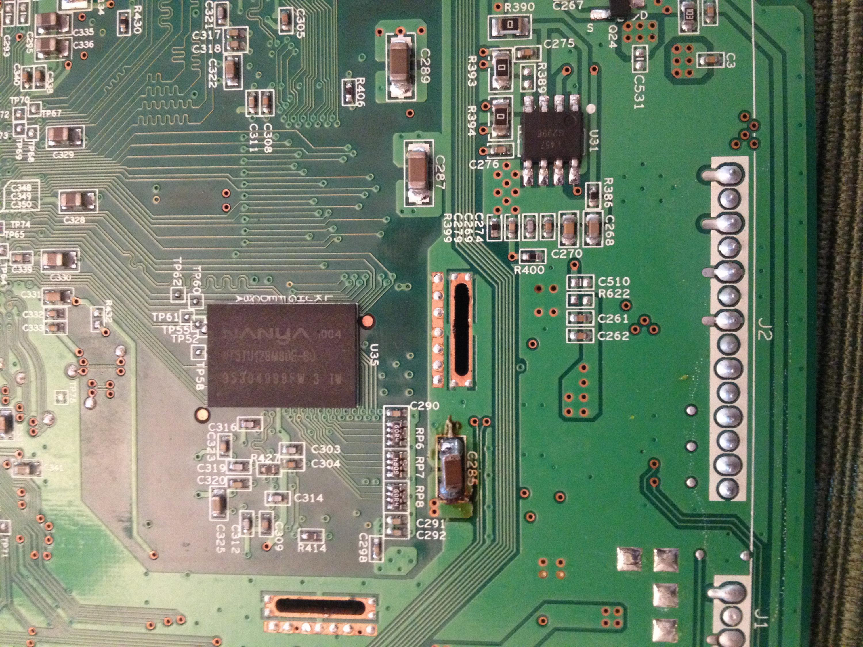

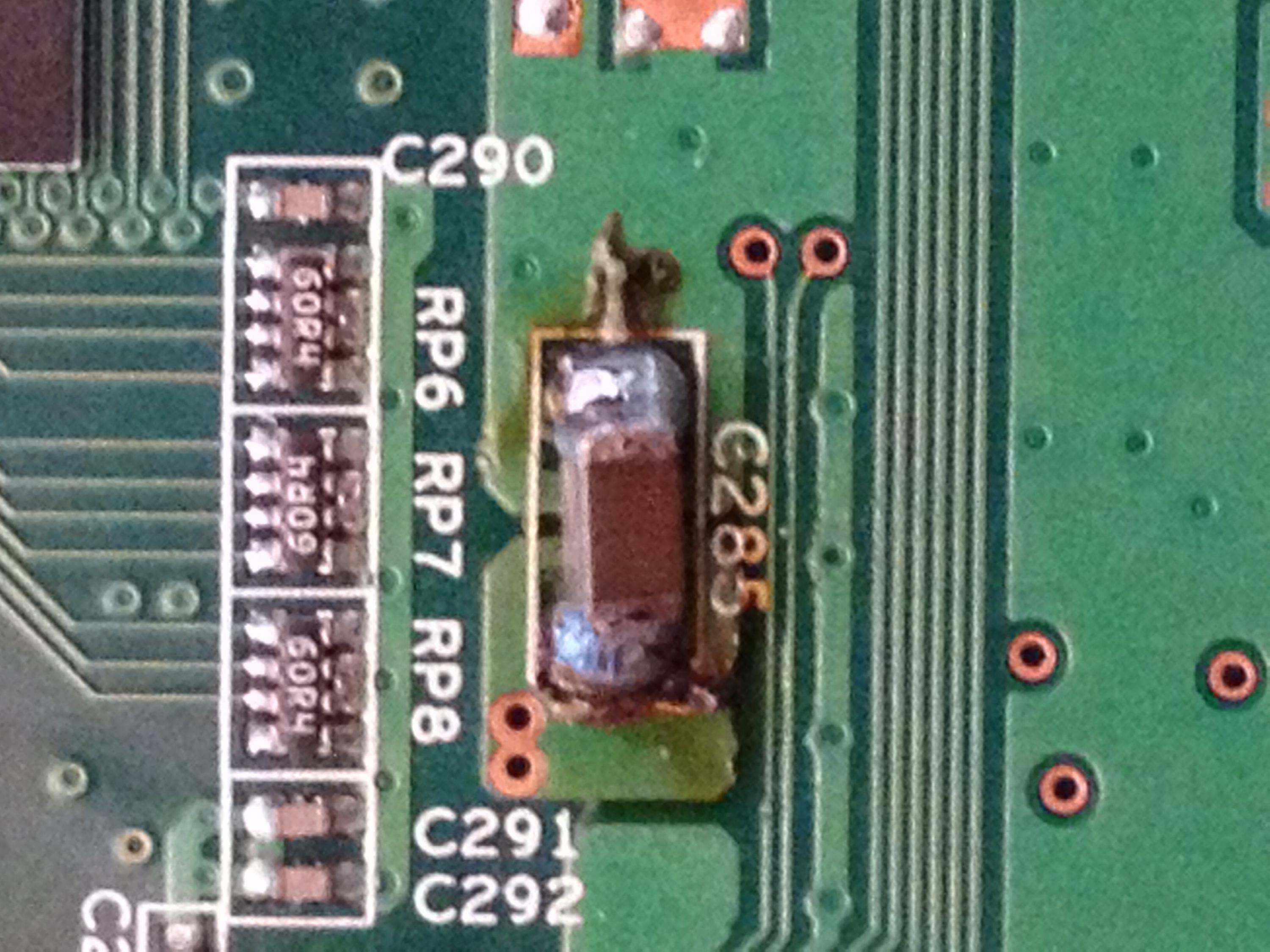

                      Can you post a pic of the region where u said you replaced a melted cap?

                        K
                          Re: Smd fuse replacement
                          Here's another
                            This was before I replaced the smd cap
                              So somebody already tried to repair the set before you did?
                              It doesn't look "melted". Was it shorted? What is it connected to? VCC GND etc?

                                I don't know what it was connected to but the last picture showed the plastic part melted down. So I replaced it but did a real bad solder job.
                                  The cap on the last picture has very likely not been mounted like this in factory. Somebody replaced it already. Was it shorted?
                                  You can determine what it is connected to when you follow the traces back to the power supply. I assume it to be on GND on one side and on 3V3 or %V on the other side.

                                    I wasn't sure. I don't have the board infront of me right now. Before I replaced the cap the tv wouldn't even power on or have the logo light up. And after I replaced it it will turn on but no image.
                                      Measure the voltage on that cap. Multimeter first DC, then AC. Post the results.
                                      If possible get a scope borrowed from someone.
