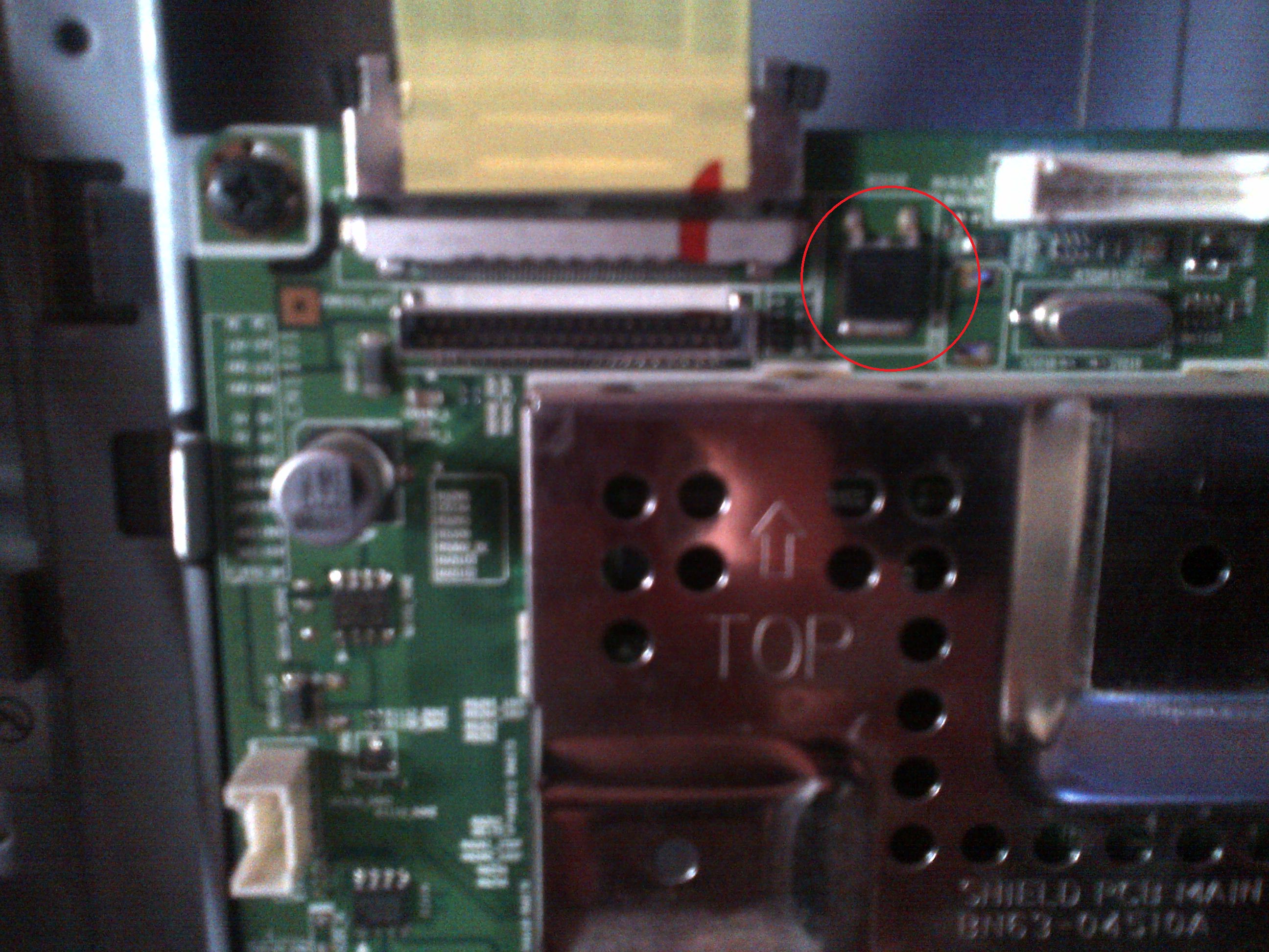

    hi guys got another one of samsungs tvs here with yet another fault. the tv switches on etc so do the backlights, but is not displaying any picture whatsoever has anyone else had same problem with this tv as a google search turned up no results at all...

    Re: No Picture on Samsung LE46A55P4f
    Have you checked the fuse on the tcon?
      no i will check just now and post result.
        with multimeter on 20v one way reads -0.01v and other reads 0.02v
          So there is no 12V on either end of the fuse on the T-CON then, the main board supplies the 12V through a switched MOSFET close to the pin on the LVDS cable that supplies the voltage.
            is it the thing i have circled ? am i better off replacing this then ?.
              It could be that, or any number of devices..
              What is correct model # as there needs to be an additional digit after "55".
                sorry Tom66 its LE46A559P4F
                  Can you post well focused picture of that section again? see post 6.
                  You can check the resistance between the fuse on the T-CON board to one of the 3 pins of that device, one of the 3 pins should have less than one Ohm reading if it is the switched MOSFET for the B+ feeding the T-CON board.
                      Tom66 i am getting sound. also when i switch it to that channel its as if there is trying to display on screen but just see lines streaming from top and dimming further down screen
                        When you get those lines check the tcon voltages.
                            Tom66 made this short video for you to see, i also have a 32" toshiba displaying same content which i have quickly shown..
                              Tom66 how do i check the T-Con voltages
                                The fuse voltage.
                                Looks to me like you were not testing fuse voltage correct - that looks like (another) bad panel to me. You can't get that with zero voltage at the T-con board. Small chance of tab bonds fault.
                                You can try checking VGH/VGL or VONE/VOFFE voltages, but for that, a pic of T-con is necessary.
                                  tom camera is shit. the board installed is T460HW02 V0 CTRL BD
                                    Don't wish to sound rude but if you fix a lot of TVs buy a decent camera. I bought a Samsung PL120 at a CeX for £45.00; it takes excellent macro stills for a compact. Good lighting and use of sunlight can help too. I'm also impressed with how good the camera is on my old-generation smartphone, a Galaxy S2.
                                    Problem with online board photos is we can't spot obvious faults (burn components/cold joints - selldoor is excellent at this) or there are minor differences between boards/layouts/components.
