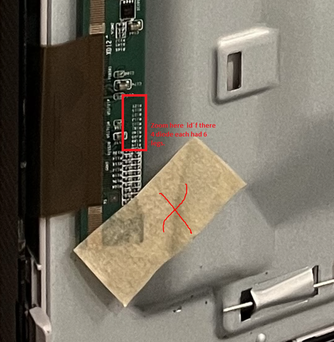

        Used with HDMI, we hade it at work for screen mirror from PC some times, max 10 hours of use...
        This is what I've done: disconnected the TV, removed the back panel, disconnected the motherboard from the power cord, it does NOT reboot.
        Reconnect the motherboard, it reboots. Disconnect the flat cable from motherboard, it doesn't reboot. Sound is present the whole time.
          This indicates that the panel is faulty.

                  Yes, they are, but I need photos of them in their entirety, especially the ends of the left and right strips.

                    then you have on the right side ( when you look from the back) at the end of panel puffer boards there are 4 ESD diode.at the section remarked E8 .. one could be shorted as its protect at time the resolution came from HDMI

                          You don't understand, I don't need these trains, but a photo of this green strip in its entirety, from one end to the other, the full length, maybe a photo in pieces.
                          You can disconnect the speakers.

                            why you upload photo of yours power boards.... yours issue at the panel puffer boards which you show the u ribbon disconnected... look on the right side after you take out the speaker at the end of the boards you will be able to see pack of ESD diode.... or you have problem with language ?

                                Remove this tape and take close-up photos of these areas.

                                  nothings under the type as i member... the pack of ESD are little to left top of the right side.... each diode with 6 pins.
                                  • Diah
                                    • Feb 2013
                                    • 6647
                                    #37
                                    zoom here.. i thing here are the 4 ESD
                                      Yes, I don’t like the look under the tape, as if there was corrosion there from the glue.
                                        exactly... its paper type... not chassis type,,, it may make short too,,, so he need to take them out from both side

                                          Can't remove the tape?
                                          Yes, here I think for a long time...
