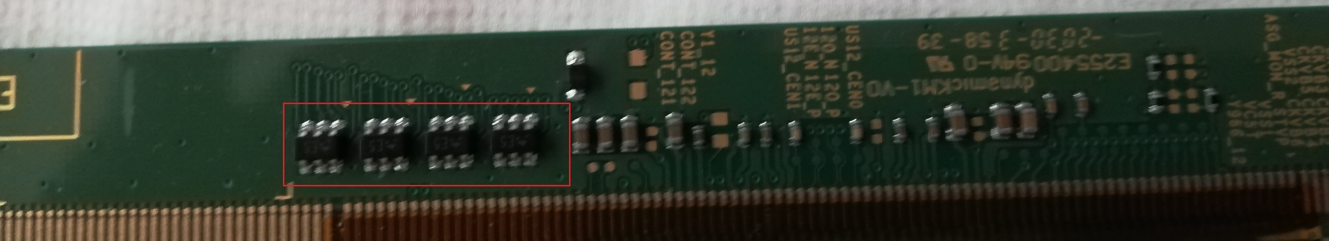

      Originally posted by lotas
      Remove this tape and take close-up photos of these areas.

        #43
        OOPS... different Panel !!
        if you just disconnected the U ribbon at the middle of the boards... did the TV work and display 3/$ picture ? need to test from both side a time.... if yes you have working TV with 3/$ screen.. then
        look on the whole boards of both side if you can see such this in PHOTO
          When dissconecting left one, (from behind tv), 2/3 screen is working. See picture. No boot loops
          when dissconecting right one, whole picture is bad, no boot loops.
          only found 3 of those, not together but separated.
          One / panel.

            #45
            Try to mask this area on the cable, on the side where the fault is...
              One / panel.
              so when you disconnect the left side ( looking from back TV ) you have part in white color and the reset good picture... correct?
              and when you disconnect the right U ribbon you have complete bad picture no reboot correct?
              show please photo for complete screen display at time you disconnect the right U ribbon.
              BTW. at first i wrote to you about doing hard reset from service menu... you can by disconnect any left or right U ribbon to put the TV in Standby and from Standby call the service menu...
              i still don't think you have issue on panel... but the T-CON on the mainboards cause the reboot... so let rest the TV as hard reset first.. go back to fist page at this threat and read they write to you also how to log in service menu when the TV in standby state.
                It didn’t work. I started with all the pins masked as you marked, but I only got a bad, black picture. Then I cut the tape smaller and smaller until it was half of your mark and tried moving it left within the marking, but the result was the same as before.
                  That's correct. Here are the pictures—note that the TV is upside down now. I'm slowly giving up on this TV.
                  I accessed the the service menu, but I don't have enough time to find where to reset because it keeps rebooting. Can you give me a hint on which menu I should follow to reach the reset button? If I leave the TV off for a while, I get a bit more time before it reboots.
