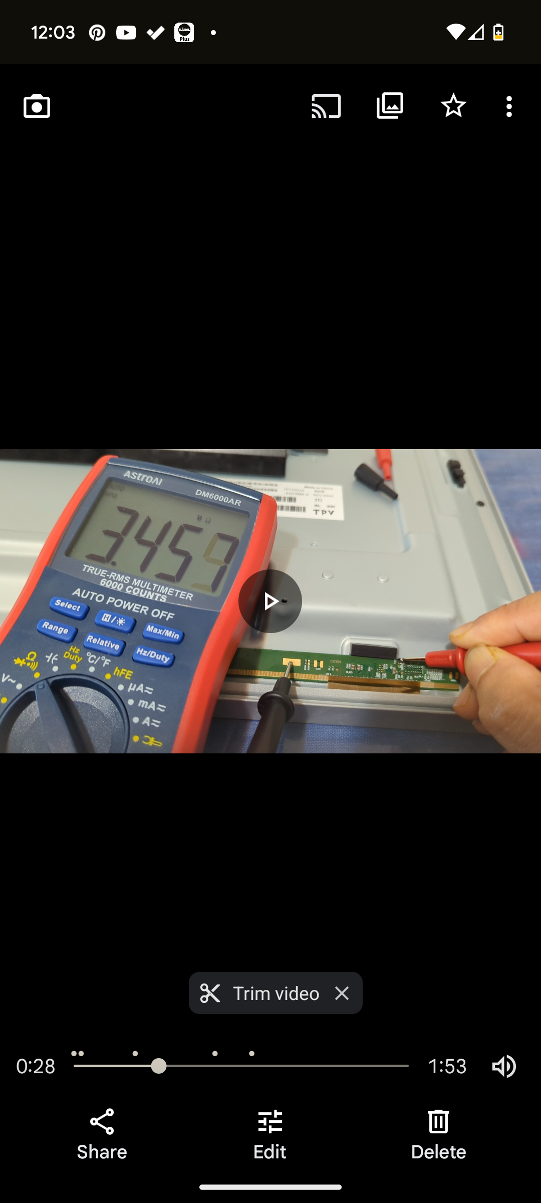

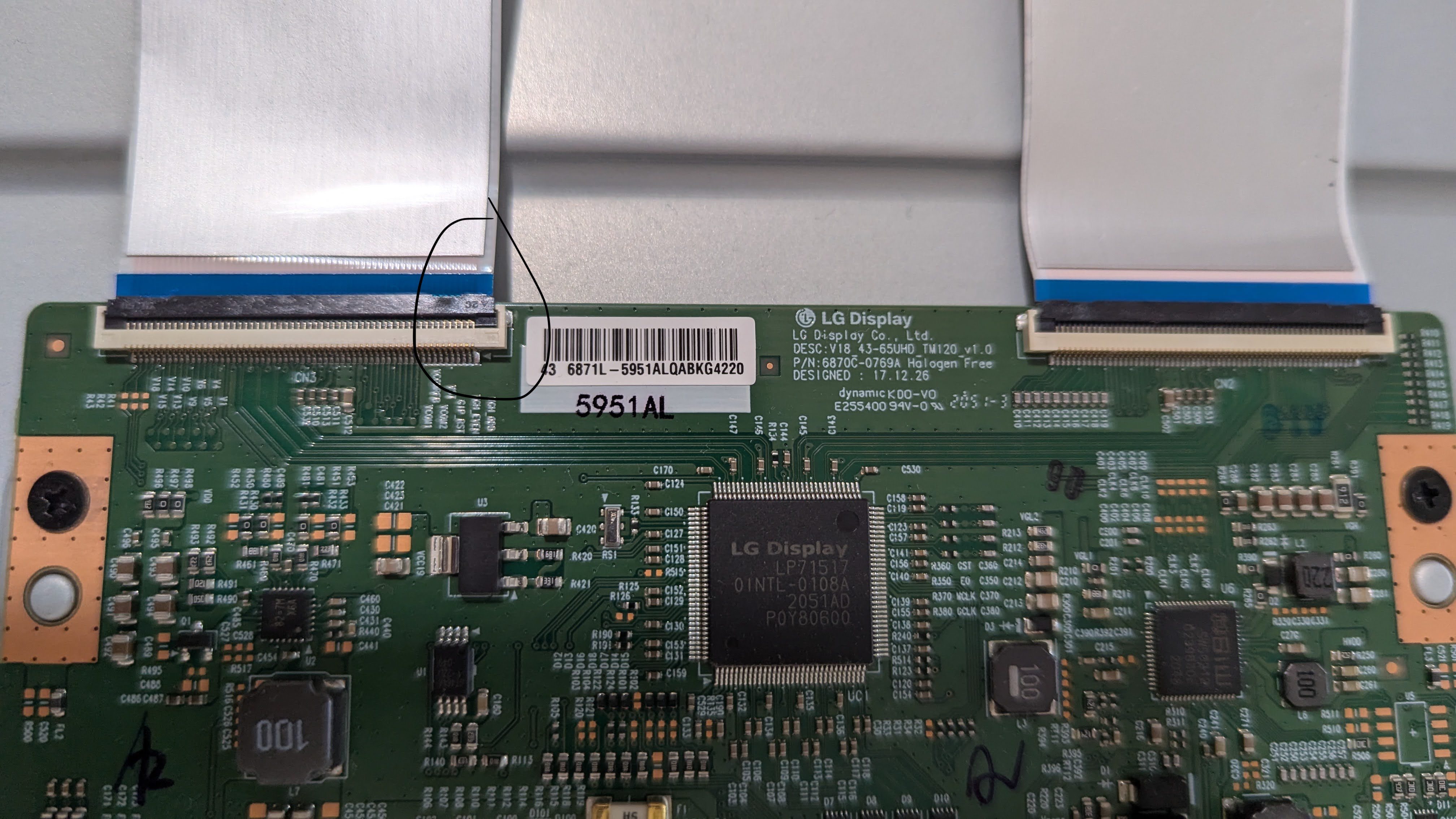

Philips 43PUS8550 no image, backlight working
  • lotas
    • Jan 2016
    • 4802
    • Russia
    Compare with the working bar, it should be approximately the same.
    • pseudorc
      • Sep 2024
      • 12
      • United Kingdom
      Checked against bar and gnd, around 3.2 on both end of the resistor but in between the both end its 0
      Is that supposed to happen?

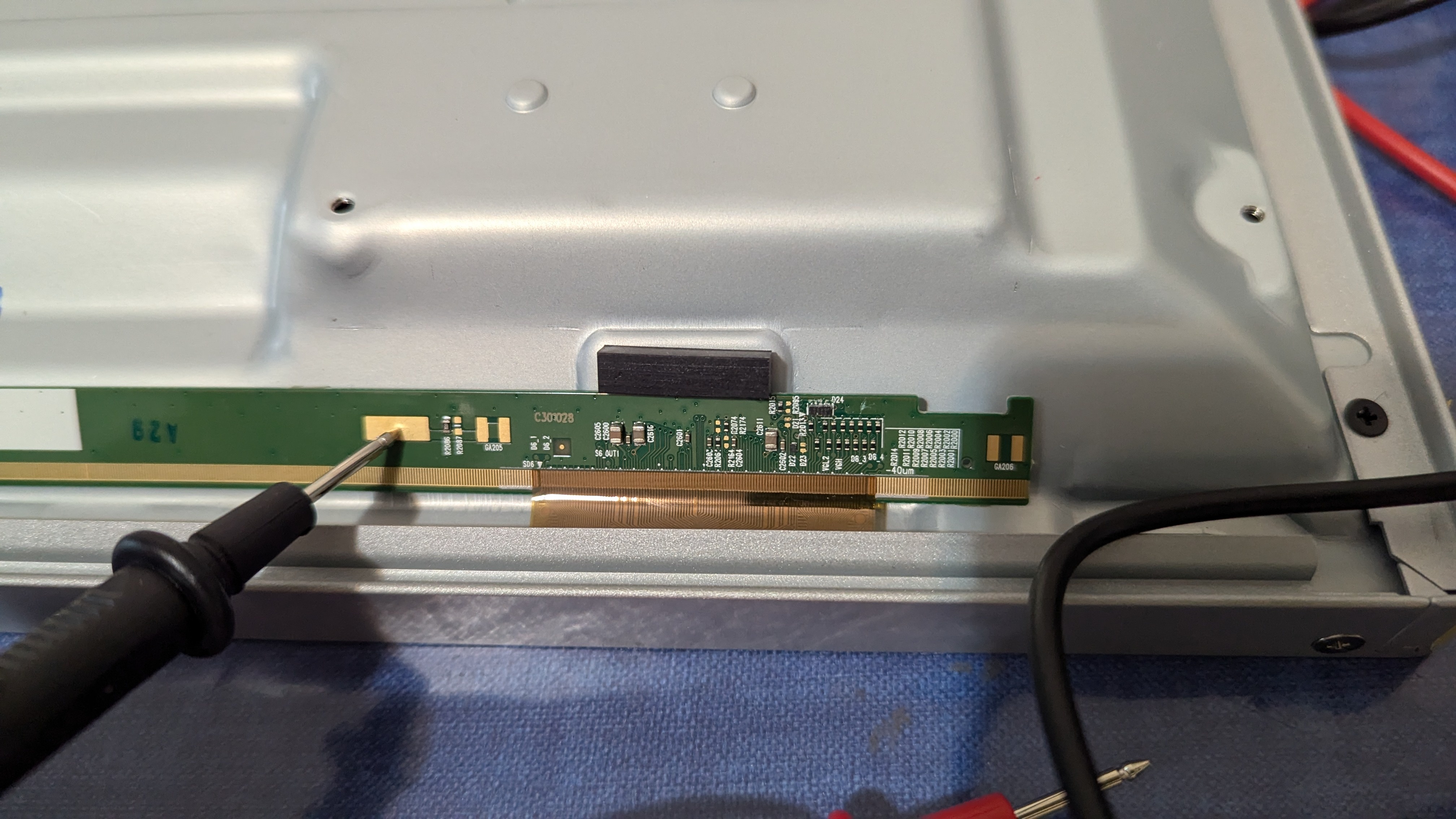

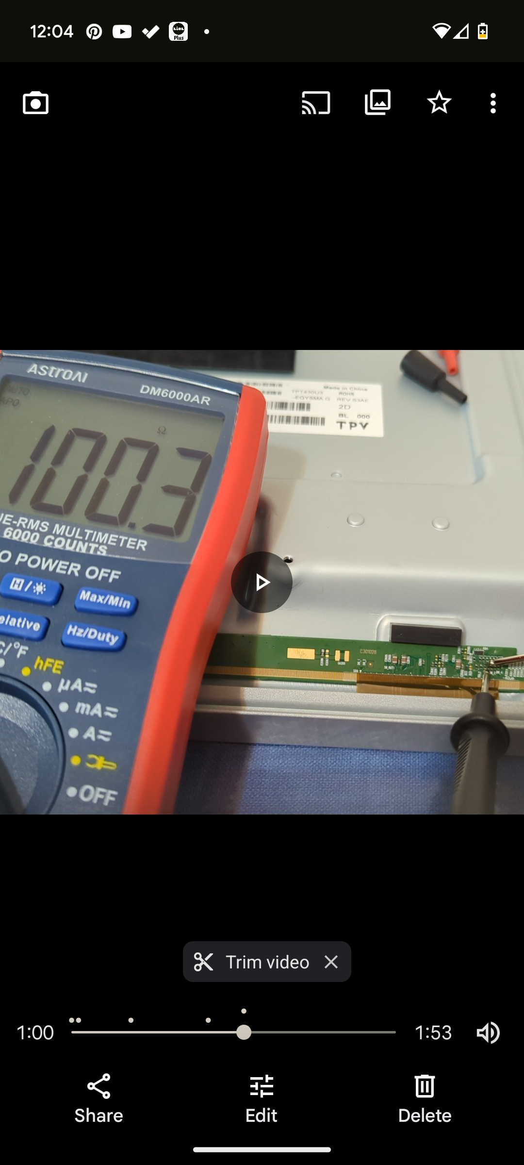

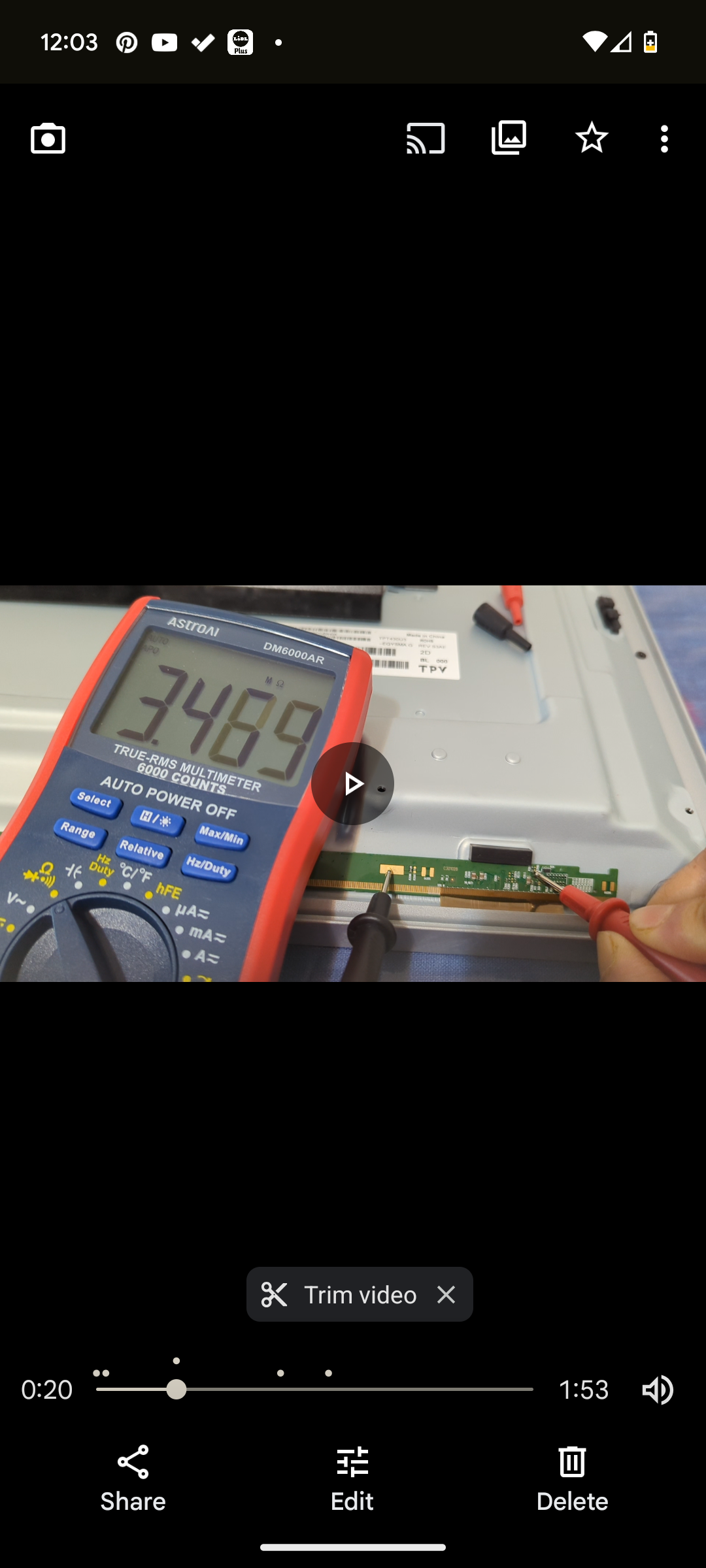

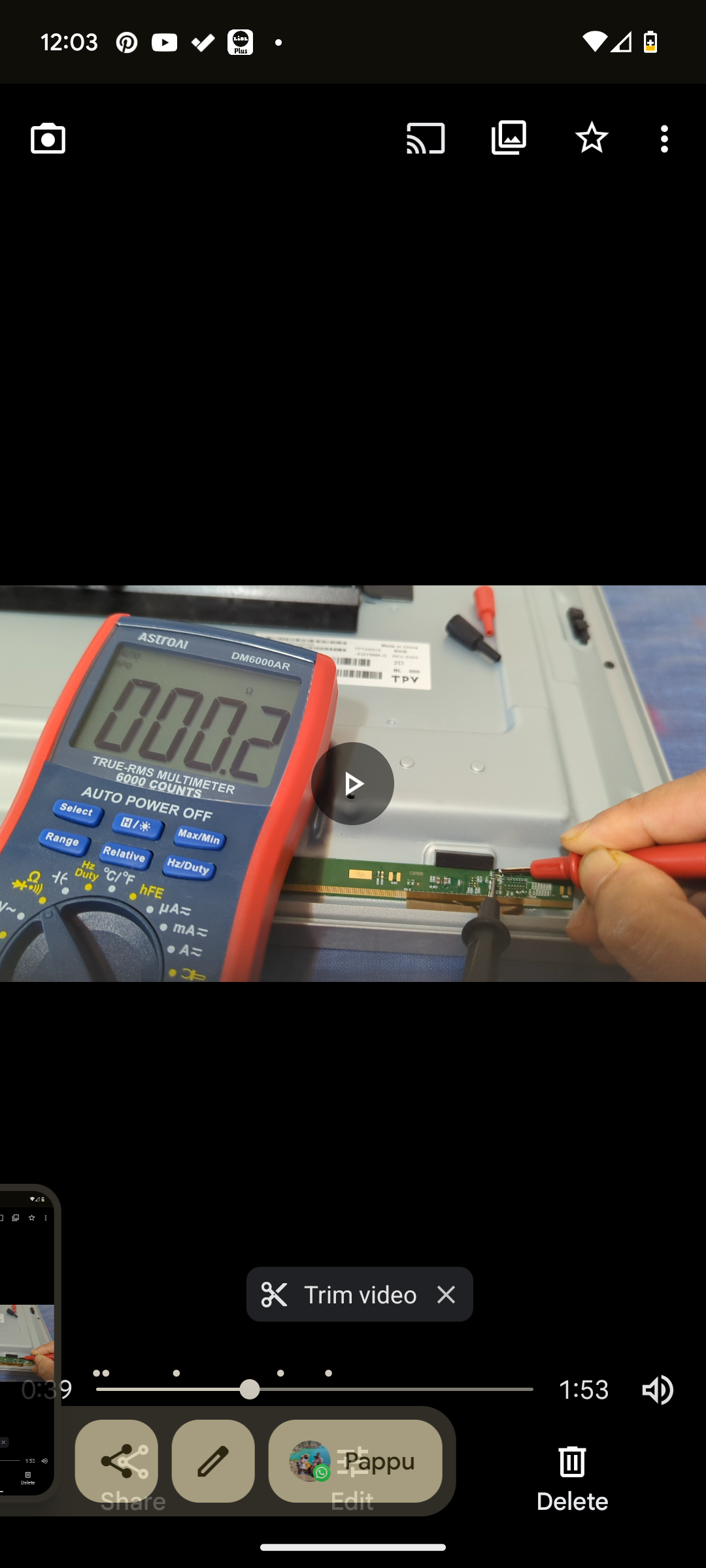

        Here are some pics of what i was measuring

          You measure relative to the ground, that contact goes through a resistor...
          I don’t have such a panel at the moment and I can’t measure how it should be, you have a working bar on the other side and compare the readings with it.

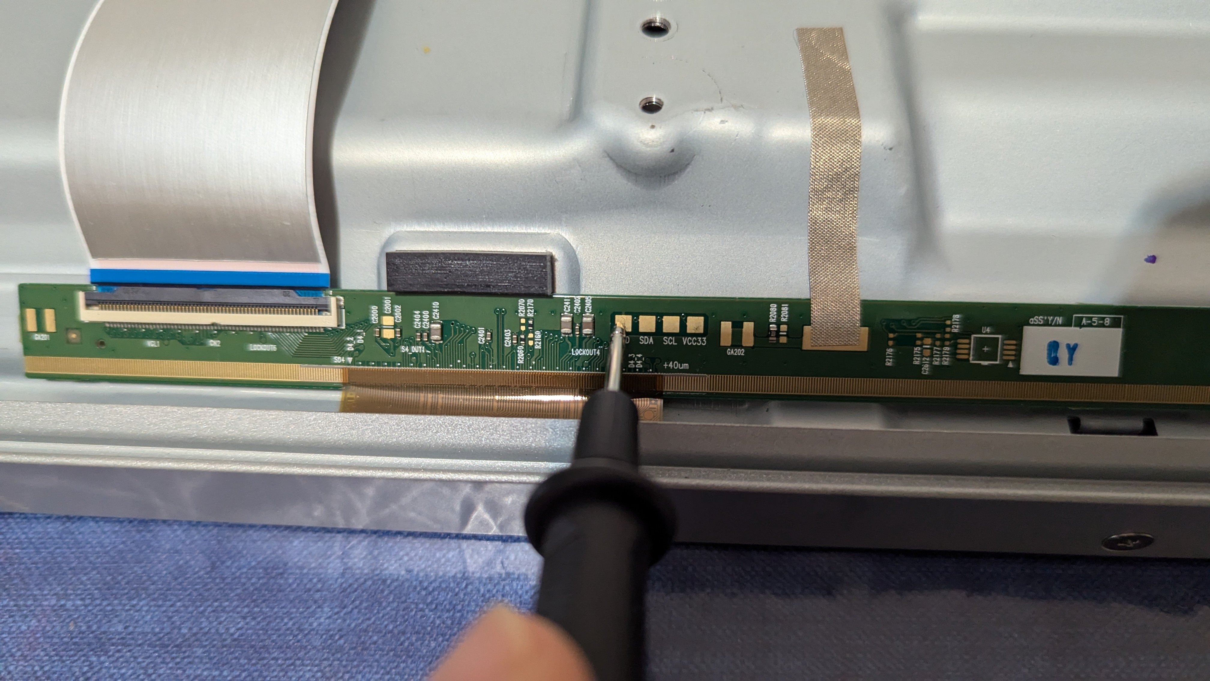

                    #29
                    So actually this wasn;t a MB issue at all, I have capped/taped some connection showing in the picture and the voltage and screen is back. I guess the issue is either in scaler PCB somewhere or connection to the half LCD panel itself, can't fix it in that case at home.
                    anyone knows if i keep this that way what to expect?

                      #30
                      Yes, as I wrote above, this is a problem in the panel, leave it like that, if you are satisfied with the image, there is nothing better you can do.
