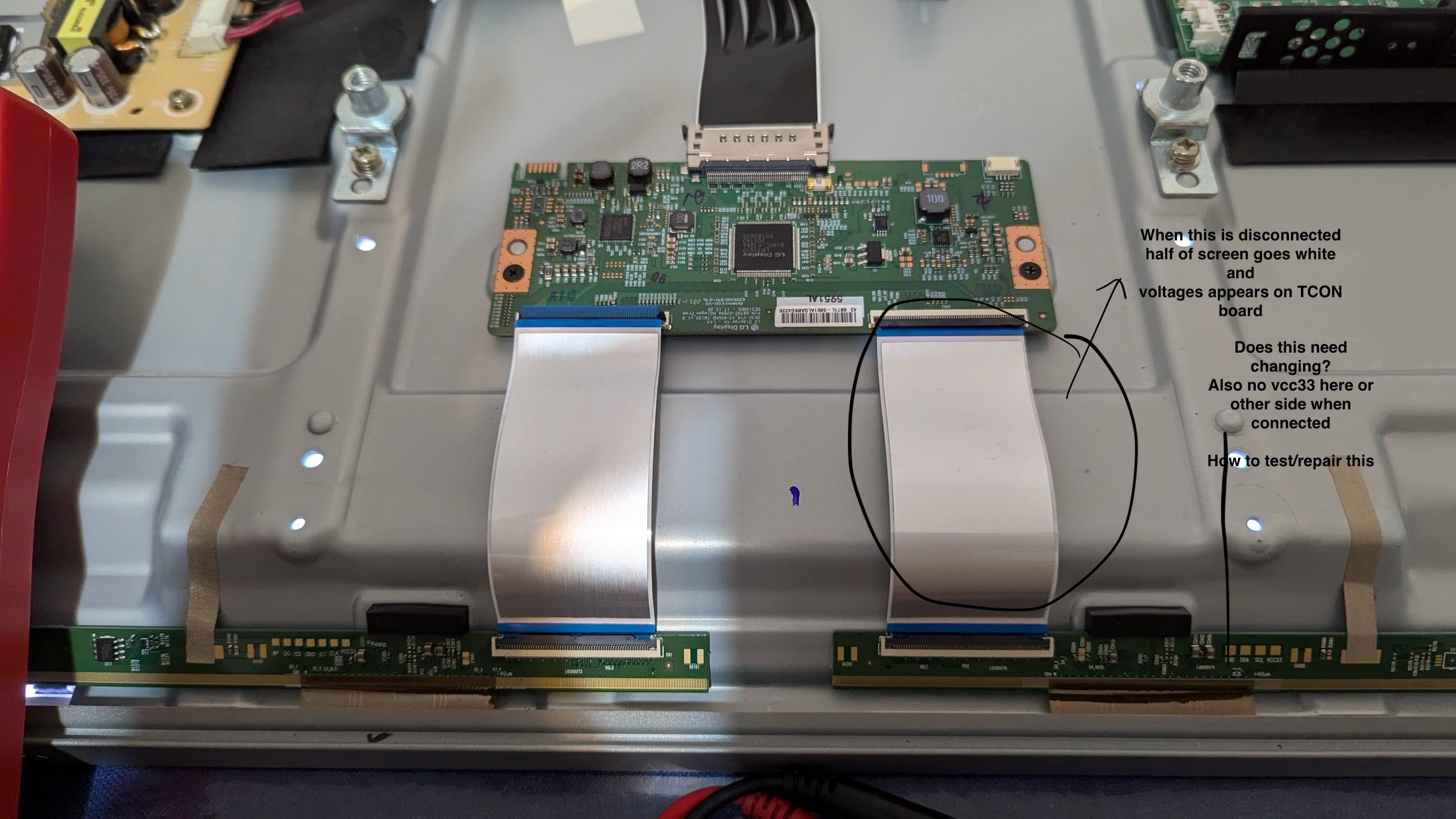

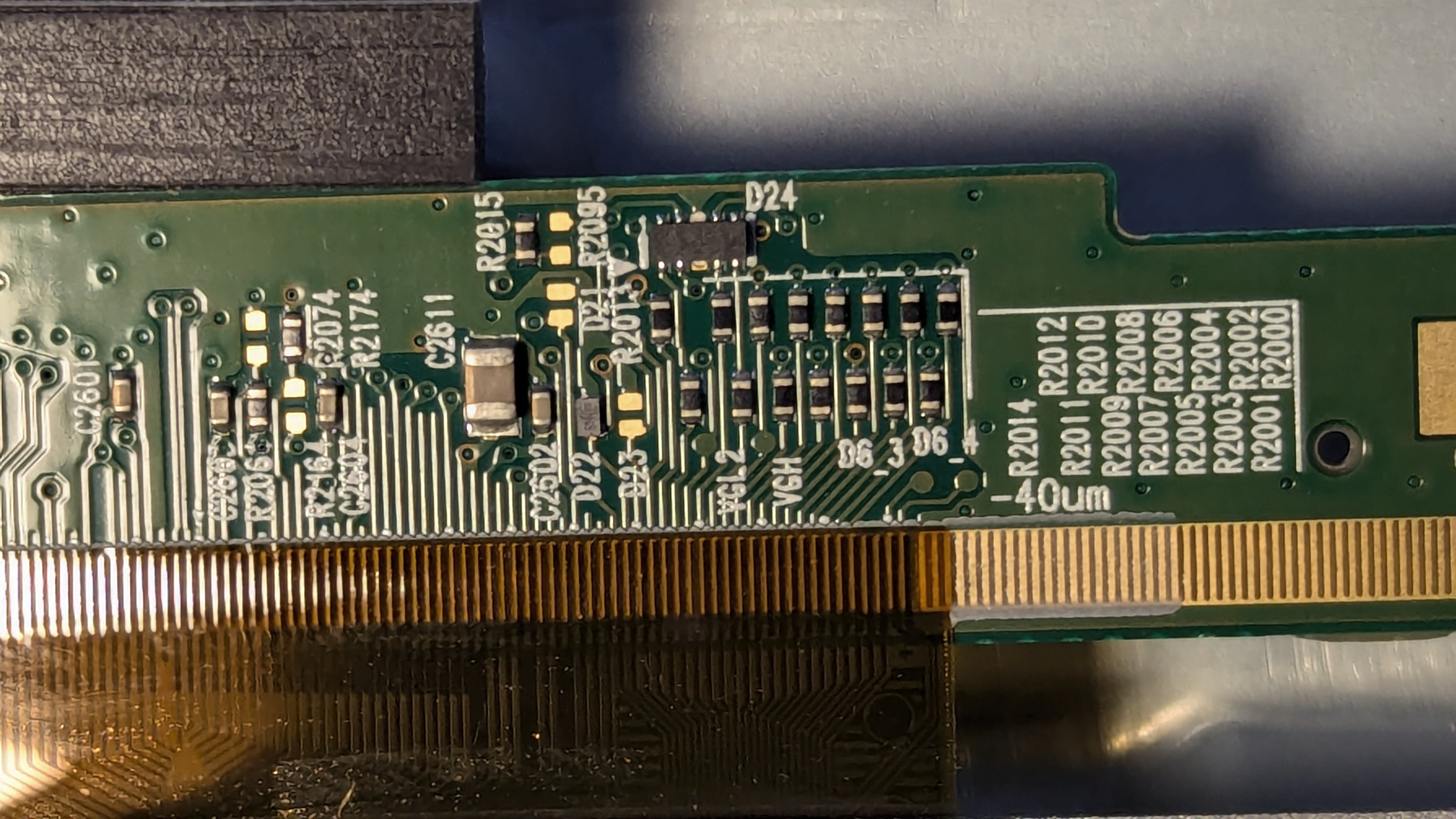

    Checking voltages at TCON
    Vin 12 V ok BUT ALL OTHER VOLTAGES 0
    VGL1 0
    VDD
    vcc19
    VGH 0
    when connection to Left half screen cable disconnected - then other half becomes white and voltages shows down below
    VGH 27.96
    VCC19 1.89
    HVDD 8.31
    VGL1 5V
    VGL2 3.8
    TCON board has been replaced with similar (bought from Ebay)
    Is this LCD panel issue ? the parts showing parts no is lg 6870s-2704d
    Many thanksClick image for larger version

                  If you disconnect the cable from this half and voltage appears on the t-con, it means that this half is shorting out some voltage and the t-con goes into protection, take a high-quality photo of this entire strip.

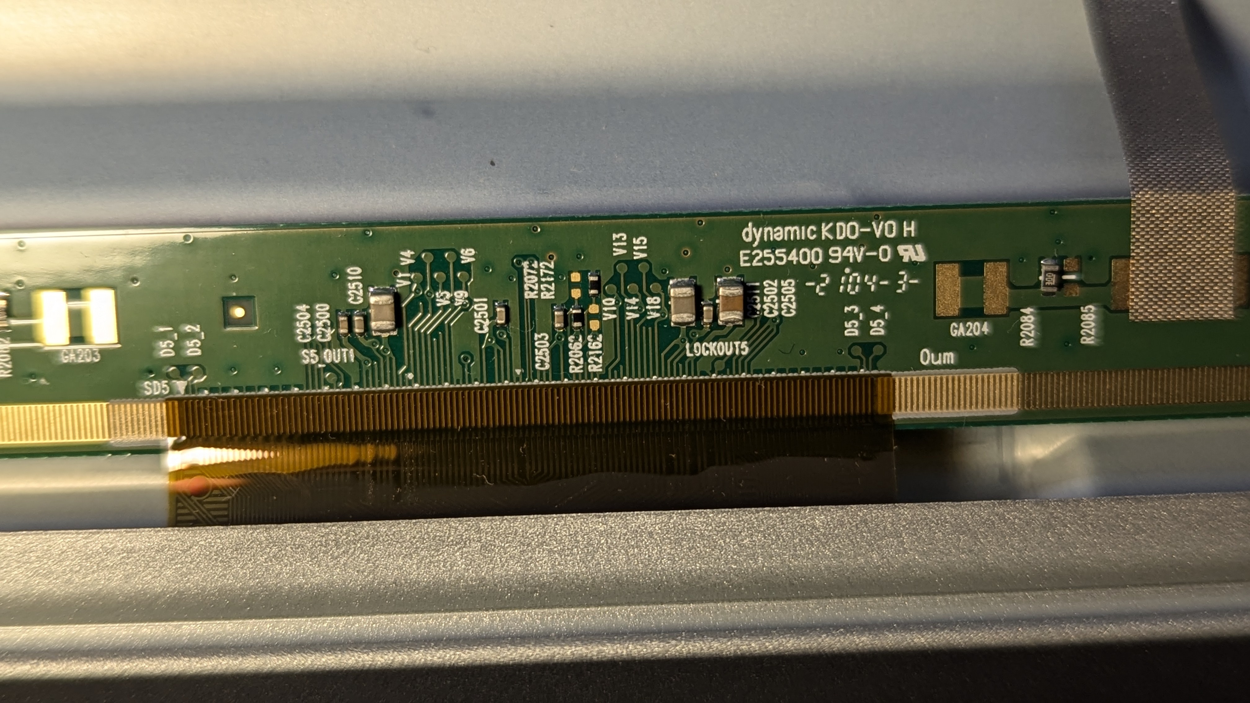

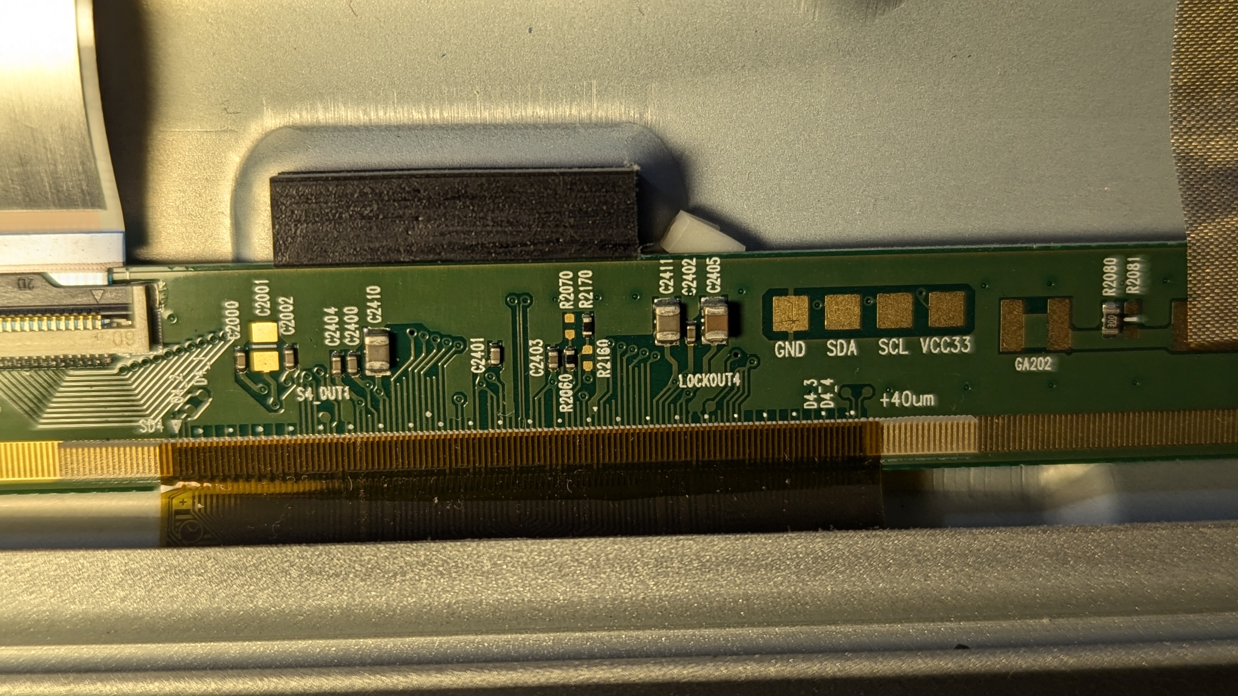

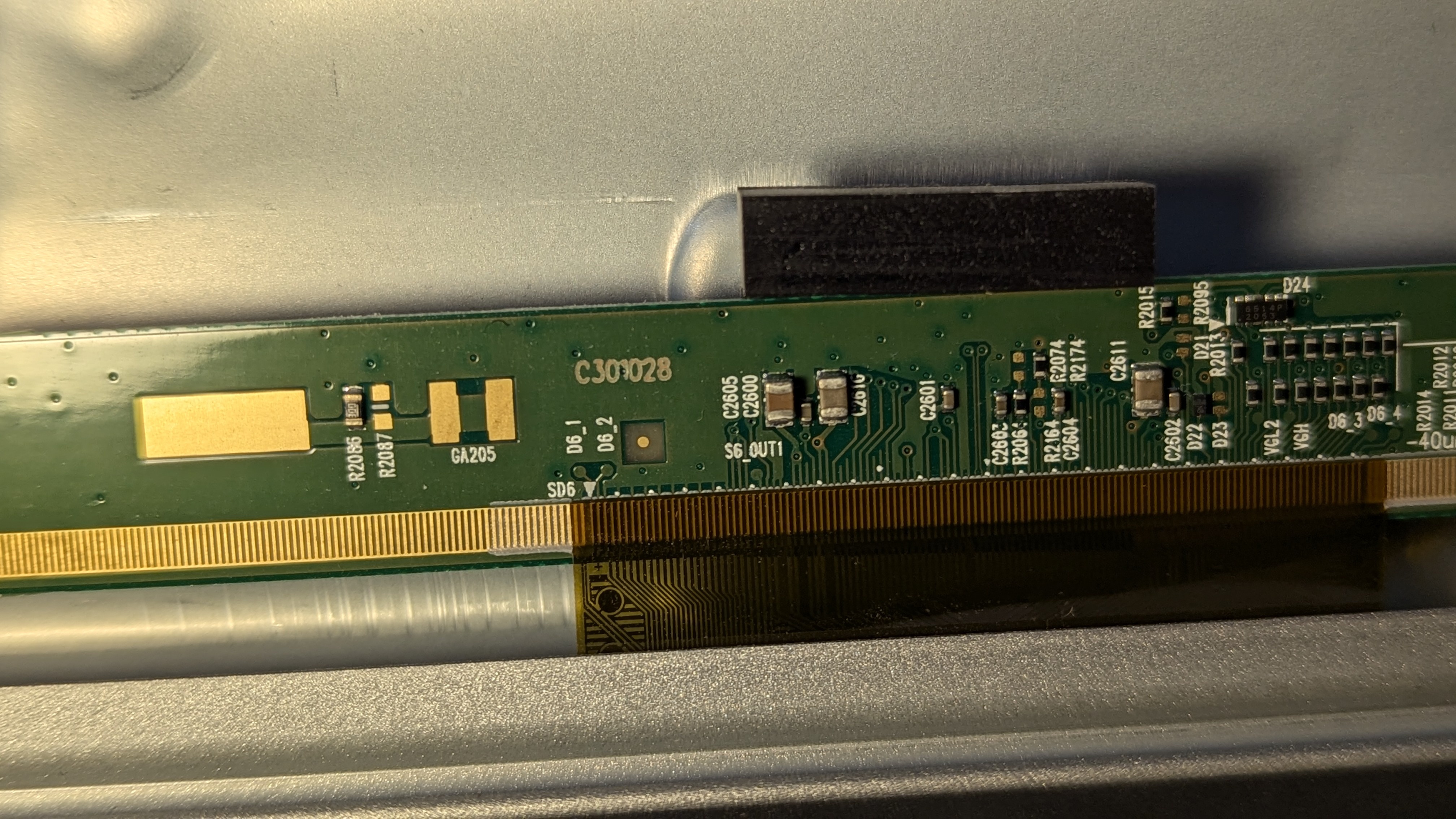

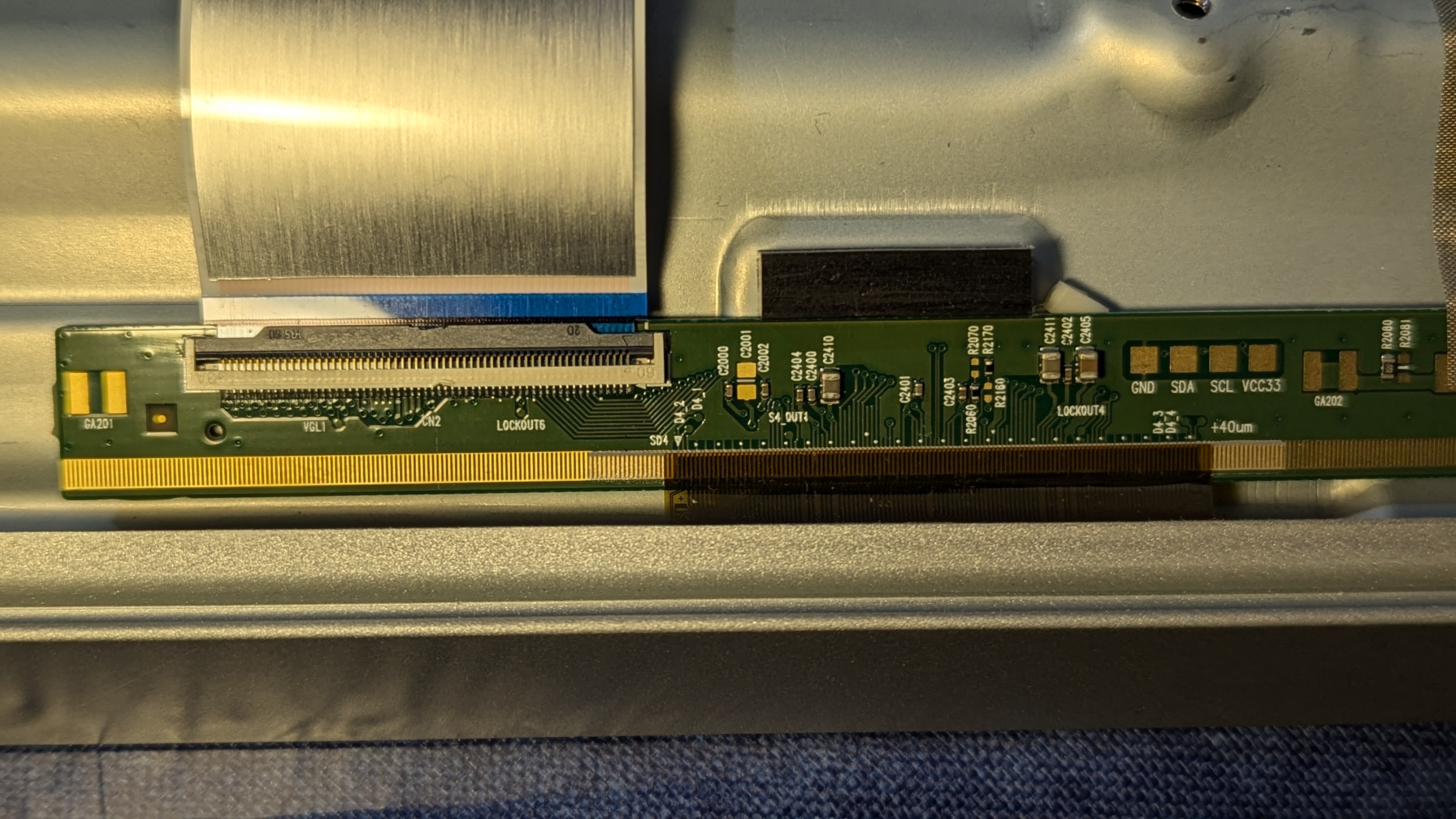

                    Here are the pics
                    • lotas
                      • Jan 2016
                      • 4537
                      • Russia

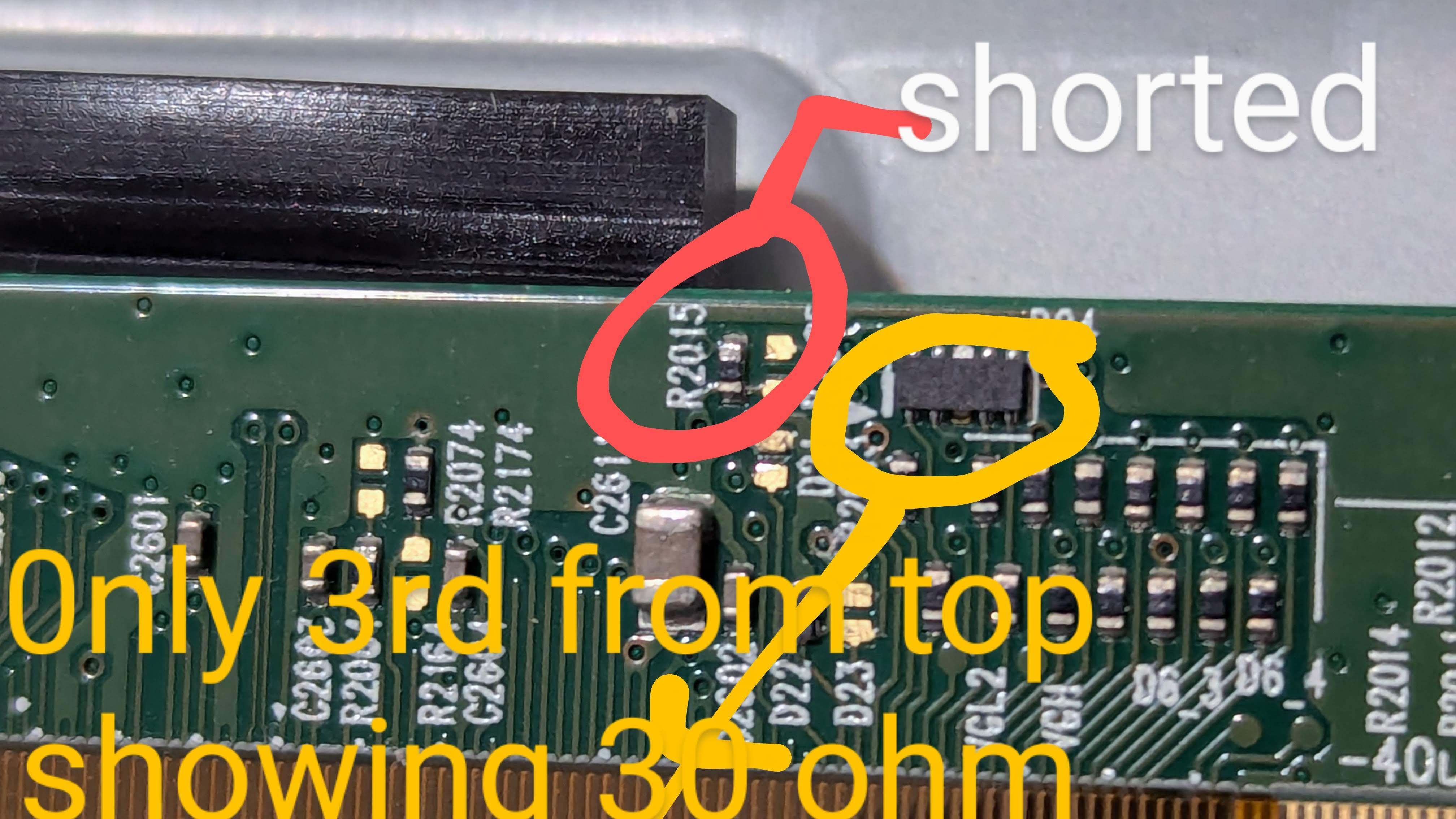

                      Disconnect the lvds cable and check the resistance at these points relative to ground (on the bar itself), it should not be low or short circuited, and also check the resistance at all ceramic capacitors on the entire bar.

                                  Voltages should not disappear (VGH, VGL,...) if the panel is working properly!
                                        Caps looks fine, however R2015 seems shorted whereas others are showing 299 Ω , and not getting any reading from D24 except the top middle one 30 Ω.
