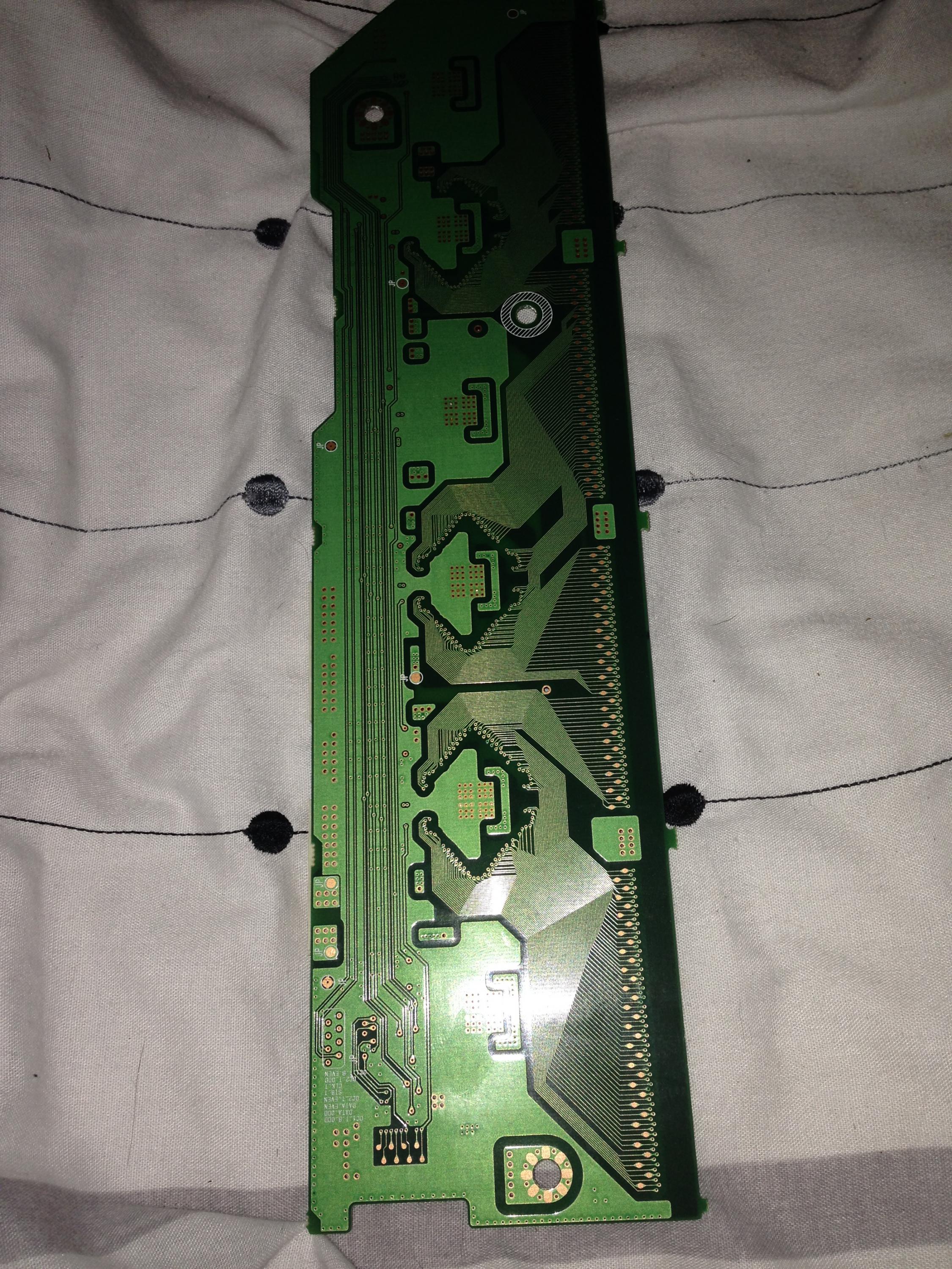

    pic could i test from bottom
      #42
      Re: lg ps3000
      ...? I need the flip side of that board.

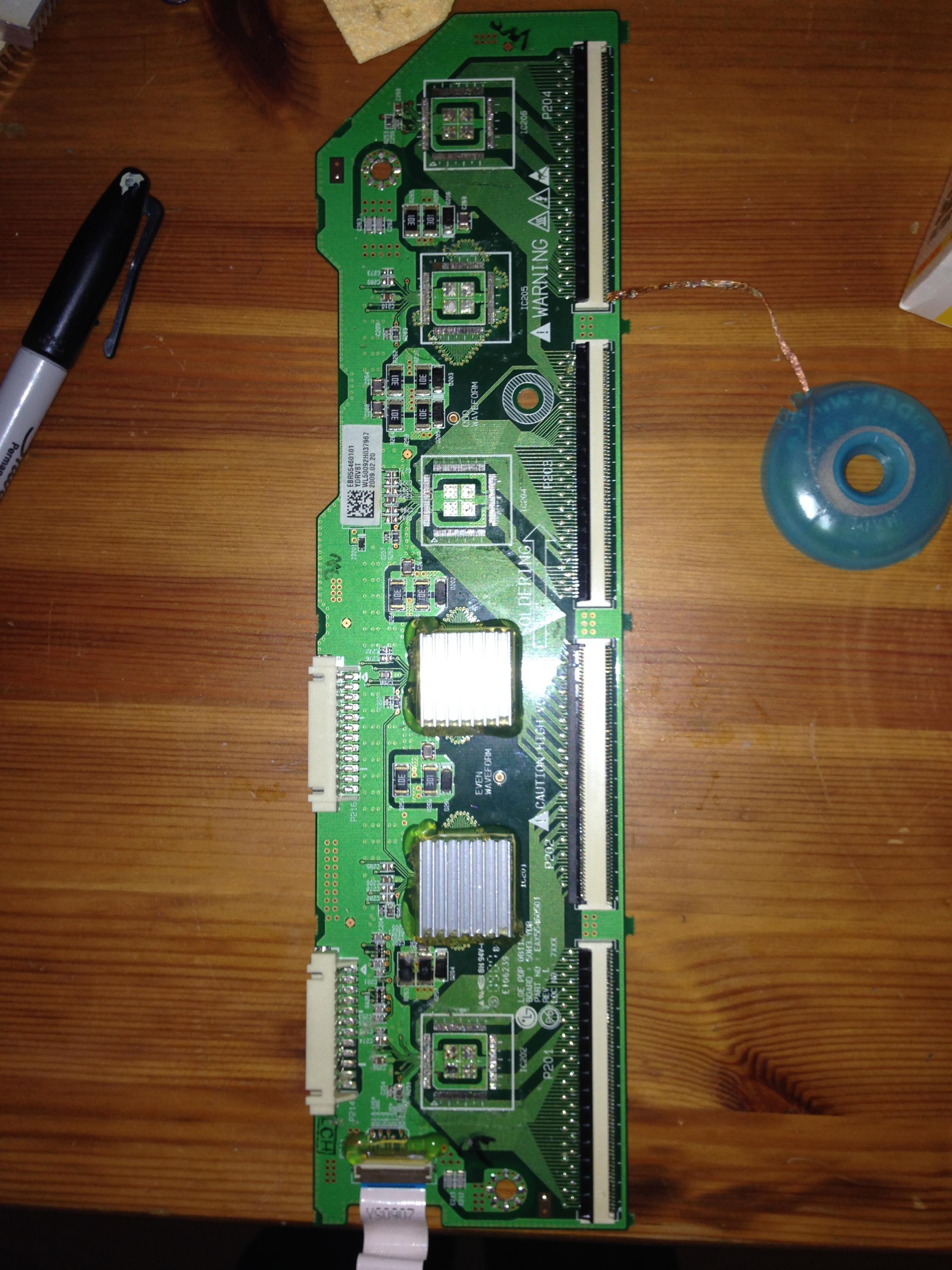

                                just removed 4 ic and still get beep on meter any idears ?
                                  #56
                                  Re: lg ps3000
                                  Which ICs did you remove? Picture of the boards as they are?
                                  • tonyuk
                                    • Feb 2014
                                    • 238
                                    • uk
                                    #57
                                    Re: lg ps3000
                                    there was burnt one so removed that and still got meter beep so removed more still getting beep im testing on middle pin of p216 then geeting beeps on p203
                                      #58
                                      Re: lg ps3000
                                      That's really odd. I can't explain the results. Same location as before?
                                      • tonyuk
                                        • Feb 2014
                                        • 238
                                        • uk
                                        #59
                                        Re: lg ps3000
                                        im getting same thing with top buffer and ic out im sure im testing it ok ?
                                          #60
                                          Re: lg ps3000
                                          Can you show me what connector pin you're using for the other end of the testing?
