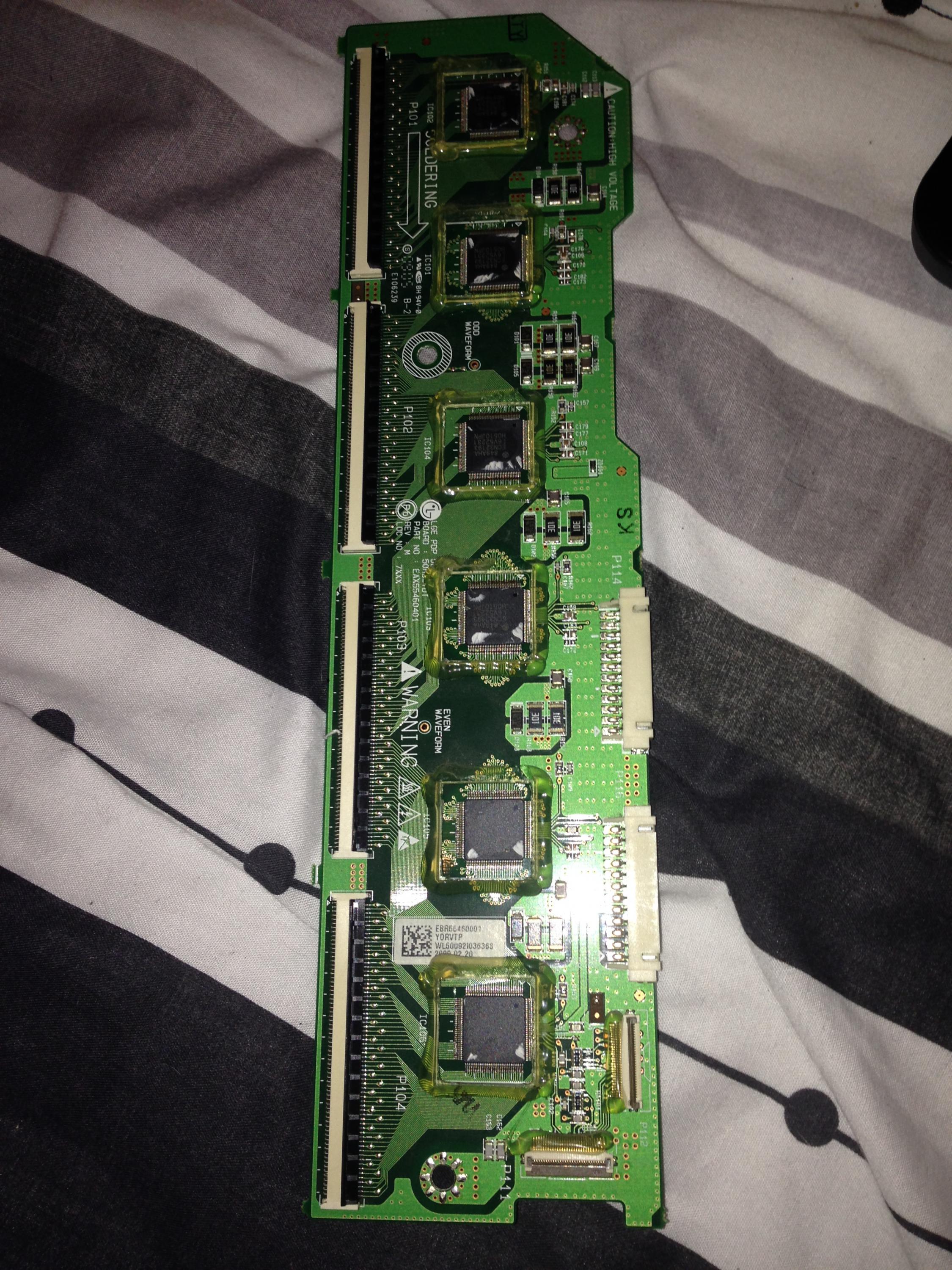

        no when i say he gave me board i mean i paid for them all to be checked and fixed but he sent bk boards from a cracked screen tv so i gues theres not much i can do apart from buy some new ic chips
        is it bottom 2 pins on top buffer that r ground to test what ic has gone

          how do i test this to see what buffers gone
            Re: lg ps3000
            As here:
            use P114 as your reference ground (Y-SUS VFG OUT.)
            http://www.youtube.com/watch?v=51SZsfH60EY
              Did you pull the heatsinks off?
              Pg 67 on has pinout and measurement results.

                yer i took them off so if i put black lead to one of the pins on 214 i get beeps and looks like 3 buffers have gone ? then on bottom buffer 2 buffers gone
                  Re: lg ps3000
                  When you say a "buffer" has gone, please indicate exactly what you mean. Do you mean you get 3 beeps? Around one IC or multiple ICs? It's quite likely only one is bad.

                    ok so i put lead on pin ref p144 any pin then run other lead down side where panel ribbons plug in and i get long beep on bottom of p101 then top and bottom of p102 hope you get what i mean my meter only has beep on its own or diode on its on
                      #30
                      Re: lg ps3000
                      OK yep so that's first IC from bottom on the top buffer blown.
                      Any chance you have your old board? If so, test it too.
                      If you find the same IC to be blown there's a chance the panel is killing it or a ribbon is touching frame, so I would check these first. For panel, look at it carefully with torch. You are looking for any pixels that, when off, look a little burnt or black vs the normal dark grey.
                      If it's a different IC then it cannot be the panel, just a random board failure or worn out IC from previously cracked panel.

                        ok so if i done that right that means some of bottom buffers gone aswell ? i also get beep on the bottom buffer

                          It seems unlikely, if you get -Vy and Vsc with bottom one installed. possible but unlikely.

                            also p101 and p102 r top of buffer board
                              #34
                              Re: lg ps3000
                              When you get a beep, make sure to hold the reading there and check again to check it is not an erroneous reading.

                                ok what i will do is tom i will test them again and post up pic with info on what ive done prob be best that way i cant see any burn marks on screen
                                i still think its cos he sent me boards from cracked screen can i can ysus with both buffers out of the tv ?
                                  #36
                                  Re: lg ps3000
                                  You won't get anything on the panel with both buffers removed.
                                  It's really weird for many chips to fail at once suddenly, which is why I doubt your readings.
                                  I'd expect one IC maybe two at most if they are nearby to each other.
                                  It's possible Y-sus has issue killing the buffer ICs but I'm not aware of any such issue on these.

                                    ok thanks tom if you see any vids with same buffers on how to test let me know im getting lost now
                                      #38
                                      Re: lg ps3000
                                      They are essentially the same as the one I did in that video.
                                      One of the essential things is your meter must have a very fast beep response. If you see in my video I can basically run it along the faulty connections and it beeps instantly. If your meter does not do that, you will need to slow down your testing.

                                        pic wherei get beep
                                          #40
                                          Re: lg ps3000
                                          Can you post a picture of the underside of the board? Need to see what lines IC #2 drives.
