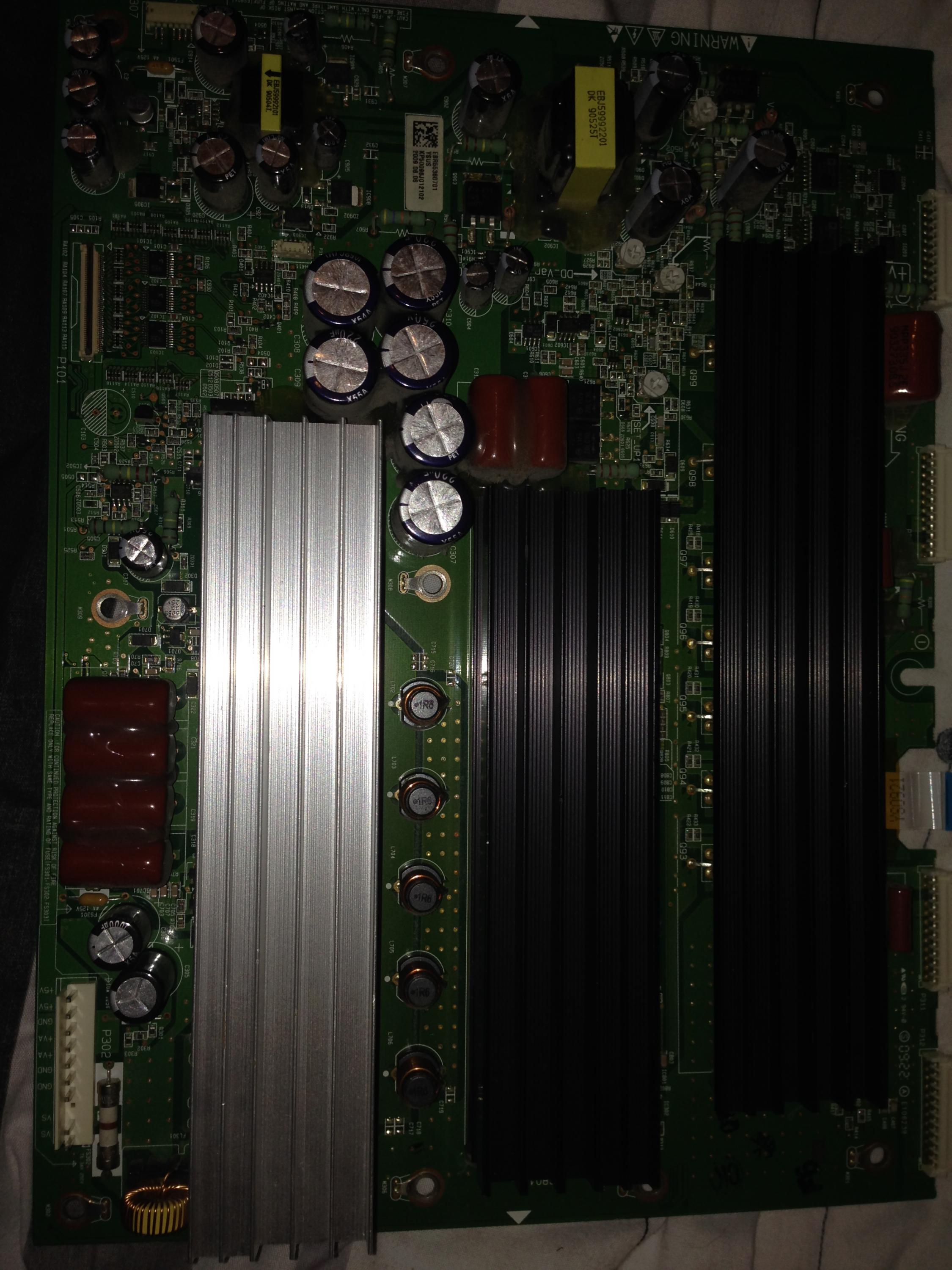

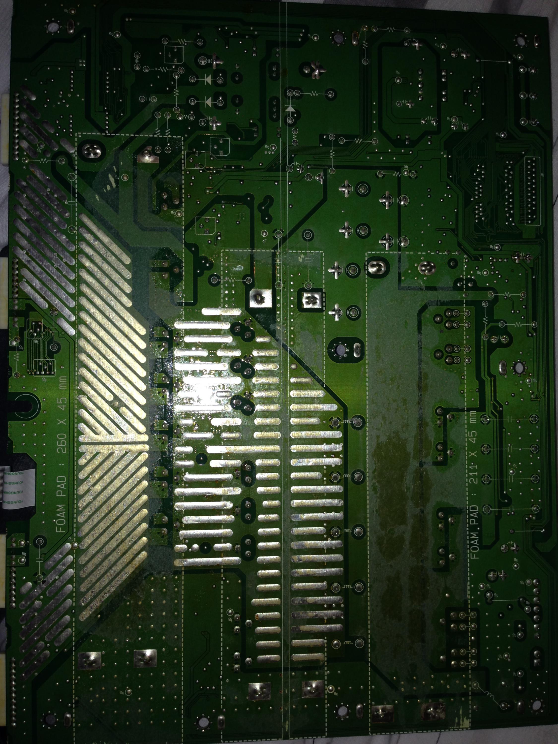

                          pics where can i get repair kit ?

                            Re: lg ps3000
                              Re: lg ps3000
                              Patience, m'lad. I was down by the pub with no internet.
                              Anyway, now try unplugging buffer boards to see if the voltages come back. If they do, try with only one buffer at a time. You only need to unplug the connections from the Y-sus, the orange ribbons may stay.

                                  ok so with top buffer unpluged i get norm reading i did try with bottom buffer out but didnt sound nice to turned tv off ?
                                    Re: lg ps3000
                                    Huh?
                                    Sounds like bad top buffer. You may get a glow on screen or half picture with only bottom in place.
                                    Buffer boards are LG's biggest weakness...!

                                      yer i got white line with just bottom buffer in now i had sent all these off buffers ysus zsus and guy said he fitted new top buffer and repair to ysus
                                      hes now saying my screen has blown the buffer ?
                                        Re: lg ps3000
                                        As far as I know, that doesn't happen with these TVs, the buffer board was probably dodgy.
