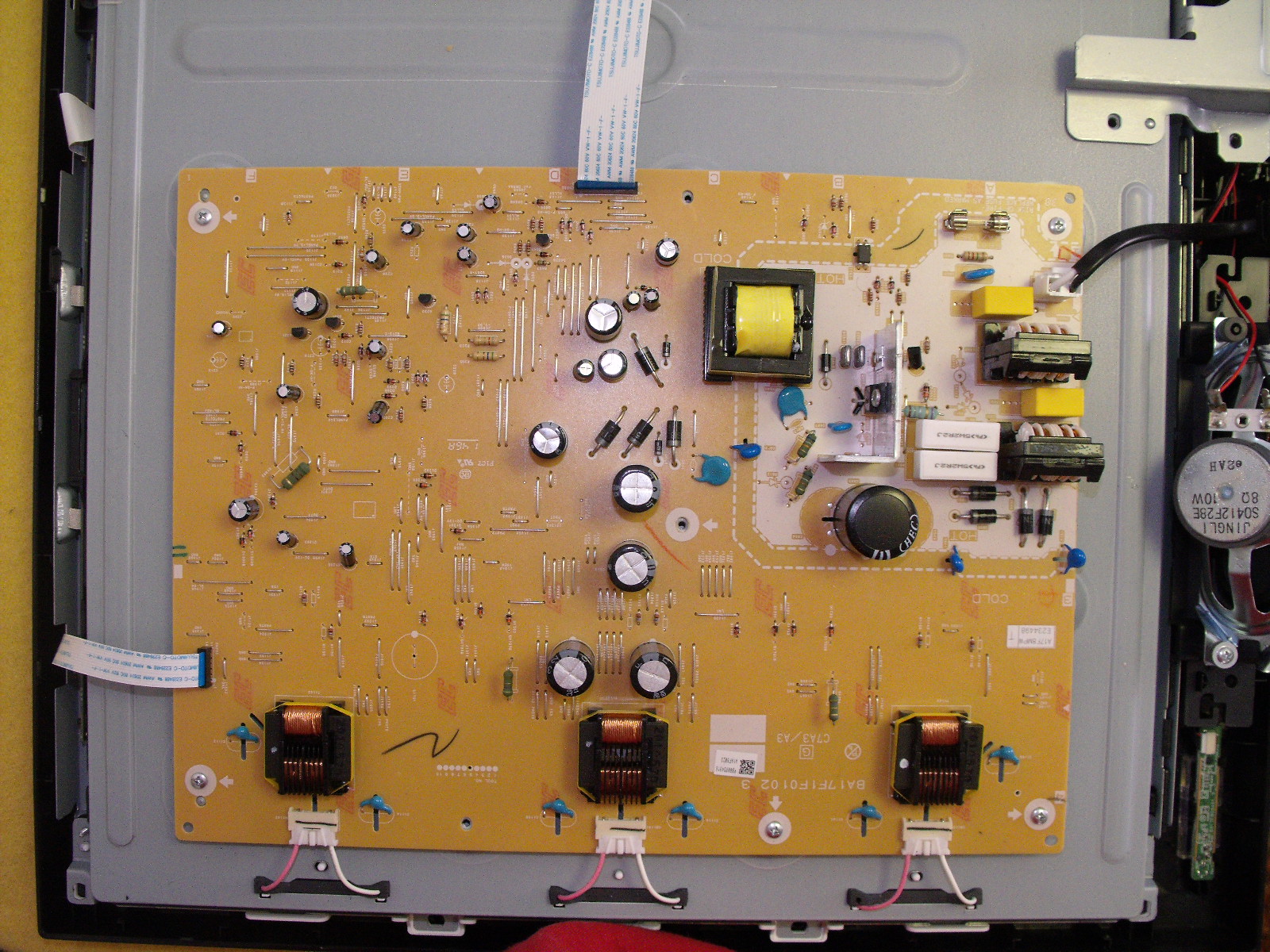

    Emerson LC320EM2 Dead
    Hello all! This time I have a Emerson LC320EM2 that is dead with no light or any sign of power. I read through a couple other threads here on this model and it seems my tv is a little different. The fuse is good and I visually checked over the caps or anything that might have gotten hot. I also tested the diodes on the hot side and came out good. I did see that they make a power board repair kit for $25 and was wondering if I should just get that but according to another thread on this TV it did not help out the other guy. Does anybody have an opinion on this??
  • CraigR
    • Dec 2013
    • 973
    Re: Emerson LC320EM2 Dead
    Well I just removed the board to have a look at the underside and it looks like someone was in there I'm guessing to put that kit in and had way too hot an iron and just destroyed the traces on the board so looks like I need another board now.
    • CraigR
      • Dec 2013
      • 973
      I hate to revive an old thread but since this post I have done about 8 of these TV's and just get a kit and it has always fixed the tv until now. After installing the kit still no power but now high pitch squeal. Just wondering if anybody has a quick answer without going into major diagnostics?
        Question is what components did you replace?
        Did you force the PSU on without the main board?
        Here is what I did to mine: https://www.badcaps.net/forum/showth...hlight=emerson
          Diode D604
          Diode D605
          Diode D607
          Diode D609
          Diode D610
          Diode D640
          Resistor R602
          Resistor R605
          Resistor R606
          Resistor R608
          Resistor R611
          Transistor Q600
          Mosfet Q601
          Fuse F601
          Did not force anything on.
          • CapLeaker
            Leaking Member
            • Dec 2014
            • 8352
            you switched diode D605 twice? or is that a typo?
            • CraigR
              • Dec 2013
              • 973
              LOL yep typo
              • CapLeaker
                Leaking Member
                • Dec 2014
                • 8352
                Did you measure all voltage rails when this thing is chirping? I am thinking something is shorted and loading the PSU down.
                • CraigR
                  • Dec 2013
                  • 973
                  No, unplugged it right away because i did not want to fry anything. I was hoping somebody might have ran into this before and might see what I missed replacing.
                  • CapLeaker
                    Leaking Member
                    • Dec 2014
                    • 8352
                    Does it chirp in STBY or did you turn the TV on?
                    • CraigR
                      • Dec 2013
                      • 973
                      Just plug it in and a very quiet steady squeal. No light on front and TV will not turn on either.
                      • CapLeaker
                        Leaking Member
                        • Dec 2014
                        • 8352
                        did you disconnect the main board and plug the PSU in?
                        • CraigR
                          • Dec 2013
                          • 973
                          Yes, same results.
