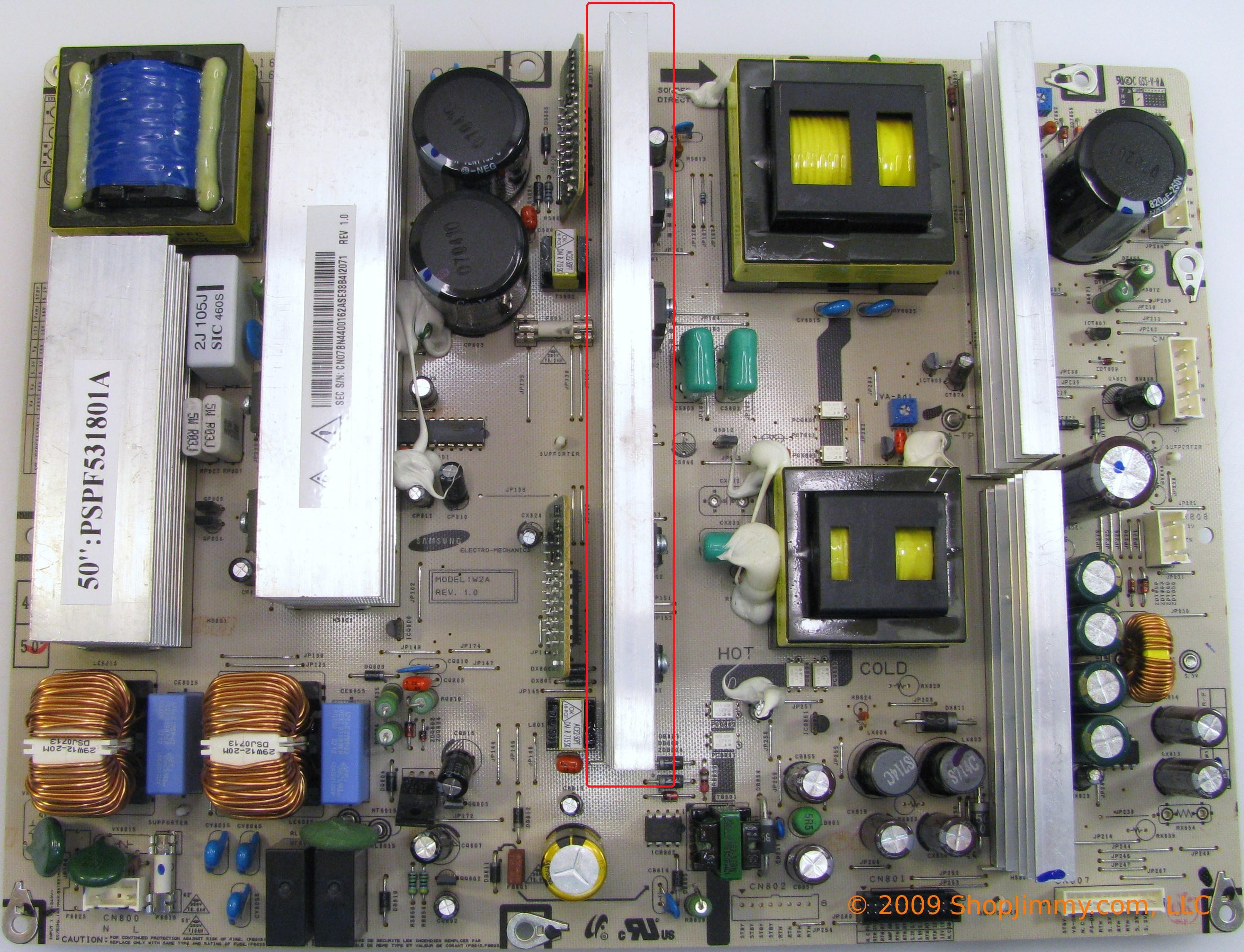

        It will be a SAMSUNG board, they made them. All depends if it's been repaired/refurbed by someone who used quality caps.
        Who's to say you got a new board or has the same fault.
        Does it always shutdown after 15mins or is it variable?
        They can also have bad solder joints on the FETs on those heatsinks and can intermittently shutdown or cycle.
        The one I had it was the long thin heatsink in the centre of the PSU where the solder joints were bad.
        Might be worth reflowing those first. I have seen one go up in smoke when cycling so it may be a good idea to get it attended to now before a simple repair turns into a bigger more expensive one.
        Even if you know somone with a soldering iron and reflow them yourself. Worth a shot and if the caps are really bad they can bulge but a bad cap can look externally normal.

              The difficulty I'm having giving advice with this is there's no certainty I'm right. Process of elimination so if you take it somewhere, are you going to be taken for a ride, how much are they going to charge, would it be just economical to just get another or send yours in to someone like Coppell Tv who offer a repair service online??
              I think some very clear sharp shots of the board may show something especially the solder joints on the underside. You never know there are some very experienced eyes on this forum.
              reflowing the joints is not beyond a complete beginner, just a matter of reheating the joint to get the solder to flow, ideally some fresh solder added would be of benefit.
              the fact it start shutting down after it gets warm does make me think it's a cracked joint.
              I've marked the heatsink i had issues with 4 devices attached to it with bad joints.

                No I only mention that as another problem these have. I'm putting the mockers on you a bit, given it's age you could invest money in the PSU and then have the ymain/buffer fail in the near future or could last for years yet.
                I really think it sounding like bad joints, reaches a certain temp goes open cct, cools makes contact again, then runs until it reaches the same temp, joint expands open cct etc etc.

                        That tv has well known issues with cold solder joints in the power supply. Dealt with two of them back to back last year. Same issue. Different areas of the power supply thou

                            I have been trying to post pics but no success. I do not see any broken soldering joints. Which leads me back to the capacitors
                            Vincent great video and it helped but all posts seems to be firmly seated.
