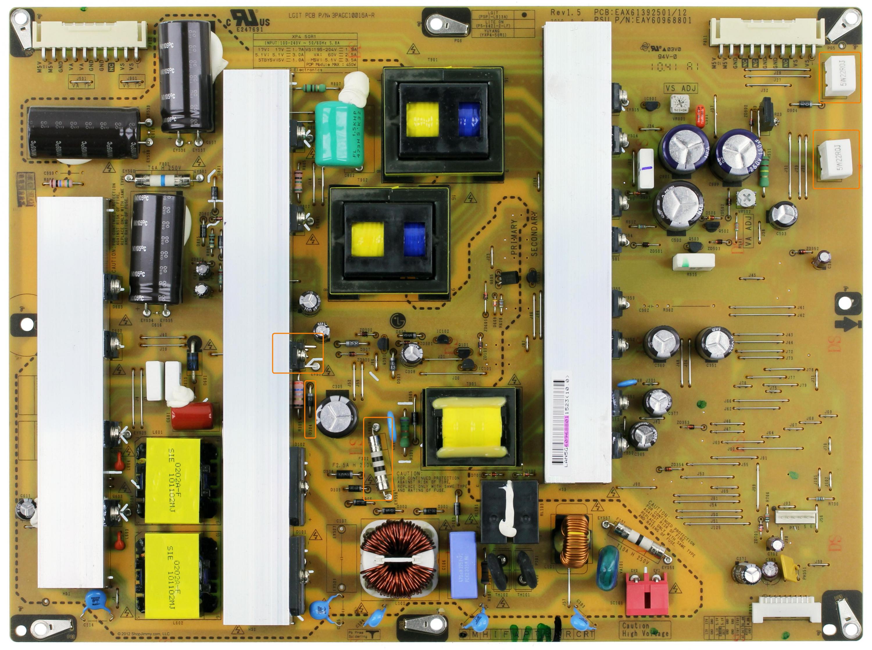

    Well after re-reading all the posts including Toms "troubleshooting some common plasma TV problems" so I thought would start a new thread concerning the PSU clicking during start up. I am not adding pictures for the moment, these are the same https://www.badcaps.net/forum/showth...LG+50+clicking
    The TV has been running great with a good picture for more than 2 years although due to work in another location the TV remained switched off for more than a year.
    Since being back home for around 6 months now and watching the TV daily it started this clicking noise and remaining in Standby mode, it was becoming frustrating so I ordered a repair kit *LG Repair KIT [Power Board] EAY60968801* that I'm still waiting on.
    Since I was expecting the parts a bit earlier I decided to remove the PSU and check the components that are on the way, I also removed the 3 ceramic 10 Ω resistors tested okay off the board 2.2 ohms set at 200 Ω.
    So far the only shorted component found is the Diode D-304 next to IC-301 voltage regulator P/N. 3BR1565JF
    I am considering replacing only the diode at this stage or until the Repair Kit arrives, would this impact other components?
    Comments appreciated.

    I would certainly change the voltage regulator as well. It will short again. Right now its intermittent and will test good but it will go soon for good. They short temporary under heat taking.the diode out.

      D304 is in parallell with R305 which is low resistance. So you have to take D304 out of the circuit to measure it properly.

          Parts arrived today so removed D304 and measured R304, very low resistance 1.5 Ohms.
          D304 on the other hand has a much lower reading than the new diode which seems suspect. The 3 ceramic resistors measure up the same as the old ones so will keep the old ones on the self.
          I imagine that voltage regulator IC301 is on its way out so will replace it first since the solder area is tight.

                            Yes the IC and 3 2.2 Ohm ceramic resistors were replaced along with D304, the fuse was not replaced as the TV still works occasionally.
                            Yes the STBY 5V did indicate the 3.4V as it was trying to startup and there is no ACDET during startup, RL_ON line measures 2V.
                            D304 still seems suspect as it reads shorted on the board but good with one leg lifted as with R304 test to ground?

                              Re: LG 50PK350 Plasma
                              Originally posted by rigeback
                              .........so I ordered a repair kit *LG Repair KIT [Power Board] EAY60968801* ...........I decided to remove the PSU and check the components that are on the way, I also removed the 3 ceramic 10 Ω resistors tested okay off the board 2.2 ohms set at 200 Ω.
                              just trying to clarify some things that's confusing me.
                              You removed 3 x ceramic 10ohm rsistors and they tested ok at 2.2ohms?
                              So the 22ohm ceramics x 2 (R927 AND R929) were good too?
                              Is this picture your board and the components supplied in the kit which were replaced?

                                if it tests good with a leg in the air, then it's good. A diode in parallel with a 1.5ohm resistor will always look shorted in cct if you meter it.

                                    Yes this is the board its almost the same except mine has 3 X 2.2 Ohms ceramic resistors R927 - R928 - R929.

                                        must be a variant then, so they're marked 2r2.
                                        I'd be tempted to try running it without the mainboard and Placing two 100 Watt light bulbs in series from Vs to Ground and see if it remains stable.
