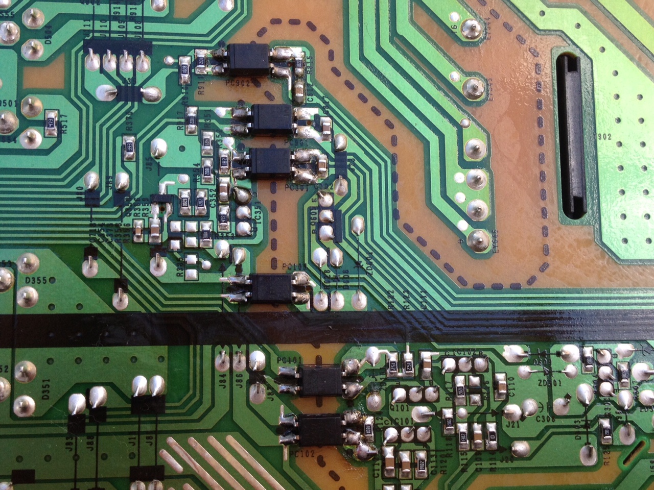

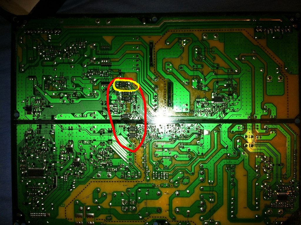

        Re: LG 50PK350 Plasma
        After re-reading https://www.badcaps.net/forum/showth...50PK350&page=2 and taking some readings I think Tom is right about the optocouplers as the AC_DET is dead unless pulled up from STD_BY 5V and even so it will not stop the relay closing (Clicking).
        The Yellow circled optocoulpler has 105 - 300 V on one side and nothing on the other? The rest all have readings.
        I would like to de-solder but I am not sure what to replace it with, in saying that I have a few from other PSU's but not sure they will work, I have not been able to locate a schematic for this board.
        Any positive thoughts would be welcome.

          Mate, I've really got nothing for you I'm afraid.

            Yeh its a bummer knowing what to get here, new IC701 or new board,, or pull 5V on the optocoulpler instead of after the IC701, could be fun and games though!

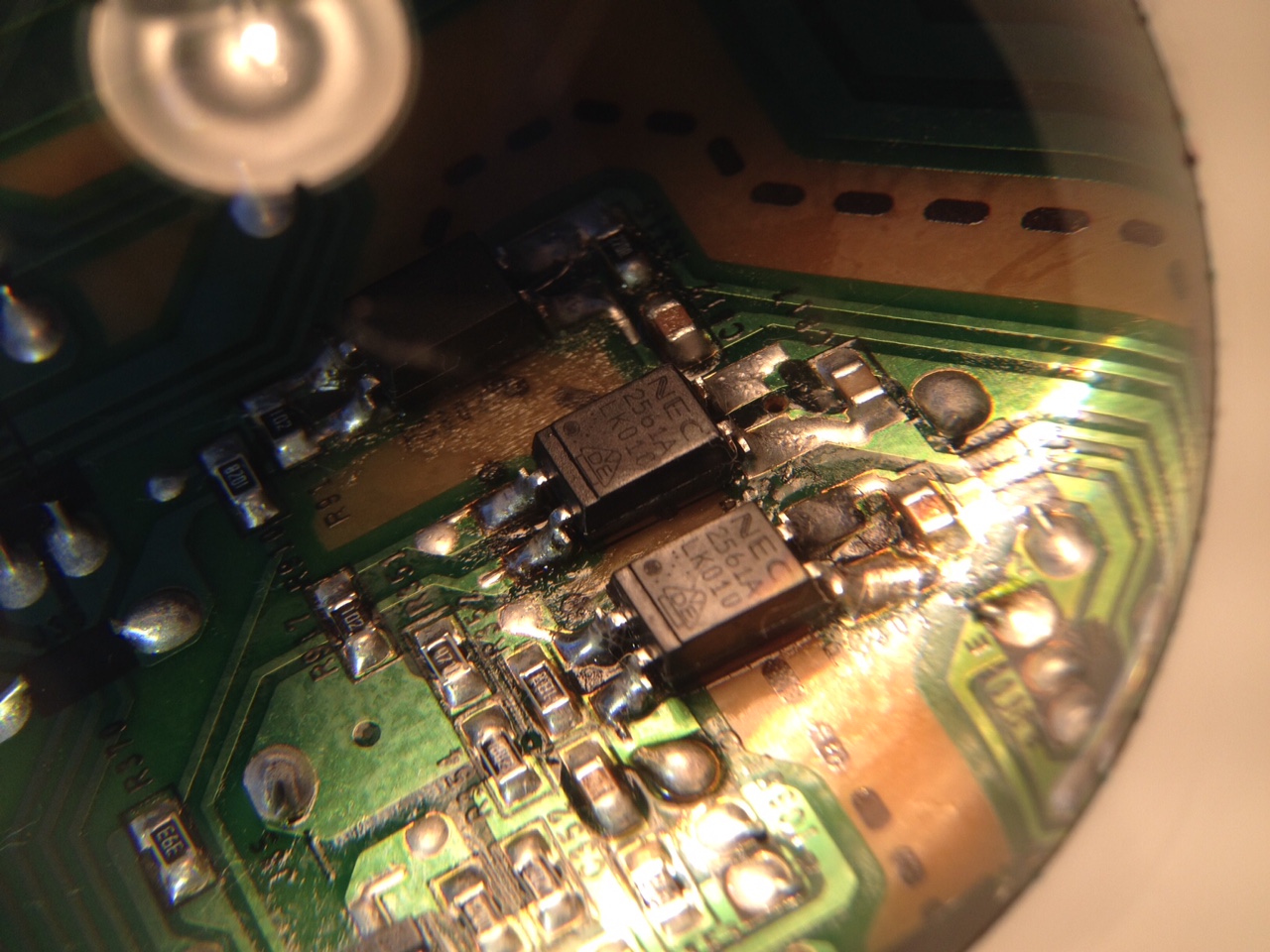

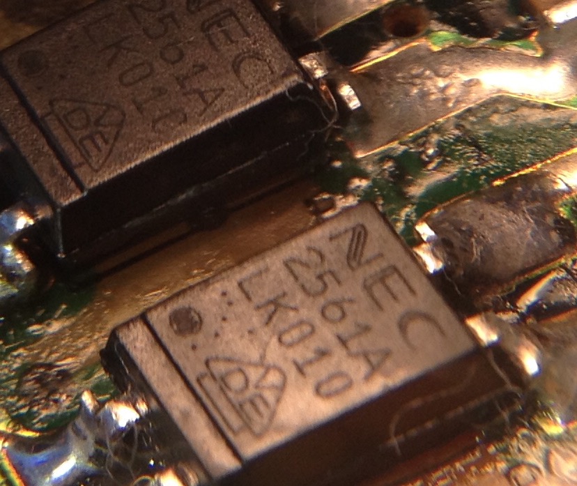

                  Could someone tell me what to do with this optocouplers as Tom said before .
                  Do you have to short them ? I have pull them out from circuit and they measure fine.

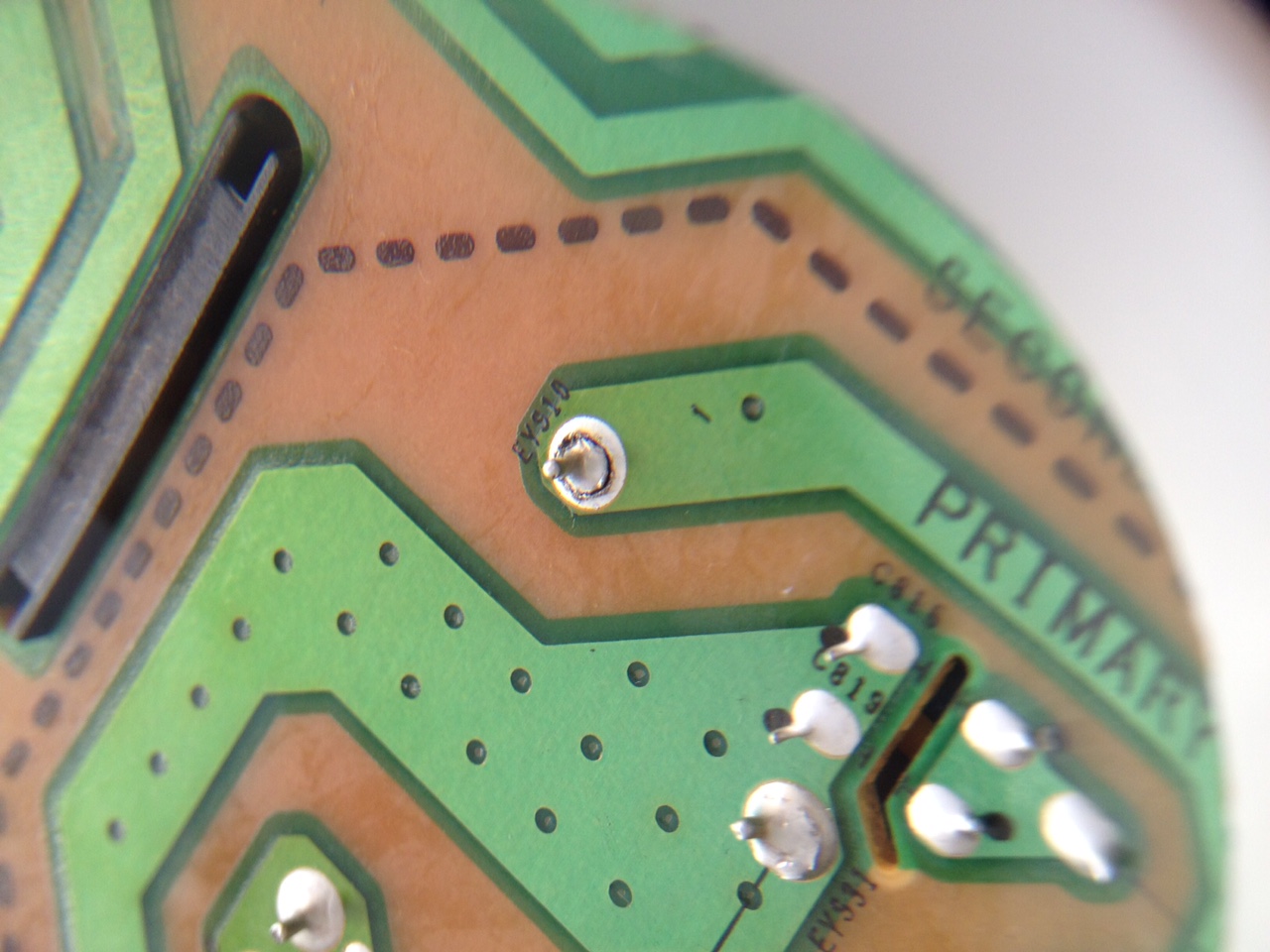

                        Hello,after I checked the board for soldering I notice EYS10 had dry joint.
                        I resolder on all transformers all pins and the tv is working with no intermittent clicking .

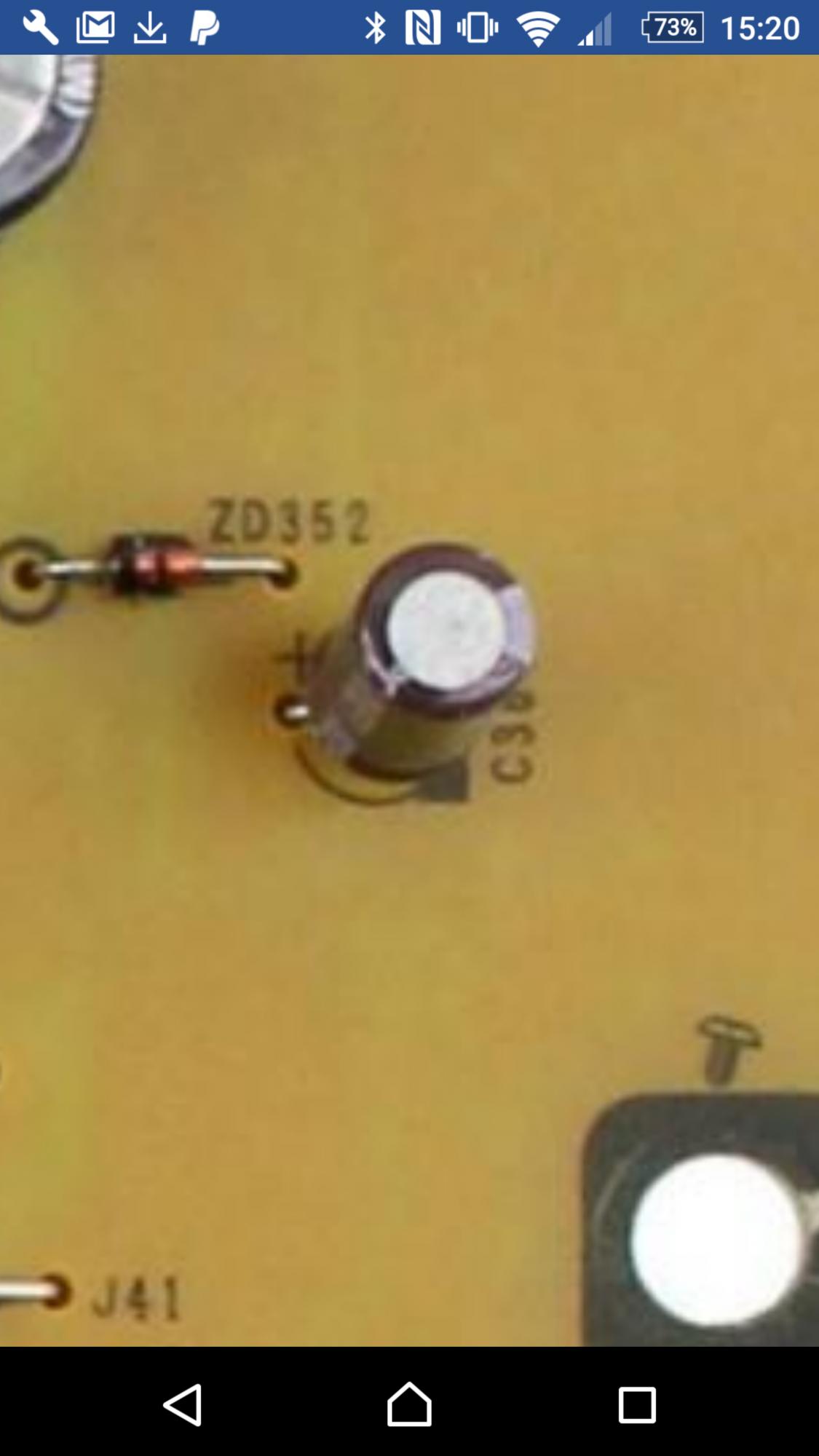

                              Yes you need to change out this capacitor here:
                              Check it with an esr meter, It will be through the roof.
                              I believe the purpose of the 2 resistors is to drain the caps on y and zsus.
                              When you turn off the tv this capacitor is used in that circuit.
                              Usually when I repair this power supply I change out the 2 resistors, the mosfet below them and that capacitor.
                              Also if you just change the capacitor and the resistors without changing the FET it tends to blow almost instantly.

                                Pic
