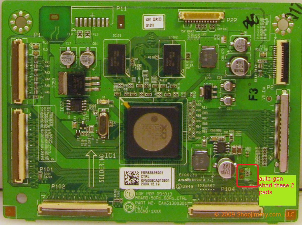

        I wonder if the logic board has an autogen.
        They show it for the PJ350 but I see a spot it might be on the PK350 but no marking so would be reluctant to suggest it, other wise that would be a handy way to confirm the PSU
                    I'll confirm this and I also noted:

                                  Ok, just found a training guide more useful and the PSU in the pictures will be yours as it has the same part number and has the 3 ceramic resistors you mentioned.
                                  Also there is an auto-gen on the control board and was at the pads I suspected but is unmarked.
                                  I'll upload it as an edit, about 18meg.

                                      Or I could try run this auto-gen on the control board although still not sure how it really works.
