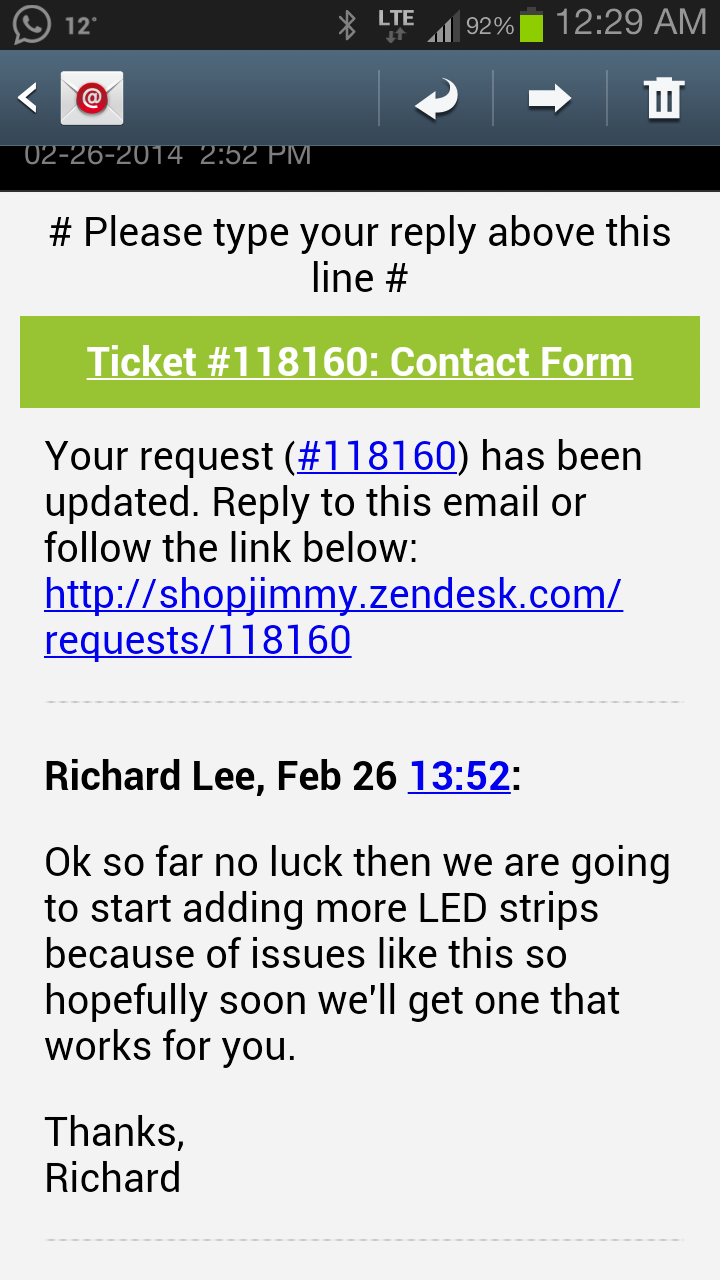

    As per some communication I've had with Shop Jimmy they must be getting more than a few requests for them. Admittedly a niche item but there you have it.
