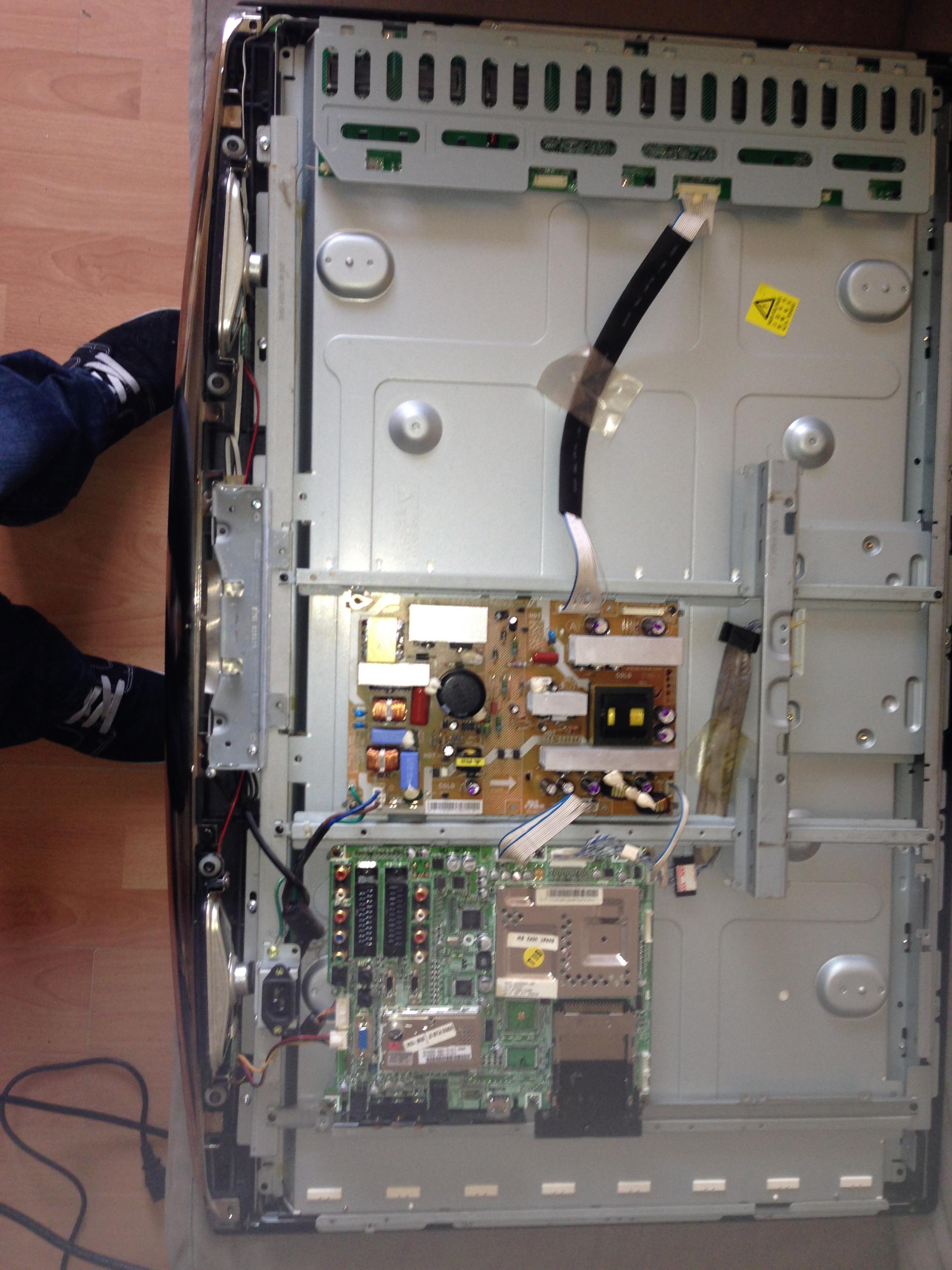

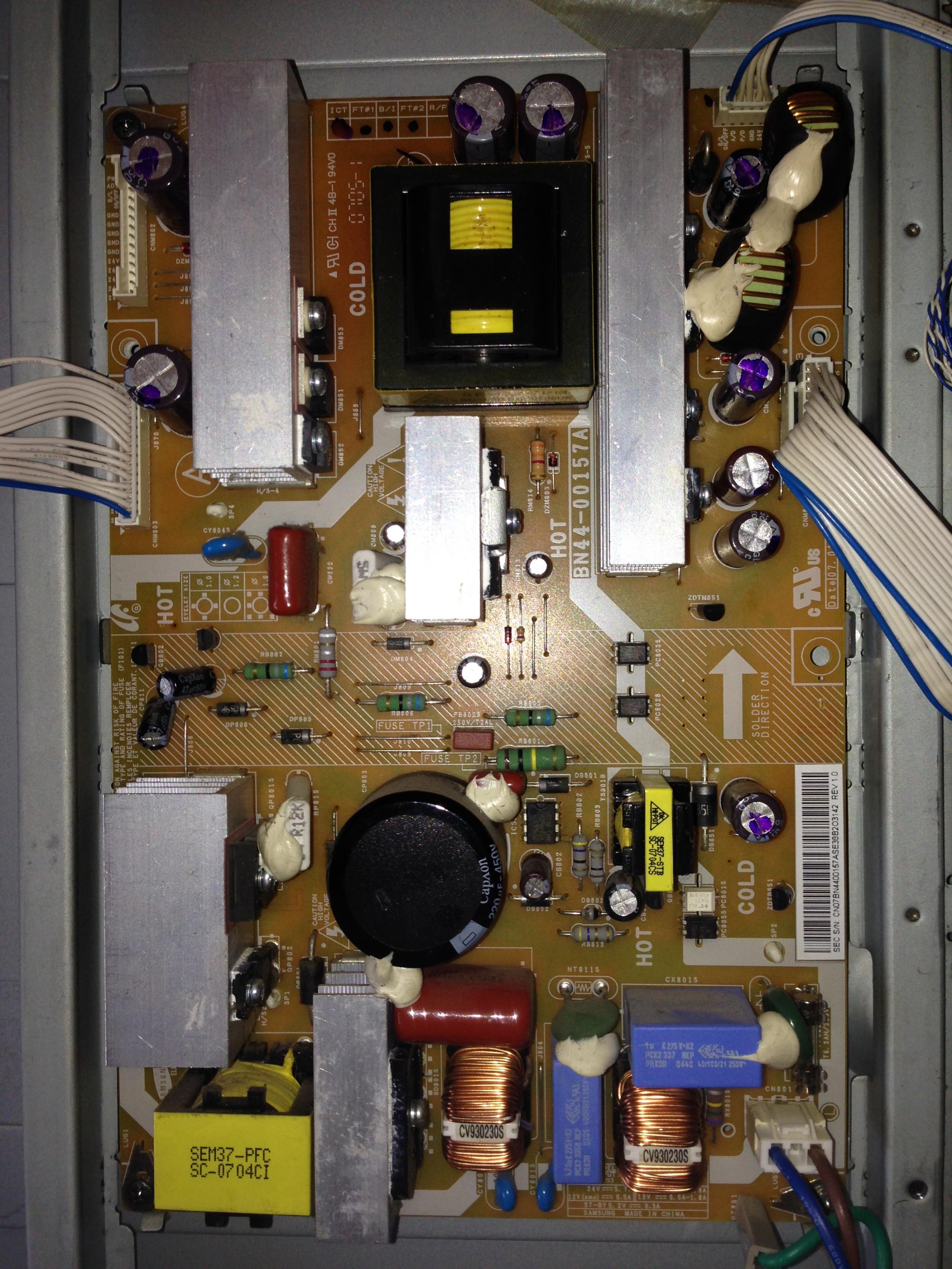

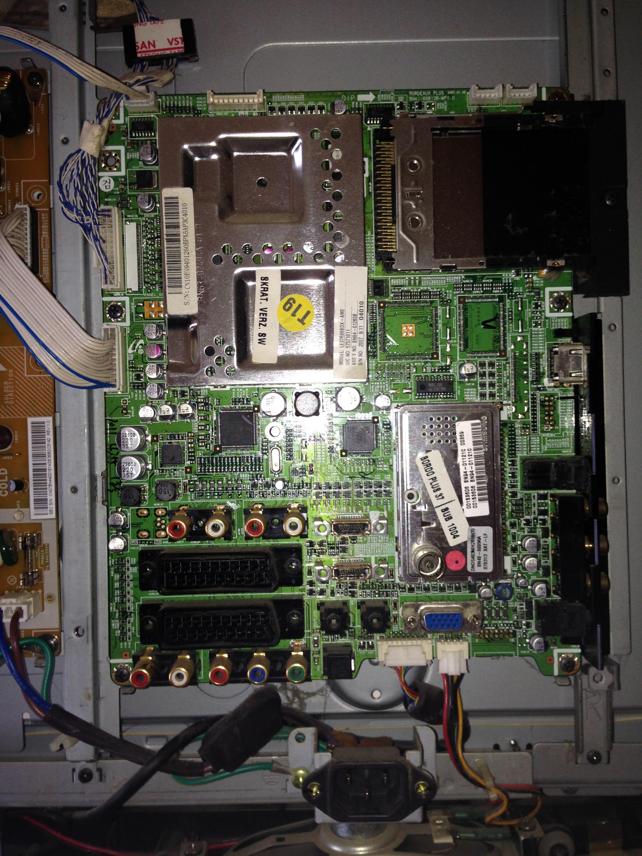

    hi peeps just got this samsung as above now the tv will turn on but i cant get a picture checked power on psu and all seems ok but if i play with plug that goes to buffer i get picture for a few secounds then goes blank again ? any idears plz

      im trying to get pic but in this tv theres only power board in center from that theres a cable runs to right side cable slot marked cnm8 03 now if i unplug that then slowly push in i get full picture then goes ? checked all marked pins and i get 24v readings as says on board

          yer i get picture and sound but only if i unplug then hold plug in if i leave in then i get no picture or backlight
            Re: le37r87bd help
            Unplug WHAT??
            Please, PICTURES!
              Re: le37r87bd help
              pics
                Re: le37r87bd help
                the cable on left in first pic white with black
                  Re: le37r87bd help
                  Thank you.
                  Now, please turn the TV off and turn it on in a dark room, do you see a flicker from the backlight as the TV first turns on?

                    thanks tom yer get a little flash on screen then goes black
                      Re: le37r87bd help

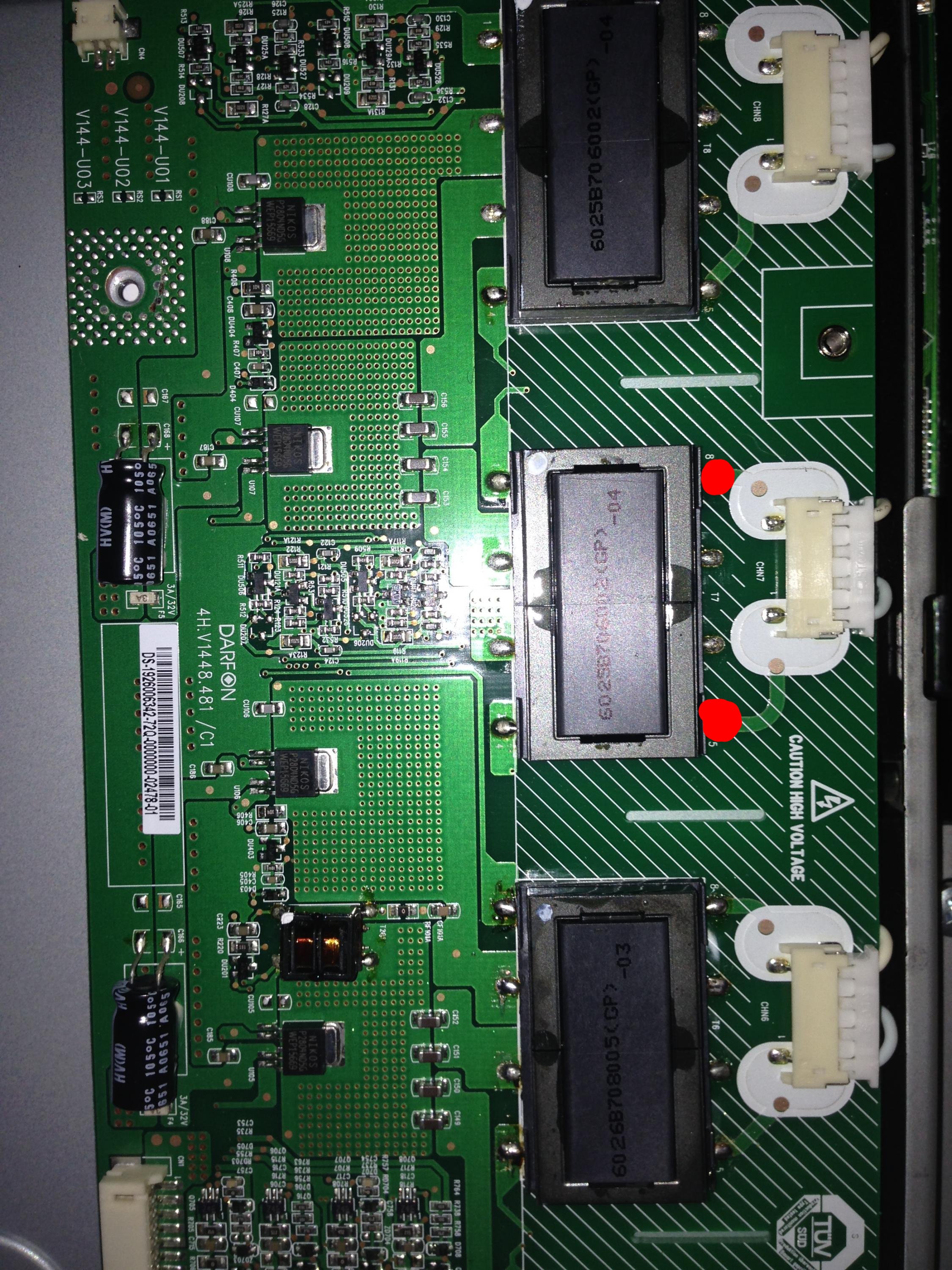

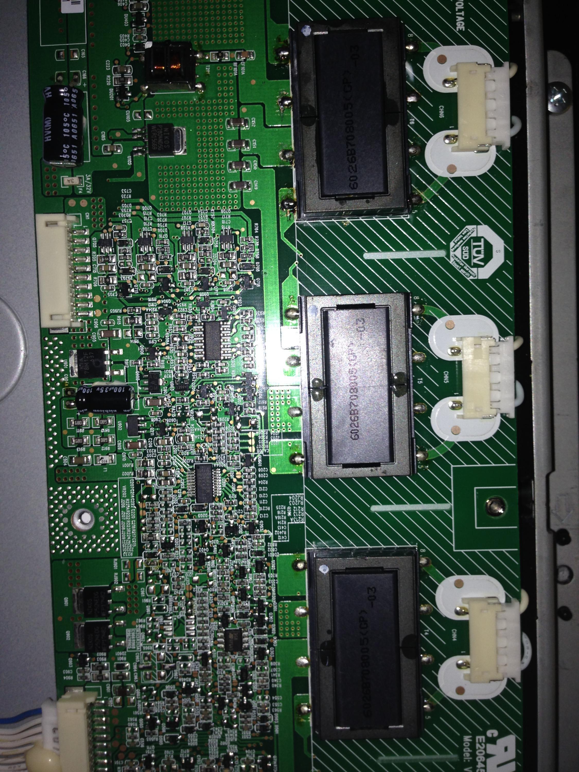

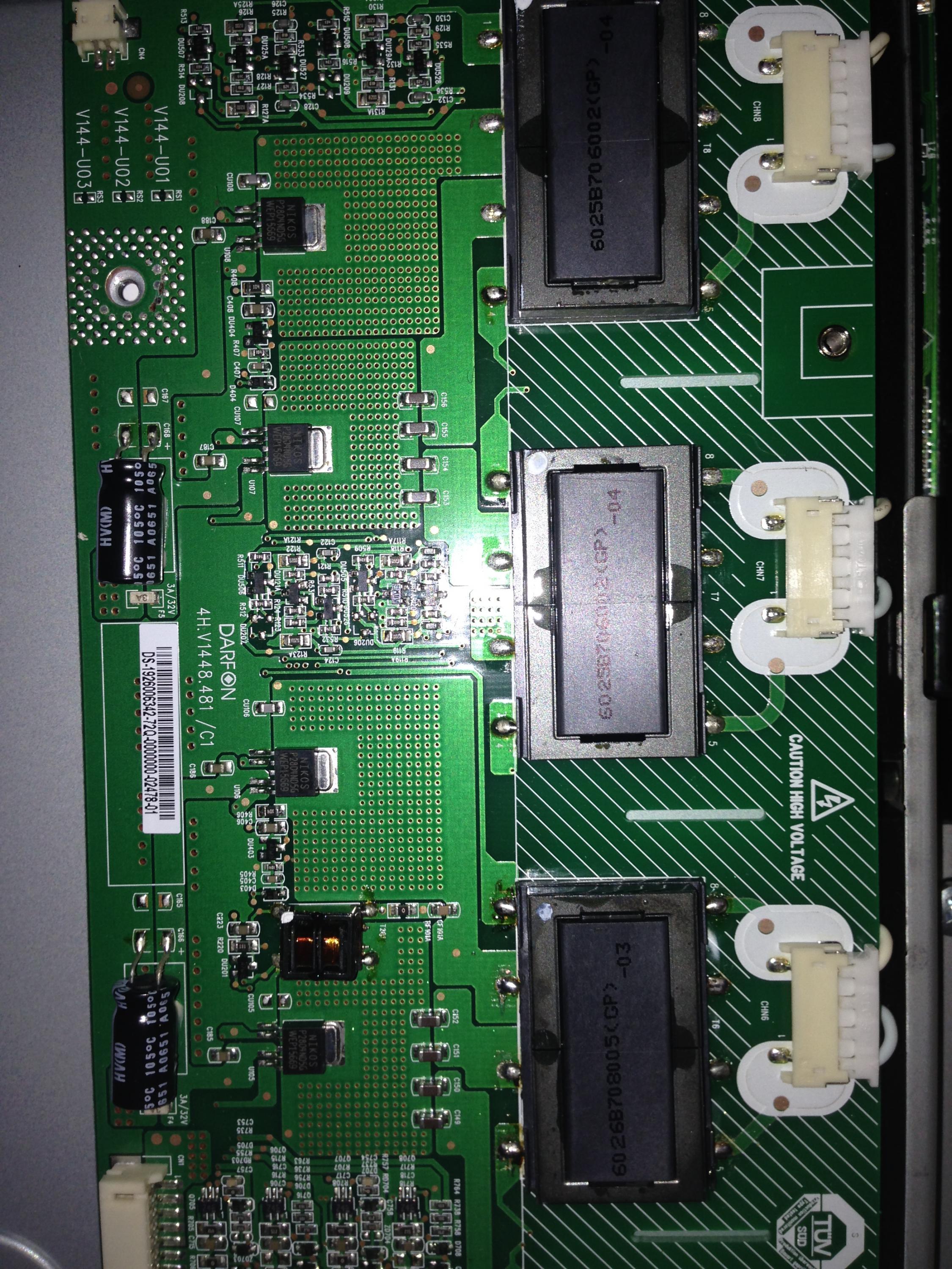

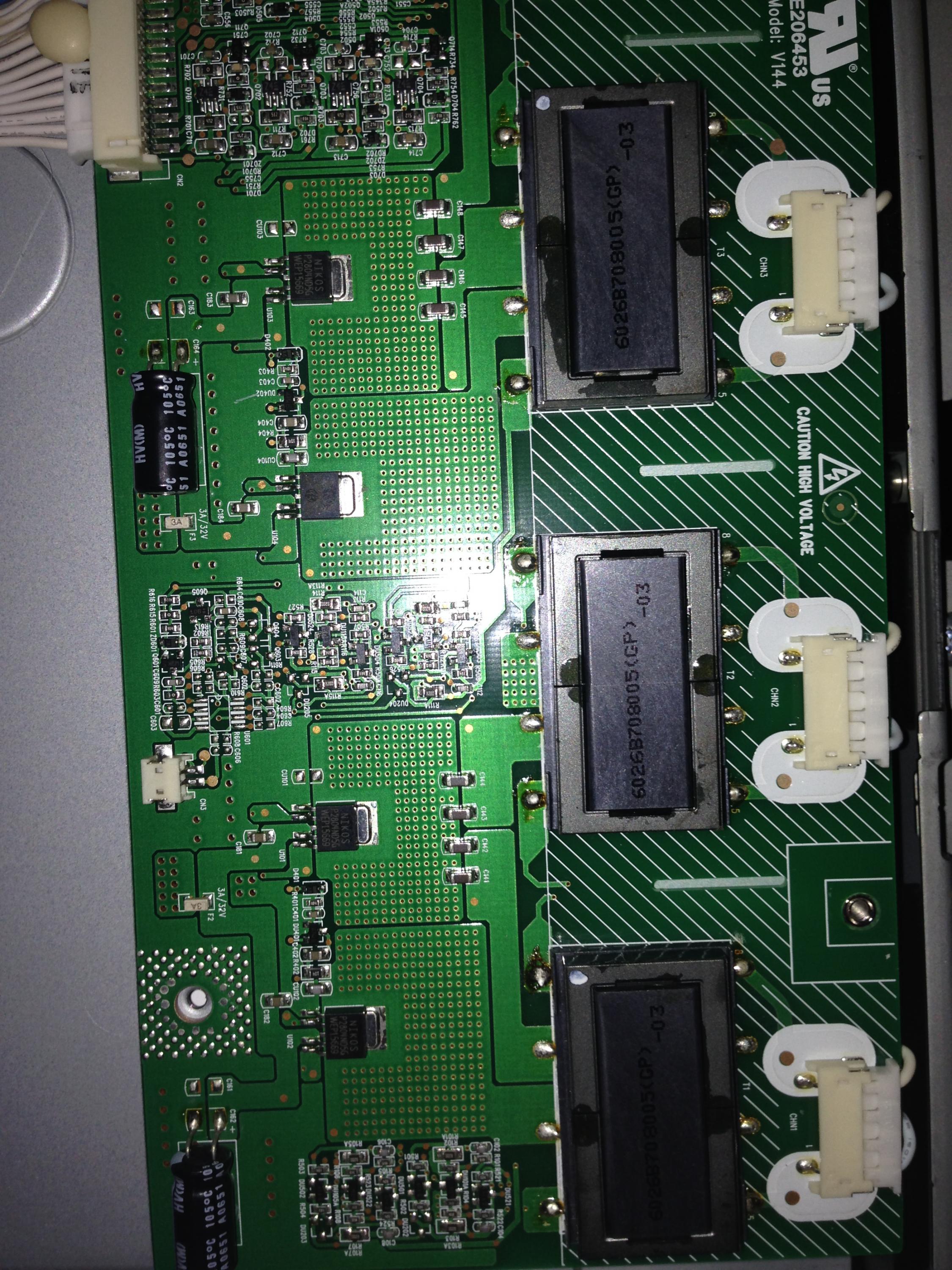

                      OK, now remove the shield from the inverter board. That's the board the white and black cable goes into. Take good clear photos of it; if necessary, split the board into different photos.
                        Re: le37r87bd help
                        ok will do thats now
                          Re: le37r87bd help
                          pics

                            Set your meter on ohms 2000 and test each transformer between 1 and 8 and 4 and 5
                            and post results ( NO POWER TO BOARD)
                              Re: le37r87bd help
                              Set meter on 20000 ohms (20k ohms)
                              Test across points highlighted. Record reading and post here.
                              Repeat for all transformers on the board. Pins 5 to 8.
                              POWER TO INVERTER MUST BE OFF - UNPLUG TV!
                                Re: le37r87bd help
                                on first pic the bottom i think ic ? looks like its been changed befor and a poor job aswell
                                  Re: le37r87bd help
                                  Wouldn't surprise me - the transformers in these frequently fail.
                                    Re: le37r87bd help
                                    Yes - meter on 20000ohms must be inflation!! the 2016 is just over 2000 so if this is the same would be off scale!
                                      Re: le37r87bd help
                                      ok so on that side of board most r 6.06 some r 6.01 but the one i said about dont get a reading
                                        Re: le37r87bd help
                                        The one which has been replaced you do not get any difference from probes not touching?
                                        I would check it is soldered right - if so it might be a dodgy part or bad luck.
