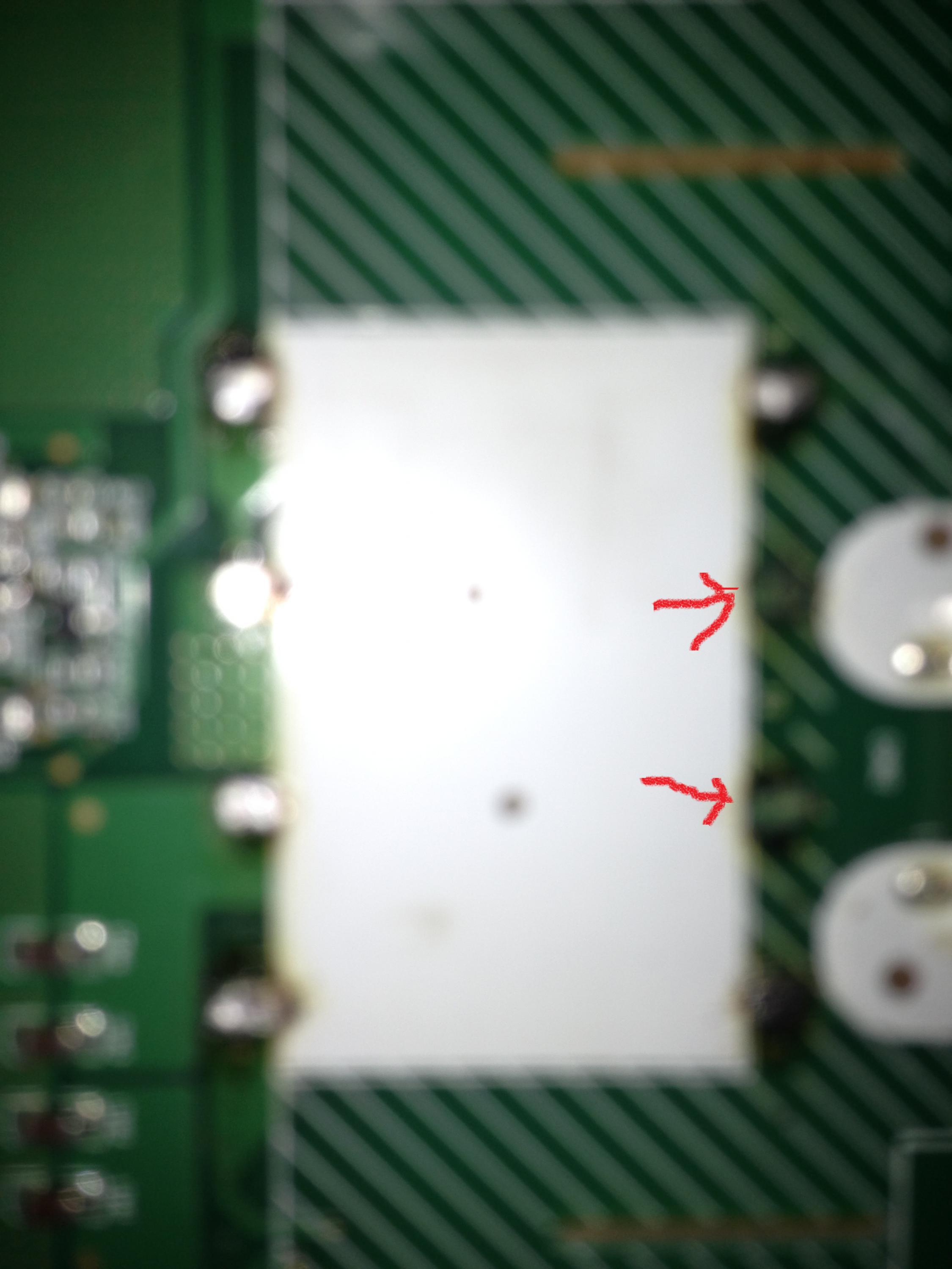

                tom on the board there dont seem to be solder spots for all pins ?
                  Re: le37r87bd help
                  I can see solder spots on all pins. The other pins might be mount points, but they're still soldered.

                    theres noting there to solder on the middle 2

                      pic

                        Needs better focus, but looks like the pads have been ripped off. Since there are no traces there this isn't a major problem, but I would add some glue to hold down the new transformer.

                          its ok gonna buy this http://cgi.ebay.co.uk/ws/eBayISAPI.d...m=181199389500
