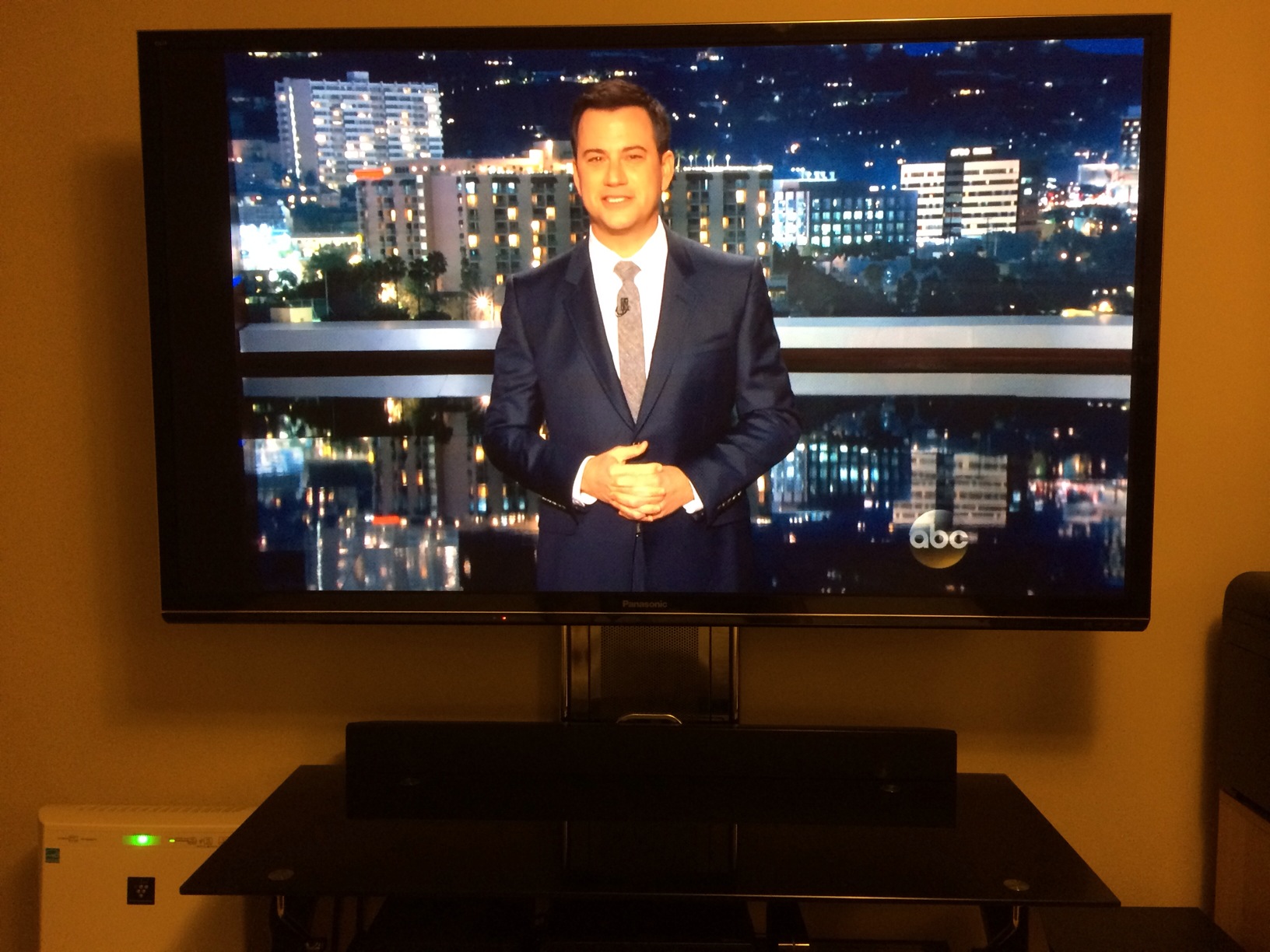

    Panasonic TV has 2 inch vertical line.

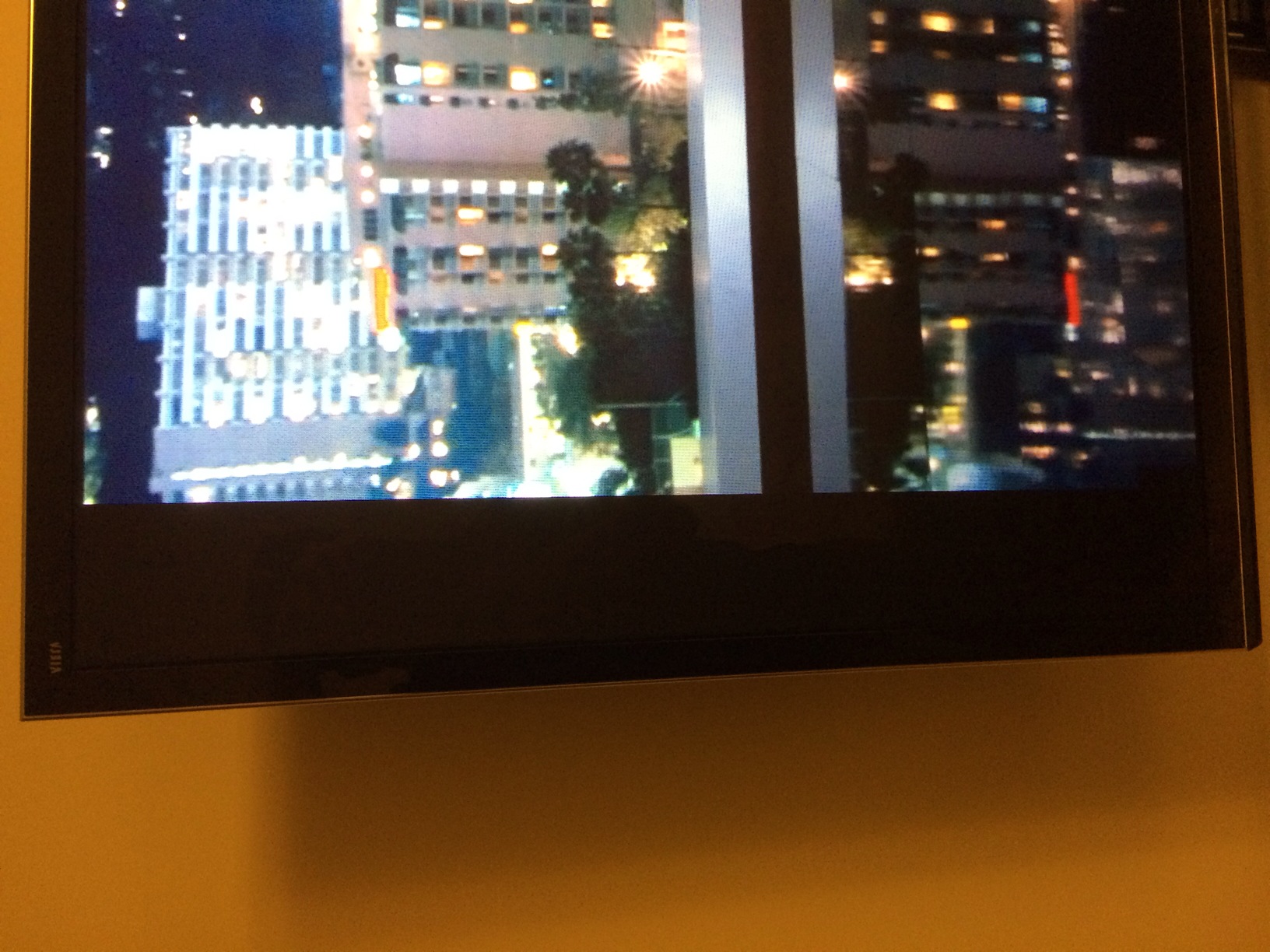

    I purchased a Panasonic 60" plasma (TCP60GT50) about a month ago. A week ago I heard a "pop" sound coming from the unit when I turned it on. The unit now has a 2.5 inch wide black vertical line on the left side of the display. The area on the left seems to just not display anything. Given the noise I heard, I presume it's a popped capacitor. I have a lot of experience repairing computers, but I don't have any experience repairing TVs and Panasonic has been less than helpful in terms of sending out a tech to look at it.
    Any advise in terms of what may be the problem would be much appreciated.

    new or used? Unlikely badcap. Worst case scenario the panel ribbon with chip on film IC. non repairable.
    If it has wty, I wouldn't touch it. Could be C buffer board but there's very little on them.
    Any pictures of the issue although I think I get what you describe. This is a fairly young TV.

      Yes it was purchased brand new. I know it has warranty on it but I am still curious to find out what the problem maybe.

        some manuals to read. there is a mirror function in service mode to flip the image but a popping noise , I would not expect A-board.

          Not sure if they can tell if you've entered service mode , definitely Panasonics problem to solve.
          My 2 guesses are c board or PDP fault. Nice looking set.
          Hope they sort it out for you soon.

            it is the pdp Panasonic having a lot of problems with their new displays
