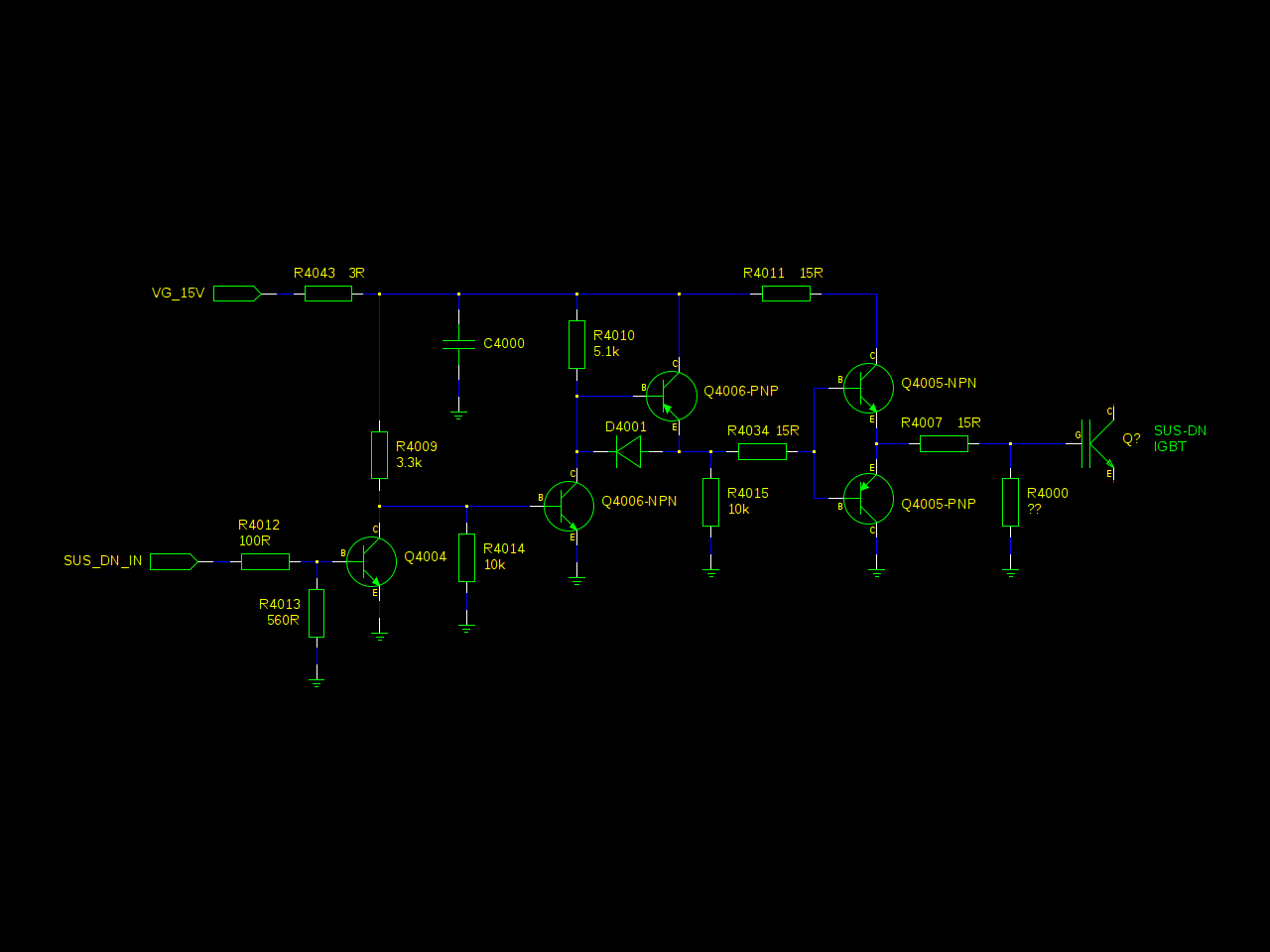

        Re: My first plasma, RCA 42PA30RQ - Sound but no picture
        I suspect Q4005 is a dual NPN/PNP pair transistor or possibly CMOS pair for gate drive, but NPN/PNP is most likely.
        Pin out guess:
        1. Vcc/NPN Collector (+15V)
        2. Vss/PNP Collector (GND)
        3. Input drive
        4. Output
        5. Input drive
        Q4006, not sure exactly, possibly dual NPN device as all pins appear uncommitted.
        ...Last post was an error in top mark decoding, had it confused with wrong device.
                Q4006 -maybe-:
                  Q4005 ? Hn4b101j

                    #29
                    Originally posted by tw2005
                    Q4005 ? Hn4b101j
                    That might be it. It's got the right markings.

                      #30
                      Looks like the right part to me. I'm not sure about Q4005 though.

                          #32
                          No, Q4005.... Q4006, "5K", looks right and has the layout I'd expect.
                          • lookimback
                            • Aug 2013
                            • 1489
                            #33
                            Q4005 is 5K. Q4006 (far left) is marked 46. I think D4001 might be bad too. I'll pull it and check but in the board I get a reading regardless of polarity.

                              #34
                              Originally posted by tom66
                              Q4006 -maybe-:
                              This reinforces your find. This one MMBT3946DW1T1G, is marking 46(no K) different manufacturer same specs.

                                #35
                                And reinforcing that even further, I am able to test it and it acts as it would if that datasheet is correct. I tested it in board but with negative on 4 I get a beep on 3 and 5. Neg on 1 I get a beep on 2 and 6.

                                      #38
                                      I reverse engineered the circuit to prove to myself it is the right device, so I think you will just need to replace Q4006 and test the SMD resistors, the other parts should be OK. (The high side driver will still need replacing too.)

                                        #39
                                        I swear you are a genius Tom. Thanks.
                                        As for the components you were unsure of R4000 is 15 0hms, the IGBT was Q4007.
