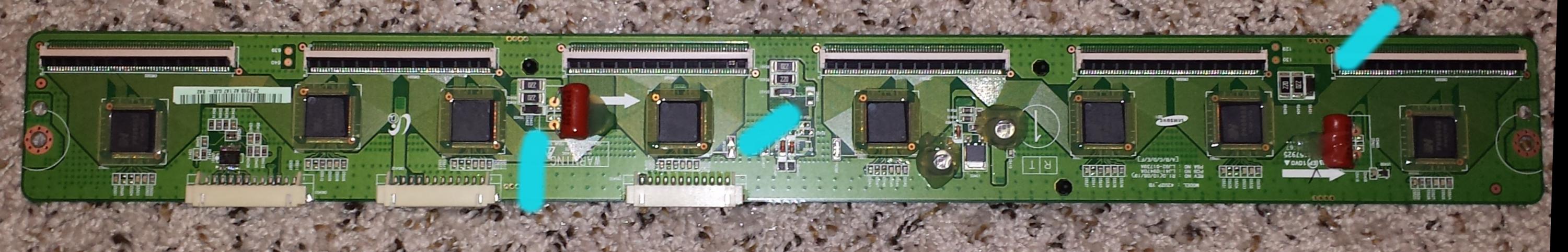

    So on the Y buffer I have 3 diodes (D5400, D5401, D5403) which I get about 3 ohms across. Removed from the board they are fine. I'm just guessing that this isn't normal. I removed IC U5401, not the problem. I'm pretty certain that the PN096S3s are the problem, I've ruled everything else out. But that only takes care of the Y buffer.
    I noticed that I get a slight hum from the X main if I have the Y buffer removed but not if it's in. I don't get a hum from the Y main at all. I haven't checked for voltages yet but that's my next move.

        What do you think about the Y buffer? Is it normal that I would have low resistance across those diodes I mentioned in my first post? Or should I suspect the PN096S3 ICs could be bad?

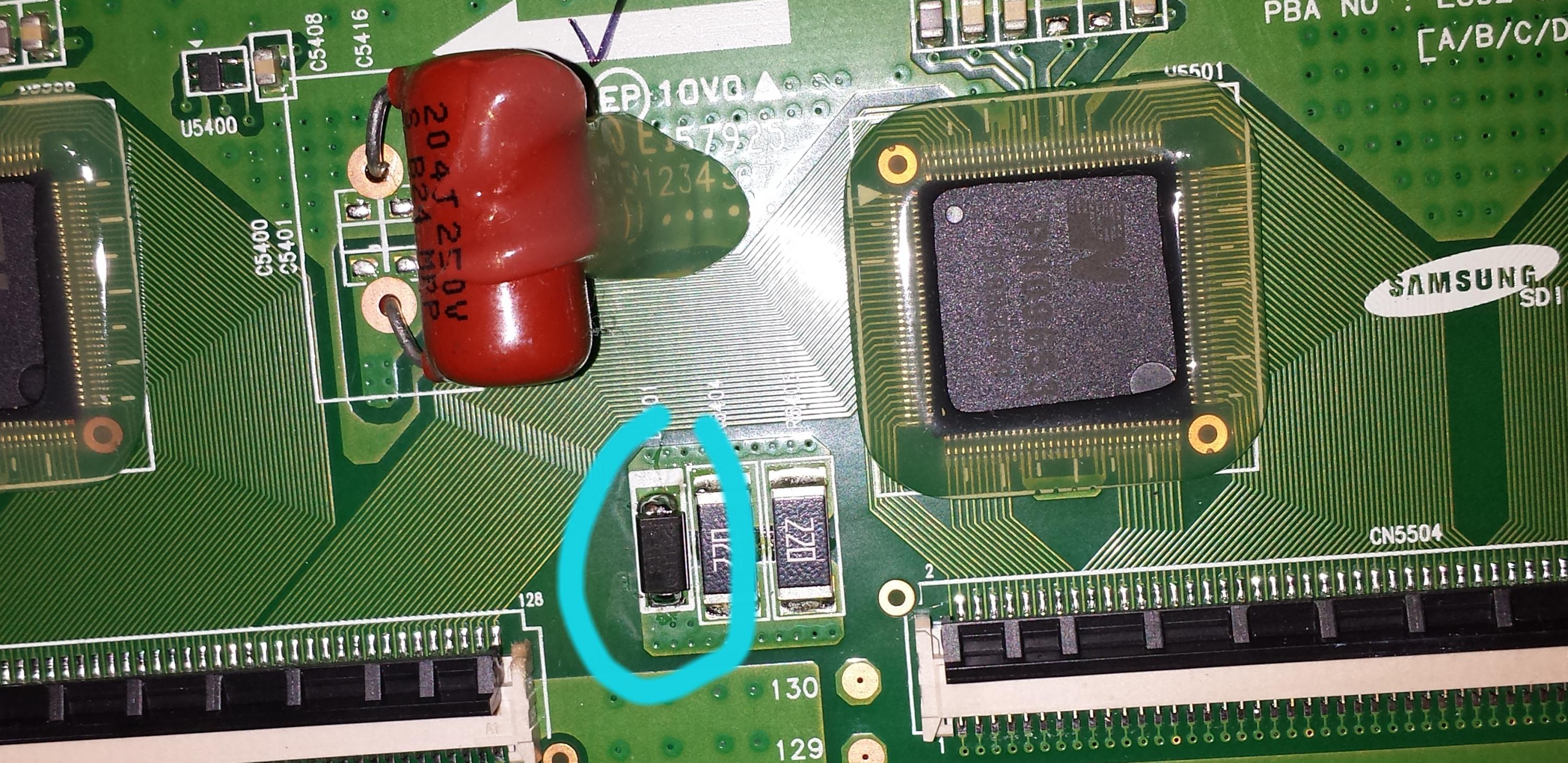

          Can you post a picture of those diodes? IIRC, they usually have some low resistance in parallel with them, they are for VSCAN circuit energy recovery I think.

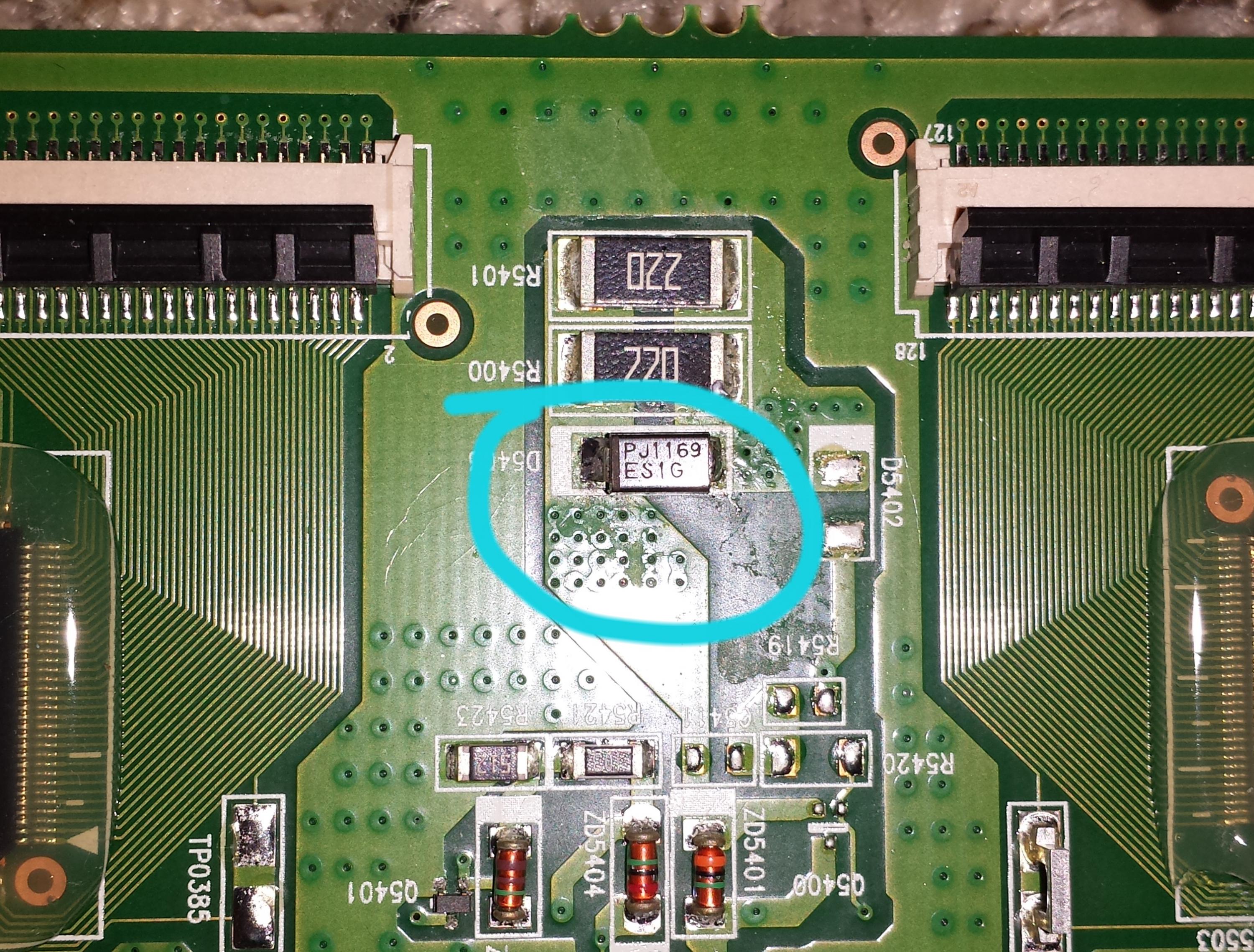

              Re: My first plasma, RCA 42PA30RQ - Sound but no picture
              Here's the pics. I got one good enough that you can read the numbers. They all have the same P/N.
              ------------signature starts here------------
                Yes so you can see the big 22R resistors in parallel so a low resistance reading is expected, 3 ohms is a bit too low, would expect around 11 ohms.
                  Ok, so something must be shorted. I'll pull the resistors first. After that nothing left but the PN096S3 ICs. Thanks.
                    Ah, wait a second, how many pairs of Rs? 3 pairs 2 each, they are all in parallel, there's your 3 ohms right there. Those Rs/Ds are only in SERIES with the VSC_H voltage, so the ICs going should would not cause that fault.
                    I'd look straight back at that X-main. Repair kit available...

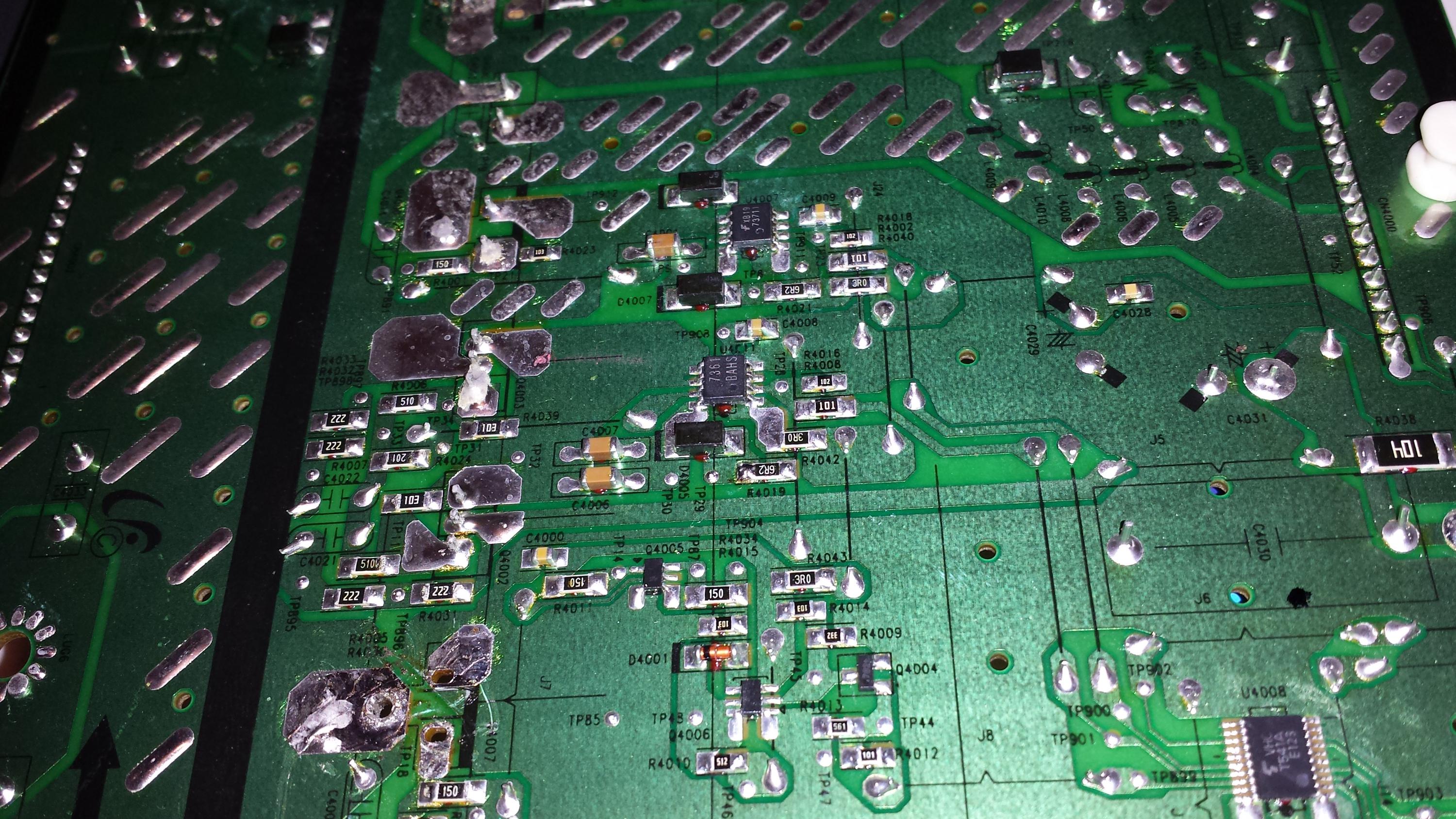

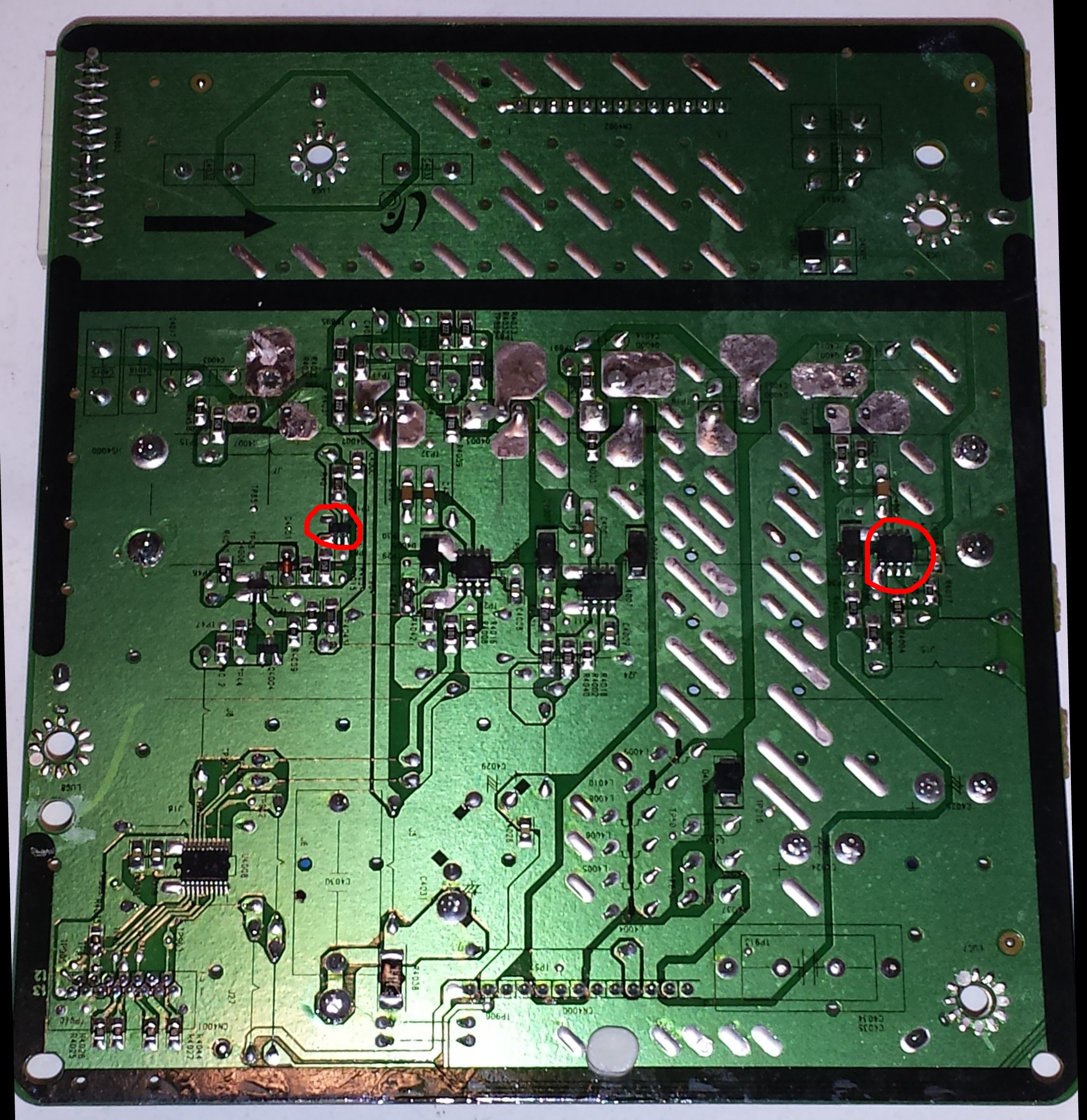

                            Here's the bottom of the X main. Can you point out the gate driver IC you're talking about please? Thanks.
                              Which FETs are bad? It's one of the 8 pin SMD IC near the bad pair of FETs.
                              • tw2005
                                • Oct 2011
                                • 6458
                                I made a feeble attempt with one of these xmains. Did the IGBTs only and they blew straight away. I gave up trying to identify those SMD parts, the board was so cheap.
                                Did the x & y swap, x damaged the y with all my fiddling.
                                buffer was ok , and fixed. that was a samsung same panel as this.
                                • lookimback
                                  • Aug 2013
                                  • 1489
                                  There was one bad on each end. I removed them before taking this pic. If you zoom in you can see where they were.

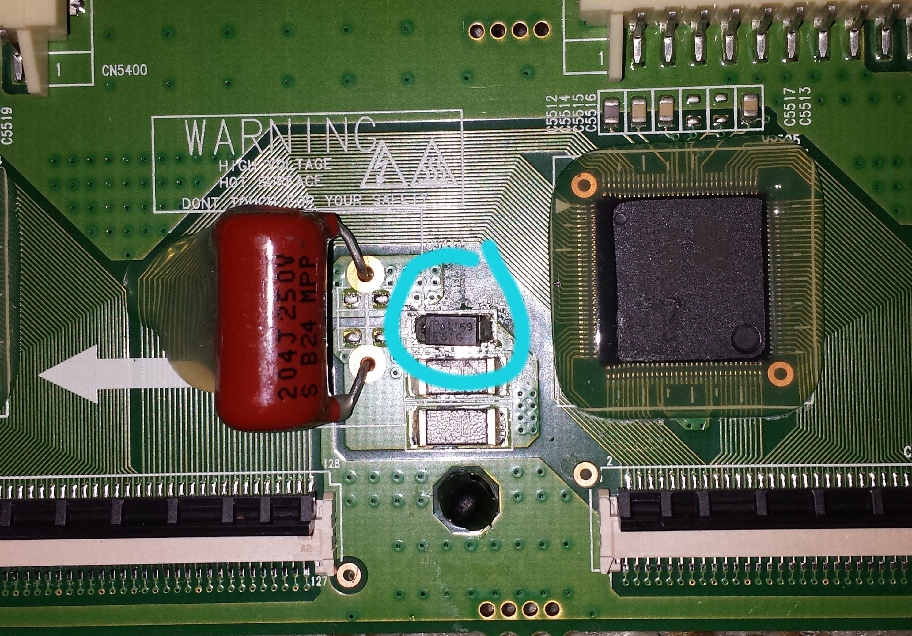

                                    I'd look into replacing these devices too then.
                                    • lookimback
                                      • Aug 2013
                                      • 1489

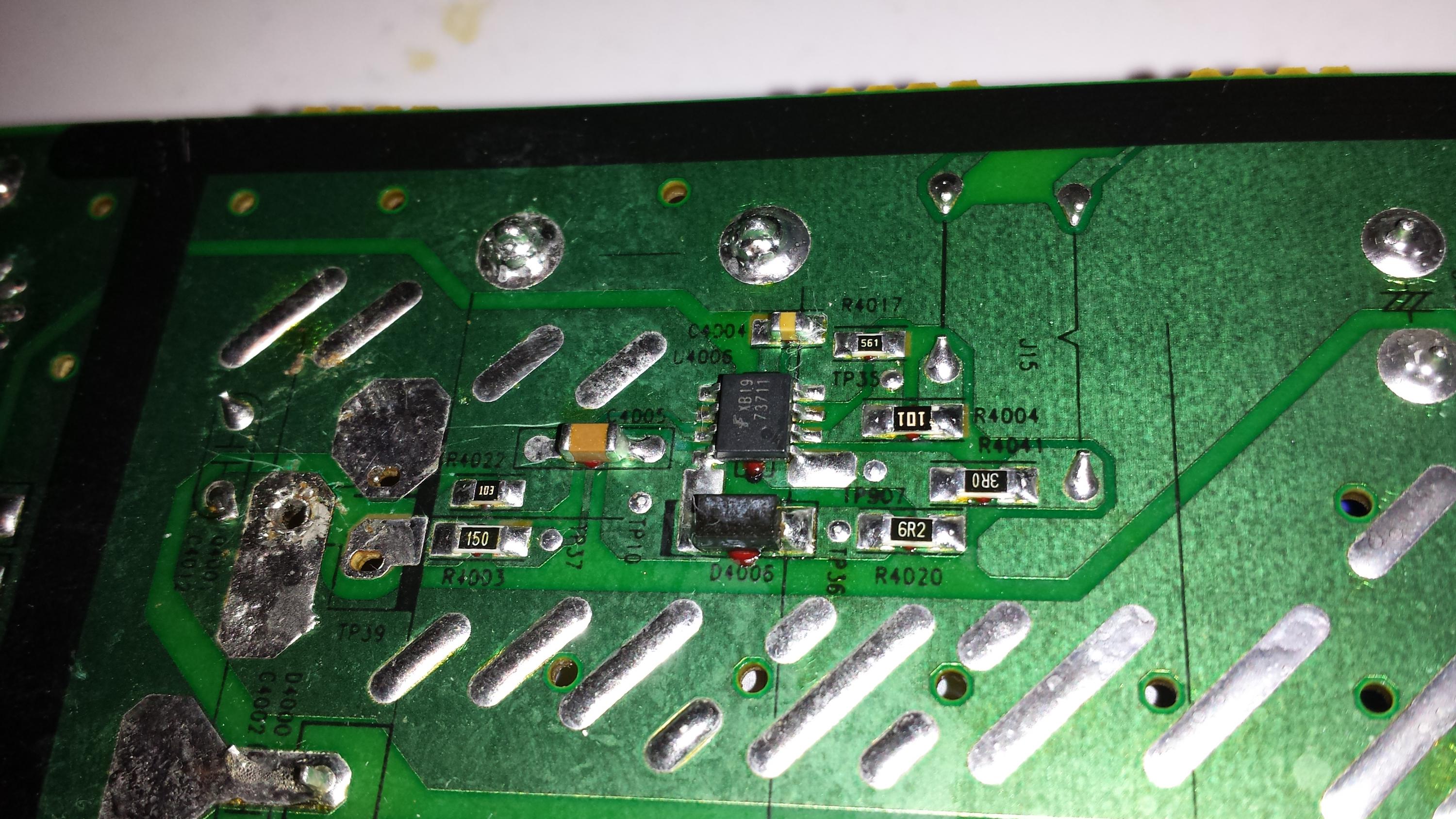

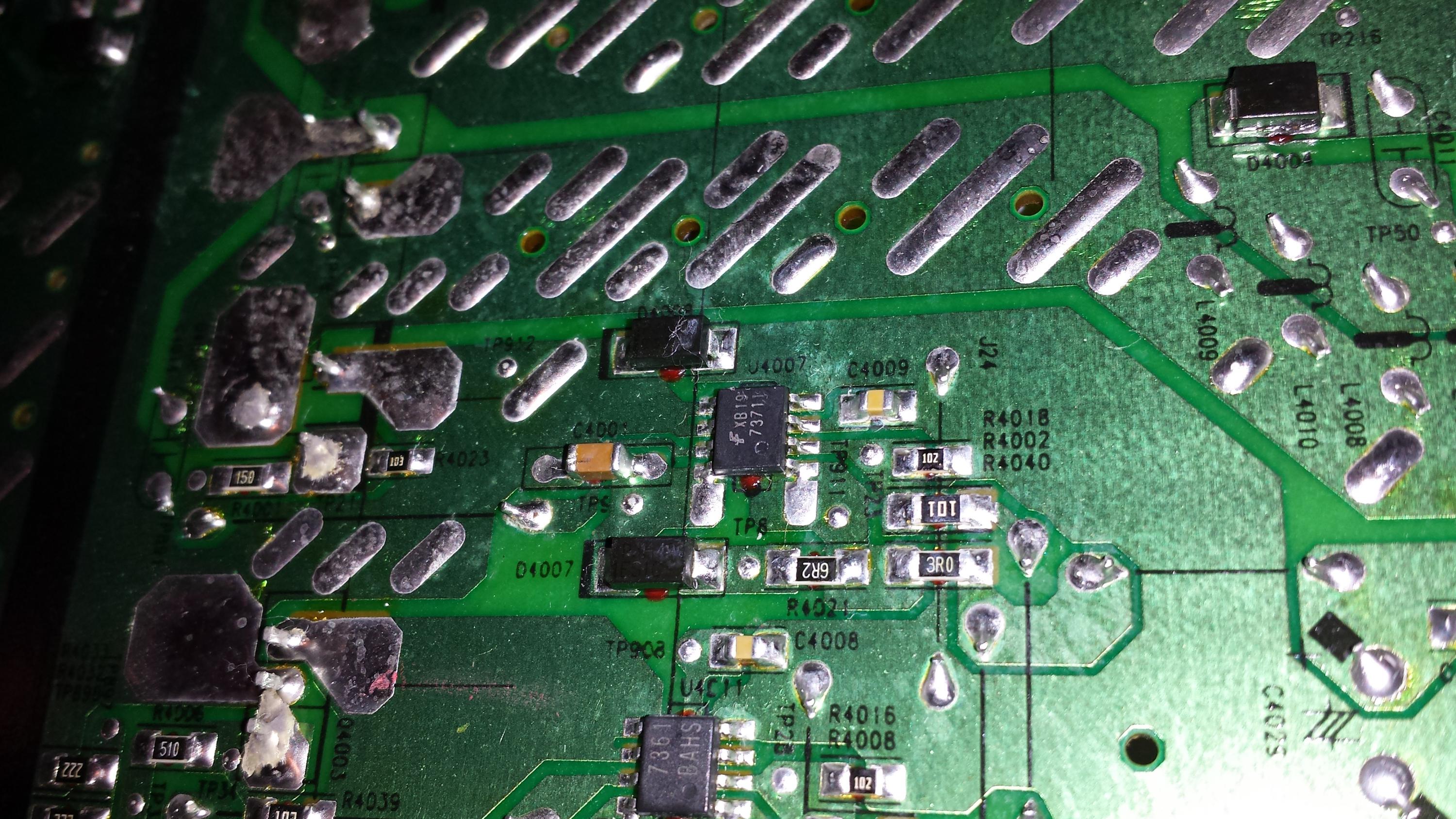

                                      Here's closeups of the ICs. The 2 on the right I'm pretty sure are FAN73711.
                                      The one on the left, not so sure but maybe FAN73611?
                                      Digikey has both if that's what they are.
                                      Datasheets for both are attached.
                                      • lookimback
                                        • Aug 2013
                                        • 1489
                                        Ok I just noticed your last post. The one you circled on the left is marked 5K. I'll try to figure out what that is.
