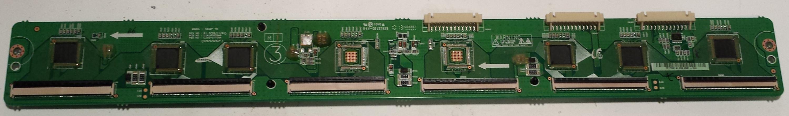

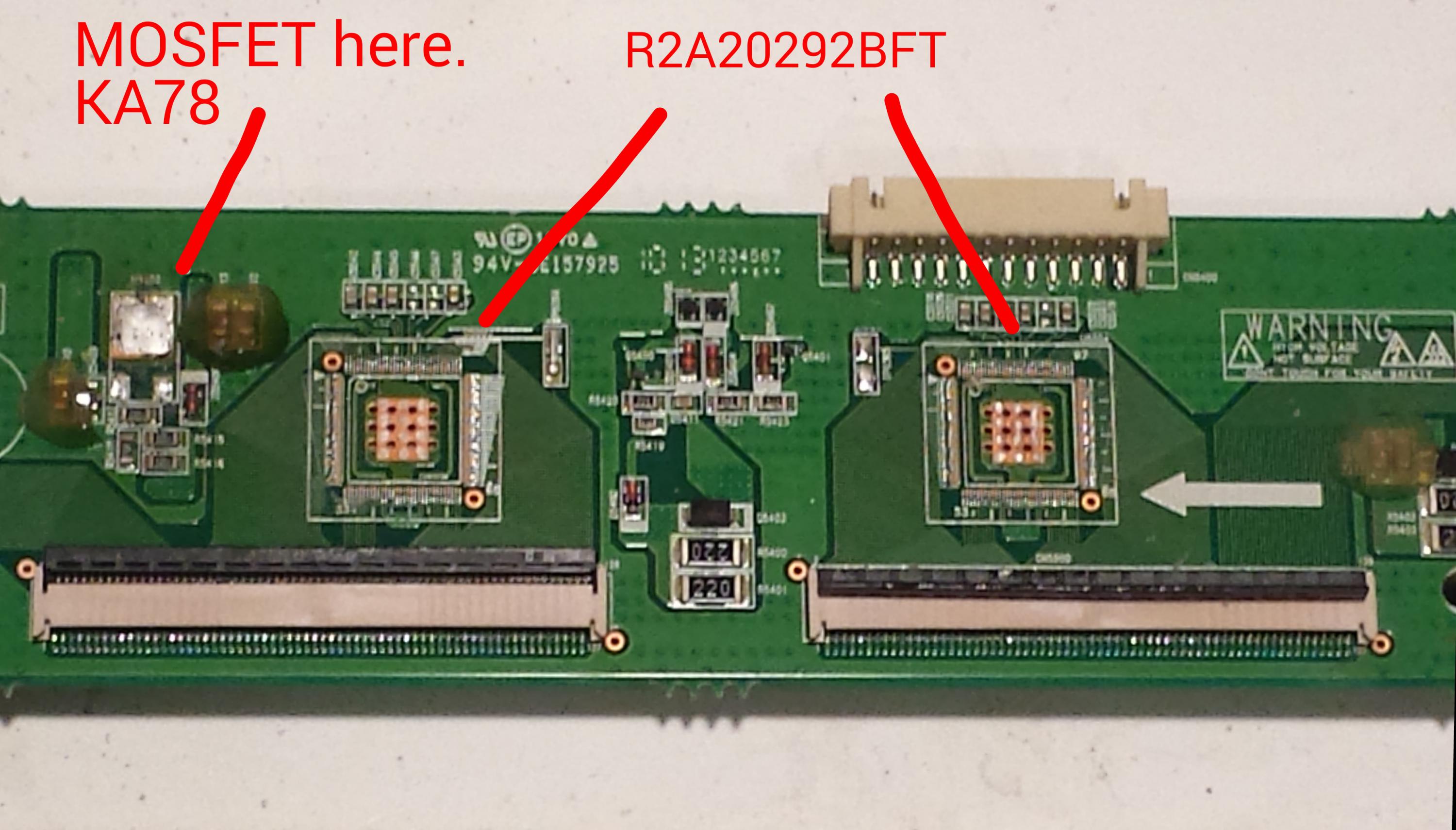

                                      Can't believe I've had this TV for 2 months waiting on parts. Well, I rebuilt the x-main and it fried right away. So something is wrong with the Y-main too. So I put it aside for a while because I haven't had time lately. Yesterday, out the blue, someone contacts me and has a Samsung PN42C450B1D with a broken screen. They only want $15 and will bring it to me. So I look on Ebay to see what the parts are worth and realize that it has the same parts as this RCA. So I get the TV. My plan now is to take the panel from the RCA and put it in the Samsung. I figure it will be worth more this way. Before doing so, I decide to test it with the RCA parts. I replace the x and y mains in the RCA with the ones from the Samsung. I get 1click and it stays powered on, but no picture. I turn it off, kill the lights, power back on. I see a few flickers. I figure it's the Y buffer. So I replace that with the one from the Samsung. Power on, and I get smoke and a hole burns through one of the r2a20292bft chips. Upon closer inspection it appears that there is a hole in two of them. I have a mosfet that appears shorted, I removed it and still have a short between the pads. I remove both of the r2a20292bft chips and the shorted pads aren't shorted any more. Does it sound like I can just replace the two r2a20292bft ICs and the MOSFET? Or should I replace all 8 r2a20292bft ICs?
                                      ------------signature starts here------------

                                        #59
                                        Re: My first plasma, RCA 42PA30RQ - Sound but no picture
                                        Here's some pictures.
                                          #60
                                          KA78=not a FET, it's a 7805 regulator.
                                          Having a short between the pads is odd, could indicate more ICs are bad (floating 5V or such...) Need exact pinout of the IC to confirm.
                                          If possible I would use the RCA buffer as these Samsung panels are well known to eat the buffer board if the screen is smashed and it's powered on with a smashed screen.
