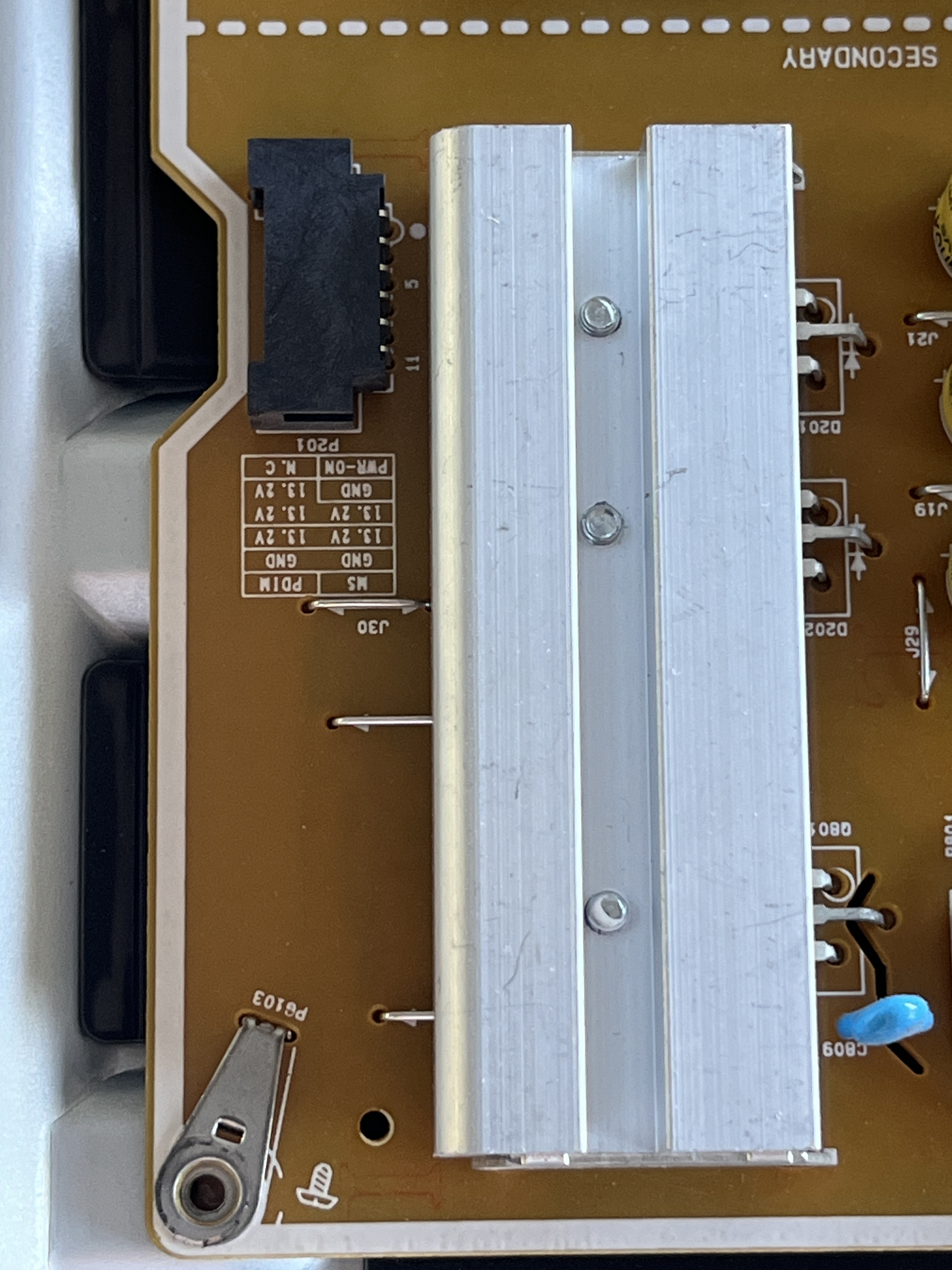

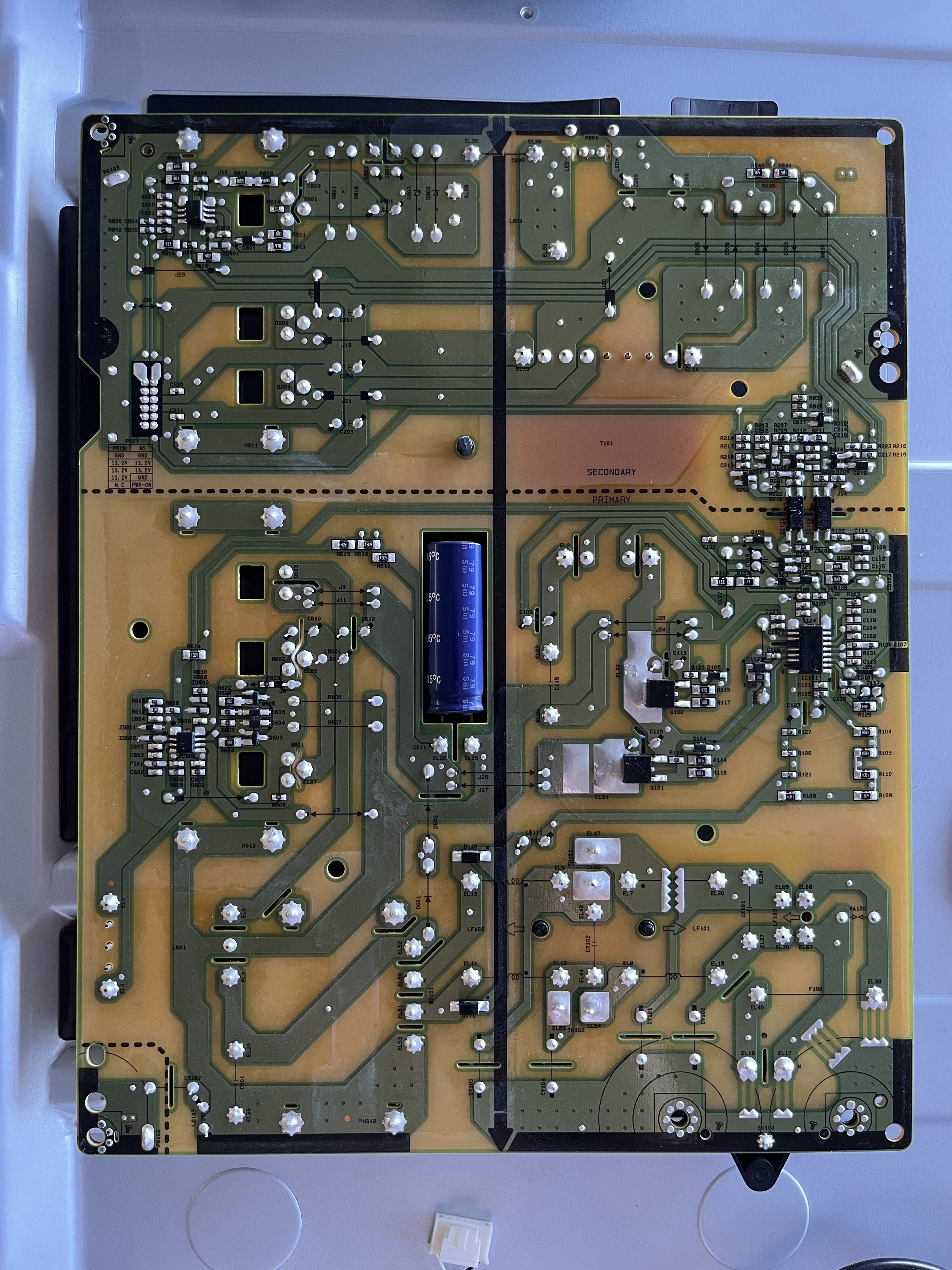

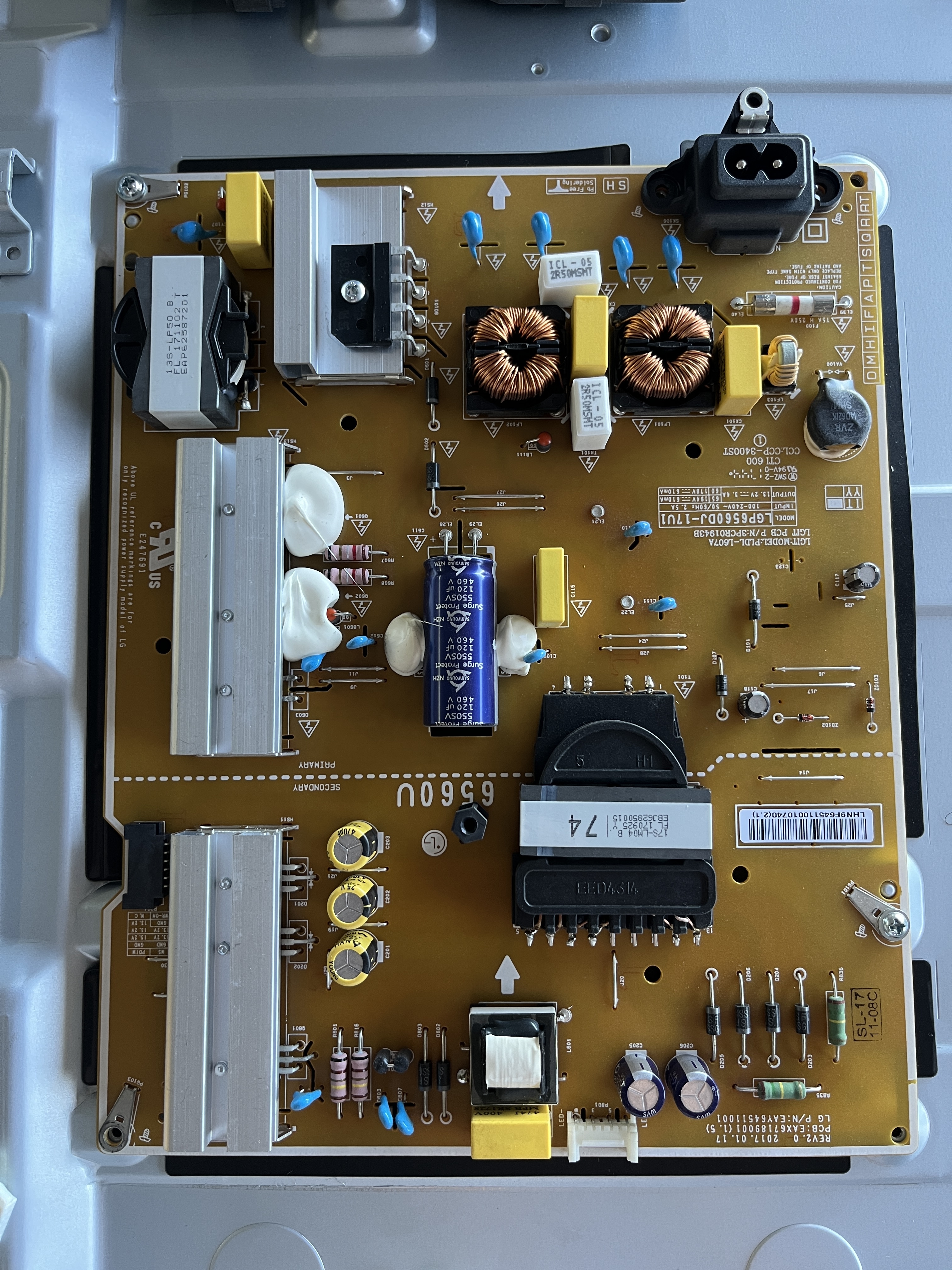

    I can see the image in the background with a flashlight. I have 260V on LED+ and 90V on LED -. The backlights were acting weird with my tester so I pulled the panel and one LED does take about 2 seconds before it lights up but thats it. Is the voltage at the LED connector correct?

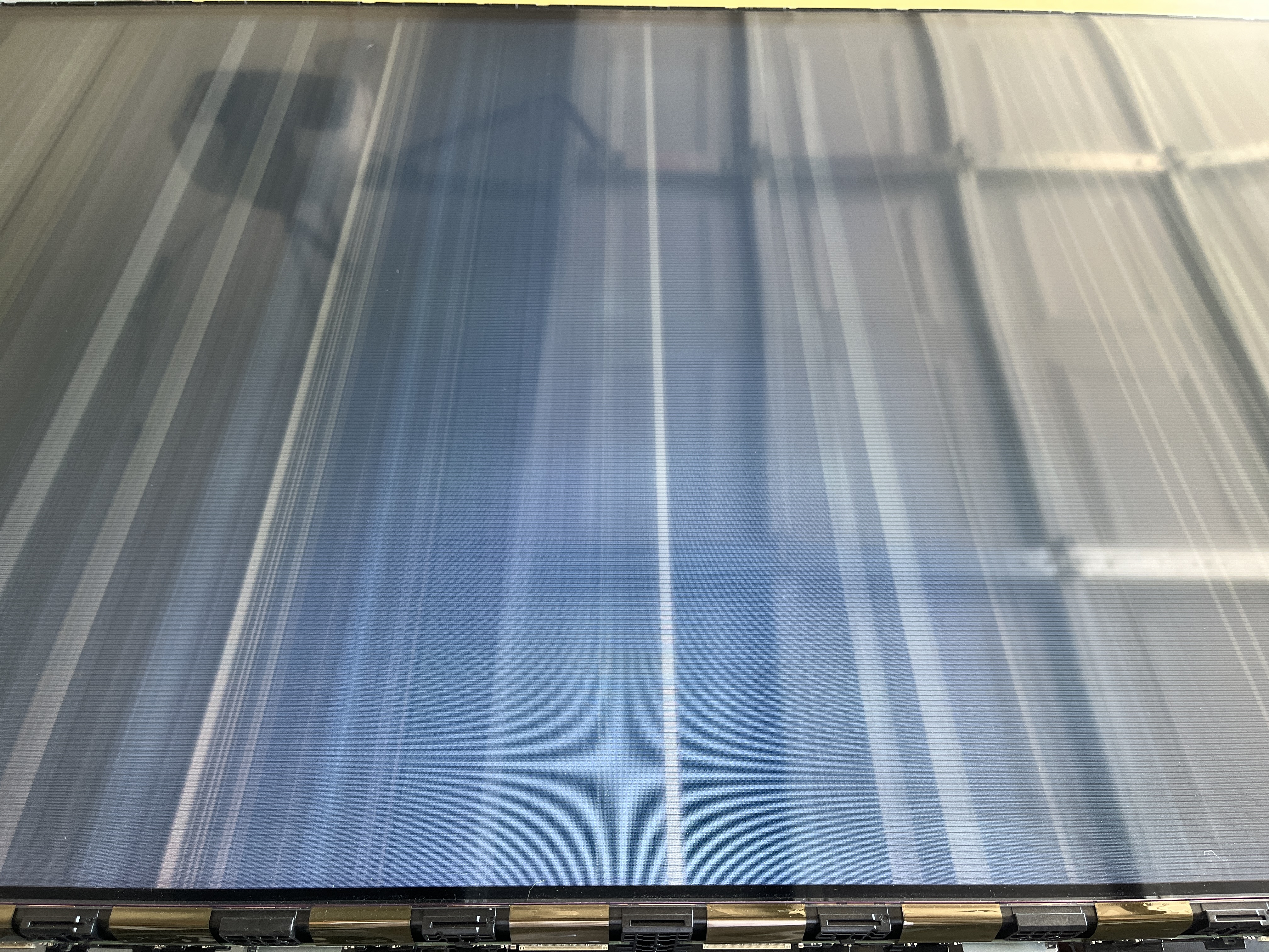

          Ok, the connection at the backlight is loose. But now I have horizontal and vertical bars all over the screen. If I disconnect the left TCON cable the left side is almost black but I can see horizontal bars. If I disconnect the right the right side is bright white and the left is still black to dark grey with horizontal lines. The right side starts off with black horizontal bars but mostly clers up after about 15 seconds.
