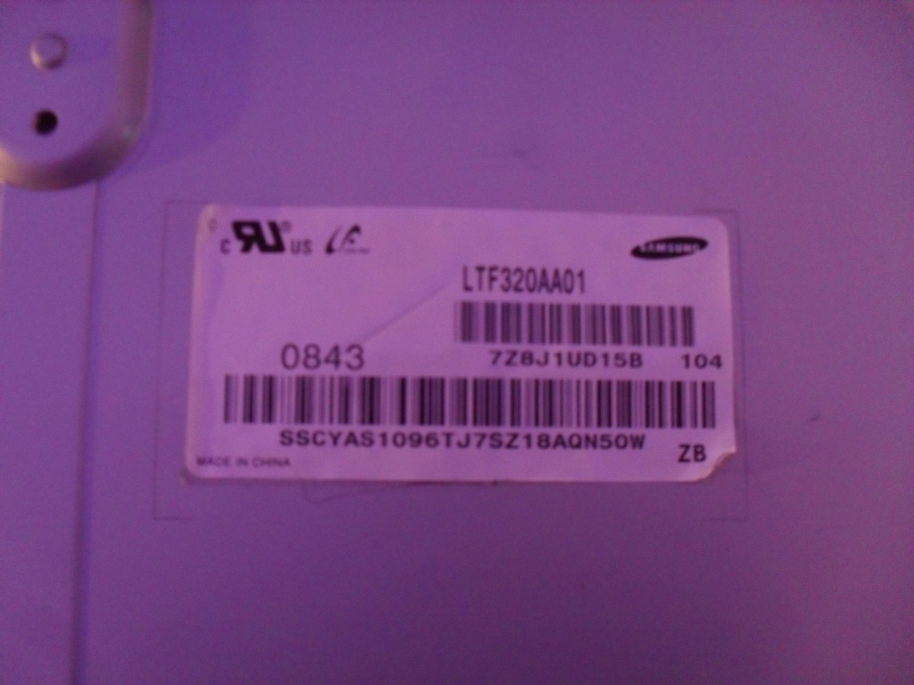

    hi there guys have a Samsung LE32A455C1D given to me by a neighbor because it had a smashed screen, because it was a white TV and looked rather nice (girlfriend wanted to keep it) i decided to see if i could get a LCD screen for it. the picture indicates the label of the original LCD panel, here is the link to the one i purchased : http://www.ebay.co.uk/itm/2812547981...84.m1497.l2649
    after i recieved screen and installed the tv switched on as normal and so did backlight but no picture. could someone shed some light on this or have i purchased wrong screen ?

    Did you use old t-con or one with panel?

      the one that was original with the TV Tom66
        Re: Problem after Replacing Screen on Samsung 32" LCD LE32A455C1D
        The panels are different revision, which might cause this problem - you would need to make sure you use the right t-con in the right panel.
        It could also be a bad LCD panel. Did seller indicate how panel was tested and verified working?

                Hi Tom66 i mailed the seller and this was the response "Hi all panels are removed from working tv.100% working part.Original t-con board for this panel is 320AA05C2LV0.0." how will i find out if that T-Con board is compatible with my AV/Main board
                  Check P/N. Who pulls working panel from working TV? Surely TV assembled is worth more. Questionable.

                          ok Tom66 ordered T-con board for that LCD panel and when i put the ribbon in it just get coloured lines running back and forward on the screen, what could be the problem.. i tried putting LVDS cable in other way on main board but just got black screen.

                                  Do those lines change at all--say with scene/channel change or bringing up the menu etc?

                                    Good chance you've got a bad panel there. Same model I did in black with similar fault...
                                    https://www.badcaps.net/forum/showthread.php?t=25839
                                    I reckon you've been sold a dud panel mate... This is why I really don't bother with panel replacements as you just don't know if panel is ok

                                        no they dont move or change colour etc when i press menu or input / change channel etc
