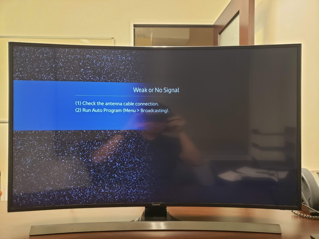

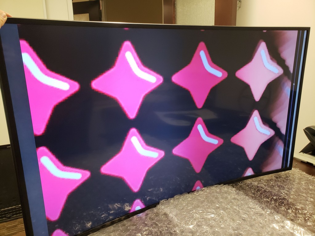

    Samsung un48ju6700 half screen ghosting problem
    This curved LCD TV has an issue affecting just the right side of the screen. It is not a backlight issue, although it might appear so from one of the attached images. The problem appears to be the right side of the screen not updating properly. Moving images on the very right side will leave a trail of ghost images. Although even just the computer cursor sitting still makes a vertical ghost band the entire height of the image. The color on the right side also looks like it doesn't have the full bit depth (the Windows background looked kind of dithered on that side).
    I went into service mode and ran the various image tests, but all of them showed the same kinds of issues as mentioned.
    Is the problem likely to be the T-con board, or the boards that connect to the bottom edge of the LCD itself, or something else?
    Things I tried already (with no effect):
    - swapping the left/right FPC cables between the T-con board and bottom edge boards.
    - swapping the FPC cables that join the outermost bottom edge boards.
    - undoing/redoing the clamps on the FPC cable between the main board and T-con board.
    - gently pressing along the bottom edge boards and FPC connectors.
    The pink star pattern is this image: https://support.lensstudio.snapchat....D0EBiX_5yg.gif
    that I just magnified until it filled the screen. It's not so obvious in the picture, but on the TV, the color is very faded on the right side.

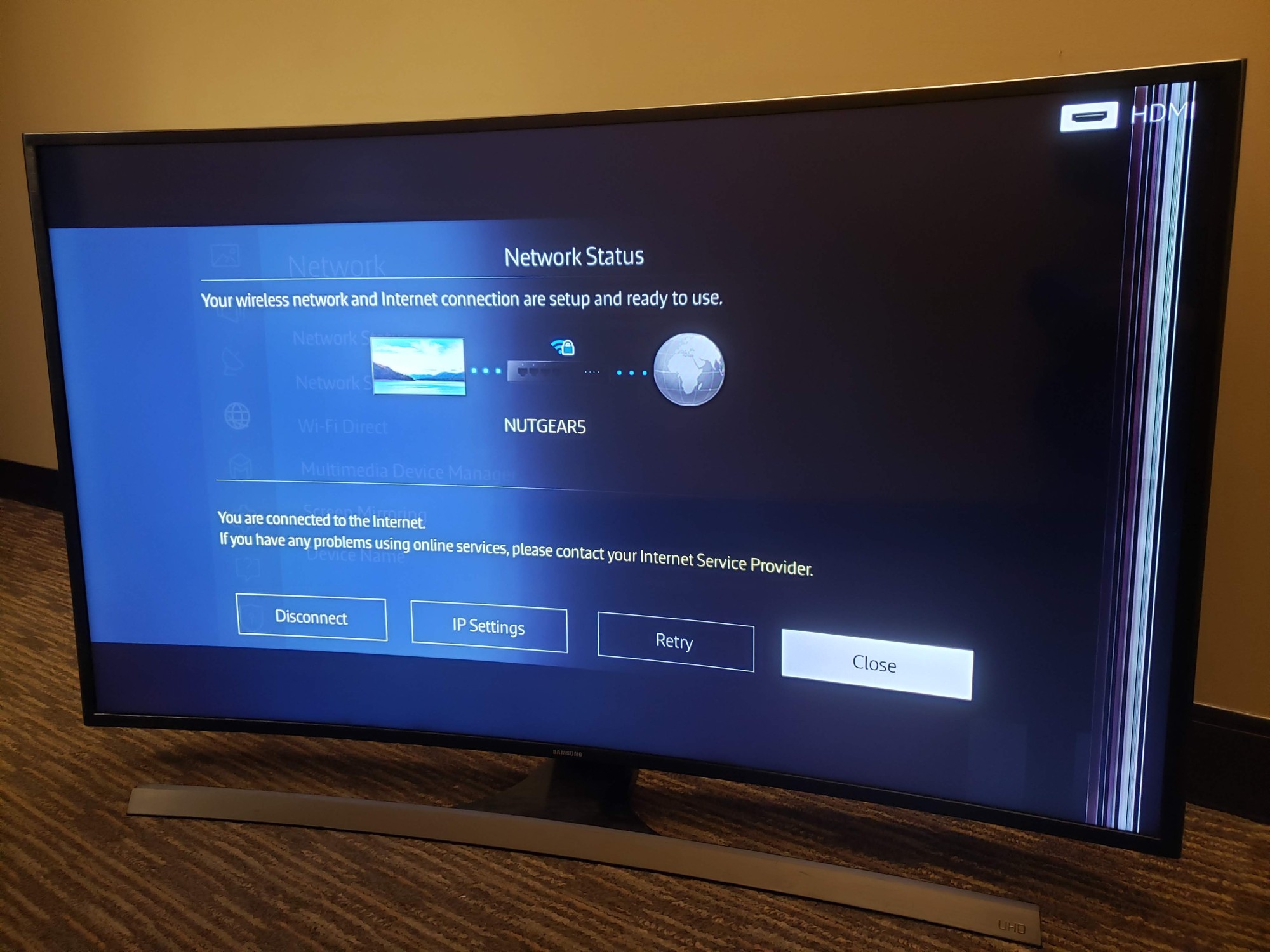

    Re: Samsung un48ju6700 half screen ghosting problem
    Here's another picture I'd taken. Notice how the letters "HDMI" get smeared up and down the right side, as well as the disappearing background.

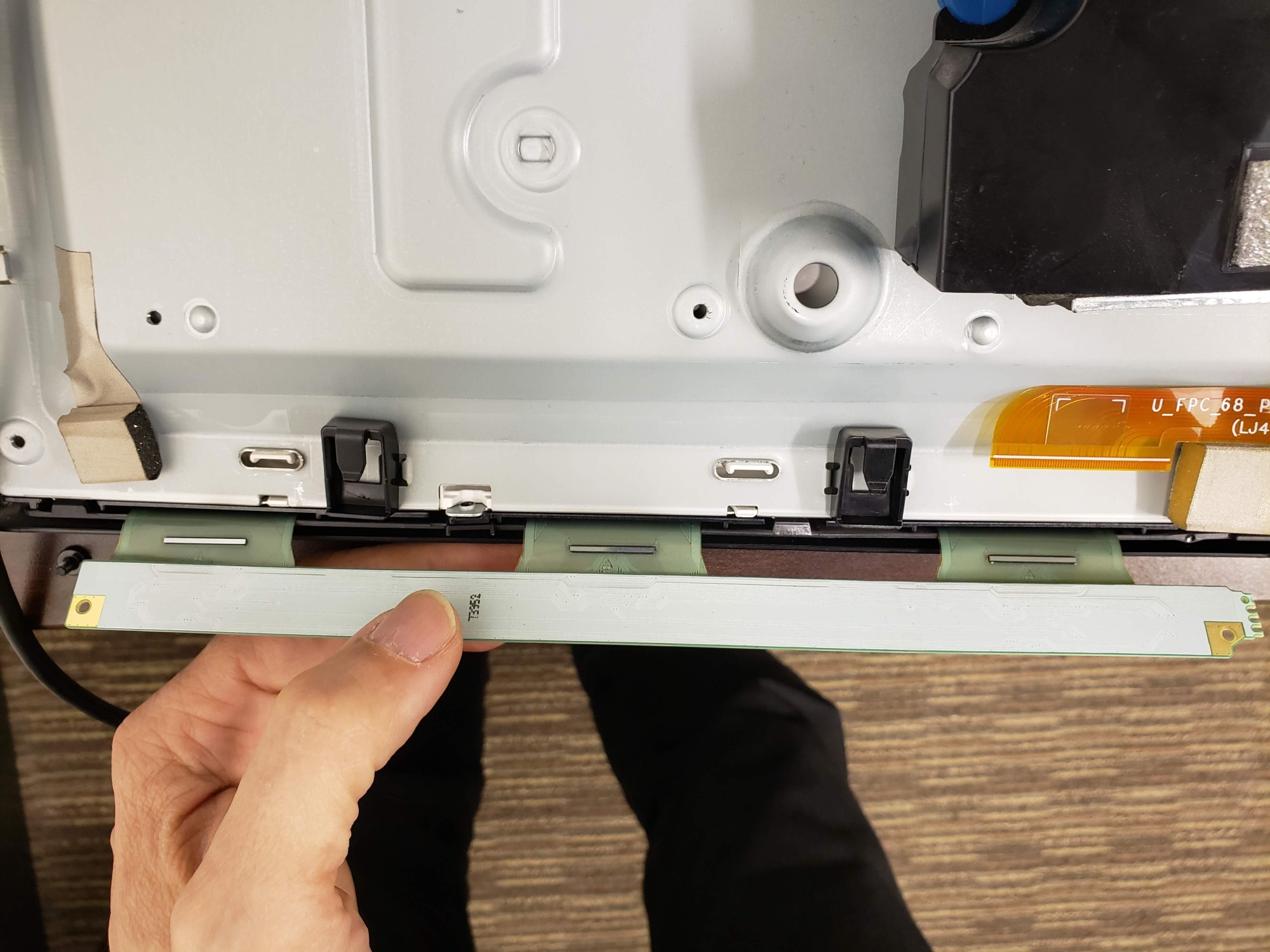

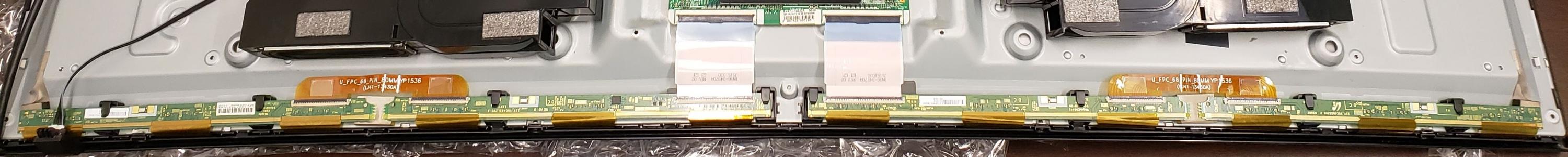

            From looking at Youtube videos of repairs of Samsung TV's of similar vintage, it seems like there are only tabs on the bottom of the screen.
            (This TV has 60 sets of plastic clips that hold the front bezel and rear metal to the LCD assembly, and I can't see the sides of the LCD without undoing all those.)
            The tabs on the screen bottom have no test points. There are COF driver ICs, but again nothing to problem on the flex either.
            Is it possible that the outer pair of tab boards are the horizontal drivers?
              Yes much probably you don't have side tabs, so the only way if i'm right is to block clock lines or start signal to the bad side..

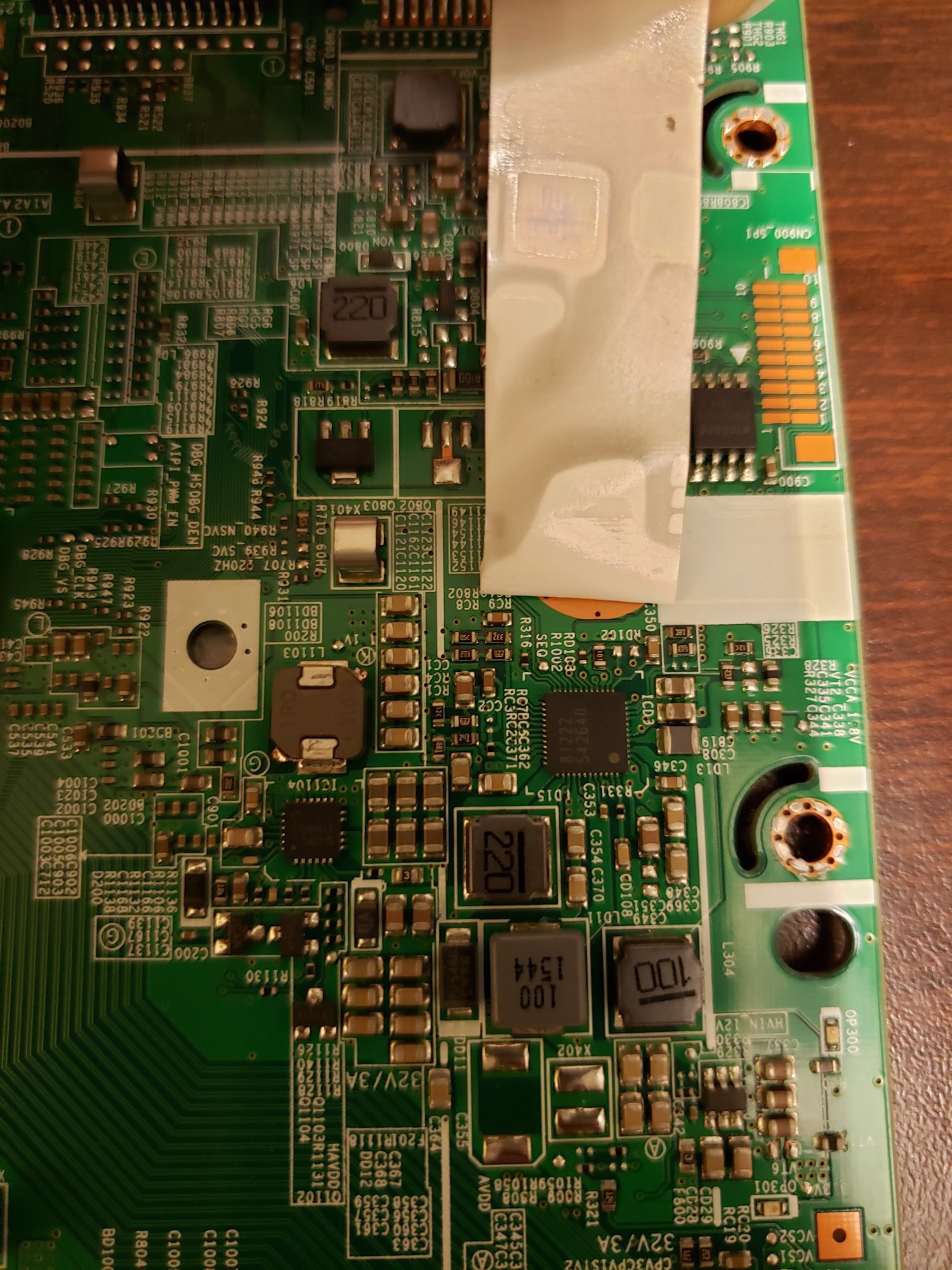

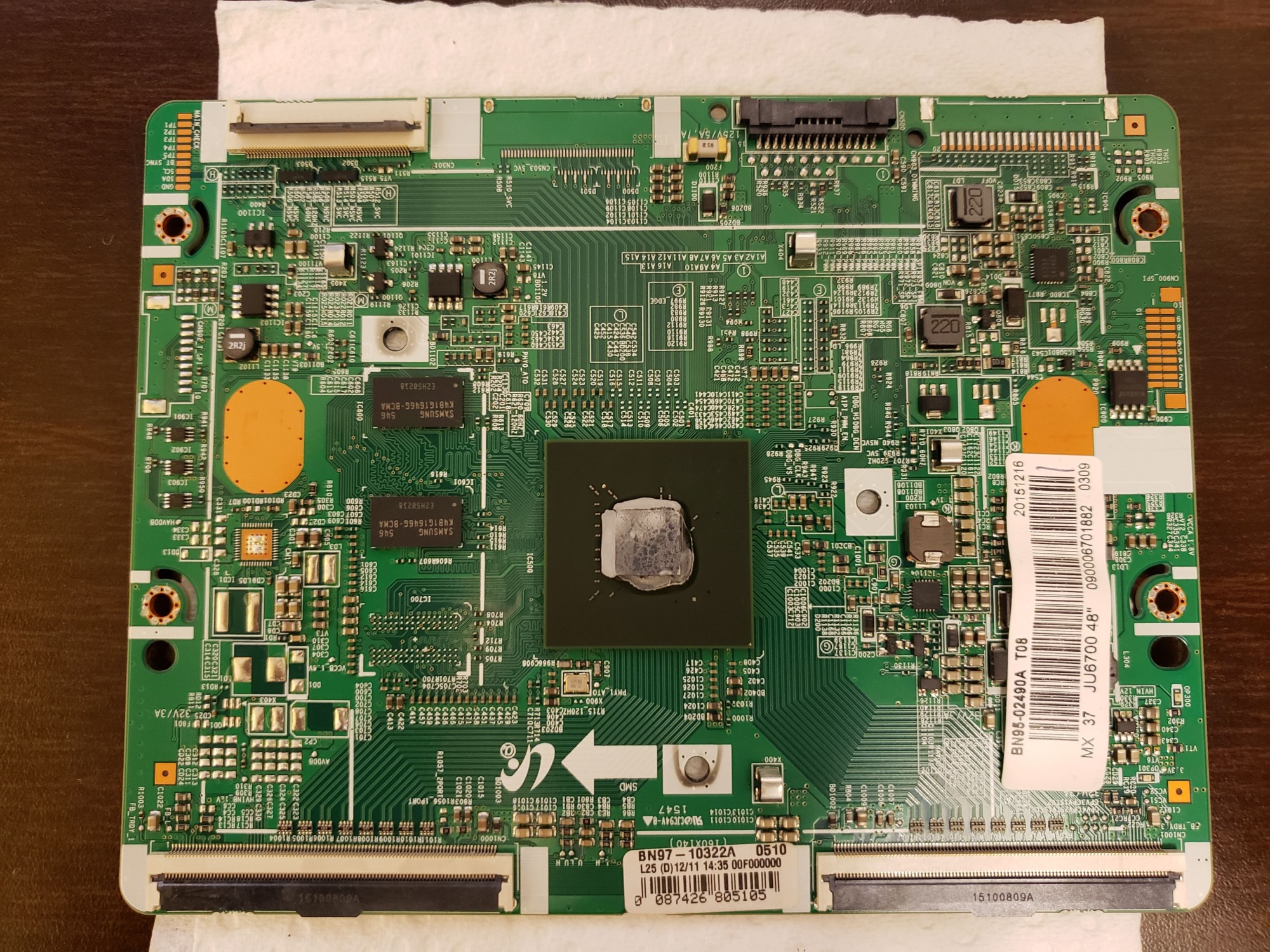

                  it is needed a photo of tcon board without eventual metal frames
                  • CityZen
                    • May 2014
                    • 40
                    T-Con:
                    • Davi.p
                      Hobbist Tech
                      • Sep 2009
                      • 4318
                      • Italy - Milan

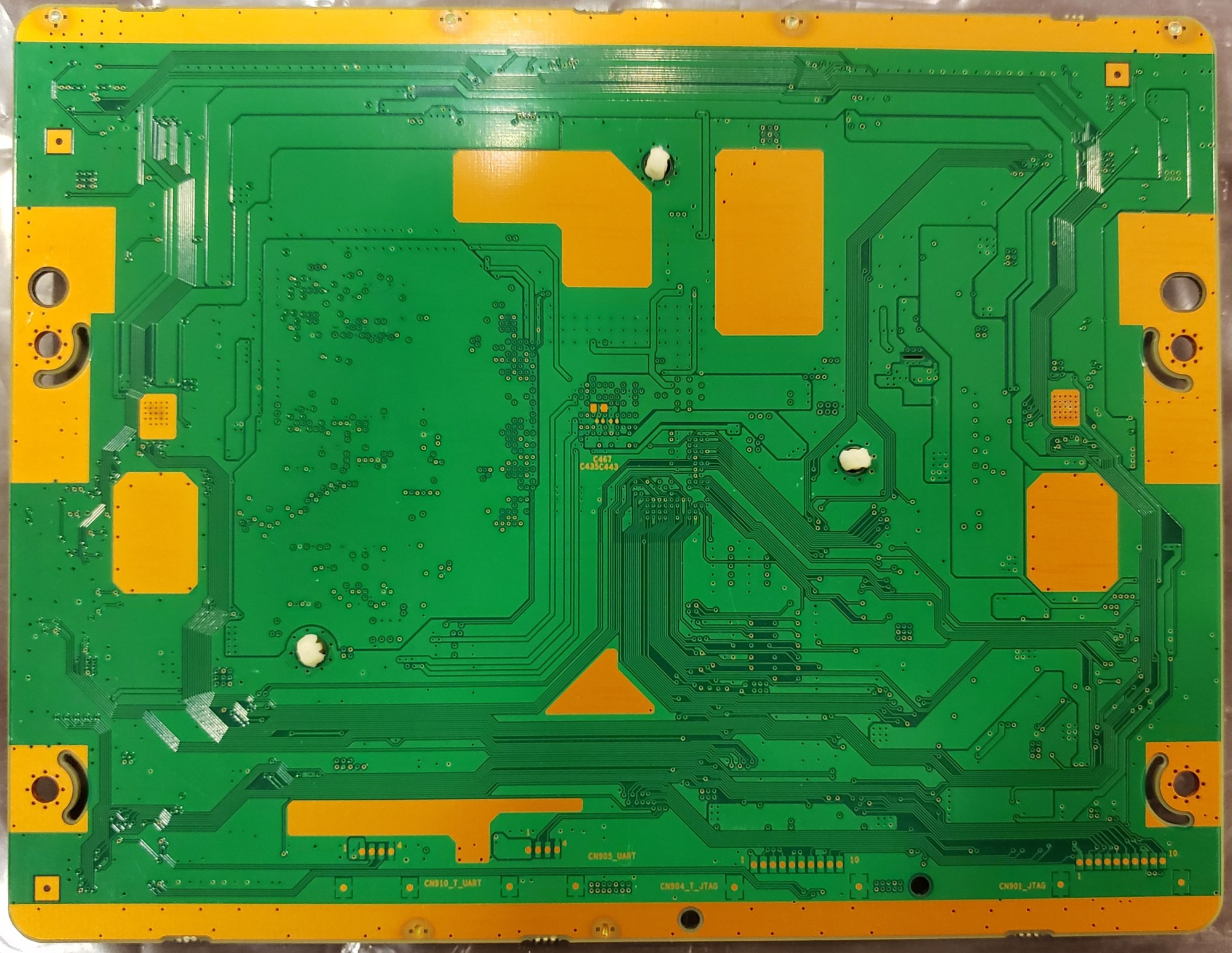

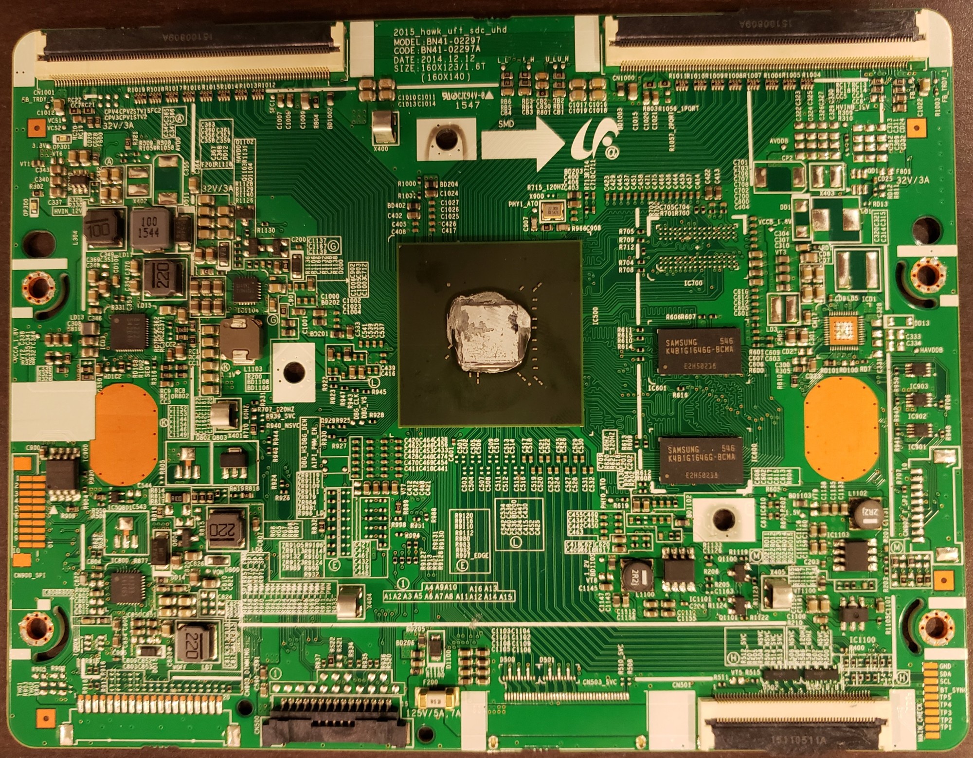

                      Remove the sticker and do a photo of that connector area without flash reflection
                      • CityZen
                        • May 2014
                        • 40

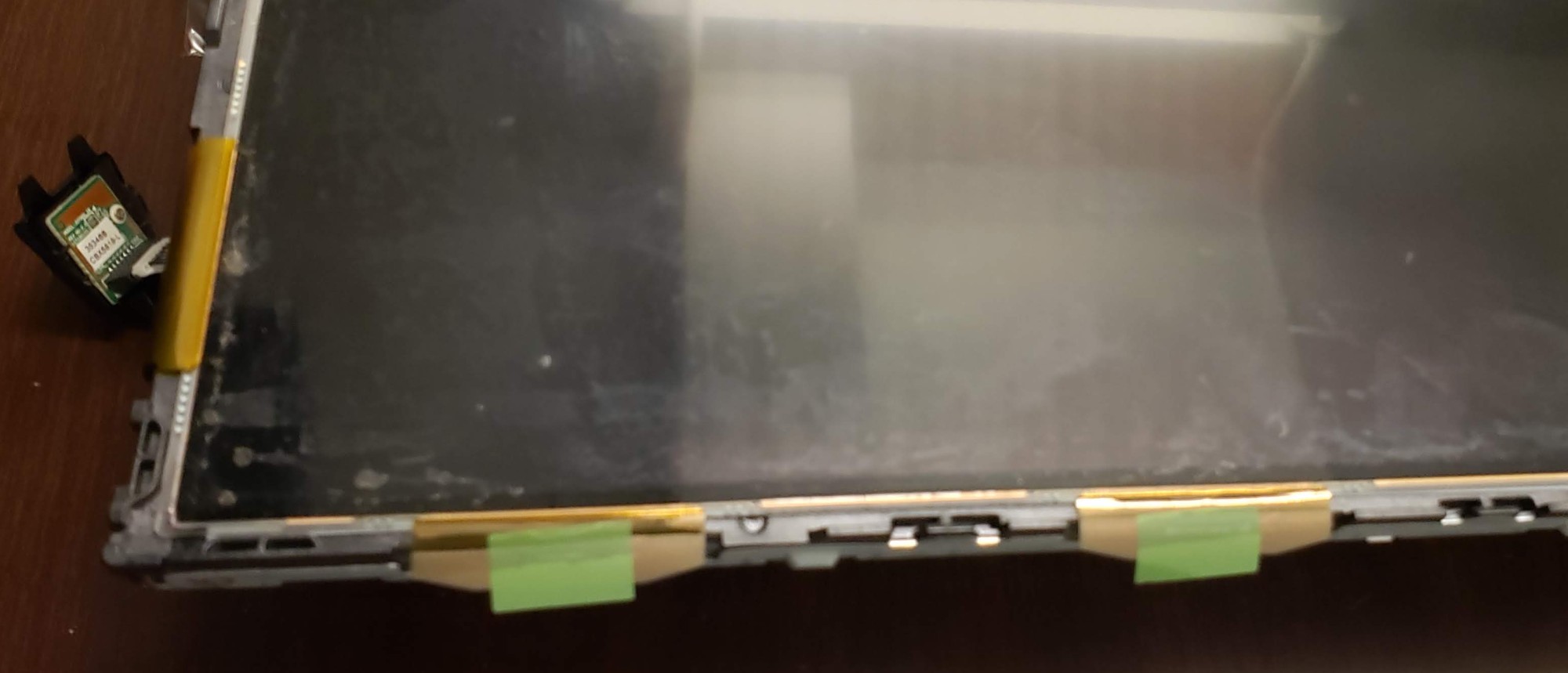

                        Okay, took a while, but here are better T-Con pictures.
                        Also, I removed the bezel, and discovered there are side tabs.
                            Okay, so if I understand you correctly, you are saying that the right side of the screen is missing either the VGL or VGH drive voltage, and that it might be possible to fix that by measuring the testpoints on the side tabs to look for these voltages, find out where it is missing from (compare left and right sides), and then to find a source of the missing voltage (either on Tcon or bottom drive boards) and wire it to the lowest test point where the signal is missing from. Is that right?
                              It is right except that you better wire it on distribution board not tcon..
                                Okay, so I wasn't able to get back to this set until this evening.
                                I measured the voltages on the lowest tabs on the left and right sides. I was able to find 26V and -6.6V on both sides. I'm not sure what to conclude from this.
