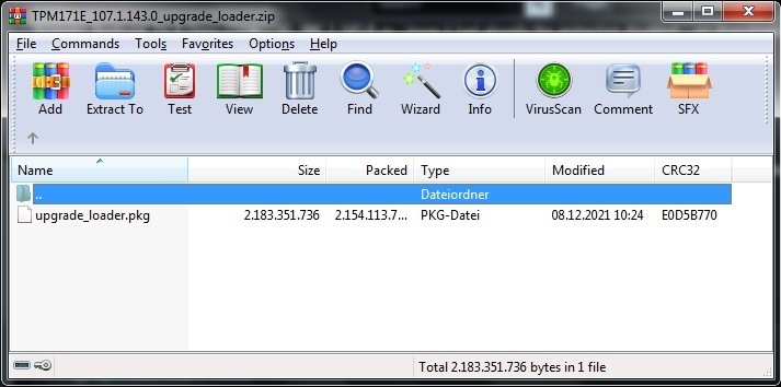

                      upgrade_loader.pkg u need you have it on the site.
                      here download and unzip... copy upgrade_loader.pkg on USB formatted FAT32 MBR mode

                          Originally posted by kozejk555
                          there is only autorun.upg. I must rename this autorun.upg on uprage_loader..pkg???
                          what are you talking .... the link in post #11 are direct download and when you unzip it you will have upgrade_loader.pkg
                          if you download dont know how,,,, so how you will be able to fix OLED !!!
