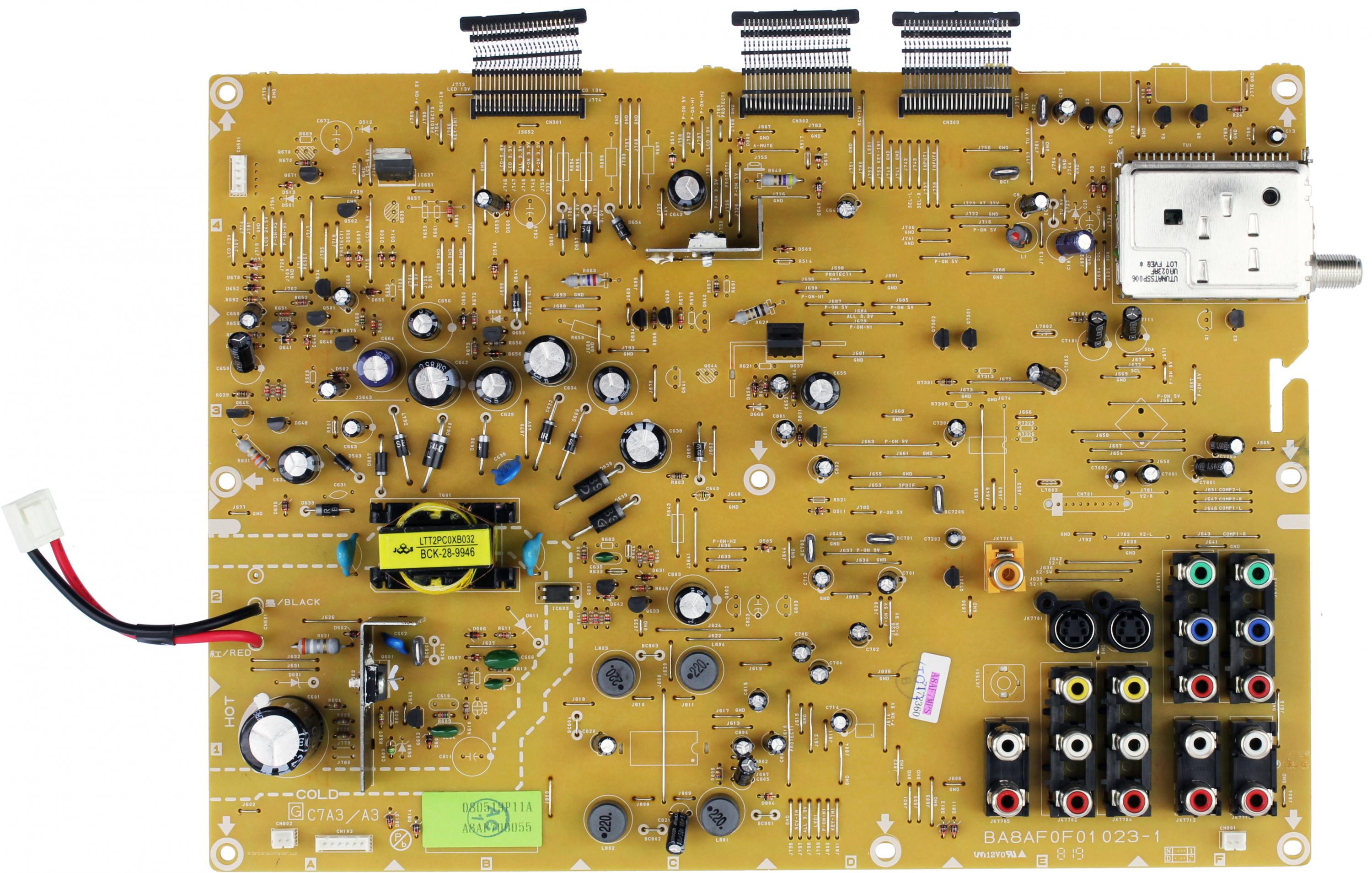

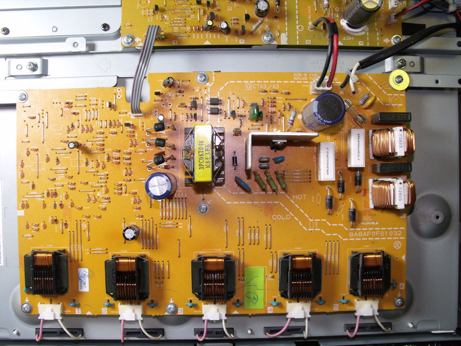

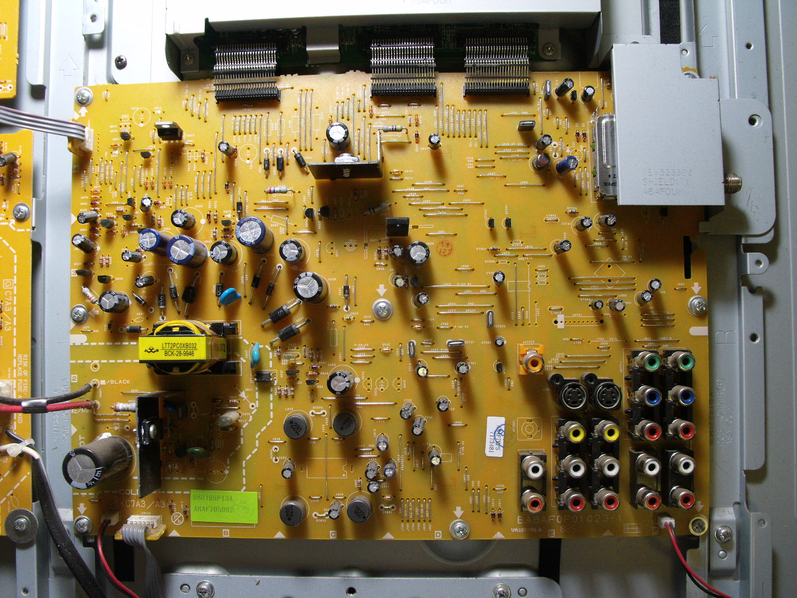

I have a Emerson LC320EM9B the standby light is red then I hit the power button the power light flashes 11 times then stays on green and I see the words "Digital Television" come on the screen for a second then goes out and the green power light goes out and the red standby light comes back on. I took the back off and no obvious bad caps I can see no burning or hot places I see so not sure where to check next. Ideas?? I uploaded what the boards look like.

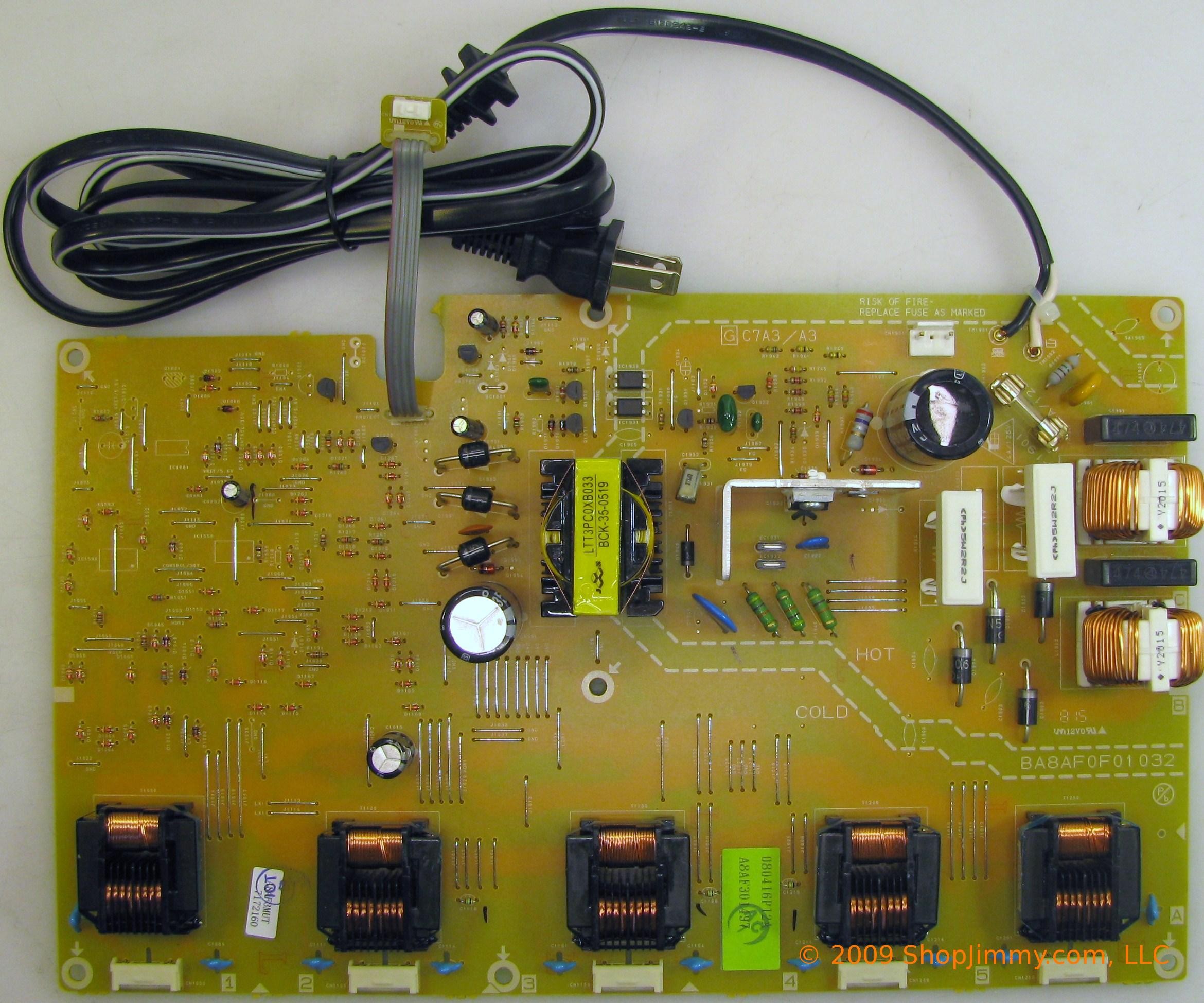

in the second pic what is the label on the 2 components above the 3 resistors in a row? wow that board got hot just like someone else that posted but never said what the fix was.Comment
Re: Emerson LC320EM9B on then off
oh ok it looks burnt. did you check anything at all? did you check that diode between the heatsink and the transformer?Comment
i don't think that is the problem. for some reason it is telling it to go into protect mode i think.Comment
did you test that mosfet on the heatsink by those 2 caps i asked about earlier?Comment

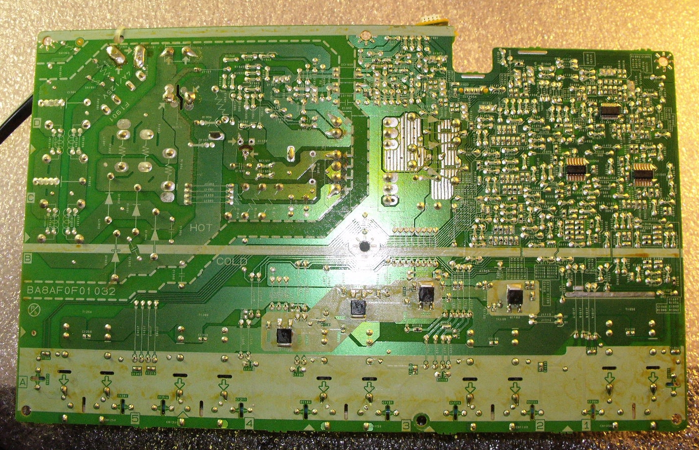

it might also have a bad inverter. causing it to go into protect mode now that i think about it. take the board off and measure the resistance of the inverters. take a pic of the bottom of the board. maybe i bad inverter is causing it to go into protect mode. you should be able to tell by testing them and seeing if they are all the same then they are probably good but if 1 varies a lot then thats probably your problem.Comment
scratch the part about the mosfet for now. you might even be able to test them without taking the board off if you can get your probes on the legs. but it would be better to see the bottom of the board to see how many pins it has etc.Comment
set meter to 2000ohms and test where the arrows are pointing 1 probe on 1 pin and red on other for all 5 of the inverter transformers and also check the 2 pins above that the same way for all 5.Comment
see if you have any resistance between the primary and secondary sides of the inverters i was gonna have you do that next but you put the board back in.Comment
