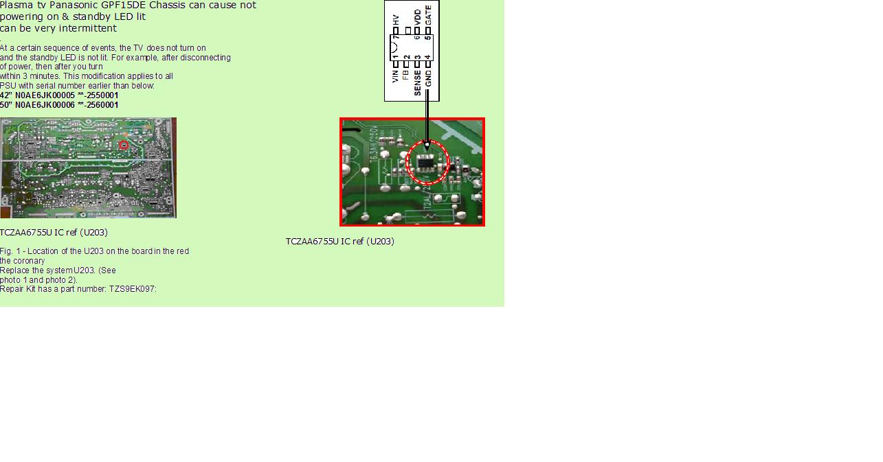

          possible solution I stumbled across.
          Plasma tv Panasonic GPF15DE Chassis can cause not powering on & standby LED lit
          can be very intermittent
          At a certain sequence of events, the TV does not turn on
          and the standby LED is not lit. For example, after disconnecting
          of power, then after you turn
          within 3 minutes. This modification applies to all
          PSU with serial number earlier than below:
          42” N0AE6JK00005 **-2550001
          50” N0AE6JK00006 **-2560001
          TCZAA6755U IC ref (U203)
          Not 100% if datasheet is correct device or proprietary for Panasonic by Fairchild.
          Does look like FAN6755UW going by the format in the sheet.
          Translated some other info.
          Some links for the IC
          http://www.ebay.com.au/itm/PANASONIC...-/160971382674
          http://www.ohmsupplies.co.uk/TCZAA67...42X50-TXP50X50
          http://www.notobsolete.co.uk/index.p...oducts_id=1209
          http://www.chsinteractive.co.uk/elec...-panasonic.htm

                Something that size is a piece of cake. If you had some fine cutters you may be able to snip the legs close to the body.
                You could flow solder across the legs to heat them all at once to lift it. I've used 2 soldering irons to heat both sides at once and used the tips like tweezers to lift at the same time.
                Good chance there be video somewhere to learn from.

                        Just in case this helps someone, I bought a TH-P42X50 with the same issue. Swapped out U203 with a NCP1271B, as that's what I could get at the time, but still didn't power up. Turns out D308 was shorted as well. It's a SS320 diode.
