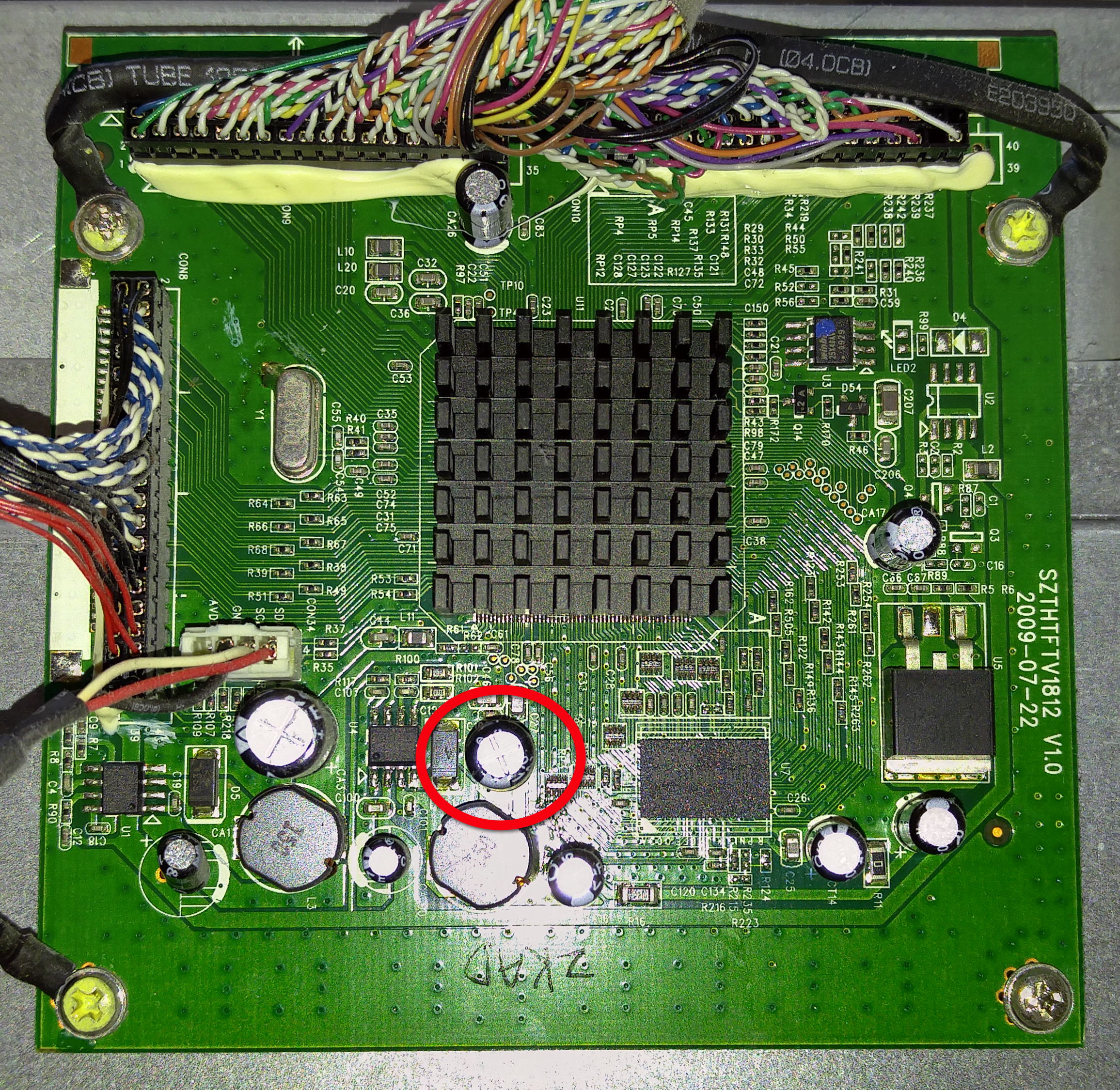

    This was my friend's Element ELGFT401 that was giving him picture issues. When it was first turned on after being allowed to cool to room temp, the picture was fritzy and jumping around from the moment the 'element' boot screen was displayed. Once it "warmed up" for a minute, the picture was fine. It would occasionally go to solid dark blue screen...sometimes a solid green screen....sometimes the pic would be wavy crazy green / white spaz...my friend says sometimes pic would completely go out and have sound with no picture. Usually turn off and back on would bring it back to life...sometimes some waiting was required.
    All the voltages on Power supply more or less matched what was printed on the board. After a lot of head scratching and searching around the forum posts, decided to try to use the poor man's freeze spray (upside down air-in-a-can) and see if I could find someplace that made the problem come back once it got happy(ish) and was showing a good pic. I found that when I sprayed the "PC board" (SZTHTFTV1812), the screen went nutz. I was able to pretty much completely turn the problem on or off by freezing...or blowing it with a hair dryer. Using various cardboard wedges and MacGyver-esq ingenuity, I was able to narrow it down to a 220uF 10V capacitor on that "PC board". Pulled it out of the board and measured it with my cheapie ESR tester and was showing about 353uF w/ 1.9 ESR. When I froze it, my tester thought it was a diode!
    Popped in a temp fix 220uF 35V (closest I could grab at local RadioShat for a quick temp test). Dropped that guy in and...ta-da! No more crack-frenzied spaz-tastic screen schenanighans. Used it for a couple hours...froze it...heated it...no more issues!!! Gonna give it back to him to run until a proper cap comes in.
    If this post helps you at all...please add to the post and share your experience. Looks like lots of other TVs share this same base sub LCD controller "PC board" Part Number - SZTHTFTV1812 (Other Elements, Seiki, Sylvania, Viore, Westinghouse..based on my quick feEBAY and shopJimmy searches).

            Just leave the 35V cap in there It will be fine (or better than the original) You can go up in voltage, but not down.

                    You really need the 35v cap there, It has at least 24 volts across it. Don't get your caps from Fry's unless you know they have low ESR, a brand like Panasonic FM or FC series. I get mine from digikey.
                    That 16V cap is probably leaking and putting noise on the line due to the over voltage on it. Rat Shack caps are crap for this type of operation.

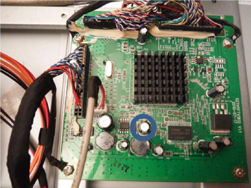

                            The cap did it! I'm surprised. I had previously removed it and it tested good, both in uf's and on the ESR meter. Then I found this thread. I replaced it with a 330uf, 16v to give it some extra uf's. It works!
                            I have noticed higher voltage caps tend have higher ESR readings. So I would stick with a 16v vs 35v, unless that is all that is available. Clearly, from above, the 35v cap does work. Just my .02.

                                Thank you so much for your post. I was having the same issues with the crack-frenzied screen and blue or green screen.
                                Tried searching for the digital board szthtftv1812 v1.1 but everywhere I looked they were out of stock. Eventually found this forum and post. I switched the 220/10v capacitor to a 220/35v I stripped from an old olevia tv that blew during a storm. From start to finish this project took about 3 hours including the time it took to open both tvs and finding the right capacitor. Worked like a charm and now the tv is back to new again.

                                  I have the same szthtftv1812 v1.1 I changed out the 220uf 10v with a 220uf 24v and it did not fix it so there are no boards available so may have to part it out!
                                    Re: 40" Element LCD ELGFT401 Picture Issues
                                    Was able to get it to work! I have 1-Main, 1-power, & 1-t-con boards to sell off for 40" Element LCD ELGFT401
