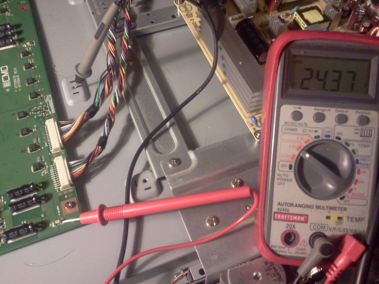

      24.37 v on one side of blk fuse and 1.098 on other side ??
      i tried ohms but couldnt get a reading.
        Re: insignia. no picture/back light
        So, all three fuses are blown? While possible, that is really unlikely! Please double check all your readings. Here, a picture would -really- help to show us where you are probing.
          i just rechecked the 3 fuses. the white fuse on bottom is 24.37 on right side of fuse .
          .001 on left side of the fuse. the other white fuse. is 24.37
          .003 i measured the right side. on that one first. the black fuse at the
          top was 24.37 and on the back side of it. was 1.098.
            Try reading right at the two legs of those black filter caps. Two blown 8A fuses + fuse for the PWM chip, does not sound right.

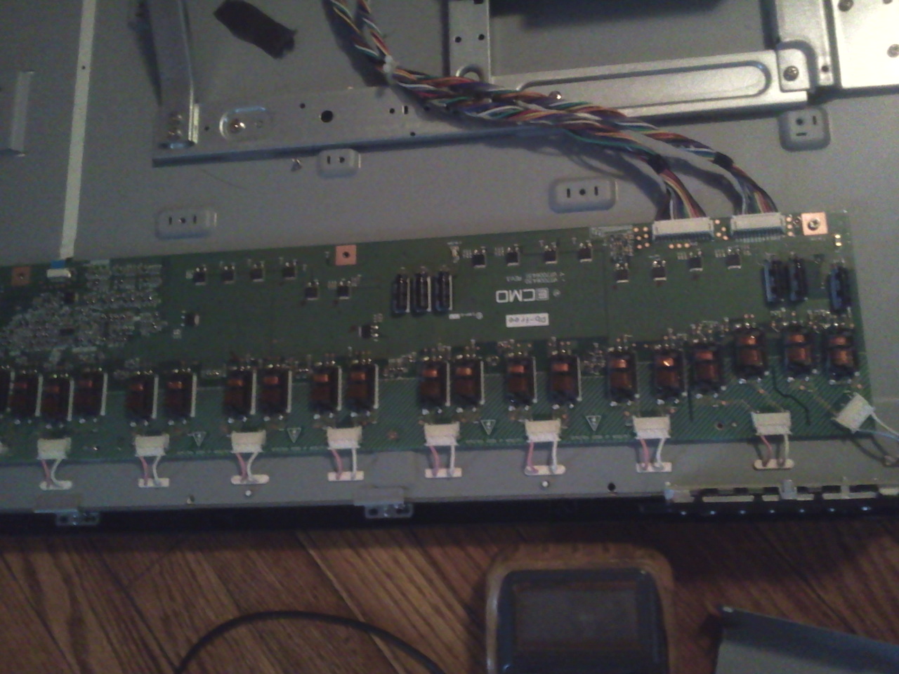

                        Don't jumper the fuse until we know what is wrong.
                        Does this TV have two inverter boards? I see two power cables which is odd?
                          Are you sure the black probe is grounded correctly - try again on the fuse in the picture using the ground screw next to it.

                            #33
                            Tom the inverter is just 1 long board. vt70064.50. (vt70064.51) rev.3
                            Voltage readings is still the same even when i use the screw next to the fuse.
                              If those 8A fuses are blown, then you need to check ALL those MOSFETs (3-pin device) next.
                              • tocold4u2
                                • Dec 2012
                                • 284
                                • usa
                                #35
                                There is 6-8 bad mosfets on inverter board. im sure replacing these are going to be a pain
                                i have a few other inverter boards with mofets...you think i. can use them as replacements
                                  #36
                                  You would need to check they are all the same spec - part # of bad FETs and of good FETs, look up datasheets and compare:
                                  - Vds (must be higher or same)
                                  - Rdson (must be lower or same)
                                  - Qg (must be lower or same)
                                  - package pins: must be compatible
                                  That will narrow it down significantly.
