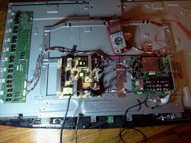

    i have a insignia e479mznkw1bm. i have a red stand by light.
    when i push power button the stand by light turns blue.
    still no picture...no sound if i hook a dvd player to it.the only response from remote is power on and power off.

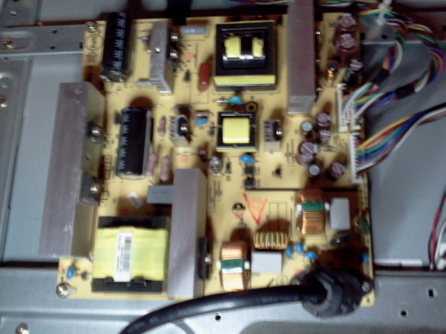

    reading on power board
    3.079.- on/off
    24.03 -. diw
    11.85. - 12v
    11.85- 12v
    o-ground
    0-
    0
    24.38-24v
    24.38
    4.01-ps on

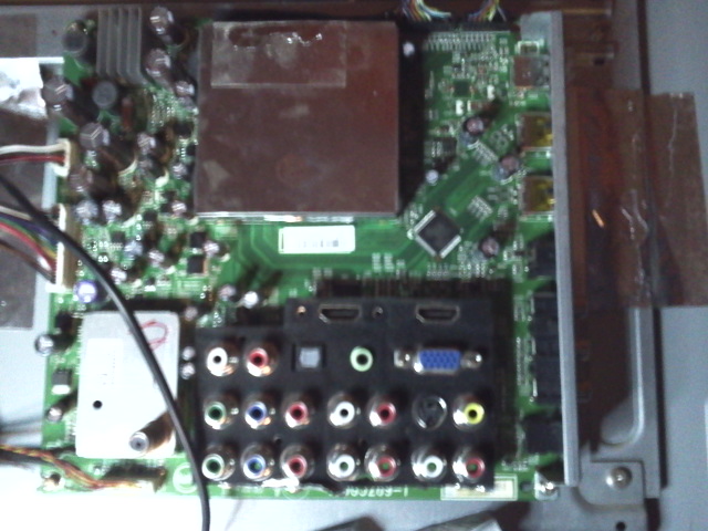

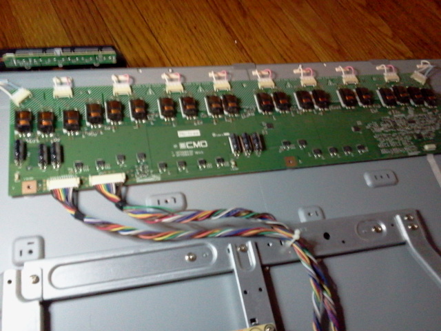

          Can we see good clear pictures of the boards? So far it has all the correct signals and voltages.
          • tocold4u2
            • Dec 2012
            • 284
            • usa

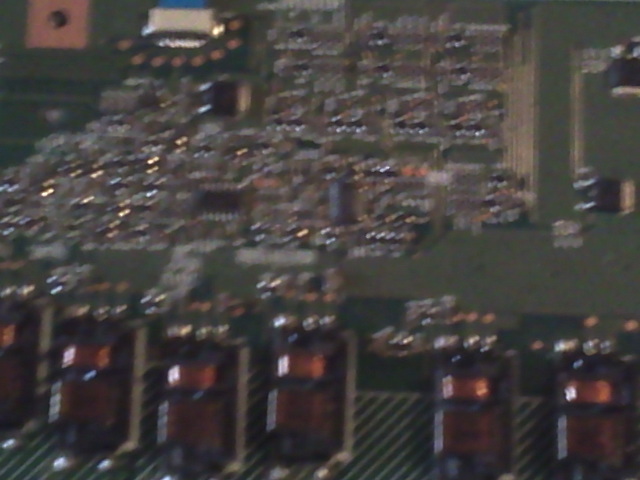

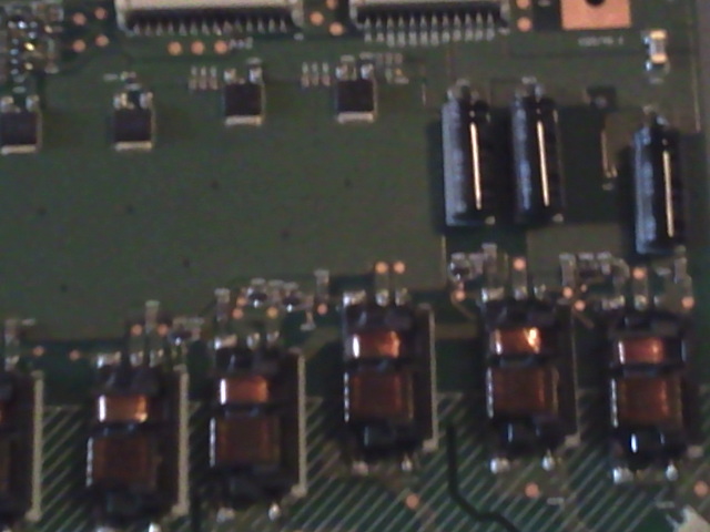

            Re: insignia. no picture/back light
            Here is a few pictures of each board
              Need high resolution picture of this board.
              https://www.badcaps.net/forum/attach...5&d=1391349191
              • tocold4u2
                • Dec 2012
                • 284
                • usa
                These are taken will cell phone cause my camer is broke
                • tocold4u2
                  • Dec 2012
                  • 284
                  • usa
                  Shpuldn t i get a 24v reading on inverter board ?
                    Cannot see anything useful in those photos, you will need to have a good camera... any chance you can borrow one?
                      I could but would be days before i could post anything .
                      Net is down here. I posted this with cell. not geting 24v on inverter board.
                        Where are you measuring the 24V? If you have a 24V power supply to the main board (for audio) it's likely you also have 24V for inverter... so check where you're probing.
                          I just saw where wires plug in from power supply board to inverter. it says 24v..
                          Well now i was probing the other side of conector n got a spark ..
                          Lost 12v pover ..gona re check. voltages. on power board

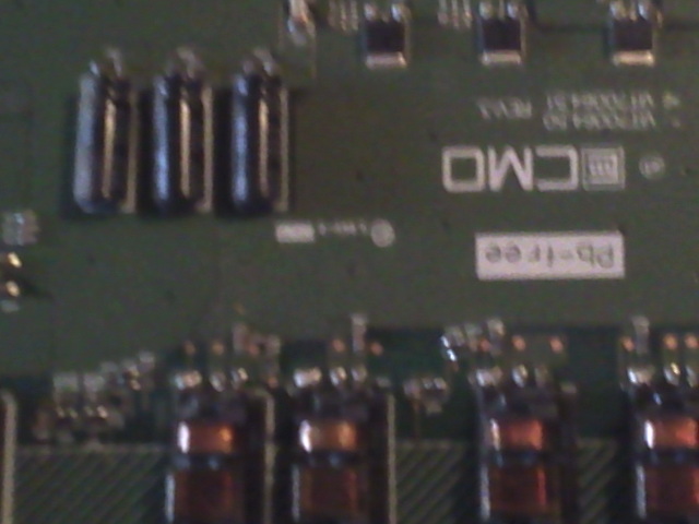

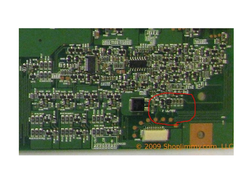

                            It looks like another one of those CMO with bad black fuse with '15', or '20' printed on top. The pictures are too poor to see anything. I hope you did not damage the 12V/24V powwer supply.
                            On the right side of the inverter, look for fuse 'F 1A/76V'
                            http://assets.shopjimmy.com/media/ca...j27d023893.jpg
                            • tocold4u2
                              • Dec 2012
                              • 284
                              • usa
                              yea budm it is a cmo inverter..looking f.or that fuse u mentioned
                              • tocold4u2
                                • Dec 2012
                                • 284
                                • usa
                                i had .523 ohms on that. fuse f1a. but tge f 8a fuse i got nothing at all.
                                the f8a/125v. i got no ohms also
                                  So one of the other white fuses show as open circuit?
