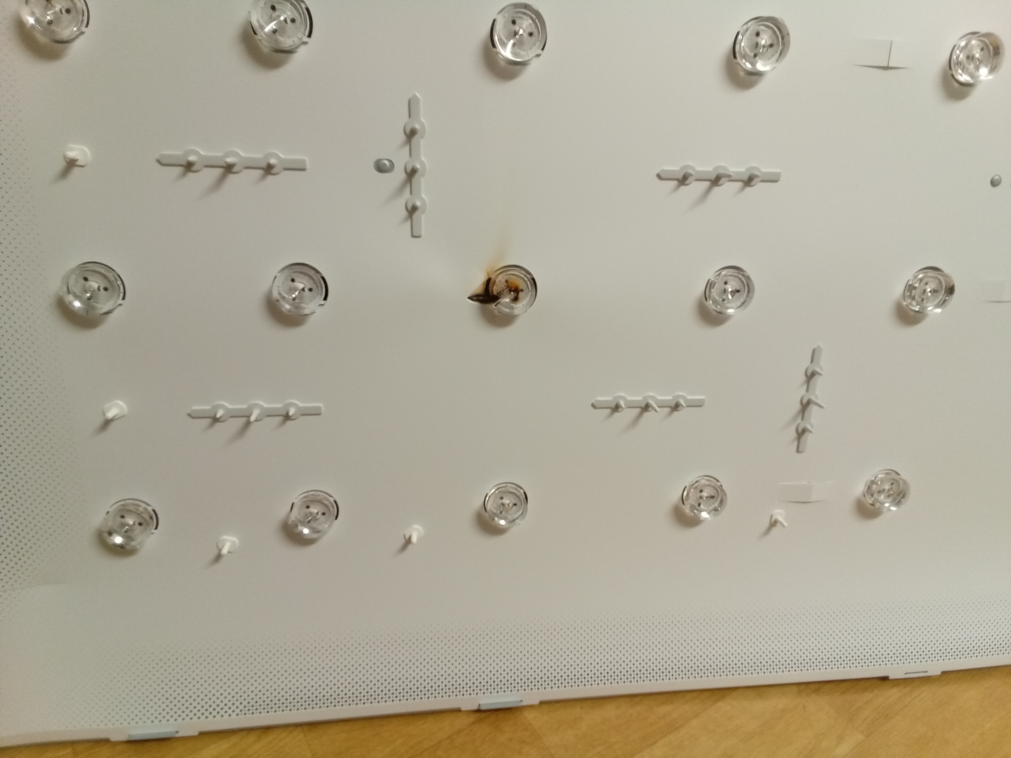

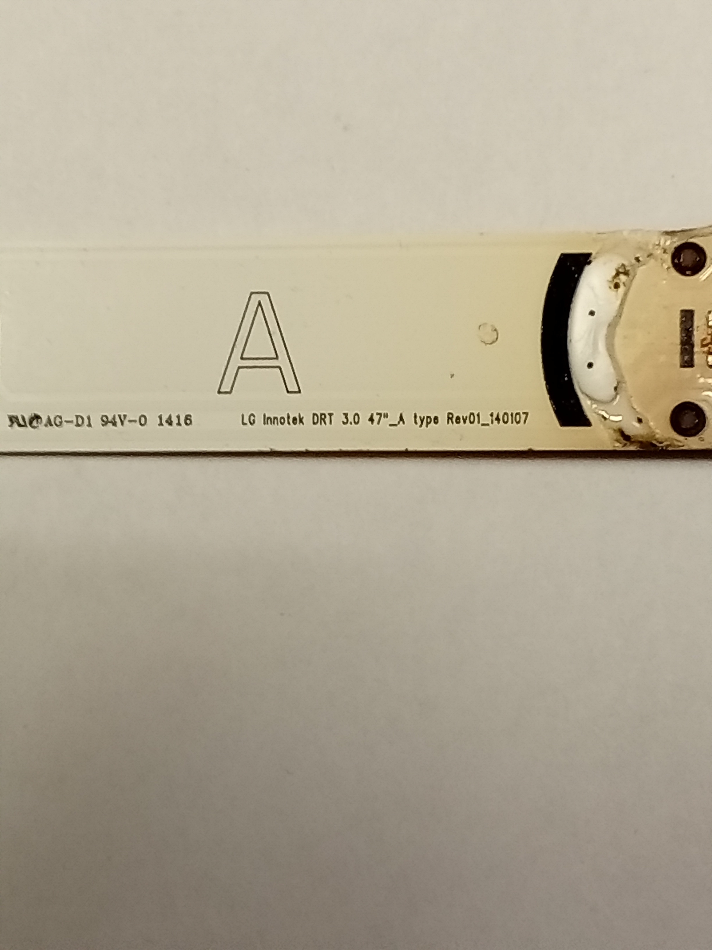

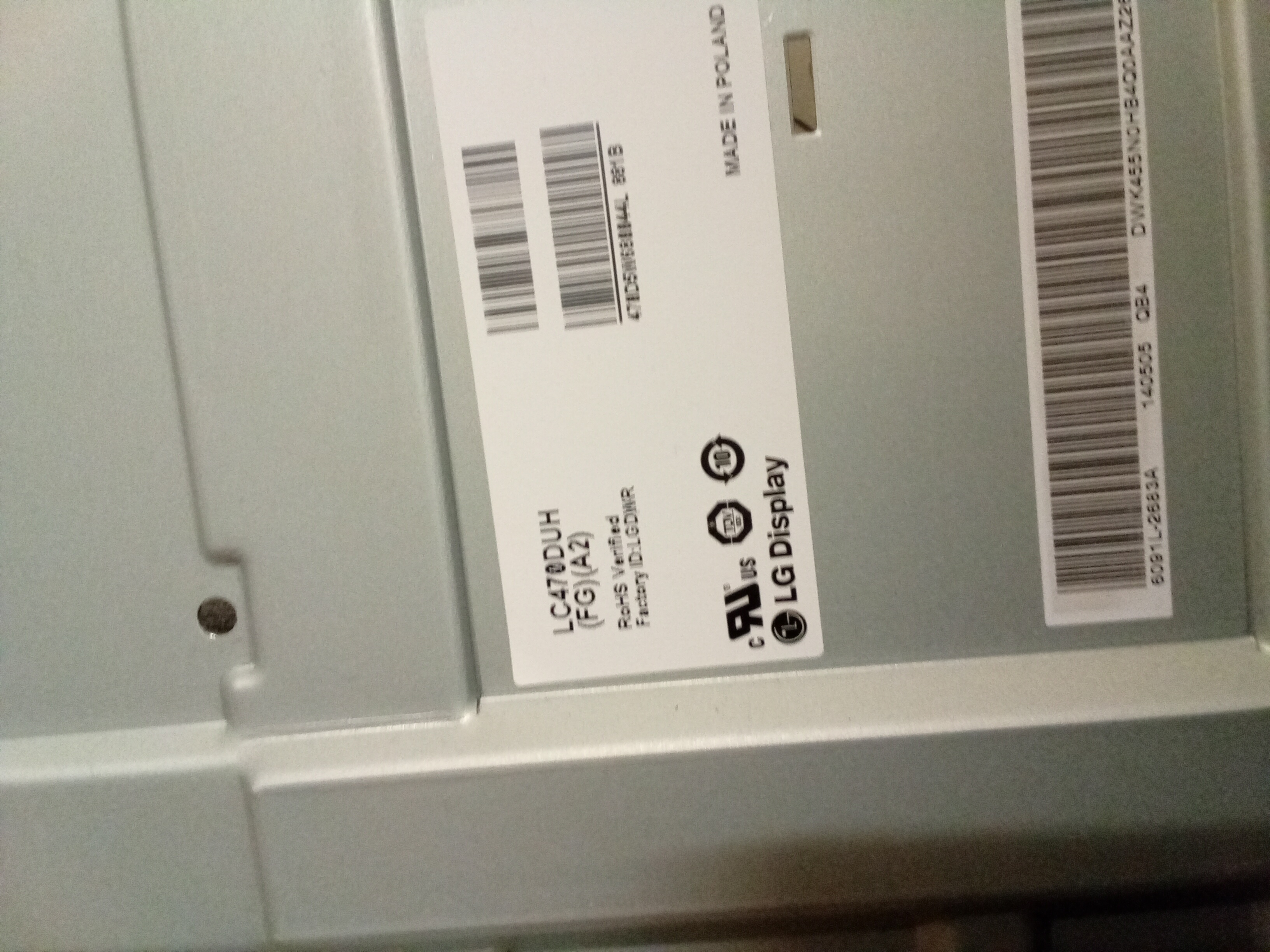

    Hi everyone need your expertise for the purchase of this LG49UH603v led strip for panel:LG470DUH because apparently they have to fit the panel. The problem here is that all the ads on ebay say that their ad is compatible with LG49UH603v.but then in their explanation it only fits panel X
    here one exemple
    https://www.ebay.co.uk/itm/384598501...2B3MsUe6ClBurR
    don't know anymore how to buy the right one if you can help me very grateful for all the advices

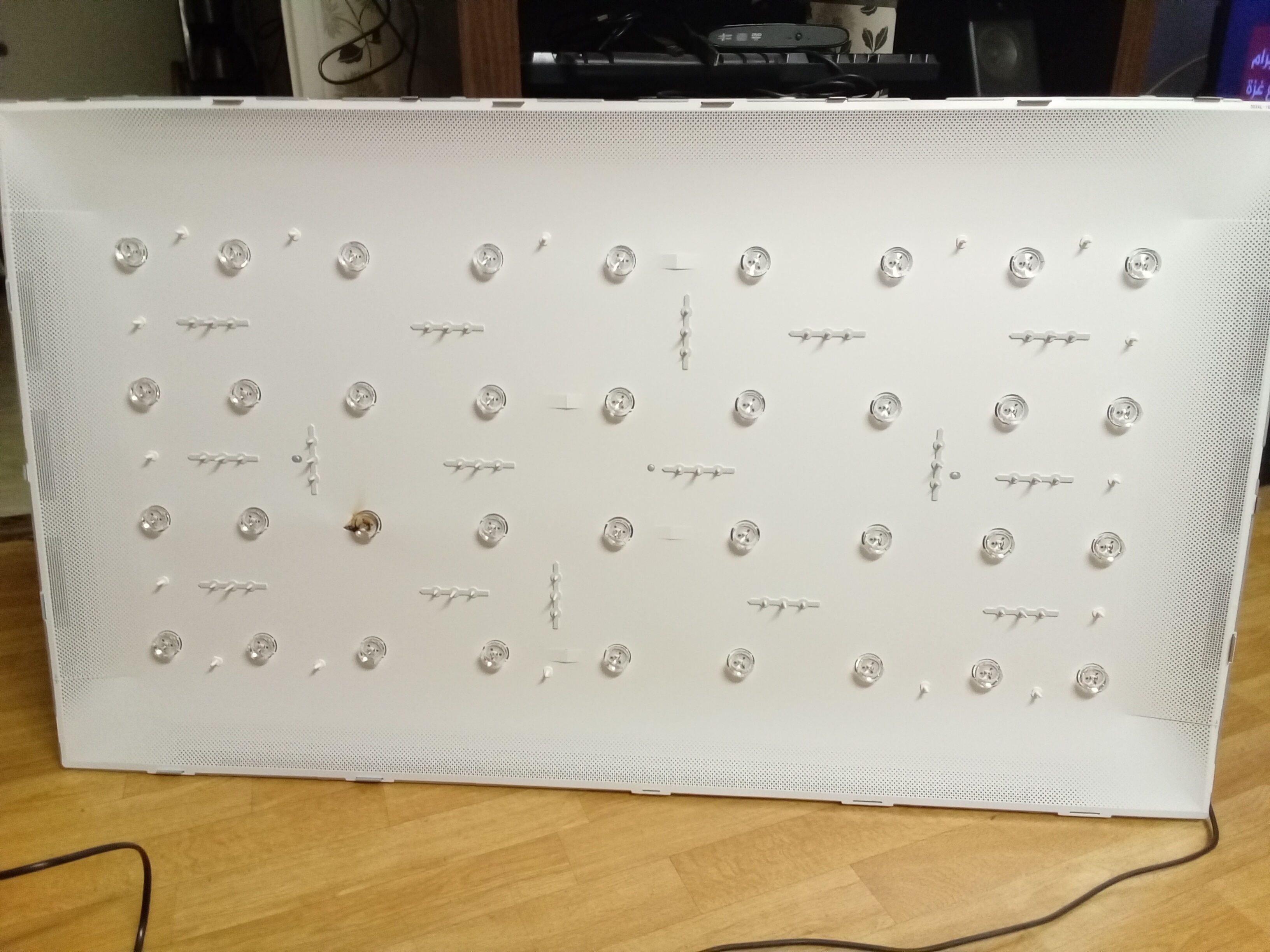

    Your panel is 47" so 49" strips will not fit. Yours looks like LB or LF series, don't you know the model number of your TV?

      Hi how it can be 47 when :the model number is LG49UH603v

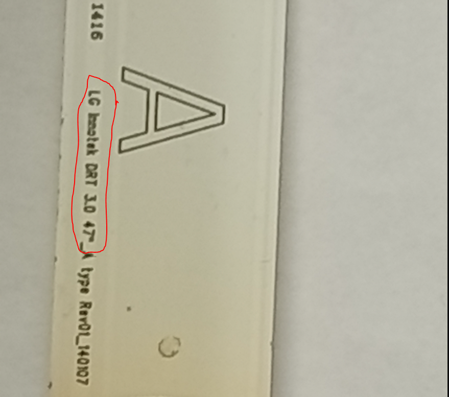

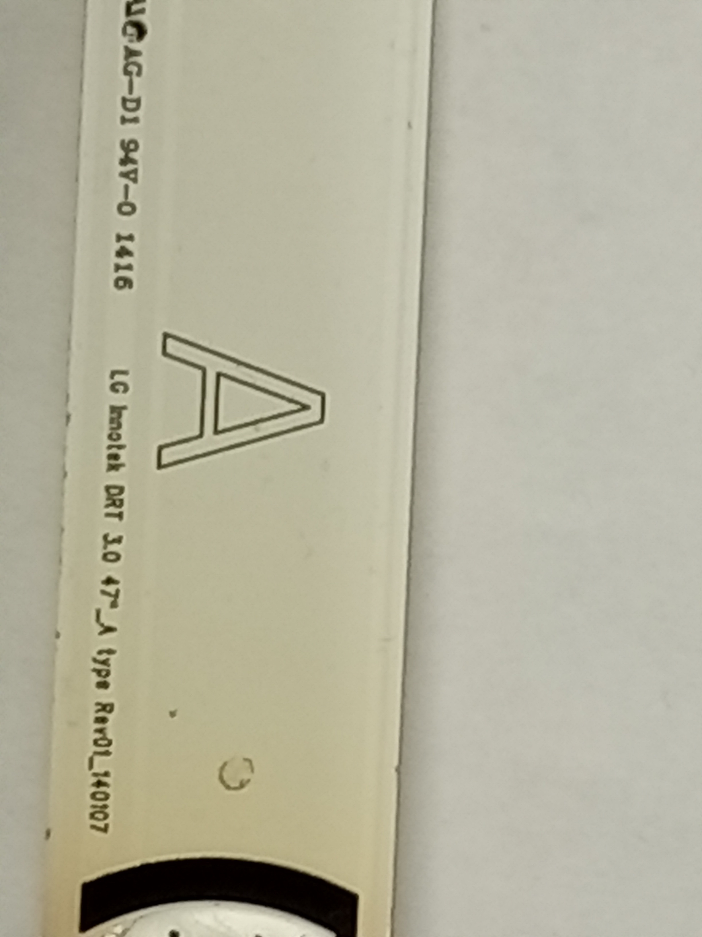

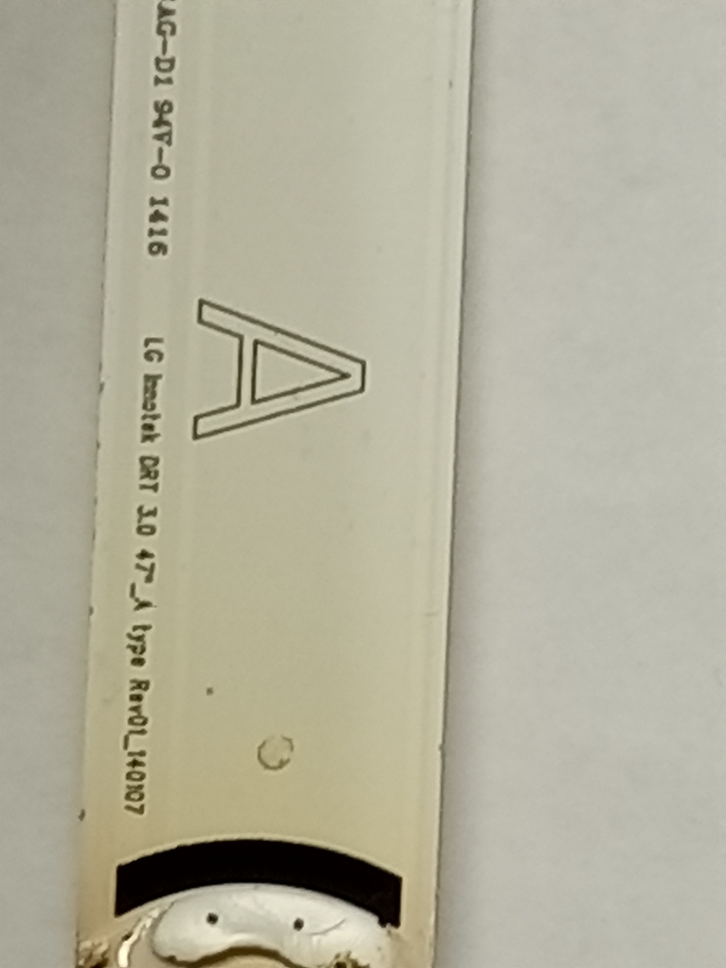

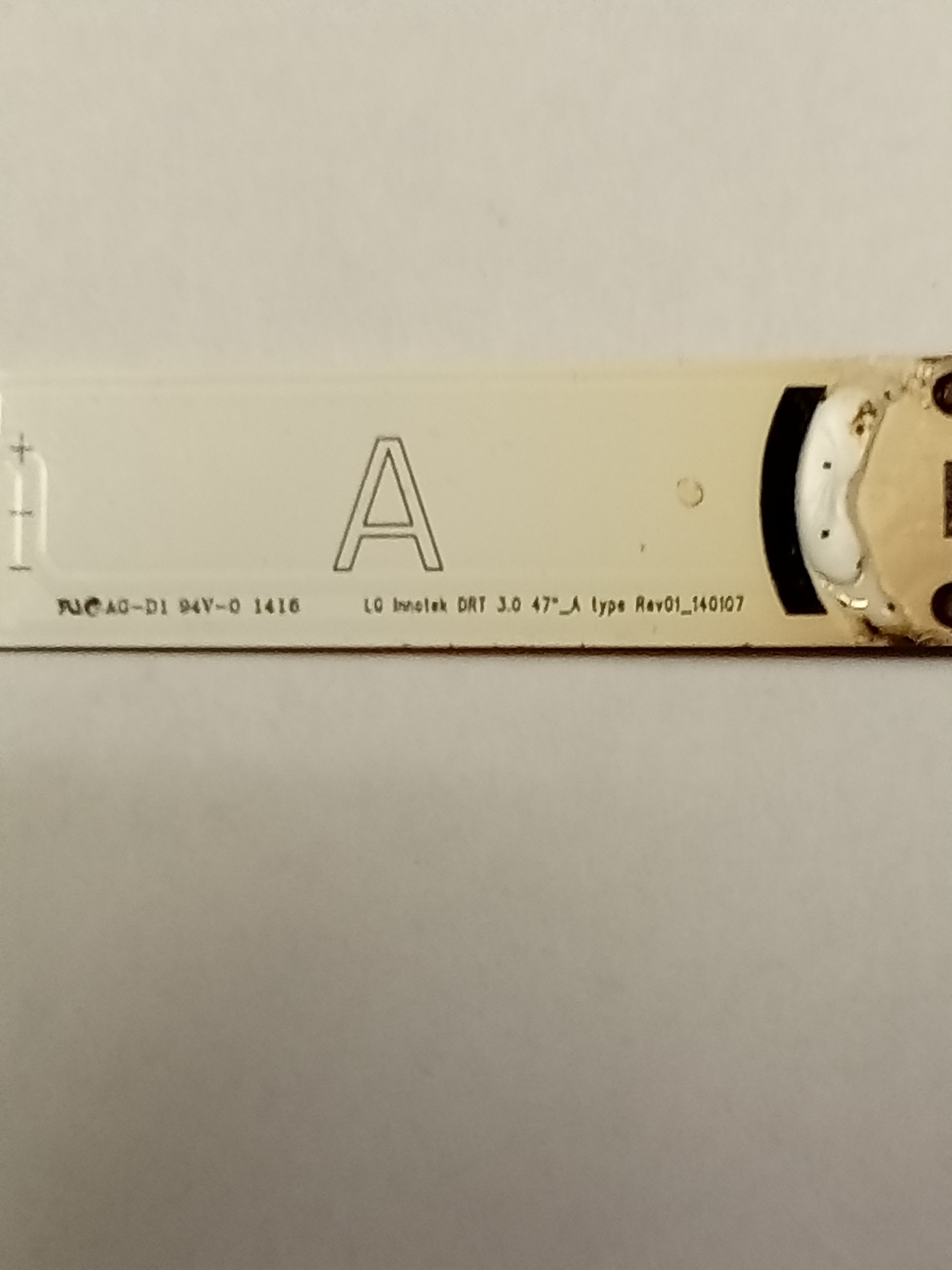

        And yours should be Innotek DRT 3.0 47" 6916L-1948A

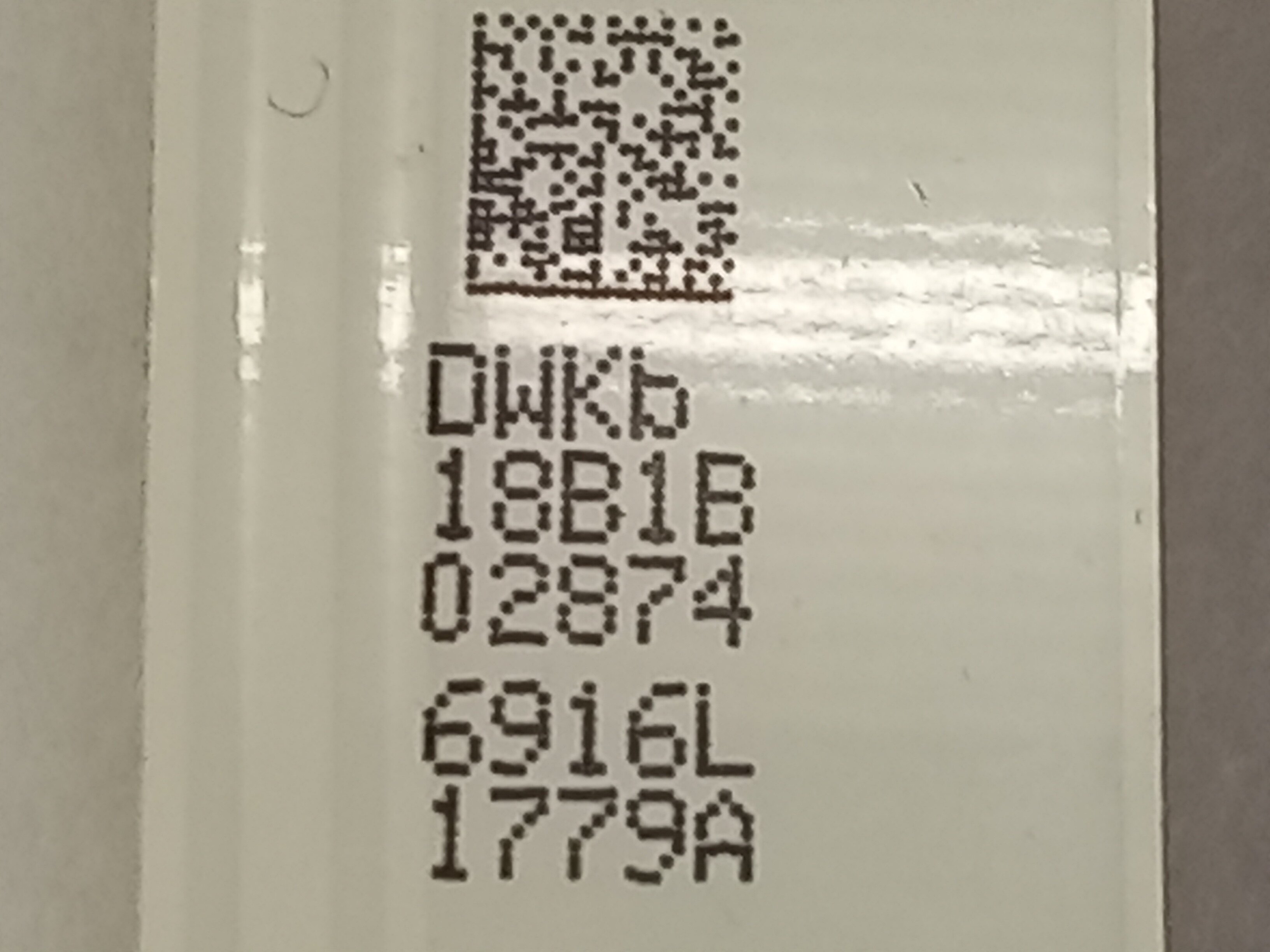

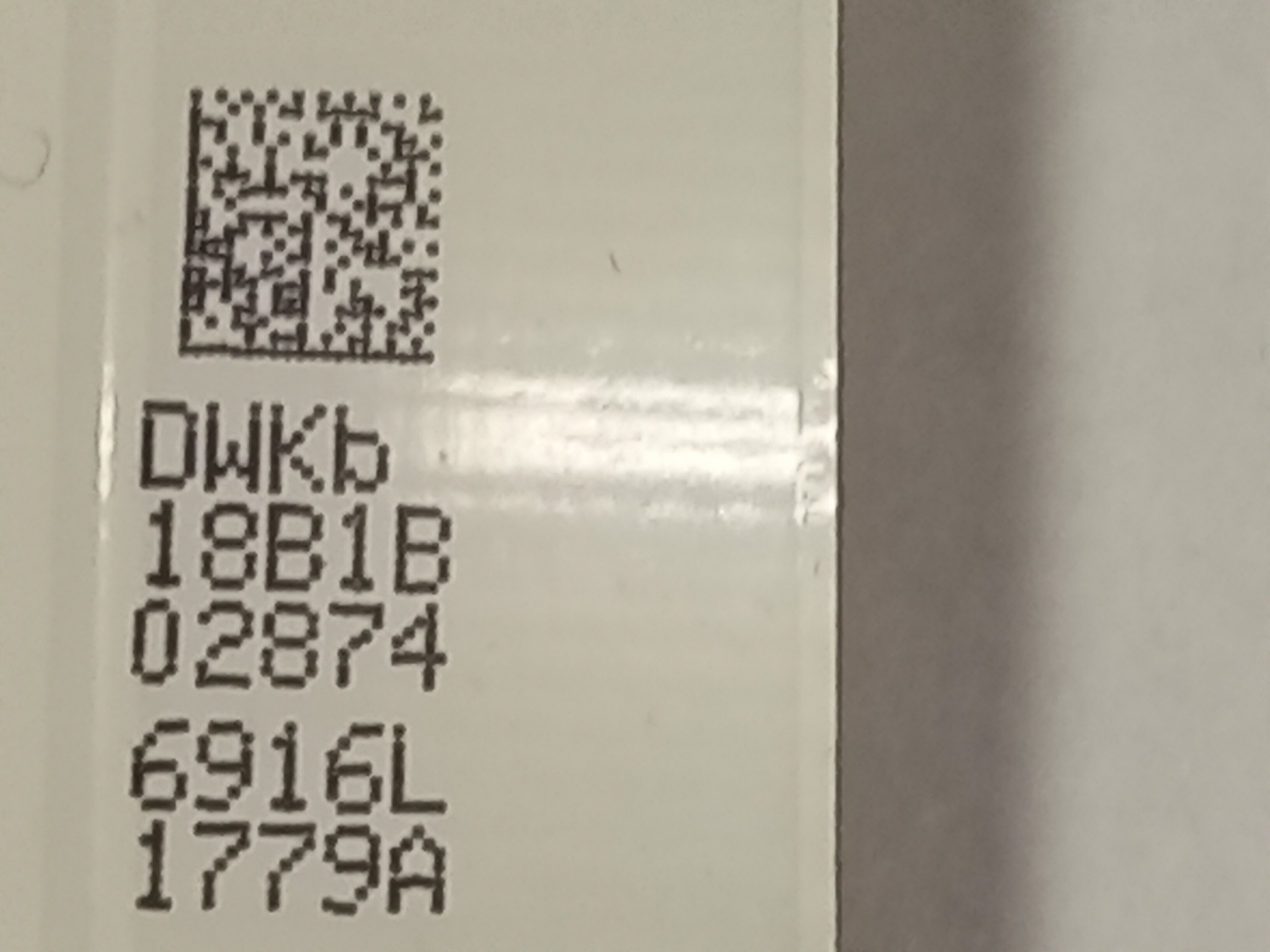

          on the led strips themselves there is a number printed thats the number i use too buy new ones

            And the TV model LG49UH603v does not match your backlight, which is in the photo, this backlight belongs to the "LB" series (47LB6300, 47GB6500, 47LB652V, 47lb650v.....).

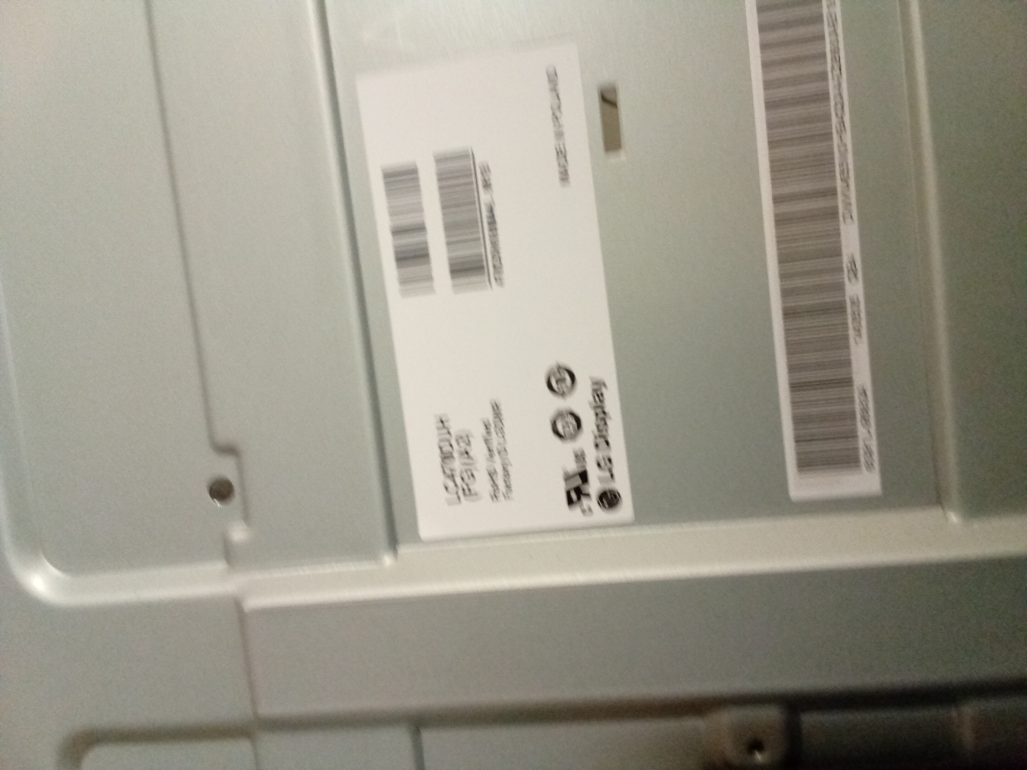

              Originally posted by lotas
              Thank you so much for the replies from all of you. now Lotas you confuse me with your second answer
              Below are all the markings that can be found on TV and on LED strip so maybe it will be easier​

                Everything is correct, you need Lg Innotek DRT 3.0 47"
