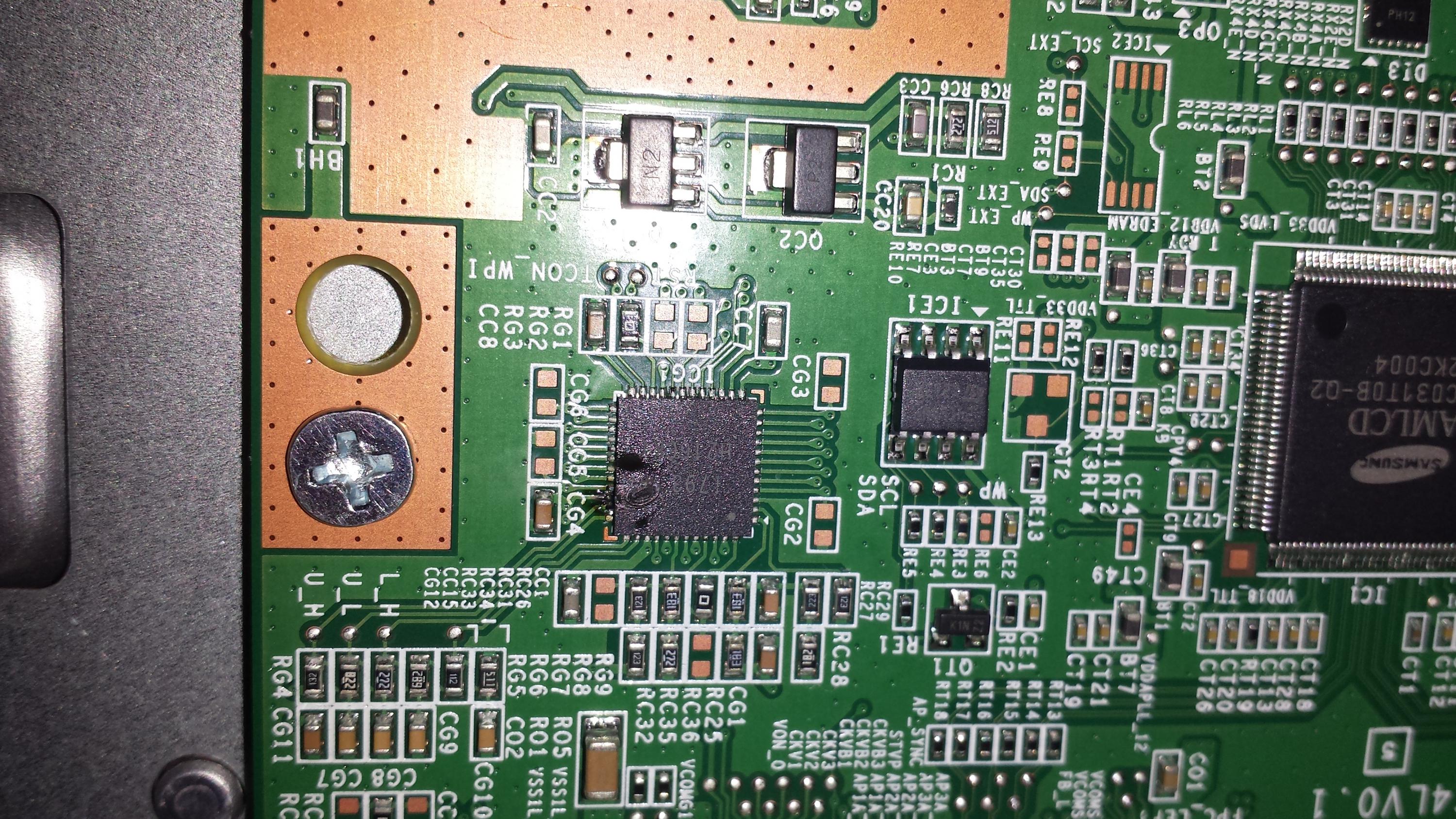

    Possibly that chip is bad or the panel killed that chip so you'd be taking a risk in replacing t-con.
      Re: Haier LE55B1381 LED
      You can see the burnt mark from the pics.
        Ok, let me take a chance and replaced the tcon...thanks for your help Tom, will keep you posted.
          Check voltages before replacing t-con board with ribbons out. That way you can know. Also, you can try checking panel for water damage.

            OK, I will recheck the voltage, is there supposed to have voltage reading on all the test points A to G?
              Expected readings:-
              A = 15-16V (AVDD for Panel Source Driver)
              B = 15-16V (HAVDD for Panel Source Driver)
              C = 20-30V (VGH/VONE for Panel Gate Driver)
              D = 1.2V±0.1V (TCON IC Core Voltage)
              E = 3.3V±0.3V (TCON IC / Panel Source Driver IO)
              F = 1.8V±0.1V (TCON IC)
              G = 11V±0.5V (Panel)
                Great...Thanks for the info. Yes, was getting 0 reading on 80% percent of the test points. Will order a tcon board and see if that fix the issue. Thx
                  Tcon board came in yesterday, I replaced and that fix the problem, looks like the bad IC chip on the old board was casing the main issue. Thanks everyone for their help.
