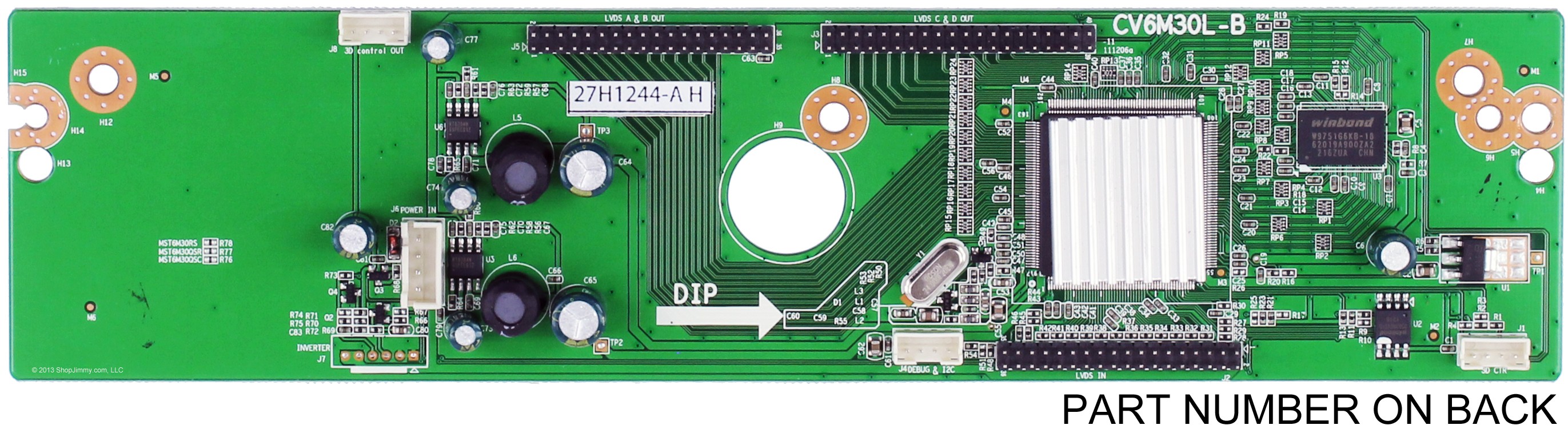

    Does anyone know the exact function of this board? What does it do, if it were to go bad?
    HAIER LE55B1381 PC BOARD CV6M30L-B 27H1244-A
    Re: Haier LE55B1381 LED
    Looks like a TCON to me lvds in from main board and lvds out to panel.
    Without it back lights may still come on but jsut white screen or if only part bad
    may show a corrupted picture colour bars or stripes
      I would guess motion FRC. For 120Hz / 100Hz application. If you remove heatsink you can probably look up chip number, very basic frame interpolation, pretty rubbish.
        Ok, makes sense. You think this board is bad? I was able to power on tv, backlight comes on, no display, picture or menu display. Already swap out main board, that didn't do anything. Was thinking this PC board might be the culpit.

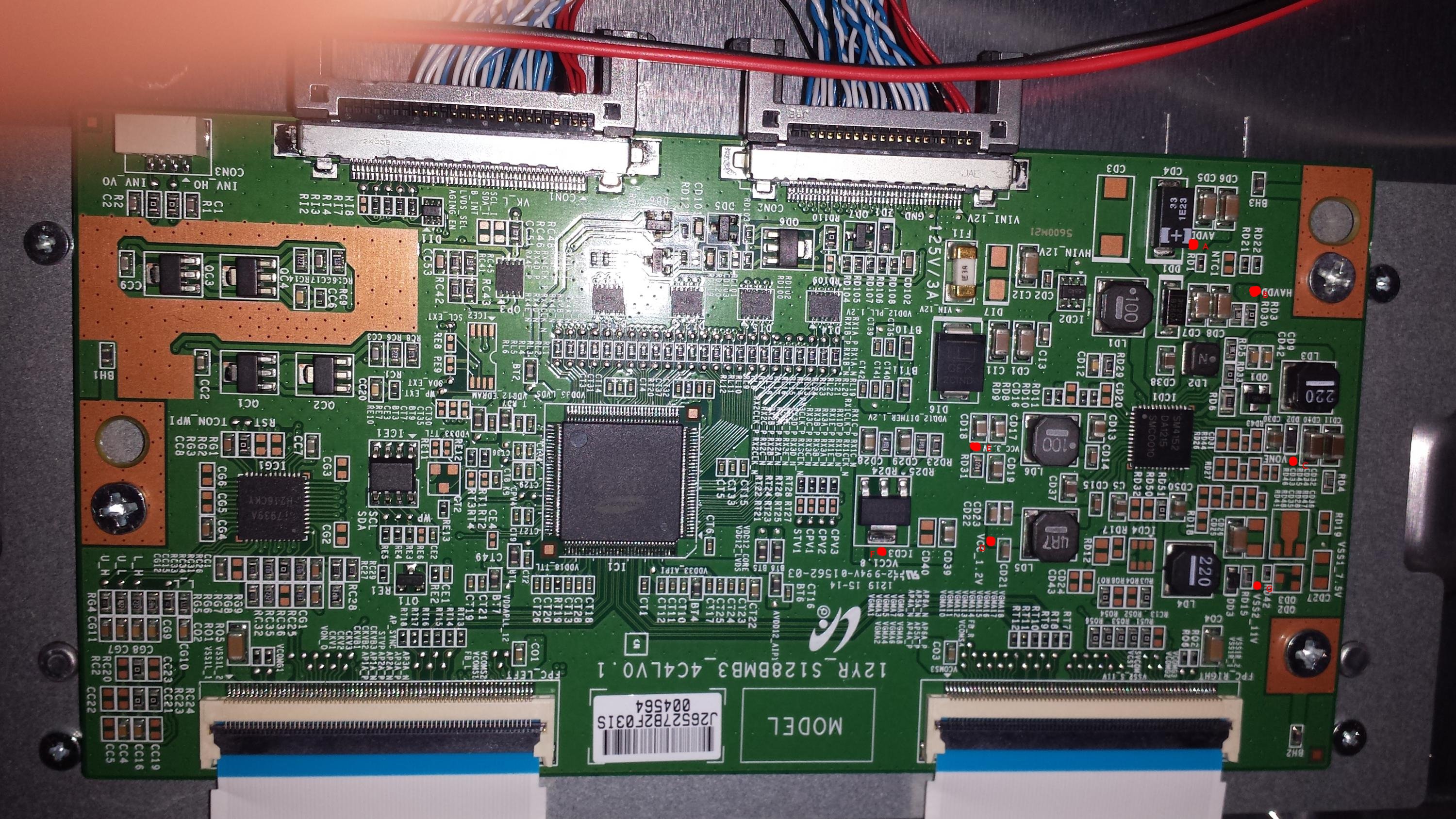

              I agree with Tom - I did say looks like - however the symptoms you describe would also apply to the Tcon.
              If yours is the same as this
              http://assets.shopjimmy.com/media/ca...26527b-top.jpg
              it has a fuse on it that if blown will give a white screen.

                  Sorry, had not had a chance to test the PC board, will check that out this week when I have more free time. Yes, that's the tcon board that I have on my tv set. Is there only one fuse on there? I believe F11, will test for continuity.
                    I measured the voltage on pin 35, 36 for 12V of LVDS A & B....getting both 12.6V for the pins. I also check the tcon board. It is the same one Selldoor attached a link to. 12YR_S128BMB3_4C4LV0.1, F11 fuse measured 3.1 V also.

                          Pic of t-con board?

                                See attachment: test all points and respond with voltages at labels A-G. Then we can see if t-con is working.
                                  Measure all the test points you label...here's my results all in DC Voltage
                                  A=0
                                  B=0
                                  C=0
                                  D=0
                                  E=0.099V
                                  F=0
                                  G=0.202V
                                    OK, you are sure that fuse is good? If so, try with the panel ribbons disconnected. If they still do not return it looks like a bad t-con board to me.
                                      Yes, recheck fuse and showing 12.6 V, what an I checking when I disconnect ribbon cable from the panel?
                                        Ok, I disconnected both my ribbon cable from the panel, turn the tv back on, and my ICG1 chip just smoke and Burnt up. Bad tcon board I'm assumming?
