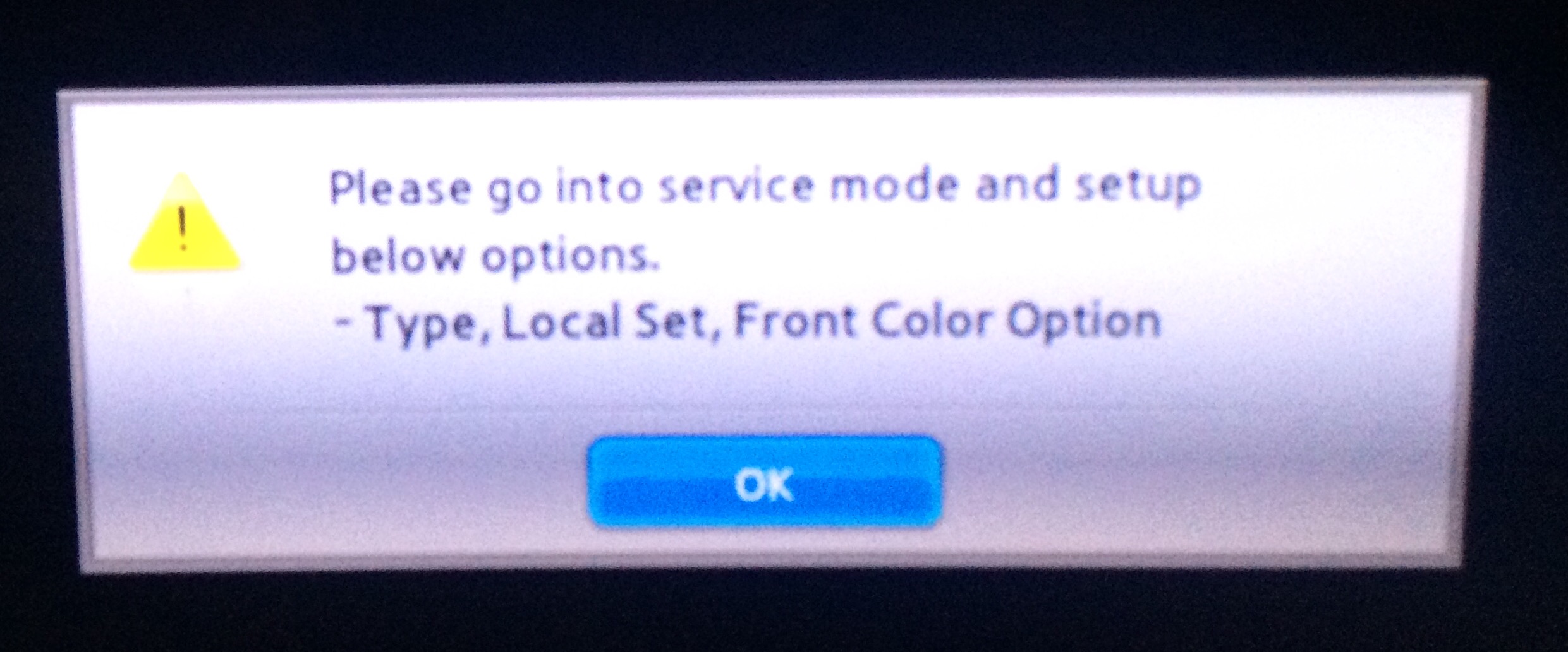

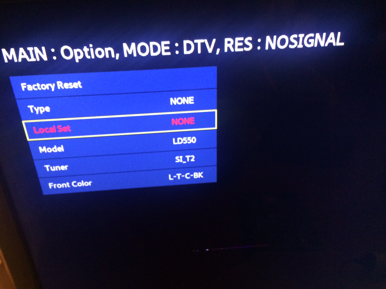

                Hey guys,
                I referred to this post a few months back, and determined that the issue didnt appear to be the 2 large capacitors in my case (I changed them), so bought a replacement main board which arrived today.
                The issue that I'm having is that the TV is asking for me to change some service menu settings; Type, Local Set, and Front Color Option
                All of which can be found under the service menu under the first option. Mine are all currently 'None', which obviously isn't correct.
                Do any of you have access to a UE40D5520 (it's a UK set from what I understand, and where I bought it too).
                The panel information is: LD400BGC-C2 DD01
                Let me know what you can find

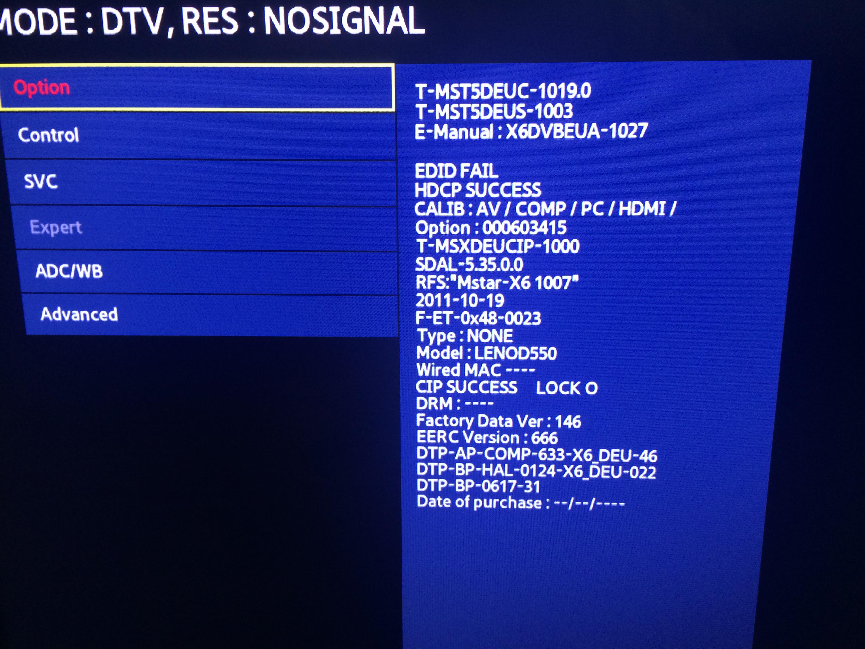

                  #48
                  Re: samsung ue40d5520 flashing red light
                  Forgot to post some accompanying images. Maybe they'll help?
                  The main one is the screen with Type & Local Set set to None, and the the setting for Front Color
