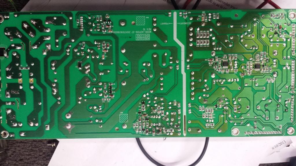

    Olevia 337-b11 no dc
    just picked up this TV for a song thought it had bad caps but as it turns out somebody had already replaced 3 known bad caps on this board and still not working I have 5V stand by and when I turn it on the blue light goes out but no 24 volts to the inverters and no 5 volt power I have checked diodes and Mosfets what's interesting is c54 small SMD cap was shorted so it was causing 5v output and ground to be short it together but I fixed that still nothing. This uses aep016-37 power supply. I also tried jumpering pson w 5vstby. same thing.any ideas where to go next with this I notice a lot of people have problems with this power supply

                W ell I went ahead and recap the output supply and I'm still getting the same thing. I do however notice that I get 3.3v and 5V output to the mainboard which explains why the power indicator works in the power button works. I'm getting about 165 V of the main capacitor and days there even after powering up. Basically no 24 volt or 12 volt or 5 volt. I even tried jumping the opto isolator and still no voltage. I tried Crossing PS on with 5 volt supply and still no output. does this kind of sounds like a voltage regulator problem? There is a 5pin voltage regulator on the power supply that I know fails on certain Samsung power supplies and I'm wondering if this could be the same issue of course I do not know how to test these certain types of regulators
                  Re: Olevia 337-b11 no dc
                  You will have to get the PFC Voltage booster circuit to work first since the 12v/24v power supply requires 370~400VDC to run that section. So if you force on the PS_ON pin and still do not get the boosted voltage, then PFC IC controller and MOSFET, ETC in that section need to be checked.
                  Any good clear pictures of both sides of the board?

                    I'll take some tomorrow. It's at work. The pfc booster ic. Is that the 6 pin ic?
                      Cannot tell until we see good clear pictures of the board, both sides.
                                  http://i845.photobucket.com/albums/a...psaa1356eb.jpg
                                  http://i845.photobucket.com/albums/a...6/DSC01680.jpg
                                  Here are the pictures of.the board. Interstingly I have found on the DC DC converter ic 1501a50 Pins.1.3 and 5 act shorted.
                                    Darn. I have nothing to check that dc converter in my stash to check it against. whatever it is doing its obviously shorting the L9 inductor to ground
                                      Pulled regulator and tests good. Something else.seems to be grounded
                                        okay I know I'm not crazy but maybe I am I'm not sure but it appears that the 18 volts is shorted to ground by Design
