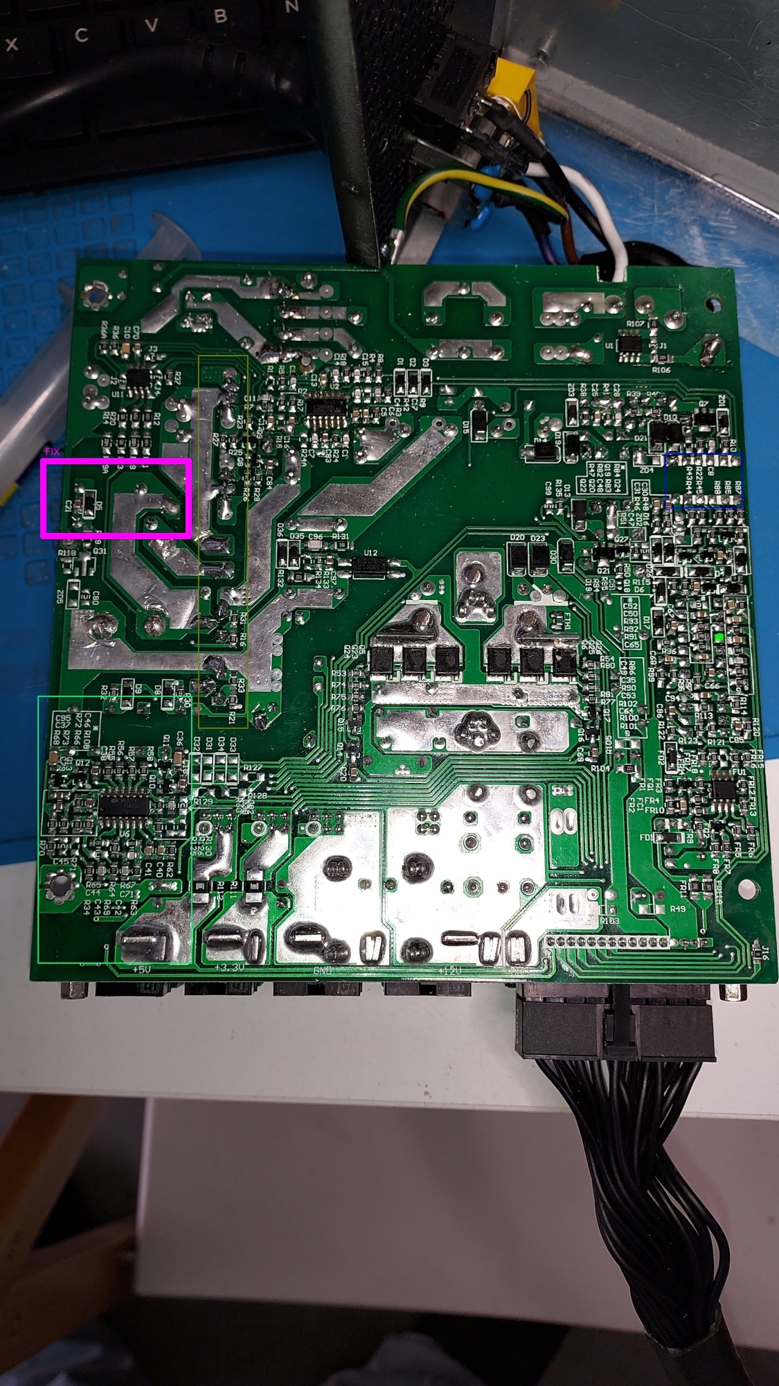

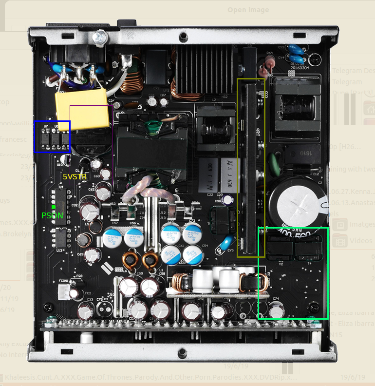

    I am trying to repair this modular ATX PSU. It only has the 5V Standby and PSON enabled (3.33V).
    PSON is delivered by (ST9S429-PG14) in pin4. This chip is a Voltage controller but it doesn't seem to trigger any PWM signal to pass it to primary through coils and "move" the big mosfets. Also next to it there is a EST7618 that it also seems a voltage controller.
    Not sure if in the right direction, but trying to find where PWM signal is generated.
    Green section seems that could be the "PWM section". It's driven by a CM6901 (back side).
    So far:
    - I've checked the 3 opto couplers. They seem ok
    - I've checked the 5 pieces (igbt, shotky......) from the khaki section and they read ok.
    Any recommendation where to focus the analysis?

    I am focusing on the green section and the CM6901 chip. These are the readings I am getting when I switch on the PSU
    Pin 1 - 5.35V
    Pin 3 - 6.12V
    Pin 4 - 4.51V
    Pin 5 - 4.45V
    Pin 9 - 2.09V (triangular clock signal)
    Pin 15 - 14.67V
    Pin 16 - 7.5V
    Rest of pins: No voltage
    Pin 7 (CSS) has no voltage.........maybe that's the reason the IC doesn't switch on?
    Anything that might indicate that chip is faulty??? (no pwm readings in pins 11-14)

            Hi:
            First of all, thank you for your time and feedback. Thank you for the attached files. I didn't know about this web and it's amazing. So much appreciated. 😀
            (There is no "miliseconds" output when I switch on the PSU). Primary doesn't do the job........
            прямо Thanks for the comment: I injected 2V into pin 7 (CSS) that confirms that CM6901 is working (PWM signal on 13-14 that goes to gates at GP28S50Gs). It's pending to investigate why there is no voltage on that pin. Forcing CM6901 to work has shown that secondary output delivers 12V & -12V (rest of voltages are not present) and the PSU makes "tic-tic" noise due to the two reles that are running to prevent some damage there.
            Also I have discovered that the other PFC controller is not receiving any voltage at pin 11 (CM6500UN)................maybe with current situation there is some mechanism that prevents it and it could be normal.
            Last but not least, I've discovered a shorted N channel MOSFET that I've already removed and asked for replacement (LPW).
            Silly question: Could I just put other N channel MOSFET (I only have A09T) to see whether there is any improvement in the PSU? Or it's better to wait? (see attachments for both items)

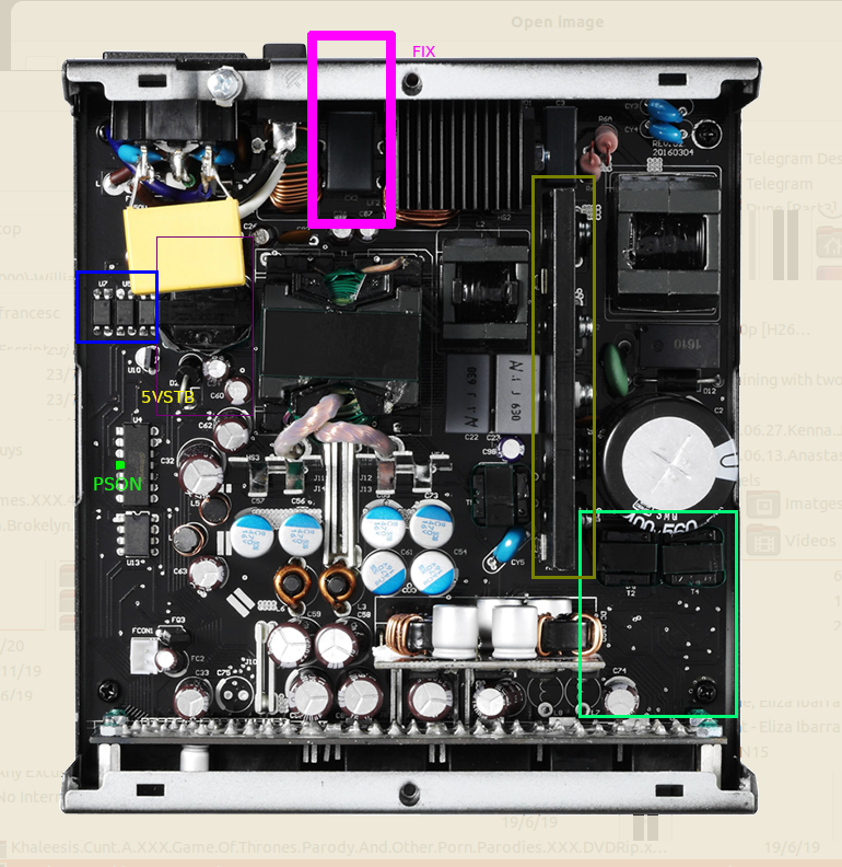

                        Today I had some spare time and I've tried it again. I finally fixed it. The rele wasn't making any noise so I've checked the components near to it. There was a tinny SMD capacitor shorted(C21) and the T4 diode (D5) was open circuit (not shorted but faulty). I replaced both and finally the SMPS came back to life.
                        What a pain in the ass this one.......🤣
