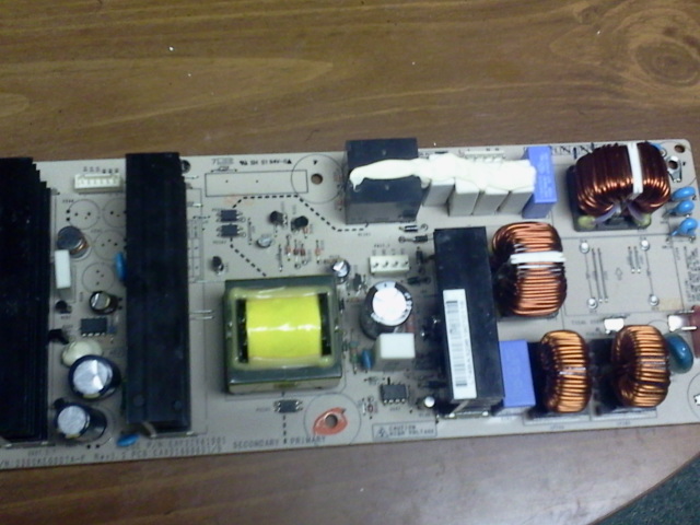

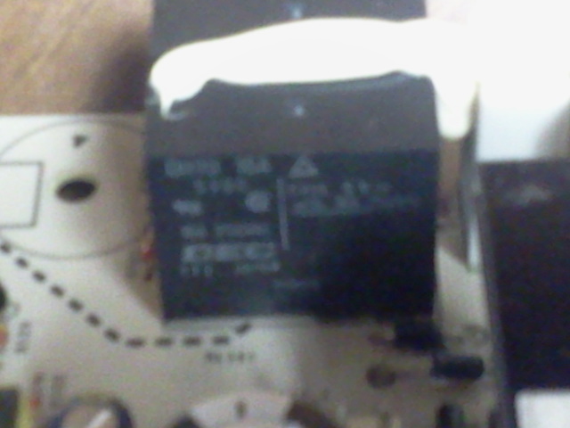

    bh1u. 16a. 5 vdc. 16a250 vac. coil relay. where can i get 2 of these

    Can you post a photo of this coil

      Re: coil relay
      here is a pic of it on the board

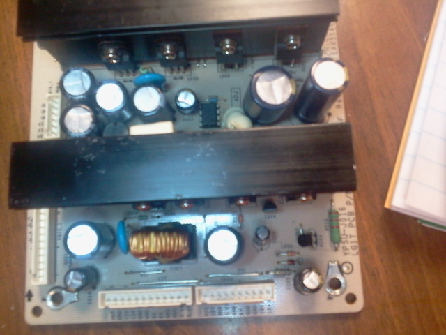

        Re: coil relay
        i believe the coil relay box is out. 1 or maybe both
        the fuse will blow on the board as soon as i plug it in and there was no relay clicking

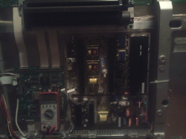

          Re: coil relay
          The photo the one of the relay you need to retake so I can see the writing
          Also what device is this board in
          Take another photo of the hole board more to the left this time

            Re: coil relay
            "the fuse will blow on the board as soon as i plug it in" you have shorted out components, not the relays. What did you check so far on the board?

              Re: coil relay
              replaced 6 caps 10v3300. this board is the sub board fo a
              lg60pc1d-ue.

                  Re: coil relay
                  this will be as good as it gets ..my camera is broke and the picture is with a cell phone

                    Re: coil relay
                    Look at both heat sink and see if you see a diode making on the components
                    also Google the part # as well see if any are shorted
                    The relay would not be your problem at this point

                      Re: coil relay
                      i tested those already..all checked good...will re check again

                        Re: coil relay
                        didnt find anything shorted but when pluged in i can hear a real faint ticking sound
                        between the subpower supply and main powersupply
                        no standby light or relay clicking

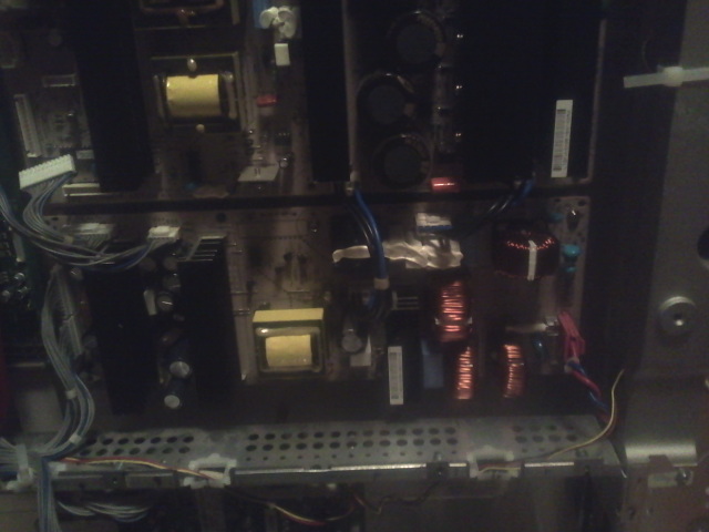

                              Re: coil relay
                              "didnt find anything shorted but when pluged in i can hear a real faint ticking sound
                              between the subpower supply and main powersupply" So it is not blowing the fuse any more?
                              Ticking can mean the power supply is trying to start due to bad startup cap or it is in shut down-restart mode due to shorted circuit.
                              Pictures are not good enough to troubleshoot from remote.

                                Re: coil relay
                                not blowing the fuse...gona try to replace the small caps

                                  Re: coil relay
                                  well the va at the conector at top of power board is up at 52...sticker calls for 60
                                  the other readings are still low and im still trying to find why im not geting my start up?
                                  i still have the verry faint ticking noise. still no stand by light.

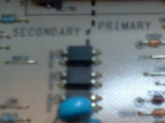

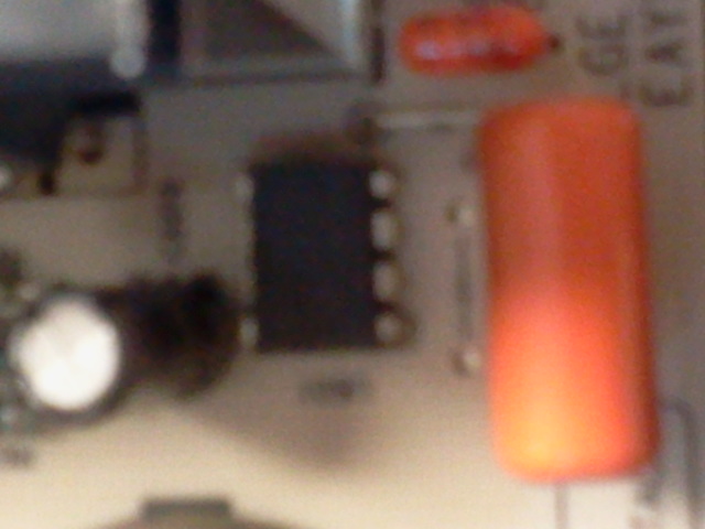

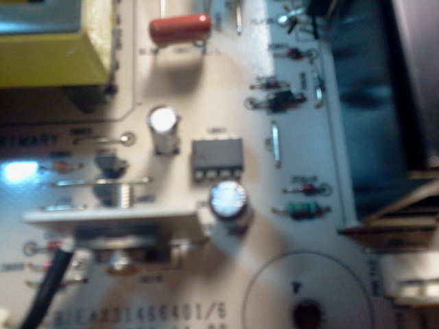

                                    Re: coil relay
                                    how do u measure the intergated circuit. it has 8 legs on it. and the other has 4
                                      Re: coil relay
                                      What are P/N as printed on the top? We need to look for spec sheet, then you will measure the resistance between the Ground pin against all other pins.

                                        Re: coil relay
                                        ka7552. rg52a. is the 8legs other is nec2571sk644. is the one with 4 legs
