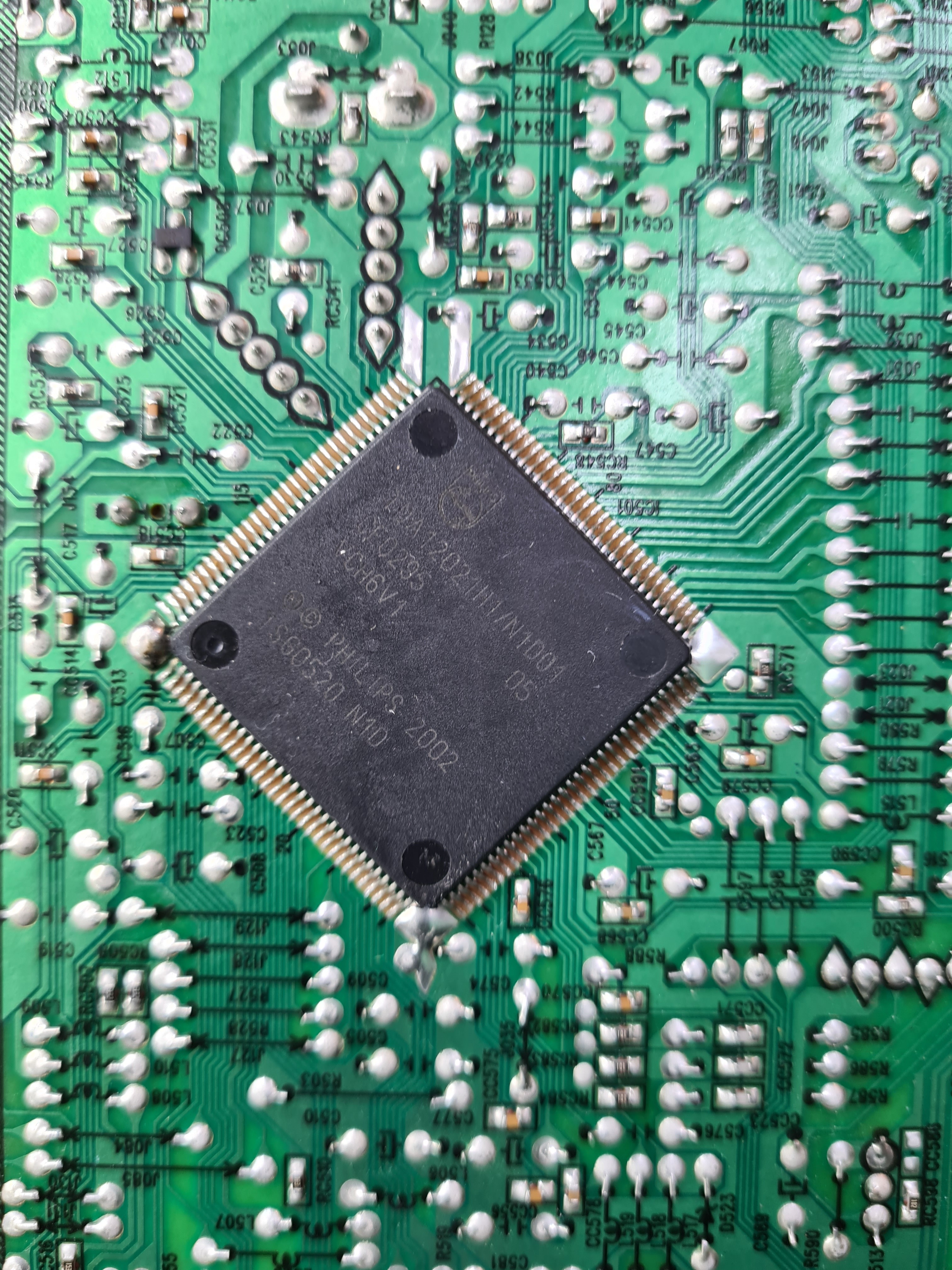

    Hi all
    This set is not powering , with standby LED flashing GREEN/RED
    PSU secondary supplies present& i assume ok
    Line output transistor measures good
    Took a chance & replaced LOPTX but still same
    Can anyone help with advice or schematic ?
  • zen
    • 511
    Hi
    Managed to prevent the switched supplies from decaying by applying an external 2V5 to pin 4 of the 5 regulators grouped together.
    Starting to suspect the PHILIPS HERCULES CHIP that pretty much carries out all the processing & drives
    Nothing resembling line drive from pin 62 , no data activity either.

      Hi, maybe the TV model - DDT21H9Z ?
      • lotas
        • Jan 2016
        • 4718
        • Russia
        DAEWOO DDT-21H9ZZF,ZZR CHASSIS CP-099F
        https://elektrotanya.com/daewoo_ddt-.../download.html
        • zen
          • 511
          Hi , yes that's the chassii
          Also just to add , crystal oscillator for chip is spot on at 24.5mhz
