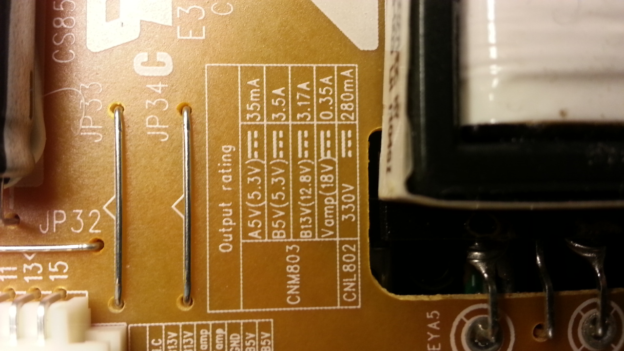

                Re: UN55D6000 Blinking Standby Light
                How much voltage can an LED light safely handle ? I have a quick and dirty idea...
                As seen in one of the pics I posted in this thread there are four wires going to the backlighting. The center two are connected together at the board so if I assume (!) there are two led strips then I can isolate the individual strips by manipulating the harness.
                The board says there is 330v at the connector or 165v per strip. Is it safe to run full voltage through one strip ?
                  #68
                  2000 count MAX reading is 19.99V i.e. it can read from 00.00 (zero) to 19.99 (1999) and has 2,000 total counts, or 1.999V max from 0.000 to 1.999, and so on.
                  I have a 6,600 count meter, many high end meters do 10,000 to 40,000 counts.
                  Each LED only rated around 3.5V to 4V but the key is they are non-linear current driven devices which means just 100V would not make the 1/4 bright they would not light up at all.
                  I don't know the configuration of this panel but if you give the model of the LCD panel (probably SAMSUNG, AUO, CHIMEI... plus model number) then configuration of LEDs might be available in my panels datasheet listing or another site.

                          #72
                          That would probably kill a great many LEDs, unless the PSU is current limited. Even then, damage would likely occur.

                                    #77
                                    100 LED's per side so 200 total of which 20 have failed (my meter lights them, not too bright but enough). Two of the twenty have failed open, the rest short.
                                    The supply is rated at 330v total or 165v per string.

                                      #78
                                      How do you explain it being so low (1.65v per led) ?
                                        #79
                                        Probably 50 LEDs/string but two strings in parallel.
