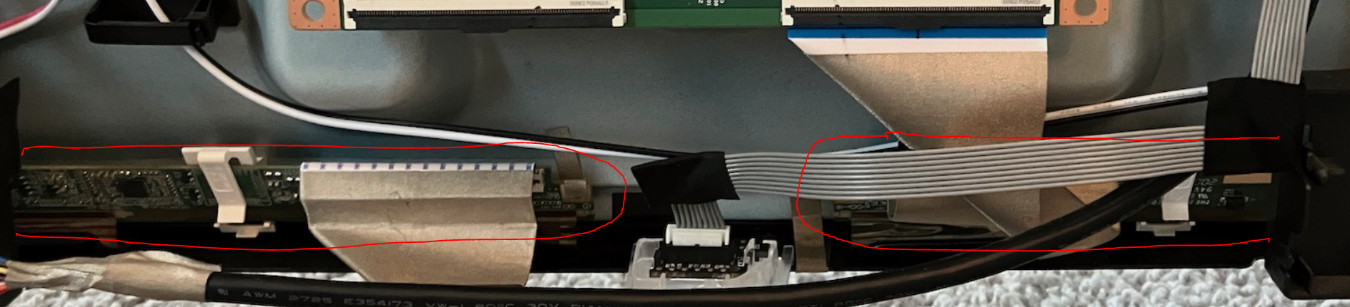

            I am also troubleshooting this identical issue, exactly as described by post #1 above.
            I had some email interaction with Hisense tech support. They sent me a series of questions, which had mostly to do with attempting repair by disconnecting the power, resetting the device, etc (none of which helped). But one item they asked was new to me: is there a flicker of white light when the panel front is lightly tapped? Yes, I get that result. But they never replied to me, even after several re-attempts.
            See attached photos with descriptions. Hopefully this helps anyone who might have a remedy? I would love to get this working. Have only had it 2.5 years, it would be a shame to make a land fill contribution with it.
            Thank you
            >>I am having trouble with uploading/describing photos. I keep getting "ERROR you are not authorized to create this post" So bear with me as I figure this out...

                Here are the photos I was trying to upload, in case they're helpful.

                      I was all set to start buying CPB's to fix the issue, then I came across the "tech support" offer on ShopJimmy. I filled out all the details of my issue (see this entire thread). Within 90 minutes I received this reply from TV tech, Randy:
                      "shorted lcd screen, no fix for that. screen costs are as much as a new tv"
                      I figure they want to sell me parts, so an answer like this seems reliable.
                      Any thoughts out there?

                        The problem may be in these buffer strips, ceramic capacitors, protective diodes, diode assemblies being short circuited and because of this the protection at the T-con output is triggered (voltages are blocked).

                            nomoresonys I tested the capacitors identified in the video. They both have continuity which I think means they're fine? But again I'm so new to this I'm not 100% sure. I don't get how a capacitor can be removed from a board and then it works? Doesn't every component have a job to do? Maybe it removes that one line in the screen and the eye doesn't notice?
                            lotas thank you for the suggestion - how would you go about testing this possibility? I am ready to learn!

                              This is probably correct. And that could be a capacitor on buffer boards. The caps should NOT have continuity, one side generally is grounded. If both sides are grounded then the problem is somewhere there. As the others were saying.

                                It's pretty simple, put meter in ohm mode, a probe lead on each end of capacitor, is the reading low, now compare that to the many other caps on the board, odds are only one or a few will show the very low ohm, if you have a meter that beeps with continuity and you get a steady beep, that indicates a short, which may be the cap itself or maybe a component nearby etc.
