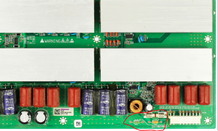

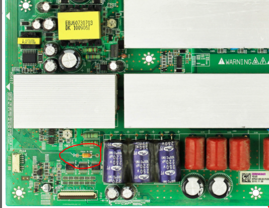

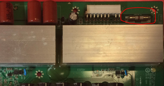

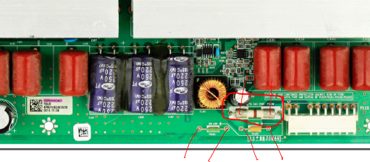

        Check the igbt's under the y-sus board for shorts. They are labeled with a "Q". It is strange that you have the correct voltages.
        • lotas
          • Jan 2016
          • 4865
          • Russia
          Предохранители живые?
          • tvtimmy
            • Mar 2015
            • 1160
            • usa
            Lotas says to check the fuses he has circled.
                I tested them with a multimeter when they are still attached to the boards and they all read about 0,5 ohm.
                  • lotas
                    • Jan 2016
                    • 4865
                    • Russia
                    If you can’t even check the fuse, then you won’t be able to repair a plasma TV, it’s very difficult to repair, it’s not an LCD TV. You can check the fuses without desoldering, at their terminals on the sides...
