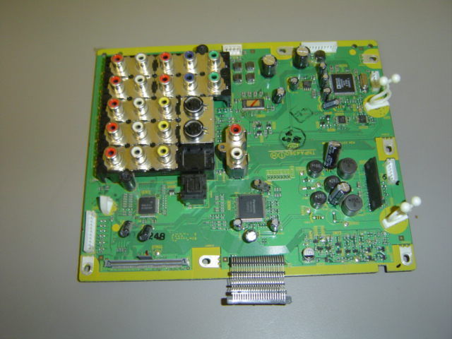

    This was the first time I repaired a 12 Bilinks Panasonic TV, symptoms: PLug in the wall, two clicks, after a while then one click. Pressed power button in the TV or in the remote control, heard click, but gave 12 blinks, not power on, the cooling fans ran a second or two, then stopped.
    The error code in the service manual mentions this is the audio processor propblem, check the H board.
    What I tried was to disconntect both speakers, no change. Disconnect the cable to the side input board, no changes. Disconnect the power cables from power supply to the H board, gave 10 blinks.
    I suspected the H Board TNPA4360 failed, ordered one and replaced it, unluckily, the problem is still the same. I could see the LED of the optical output jack lite up then off as the tv shut off.

      Re: Panasonic Plasma TH-42PZ77U 12 Blinks
      I checked the TP2037, 2.67V, and I installed back my original board, is 2.71V. Not sure if voltage is high or low, from Tom66's comment, 15V is high, so 2.67 is low.
      I also checked the voltage from the power supply, it's 15.75v, normal.
      Is it possible two boards fault at the same part ? or the fault I from other boards?

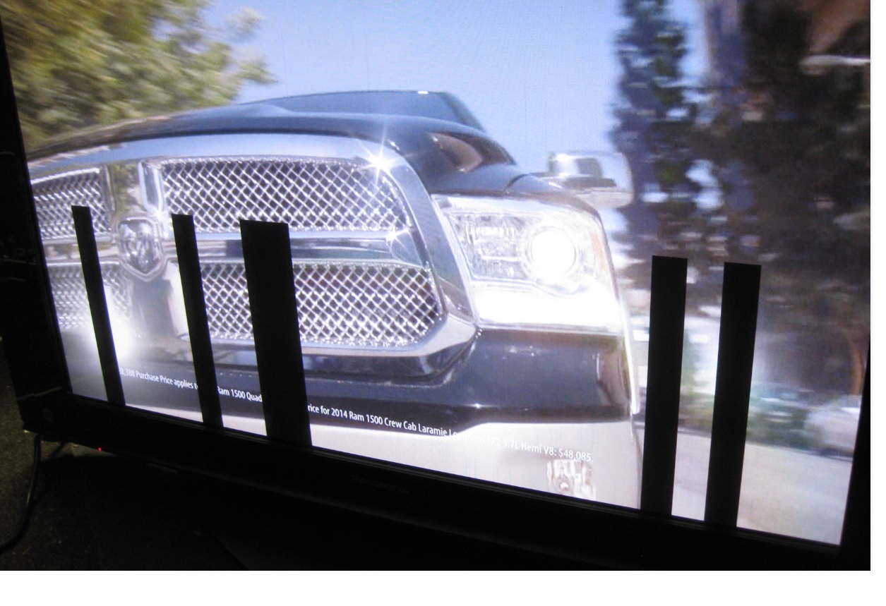

          But unfortunately this TV has another big issue: There are 5 vertical bars on the lower of the screen, and there are many very thin vertical lines, most lines on the lower screen, some on the upper screen.
          I have no mood to go ahead to fix it, the 4 of the C buffer boards are bad, or even the panel is bad.
            Big bars: if there is NOTHING in those bars, it is quite likely that they are just loose connections or bad C board. But if there is something in them, then it can be a bad plasma panel.
